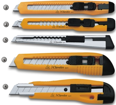

May i ask what type of cutter did you use for the veneer ?

. . May i ask what type of cutter did you use for the veneer ?
Hi Paul, for this task I use a very common set of cutters like the ones showed here below. It is important to use cutters with interchangeable blades in order tho have the edge always in perfect conditions.
