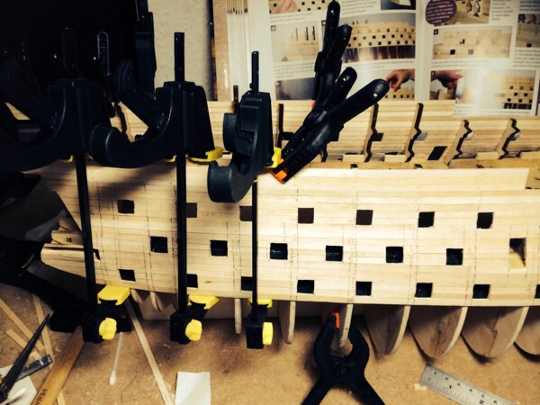

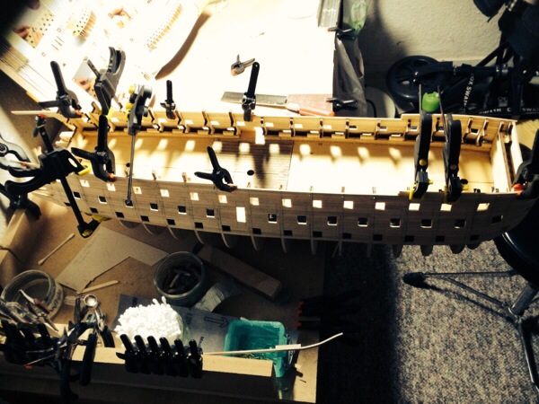

Another question. When I measured the height of the planking at the top of the frames, it was slightly higher than the last plank so as you can see below I have added another one. Is this the right thing to do and should it just sand it down or have I made an error in this??

#63 Posted : 01 July 2014 17:20:32
Hi William
You can reduce the plank height down later so that should be ok, as for the template - the wording is wrong in the mag, it should be placed at the rear of the frame as in your pic.
Here is the text from the official build diary -
"Page 12 contains a template profile which needs to be transferred to stiff card, (such as the back of a cereal packet), the template needs to match exactly. Note that the first template photo shown contains incorrect wording, it should read 'This point lines up with the rear of frame 30' which as per the wording noted in second template photo, therefore the template should be aligned with the rear of frame 30 as per photo 5 of this diary build"
Hope this helps

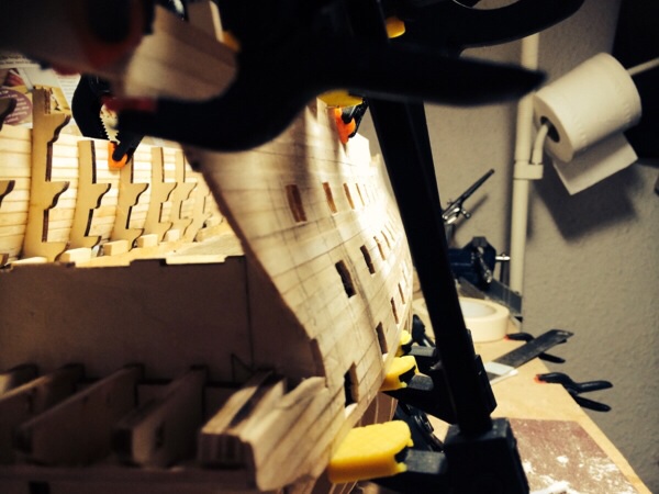

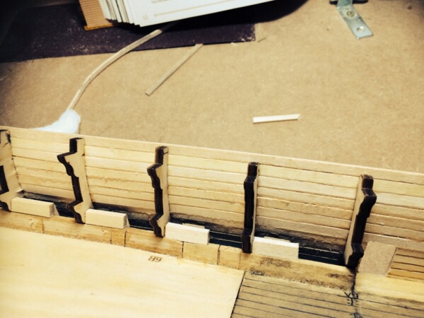

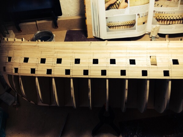

Some latest pics, still resisting the urge to sand any of it yet. I've been thinking ahead to the mast and other dowel relation objects on the ship. Am I right in thinking that the only way to get this spot on os to use a modellers laythe?

#70 Posted : 10 July 2014 19:13:09
Looks good William, very neatBigGrin If you are referring to the mast and spar tapering then no, a lathe is not necessary although would be best. I used a cordless drill - put the mast into the drill chuck, you wont end up seeing the lower end anyway as its below deck, spin the mast whilst holding it against a sanding board, basically a large piece of sandpaper glued to a board. Keep checking the diameter as you go.

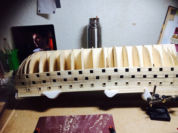

Ok, trying to sit down and stomach the next bit but straight away I have a question. Have a look at the photo and you should see a nip in the line of the last plank towards the bow. The next step is to lay a plank between frames 18 and 25. Should I have it bend with the plank above (or below as the picture shows), or do I run it as straight as possible and add a dropper plank?
