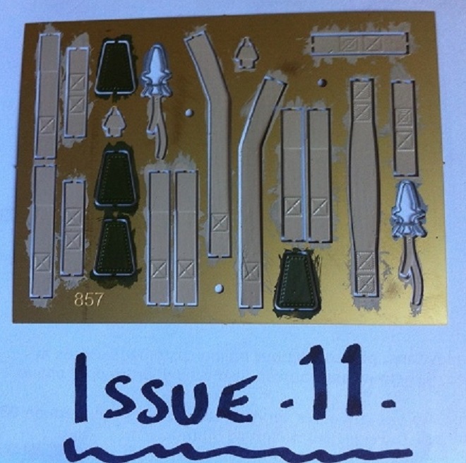

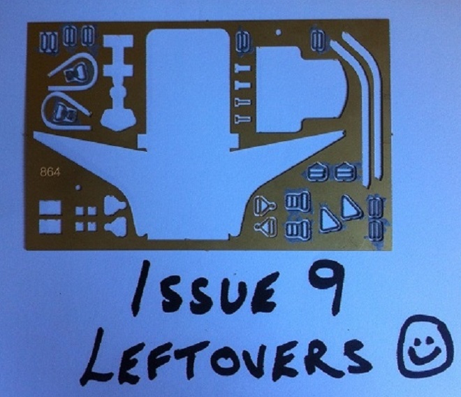

Now this is just a preview of issue 11.
It supplies a brass fret of the pilot`s harness straps, in addition you now bring into play most of the remaining parts of issue 9, these parts are the buckles and adjusters for the harness.
All of these parts are painted whilst in the fret.
I have used the recommended Humbrol paints:
56 - Aliminium
121 - Pale stone(matt)
159 - Khaki drab (matt)
One thing that did come to light was, that the paints 121 and 159 do not come in acrylic, but, the enamel has done an excellent job albeit that it took a bit longer to dry.
When assembled I may try a bit of dark wash to tone down the harness straps. Have already had some success with the pilots head rest with that, but more on that later.Blink
The parts you are about to see have to be fed through each other, bent then stuck in the right place at the back, confused, I am. LOL
This section is going to need some serious translation, as the drawings and pics are not as self explanatory as other issues have been.
So I`ll leave you with a couple of pics below of the painted parts still in their frets.
I`ll leave those parts up to your imagination, while I translate the instructions. Flapper Flapper Flapper
Oh, by the way, the built part now weighs:
120 gms
4.2 oz
0.265 lbs
See you soon
Happy building

delboy271155 wrote:
Hi All,BigGrin
Need to give my eyes something larger to focus on, every so often, so made a start on the Hachette Stuka.
Uhhh, Derek? Remember this?
Where are these 'larger bits' you mentioned? Because to me it looks like they are getting smaller, not bigger! Flapper Flapper Flapper
Oh, and be careful with enamels. They tend to be and dry a bit thicker than acrylics so there is every chance of you losing some of that gorgeous detail!!!
And that would be a real shame!
So please be careful and let me know when you find a larger bit, ok?

BigGrin Hi Derek
Some nice but fiddly looking etch there, taking your time is the secret here. Also if you need to put a dome in any of the parts provided then a bag of assorted size marble's will be needed, placing the part to be domed on a soft surface and rolling the marble in a circular motion over it will bring in the results.

Hi Adrie, BigGrin LOL
In my defense, the parts did start out bigger and since then as you say have got smaller to say the least, but this is such a brilliant kit I`m having to ease the brakes on, as it`s tending to drag me along.
The sign of a good kit I think, but not to be rushed.
As far as the enamels go, there is an equivalent Tamiya acrylic XF51, for the drab Khaki, but I can`t find one for the pale stone. That aside the nearest shop I can find with the acrylics is 10 miles away.
So rather than wait for some to be posted, I have almost dry brushed the webbing strap parts with the enamel and managed to keep the detail of the stitching.
Larger parts appear in issue 13, but they come with the mandatory tiny bits as well. LOL LOL LOL
Thanks for looking in and the very welcome advise. Cool

Hi Andy,BigGrin
Your very right, this is a definite slow down point.
First off, translation required as previously mentioned.
Then the straps will have some serious bends put in them, so that the ends when passed through the buckles can be stuck to the reverse side.
These "U" bends will have to be spot on, or the strap ends will not lay directly on top of the reverse side.
So, I`ve now found a use for some of the scrap brass, PRACTICE.
