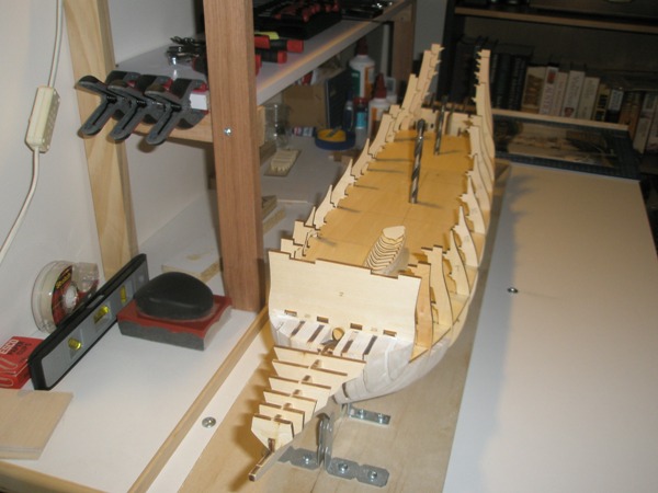

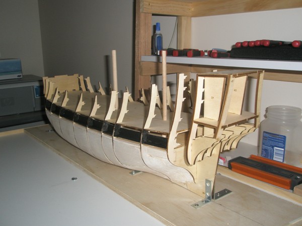

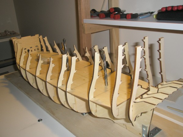

Hi Everyone.
Here's progress report #2 June 2014
Lower deck installed. Had a bit of bother aligning Rib 13 starboard side with the deck slot. The rib was warped forward slightly (approx 5deg) so I made a ram with a piece of dowel against the base of frame 2 and carefully slid the other end down rib 13 until it was perpendicular. The rest of the deck then installed easily. Rib 13 is still slightly off and will probably give me a bit more heartburn for the second deck.Glare
Here's the pics of the deck installed;

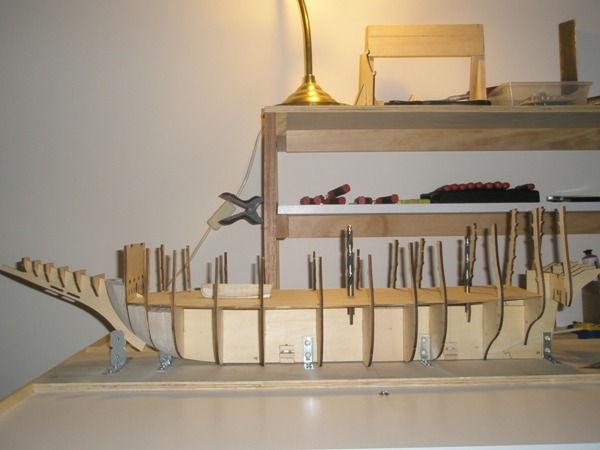

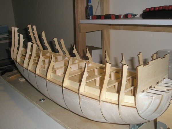

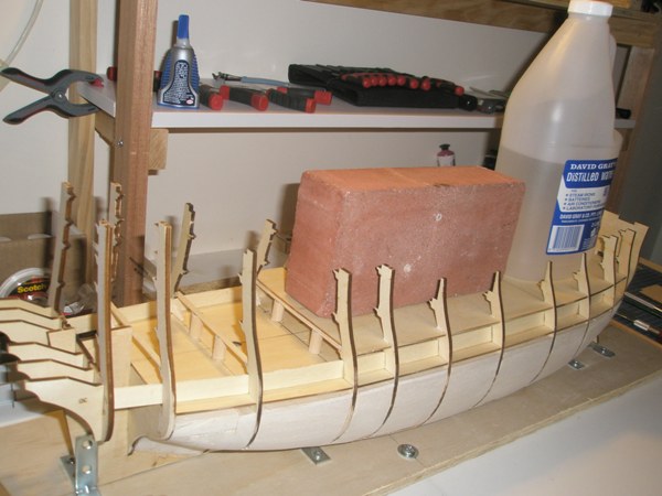

Preparing to install second deck.
I've fitted additional supports under the deck beams. Started with scrap pieces of 5mm balsa but found too fiddly and they persisted in falling over. The dowels were much easier to prepare and instal.
I was a little concerned about the integrity of the false cannon supports once drilling holes for the cannon commenced, so I've added buttresses behind each rib for extra strength.
There was a gap between the deck and beam at frame 22 so I added an extra beam as a packer so the deck now has full bearing on the relevant beams.
Note the use of my trusty brick pavers to weigh it all down.BigGrin

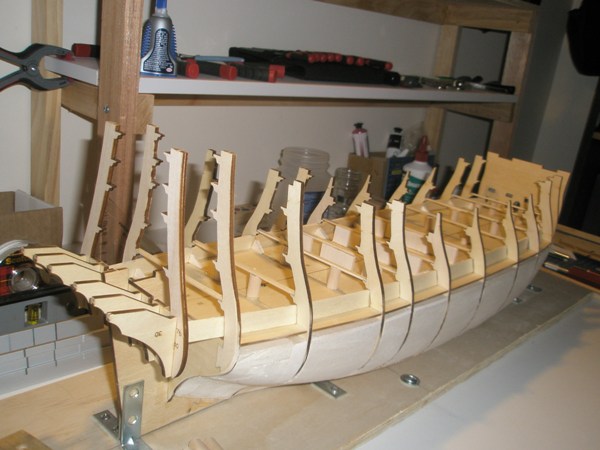

And finally here's the stern assembly completed (issue15).
I think it has been corrected where struts 45 meet the upper deck 42, as there was no need for the little packers per Mr T's build. All went together without a problem.
I've decided not to do balsa infills between frames 26 and 27 - there is so much wood in there it doesn't seem necessary.
That's all for now, bring on the planking!!!BigGrin BigGrin BigGrin

Fabulous work. The deck supports are a benefit with the additional weight being applied when installing the second middle deck.
That said, there seems to be a common trait whereby there are some significant weighted objects being placed on the second deck. On my build I have only done a dry fit. For mine, whilst the join between the centre and aft deck sections are flush, between the fwd and centre sections I have a 2mm step. I need to apply a heavy object a the end of the fwd deck piece to achieve a decent join. This is despite the lower deck being flush. I will post pictures in my build log this evening (I'm currently at work and checking into the forum on my lunch break).
So, I'm not sure whether other members have used heavy weights because of similar issues.

The only reason I used heavy weights is because the centre deck sections were a bit woofy (slightly wavy) and I wanted to make sure everything was bearing 100% and nice and flat.
It seems your forward sections must be warped if there is a step (at rib 13 I assume?) and the lower deck is flush...I can't think of any other reason.Confused Confused.
Good idea to post some pics and lets have a look, maybe the experts will have a remedy.Cool

#73 Posted : 20 June 2014 10:27:34
the deck you are referring to has a slight slope either end,so some weight needs to be applied so that the deck sits on it's support beams.but be careful not to overdo the weights, or a saggy bottom occurs,Crying BigGrin
Hi Karl
Yes you are right, and thank you for the timely advice. However, I would not use such heavy weights if not for the balsa infills which make the hull very strong and sturdy. I am very attached to the lady and would never treat her roughly!!! BigGrin BigGrin
