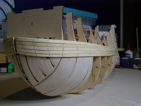

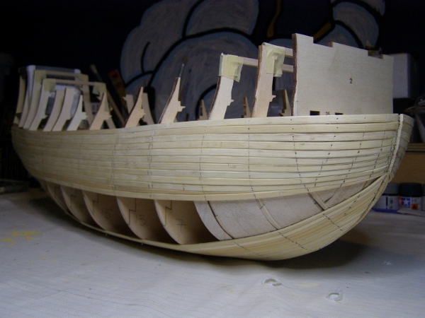

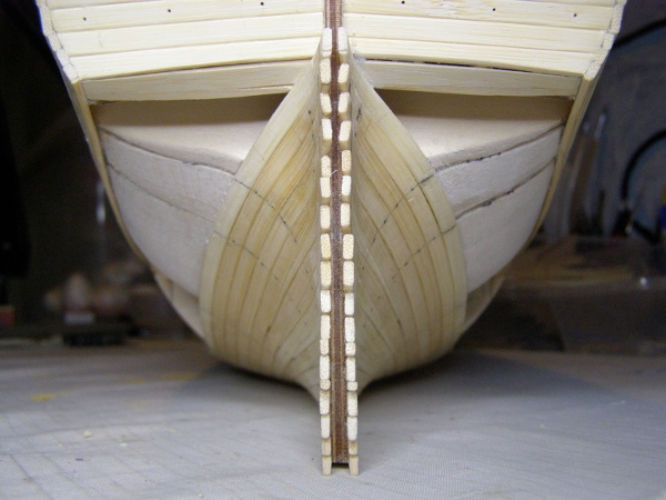

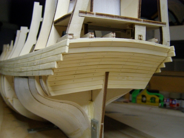

Hi Again,
It has been a couple of weeks since my last post and high time to update my progress. Very many thanks for your previous comments, much appreciated.
So, planking has commence. Some trials and tribulations were encountered (as with any attempt at learning new skills, seeing what doesn't work and what does).
The planking under the gallery was relatively straight forward. Prior planking this area I must admit that I did not pay too much attention to the overall shape that would result. Upon setting the first series of planks it was quickly apparent that there is a subtle curvature of the under gallery section. I ended up completing the first sequence up to the keel using 6 planks. I had to cut a small notch on the underside of the 6th plank where it meets the keel, otherwise there would have been a bulge in the plank in this area. A minor issue was encountered when completing the planks to the upper gallery where I ended up with a split in the stern bracket (#28) on the stbd inboard side. I made up a U-shaped support bracket (with copious amounts of glue) to keep the stern bracket structurally sound and (hopefully) prevent the split from any bigger in the future.
The first five bow & hull planks have been laid. For me, this is definitely slow and steady progress. Experimenting with different techniques in order to get the planks bent to the required shape. Tried the kettle (only have an electric one) and the steam wasn't available for long enough. So, I thought I would try the bamboo vegie steamer placed in the wok with simmering hot water. Bent the planks a treat, but I found that I had a small window of opportunity (less that 5 minutes) to get the plank bent to the right shape otherwise the plank would quickly dry out. Placing the plank back into the steamer would result in it straightening out again. I have now resorted to soaking the plank in a tall glass of water for about 30 minutes and using an electric plank bender. At the end of the day, I guess it's horses for courses and whatever works.
I have also found that there are certain colour shades of bamboo that bend easier than others. So I am now grouping planks by colour shade and location of knots. Hopefully I'm not the Lone Ranger in this aspect.
Snapped two drill bits from my micro-drill set whilst pre-drilling a bamboo plank, was not happy about that. Then I recalled reading a post in another build log about using a dressmaker pin as a drill bit. This is definitely the way to go when pre-drilling bamboo and I am kicking myself for not remembering this earlier. I filed the end of the pin into a Vee and this works a treat.
So, the trusty "dry dock" has now been placed into semi-retirement and it's on to laying the garboard plank.
Until next time.......
Adam

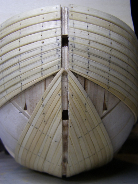

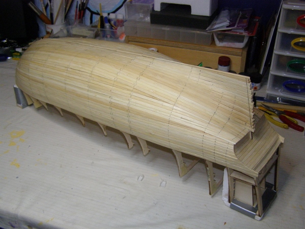

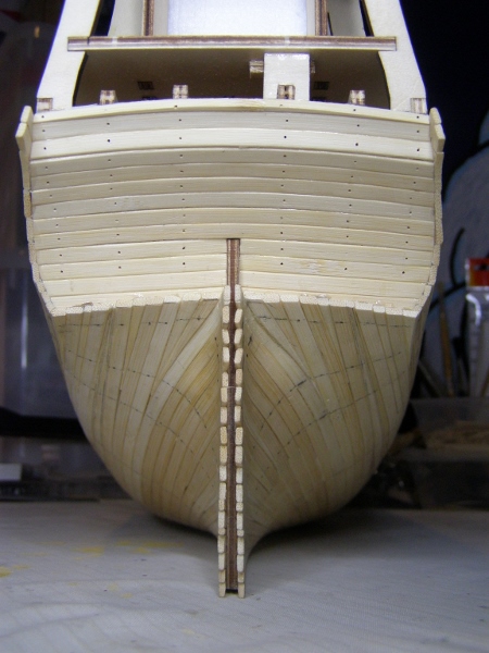

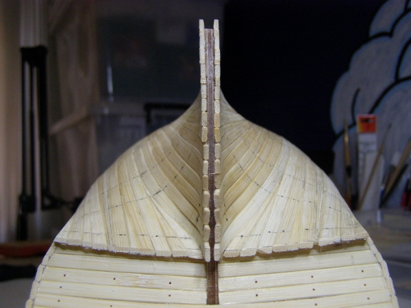

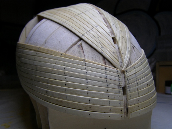

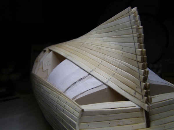

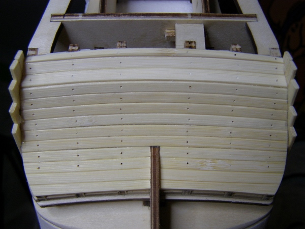

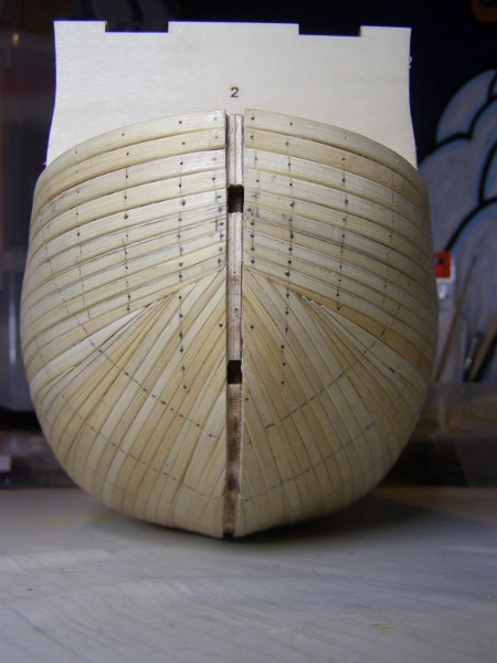

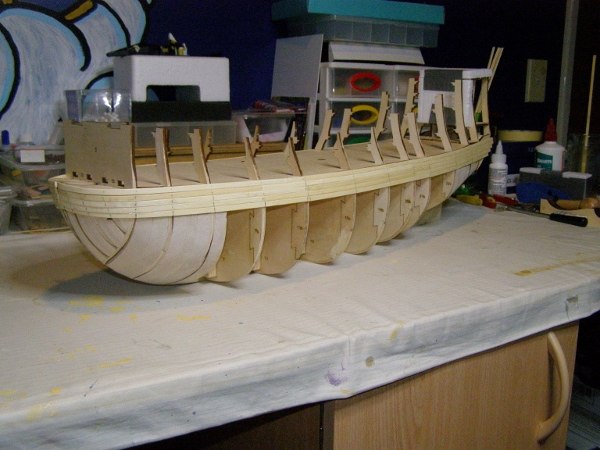

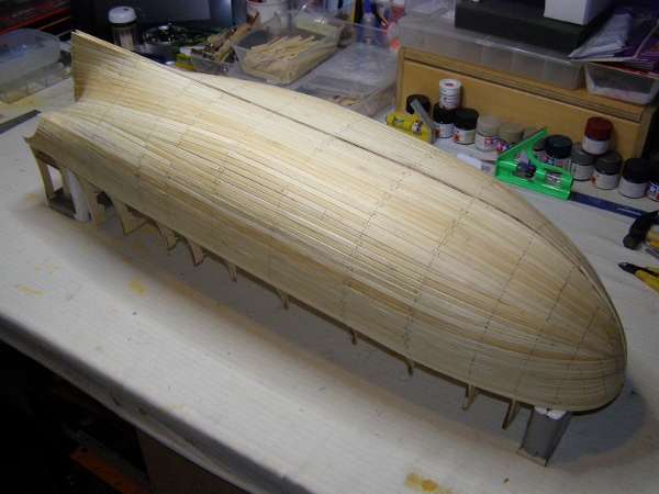

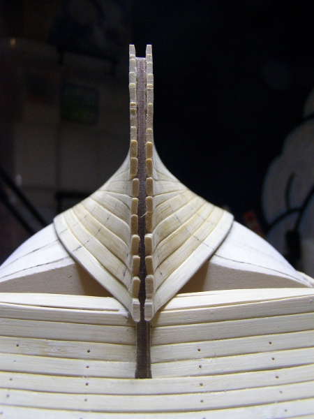

G'day Folks,

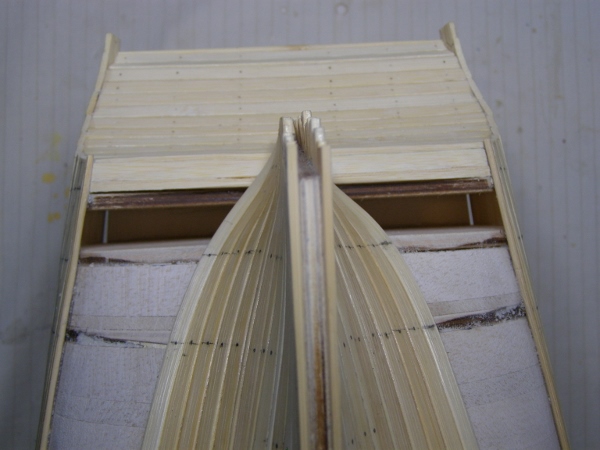

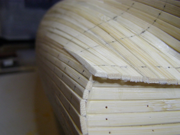

It has been a few months since my last post, however, the build is continuing albeit at a slow pace. I am still progressing with Issue #25 and picked up Issue #37 today from the newsagent. There just isn't enough time in the week to devote sufficient attention to the build. A couple of hours on weekends is all I can manage at this stage. Hopefully over the Christmas break I can do some catch-up.
Anyhow, hull planking has reached a minor milestone whereby the upper and lower planks at the bow now meet. There are still many more rows to complete and nowhere at the bow to squeeze them in. In hindsight I think that the third & fourth row from the keel is the cause of is this dilemma. The planks for those two rows ended in full width and take up a significant amount of space at the bow. The planks after these were mainly half width at the ends. For the pins supporting the planks on the bow frames I have left these installed. I cut the heads off and used a nail punch to drive them flush with the planks. This was mainly to provide additional securing support for the planks. I have also left the pins installed along each row where two plank ends meet and are attached to a frame.
Shaping and fitting the planks to the stern area has been a tedious evolution. The degree of twisting and flexing required to obtain a smooth flow and overall shape within a 3-4 inch length for each row was a challenge indeed. I have been using an electric plank bender iron to aid in achieving the required twists in the planks for this area. This part of the planking has taken most of the time that I have available to date. A monotonous process but it is great to see it coming together and taking shape. I am fairly happy with the outcome.
Thanks for looking in, enjoy the pictures of progress so far.
Adam

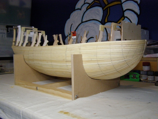

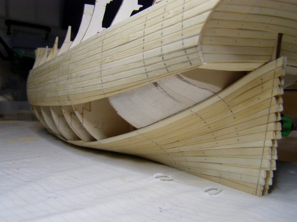

#79 Posted : 23 January 2015 13:52:45
Joined: 17/04/2014
Posts: 99
Points: 303
Location: Perth, Western Australia

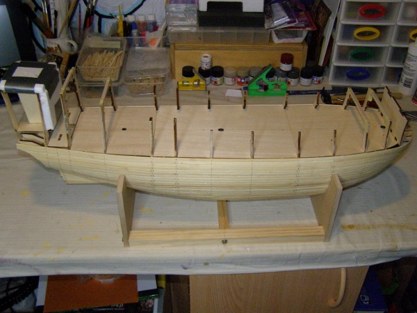

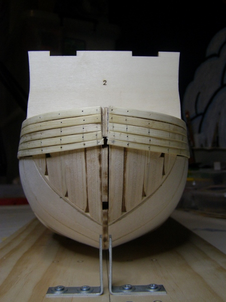

Just a quick update, but firstly thank you all for your comments and apologies for the delay in responding.
I have finally completed the first planking layer on the lower hull section. BigGrin I am very hopeful that the upper section is less painstakingly time consuming.
The final two rows were unable to be laid as per the instructions contained in Issues 27 & 28. For some strange reason I was closing the gap between the final rows sooner than expected. So, it was a combination of the steps contained in the two issues that finished off this part of the build. The end result does not appear to be too abnormal or detrimental to the overall shape of the hull, so I guess there is no harm done. Unsure
The hull planking at the stern has a distinctive ā€œLā€ shape to it at the moment (as seen in the third photo). In this area I was unable to lay the planks to achieve a curve, however, I am intending to rectify this during the sanding process.
I have also constructed a build cradle. After looking at the upturned hull for so long, it is strange to see the old girl the right way up. Now it's starting to look like a ship, instead of a blimp.
Thanks for looking in.
Adam
