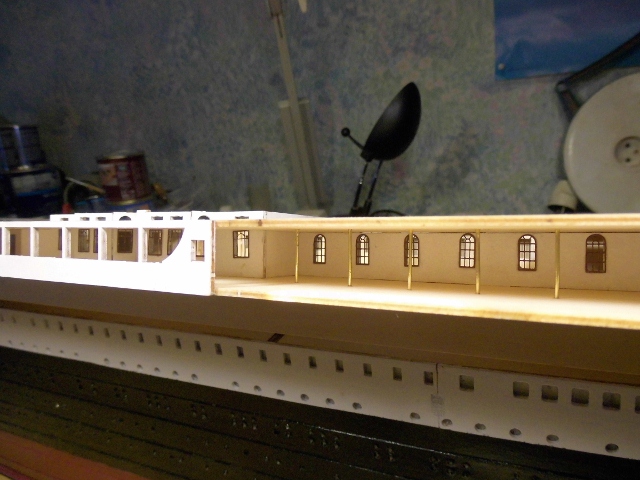

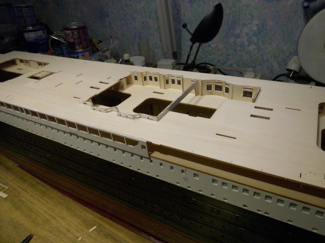

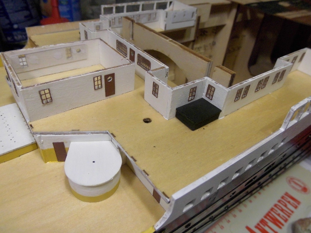

The deck you see here will probably not be planked at all. Once finished it's almost impossible to see it because
it's behind the outer windows that will be added later. ( looking like the plank right below this deck) . But planking is
still a headache to me. Billing Boats has not intented any deck planking at all. But if you take a look at Dave's incredible
work in this field with his Titanic you will understand that I still might start some planking, at least at the more visible
decks. We 'll see :-)

Those windows look wonderful and so delicate.
What I find really odd is that on such a large and detailed kit billings have omitted the deck planking detail. At this scale it's certainly something that would be seen and these ships had some lovely varnished decking.
Hope the rest of your build goes well.

I might indeed start planking the decks, but I intend to only do so on the visible parts. If I'm well informed Titanic had pinewood planking. If we start from 5 inch wide
planks (12,5 cm) I need 0.8 mm ( 1/32 ") planks on the 1:144 scale. Please look at the fantastic example by Dave, elsewhere on Modelspace (Titanic 1:144) if you haven't done
so yet :-) Yes: the windows provided by Billing Boats are very, very fine. Rather difficult to remove from the provided metalsheet. But if you take care, the result is fine :-)

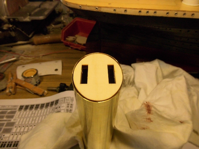

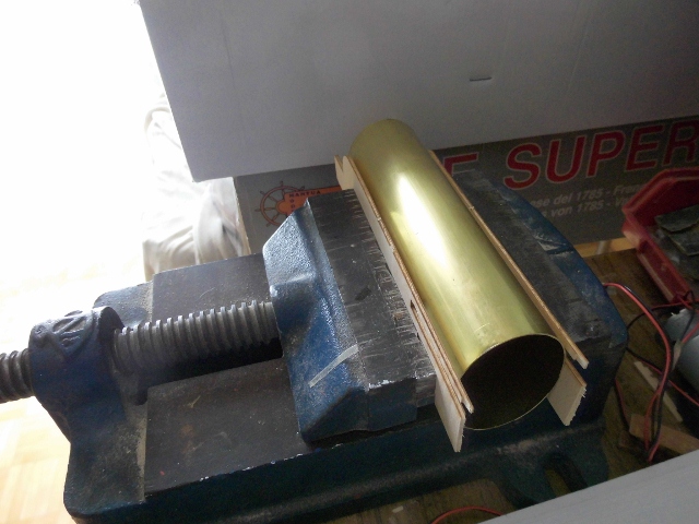

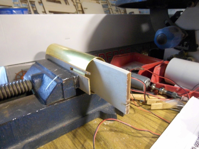

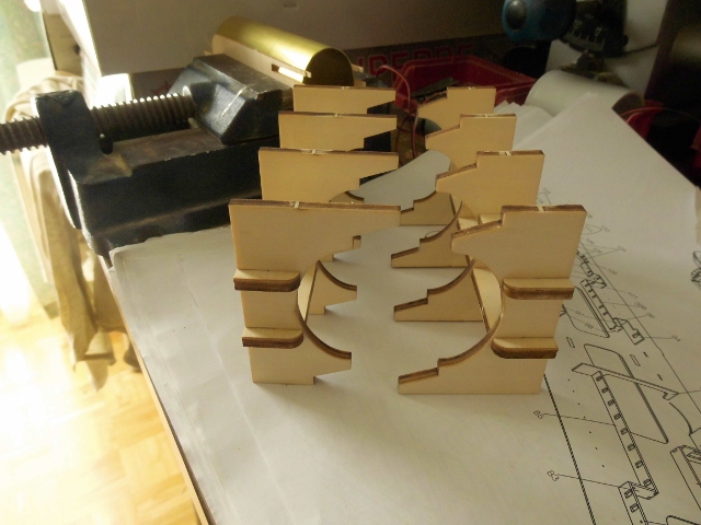

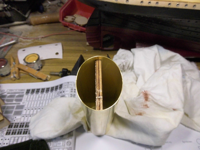

Building plans show a wooden structure to be build just to push the chimneys into an oval shape.
In practise that prooved to be totally impossible ; once you remove the wooden structure the chimney
returns to its round shape, even if you leave it bent for days on end. The following pictures show the
solution I found for this problem. Make a peace of wood about 1 cm shorter than the chimney and exactly
5 cm wide. (this is a fraction less than 2 inches). Round the edges with sandpaper and introduce the wood
into the bent chimney that will now not return to its almost perfect round shape. Laugh

The brass tubes for the funnels have to be heated to cherry red with a blow torch and then allowed to cool. This then allows the tubes to be squeezed (annealed) into shape. It is a common metal work practice when wanting to change the shape of metal pieces. However the oval wooden pieces on which the funnels sit appear small for the size of finished tube shape. Not sure why it is not a precise fit when other parts seem to be a good fit.

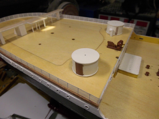

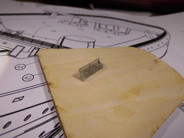

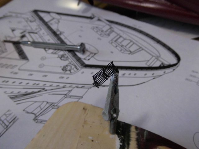

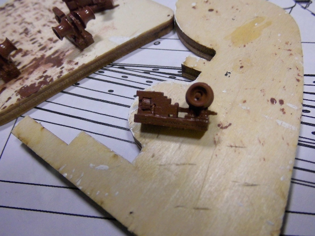

She's still growing, but building all the details takes hours and hours and hours. Not easy at all! Even though the model
is 2 meters long, it's still a 1:144 scale which means that an object like a bench is about 6 or 7 mm high on the model (see fotographs...)
