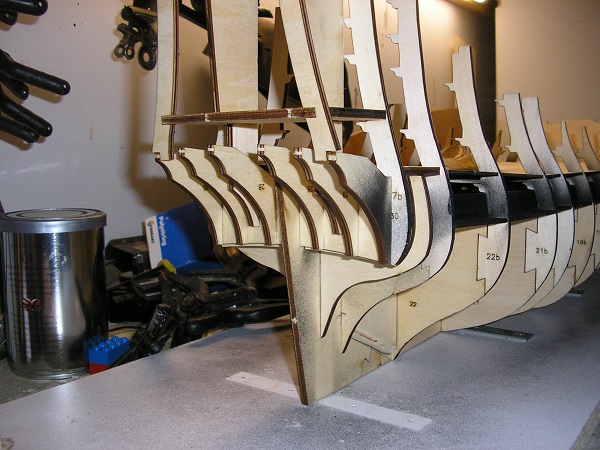

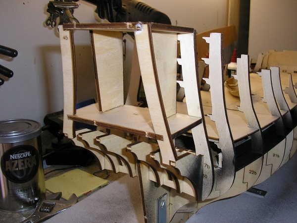

Issue #15 frame work for the galley, need a bit of dexterity but got there

bb1949
#65 Posted : 02 July 2014 09:24:06
Joined: 27/02/2014
Posts: 149
Points: 456
Location: Forest Lake QLD
Hey Jock. I'd very happy with that. Looks good.
Brex.
George1
#66 Posted : 02 July 2014 10:55:33
Joined: 16/03/2014
Posts: 516
Points: 1,563
HI Jock. BigGrin
Looks good mate. Cool Cool A bit fiddly like you said but once together it's OK. BigGrin
George
Building HMS SOTS

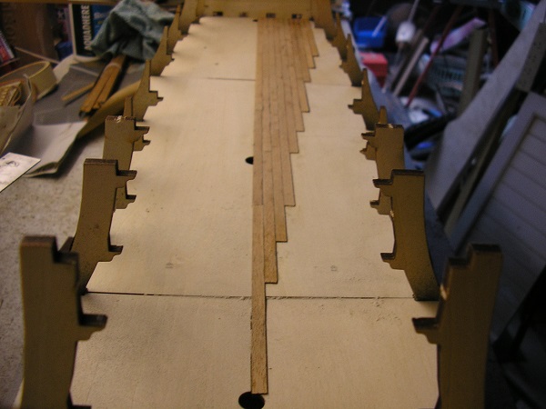

Issue #16 Gallery now completed. These must have made the ship heavy in the stern. Looking at the photo I need to tidy up my bench.

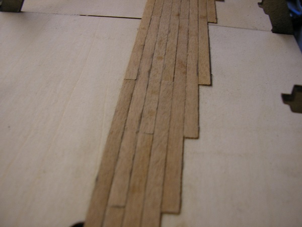

As stated in a previous post I am closing the gun ports on the lower deck and having complete cannon on the next.So the first step is to plank the second deck this will encompass modification to either the new gun carriages or the wheels.

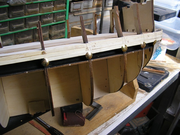

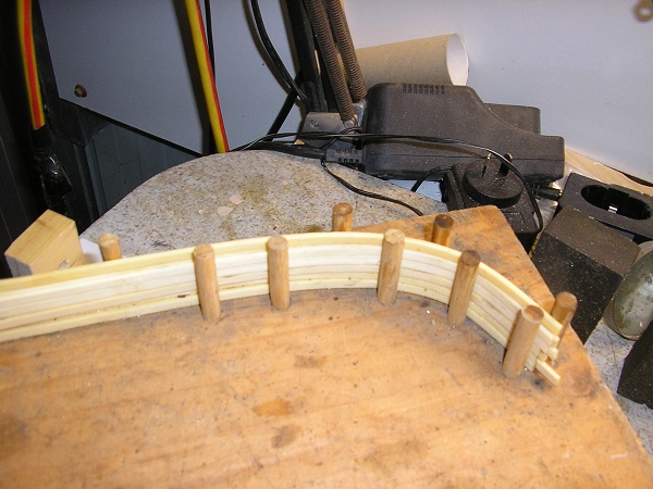

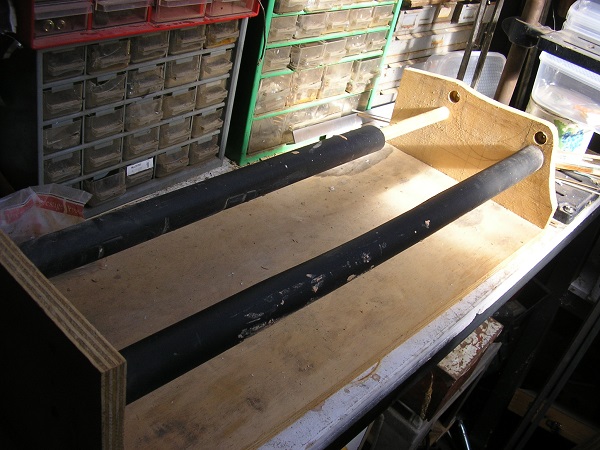

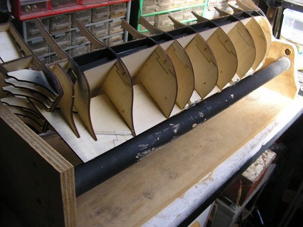

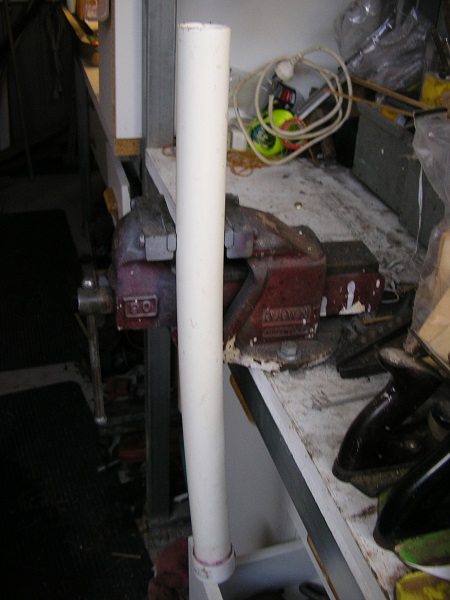

Started on the planking. I don't like crimping the planks so use boiling water. The first and second photos of the jig which I use to hold the hull, this has been used on three or four models already. The next shows the capped poly tube I use to soak the planks and the final photo shows the bending jig the wet planks are placed in till they dry.
Tried nailing the planks on the stern the bamboo is too tough will buy a drill on Monday.

#70 Posted : 12 July 2014 09:48:16
Coming along nicely Jock, love the build cradle and bending jig... Cool Cool .. With the bamboo think you will find most of use predrilled prior to pinning the planks, the bamboo has a horrible habit of splitting if you try to nail without predrilling even with wet planks.... Keep the posts coming....Cool Cool
bb1949
#71 Posted : 17 July 2014 09:23:38
Joined: 27/02/2014
Posts: 149
Points: 456
Gee I like that jig for the planks,Drool but how did you get the arc? Confused That is something I would like to try on my other build that is progressing to this point shortly. Any suggestions on achieving the desired shape is appreciated.
Also is it my imagination or do the planks swell slightly and then when dry shrink. I have in the past used soaked plants and a hot steam iron to shape the timber and find the next day a gap where there wasn't a gap the night before. Not that this worries me too much on the first layer but it does trouble on the next.
Brex1949
#72 Posted : 17 July 2014 23:31:21
Brex1949
Hi Gents, there are many ways of bending and shaping planks and yes Brex, soaking planks is likely to cause swelling and shrinking with each plank reacting differently, gaps are likely to appear as the planks dry out.... I didn't find any problems using the bamboo supplied and found my method of bending and shaping the planks worked very well for me.... If you flex the plank you will find the plank will bend easier in one direction rather than the other, always apply the bend the direction the plank bends the easiest. By holding the area of the plank to be bent over a steaming kettle and bending gently you will find the plank will bend quite quickly. Continue to check the shaping on the hull as you go applying more steam if necessary to carry out any corrections... When happy, pin the plank in place temporarily and leave to dry fully, ideally overnight... When the planks are dry then you can glue and fix in place. Also with bamboo, pre-drill the pin holes first and you should find splitting will be kept to a minimum... Lastly for me, the edges of the bamboo strips are rounded and I found by sanding the rounded edges off the planks, top and bottom resulted in a cleaner fit.
Hope this helps, if you have any queries or clarification then by all means get back to me...

jock
#75 Posted : 19 July 2014 06:31:57
Joined: 08/03/2011
Posts: 65
Points: 187
Location: Bendigo Australia
Thanks for the reply's first
The arc for the bending jig came from my Endeavor build, not quite severe enough but it is doing the job.
I allow a few days for the planks to dry completely before attaching them.
Thanks for the tip on the bending of the bamboo I hadn't noticed it before will take note now

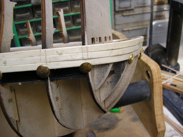

Tried using pins and small drill, gave up and I've gone back to using thumb tacks pressed into the frames.

Whizgig
#77 Posted : 20 July 2014 08:07:00
Joined: 19/07/2014
Posts: 209
Points: 580
Location: Delecombe, Victoria, Australia
It's looking very nice Jock.BigGrin
#78 Posted : 20 July 2014 08:52:06
BigGrin Hi Jim
Nice start on the planking
#79 Posted : 20 July 2014 09:47:15
Looking good Jock, thumb tacks work just as well in fact probably better... Instead of using a small drill bit, cut the head of a pin, insert that into your drill to drill the pin holes. Think you will find it will work just the same and it won't snap that easily either.. lot cheaper too...
