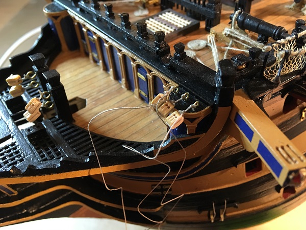

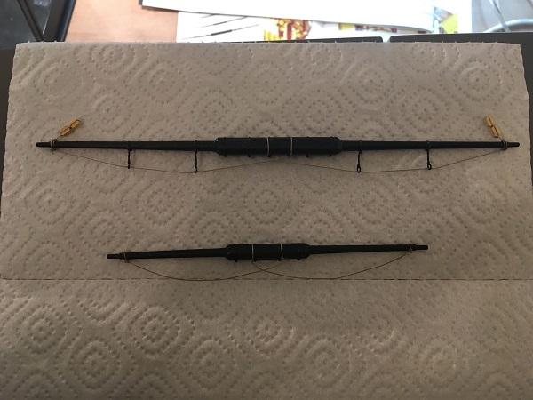

Just a small update:
I finished the last two yards for the spritsails as well as the boomkins.
Also i added footropes to the jibboom and flying jibboom.
So i finally achieved my goal to complete all the partwork until the end of this year - and i`ll be able to start the new one with the rigging.

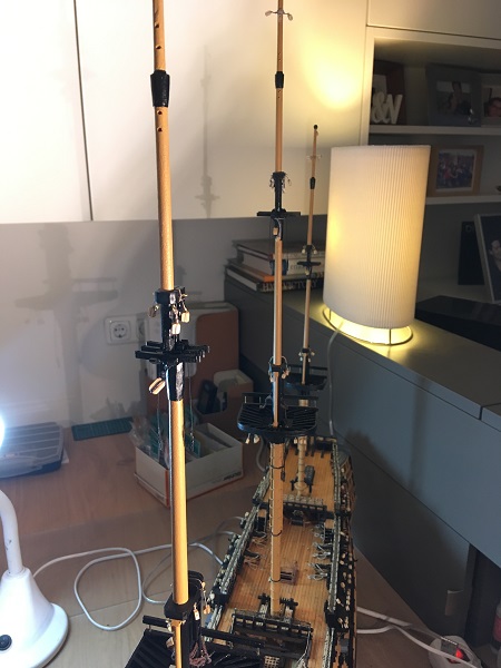

#769 Posted : 09 January 2019 12:13:59
Thanks for your nice comments!

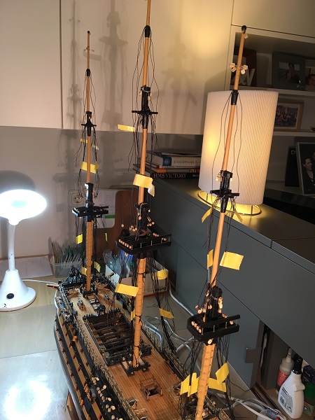

In the meantime i added all the Pendants (also the topmast ones).
#770 Posted : 09 January 2019 12:21:01

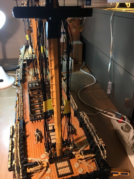

Then i attached the shrouds to the foremast - but when experimenting with how to add the deadeyes - the mast kept turning around.
So i decided to secure the masts to the hull a little bit earlier than suggested in the instructions.
This way i think i could achieve a straight alignment and upright Position of all the masts easier than after attaching all the shrouds

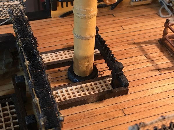

#771 Posted : 09 January 2019 12:23:03
As a little extra detail i added another mast socket to the mizzen mast at the quarter deck level (was quite fiddly to get it in the right position).

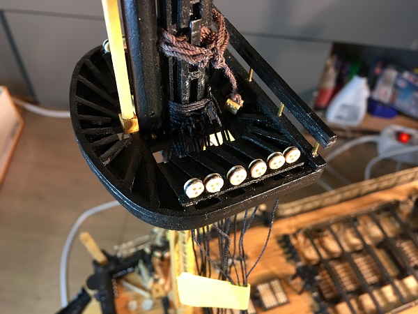

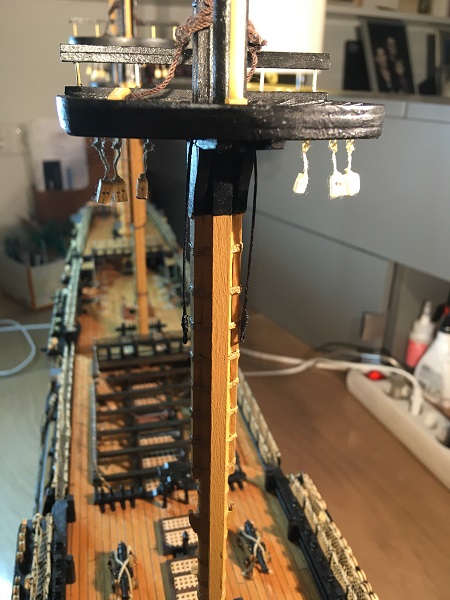

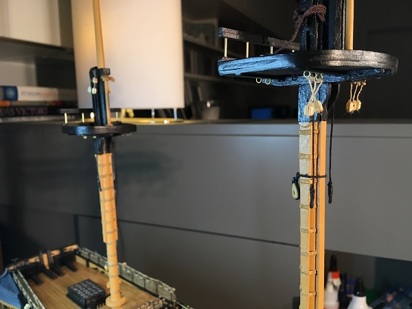

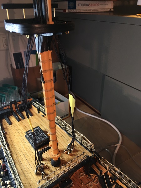

This is just so you guys don`t think i`m lazy. But although i spent many hours with my Vic one can´t see much progress!
So here are some pics of my shrouds with all the attached deadeyes.

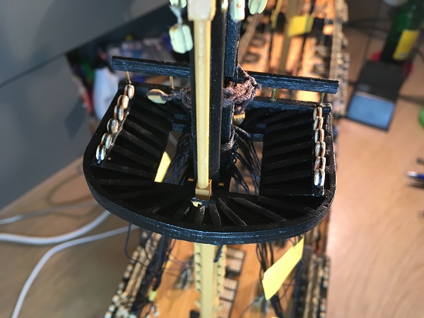

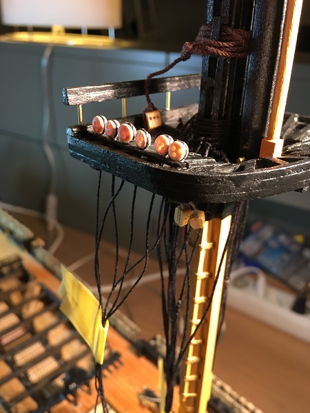

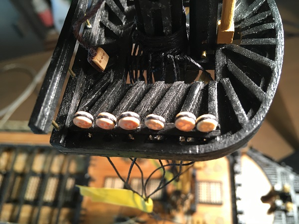

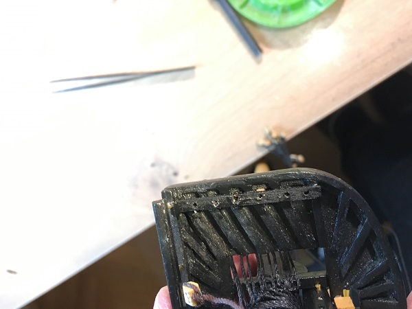

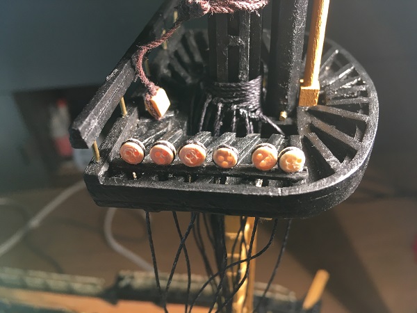

Next step was adding the deadeyes to the masttops.
But here i had a problem - as when applying Tension the deadeyes tended to turn and go between the little steps we built on the masttops.
So i came up with this solution:
I added a little wood strip and drilled the holes for the shrouds.
#777 Posted : 05 February 2019 14:36:56
Now i could thread all the shrouds through those new holes and through the ones we previously drilled into the masttops.
This assured that all the deadeyes are now sitting firmly at the same height and direction.
Maybe this helps if anyone has a similar problem.

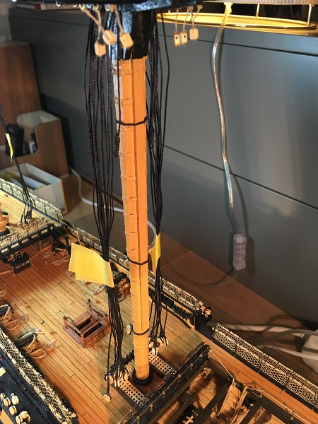

#778 Posted : 27 February 2019 14:03:49
Hi guys!
I finally attached all the shrouds (including the topgallant shrouds) to the three masts.

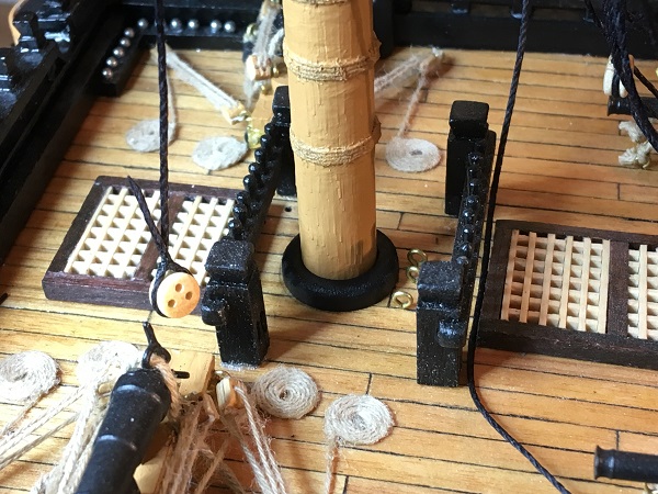

#779 Posted : 27 February 2019 14:08:08

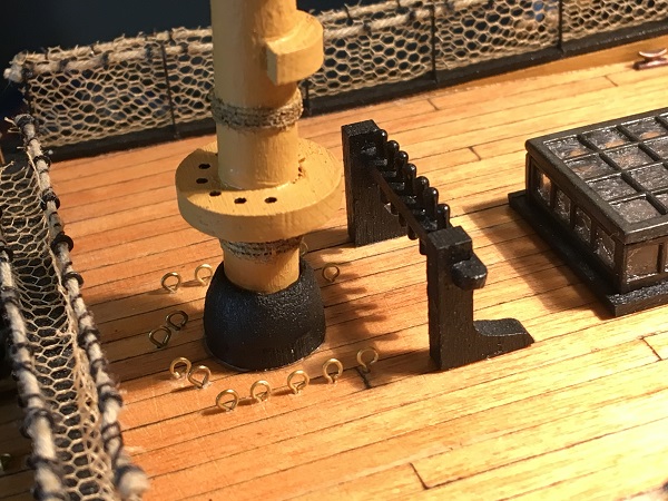

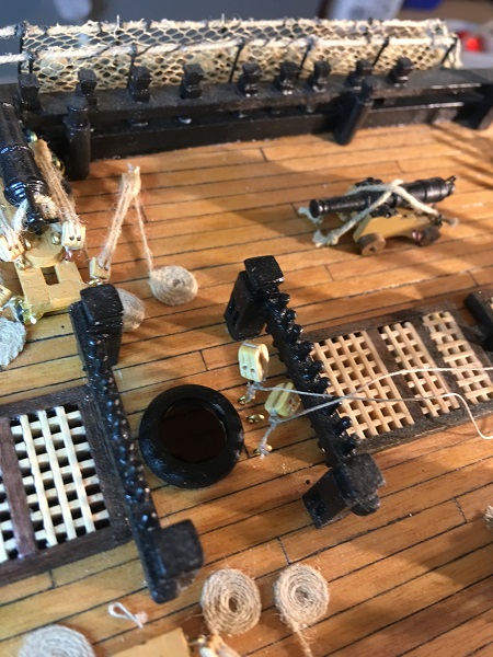

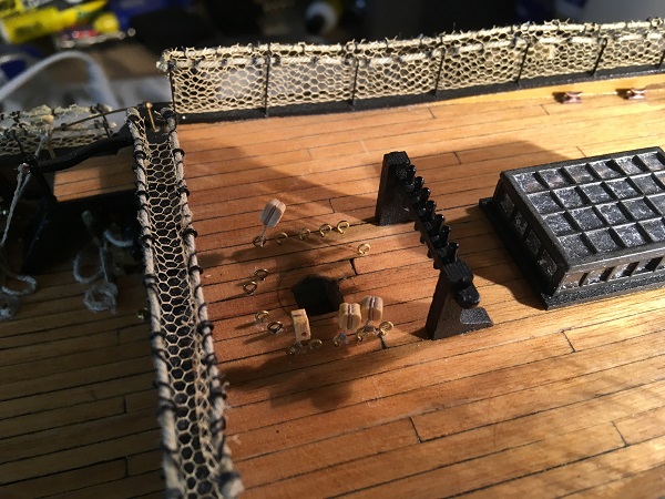

Before moving on i added a few blocks to some of the the eyebolts on the deck, as i want to add lashings to the stays instead of just binding them to the bolts.
I think i will now start producing all the gunport-lids - which i`m not looking forward to!!
