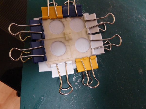

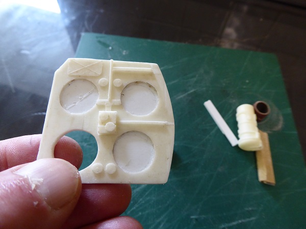

This weeks build log on my U230 U-boat will be looking at fitting the forward torpedo tube bulkhead. This bulkhead was an AMP from a German supplier and made of a very pliable, soft resin type plastic. Over the course of time it had become warped and there was a split near one of the holes for the torpedo tubes.
First job was to remove the side bulkhead that was attached to one side and has moulded cables on it. From there i fixed a 0.5mm thick backing sheet to reduce the warp effect on the torpedo tube bulkhead.
The attached photo shows the backing sheet clamped in place.

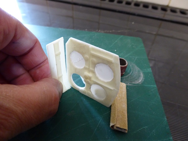

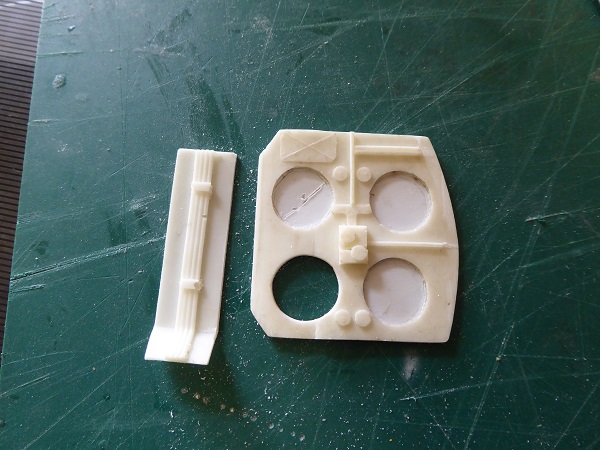

This photo shows the side bulkhead removed. Also, one of the holes for the torpedo tubes has been cut out after the backing sheet was fixed.
#771 Posted : 08 June 2017 20:29:22
This photo shows the position of the side bulkhead.

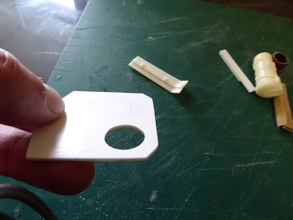

This photo shows the backing sheet trimmed to shape.

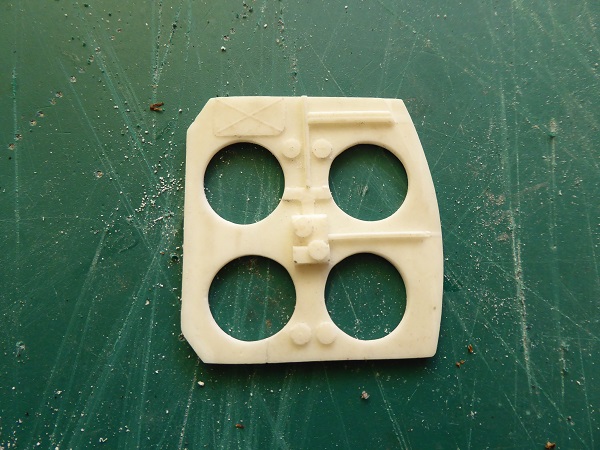

Another photo showing the torpedo tube bulkhead.
#774 Posted : 08 June 2017 20:32:43
Bulkhead with all cut-outs completed.

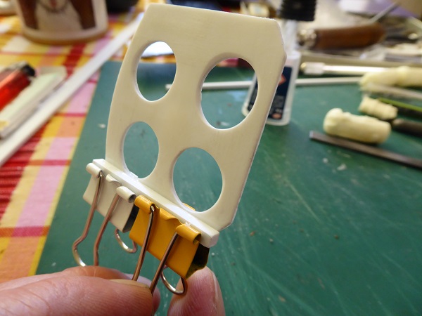

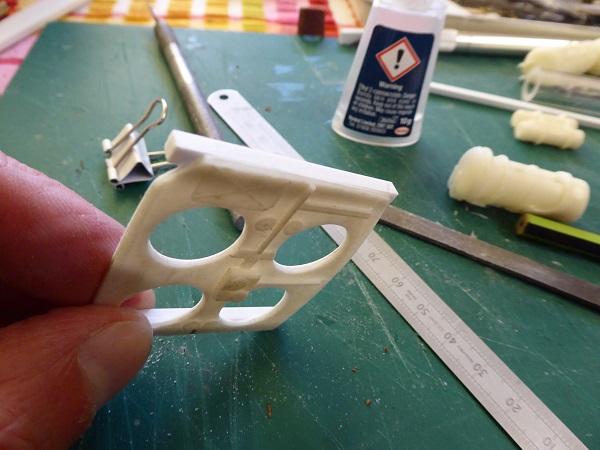

I then fixed 2.5mm square strip to the backing sheet, top and bottom. These strips have two functions; one, they add strength and reduce the warp effect and two, act as guides when fixing the bulkhead to the inside of the U-boat.
This photo shows the lower strip being clamped in place.
#776 Posted : 08 June 2017 20:36:36
Lower strip fixed.

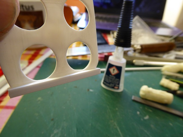

#777 Posted : 08 June 2017 20:38:29
Upper strip fitted.
#778 Posted : 08 June 2017 20:39:29
Another photo showing the upper strip fitted.

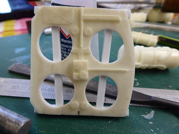

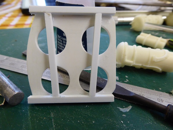

The next step was to add further strips running vertically. Again these serve a dual purpose in that they strengthen the bulkhead and act as a buffer for the torpedo tubes to butt up against.
As the tubes themselves are off-set with the upper tubes having a wider spacing than the lower ones, I built the strips to run through the centre line of each upper and lower pair, forming a vee shape.
This photo shows both vertical strips fitted, looking towards the backing sheet.
#780 Posted : 08 June 2017 20:48:03
Looking from the bulkhead side.
