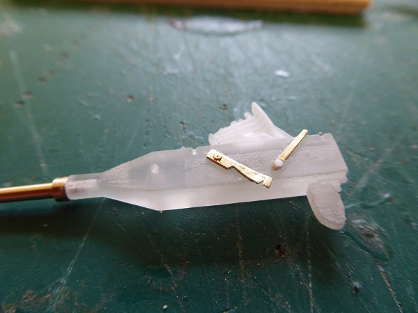

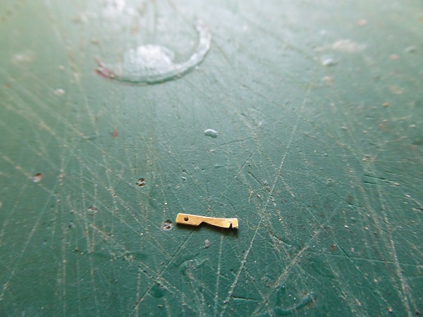

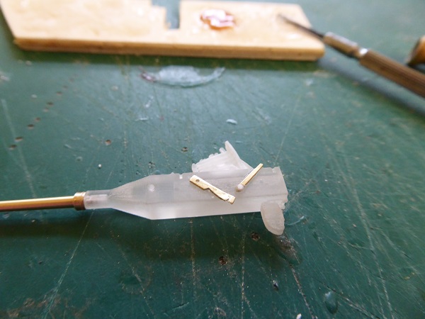

#744 Posted : 08 March 2019 00:24:26
I then made a locking lever in a similar fashion using a scrap piece of brass filed to the correct profile.
#745 Posted : 08 March 2019 00:25:00
Locking lever fixed in place.
#746 Posted : 08 March 2019 00:26:57
I then added further detail to the locking lever by drilling through it with a 0.5mm diameter drill and inserted a small rivet to represent a pivot point.
#747 Posted : 08 March 2019 00:27:31
Rivet in place on the locking lever.

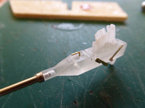

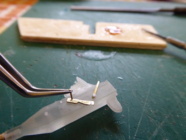

Further detail was added to the top of the gun using 0.5mm diameter brass rod, bent to shape.
#749 Posted : 08 March 2019 00:31:59
I then made a 'stop' for the cocking lever by drilling through with a 0.5mm diameter drill and inserting a small rivet.
The end of the tweezers in the photo point to the 'stop'.

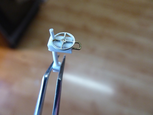

#751 Posted : 08 March 2019 00:38:54
The control surface handwheels were made using various pieces of plastic strip and rod filed to shape with further detail added from 0.5mm diameter brass rod for grab handles. Finally, etched after market hand wheels were fixed in place with small rivets.
In this photo is the first of the completed scratch built control surface handwheel alongside the printed version.

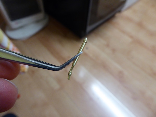

The next job was to replace the cardan shaft which transmits drive between the gun body and its turntable.
The attached photo shows the printed cardan shaft removed from the gun body.

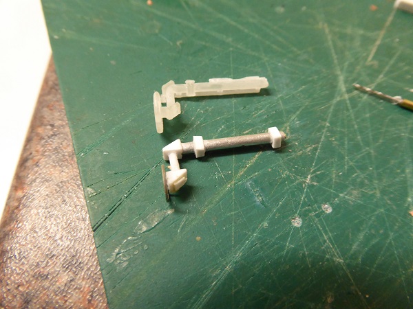

#753 Posted : 08 March 2019 00:44:55
I used 1.5mm diameter brass tubing, drilled through to open its internal diameter to 1.0mm and chopped this into three pieces. One longer and two shorter to represent the universal joints.
I then inserted a length of 1.0mm diameter brass rod through the three tubes and bent it to shape.

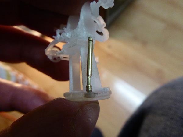

#754 Posted : 08 March 2019 00:45:27
Cardan shaft in place.
#755 Posted : 08 March 2019 00:46:31
From another angle.

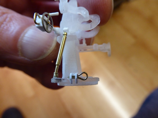

#756 Posted : 08 March 2019 00:49:10
Moving on, i made two brackets and a locking pin for the turntable from plastic sheet and brass rod bent to shape.

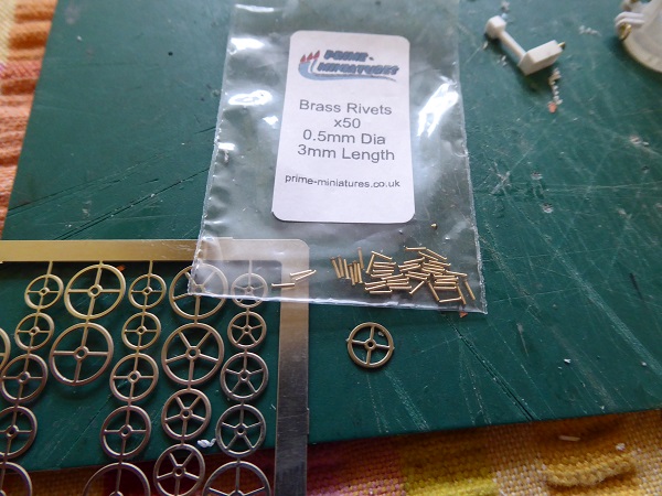

This photo shows the after-market rivets and handwheels I've been using.
#758 Posted : 08 March 2019 00:52:02
This photo shows the second of the scratch built control surface handwheels.
#759 Posted : 08 March 2019 00:53:58
This photo shows the third and final of the scratch built control surface handwheels alongside the original printed version.
