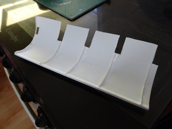

I then carried on in this fashion for No.3 template only realise that the shell was being thrown out by these curved supports. No3. template was now too far over to the open edge, totally throwing out the alignment of the curve!Cursing.
Furthermore, i had booked a day off to concentrate on this section with high hopes of making progress, only to end up with 6 curved supports that weren't working after 6 hours of filing bits here and there!Mad
So, the next evening i removed them allBlink and decided to start again with a fresh perspective.

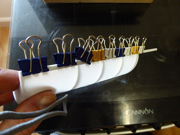

The first job was to add strength to the shell so that i could properly gauge it's fit and work from there. I glued a 3mm square strip along the edge that's closest to the opening. Using clips to hold and align it correctly i could glue it accurately.
This photo shows the strip clipped in place.
#742 Posted : 31 May 2017 23:42:10
Strip fitted.

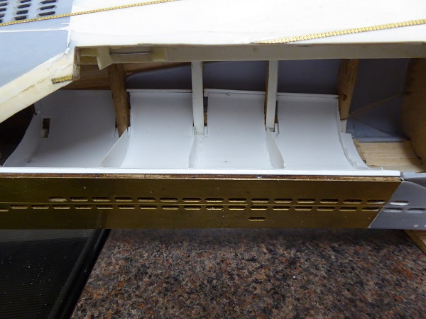

The shell being test fitted. The strengthening strip along the edge worked a treat and provided plenty of support for the shell.

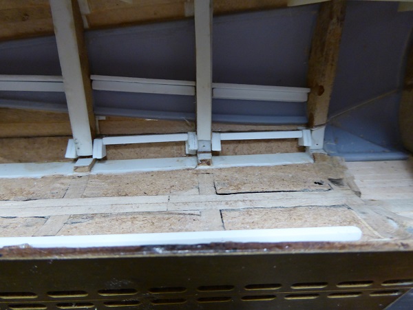

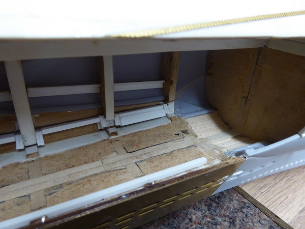

I then realised that the extra size cut outs i had made in the shell, to allow for the vertical frames, would allow me to measure with more accuracy the size of the supports to fit the underside.
I pushed a 4.0mm x 2.0mm strip through the gap and marked on it where the natural curve of the shell was. I now had a plan!BigGrin
Once cut, i glued it to another piece to really widen it out and offer maximum support for the shell. This was a much quicker process than i had with the curved supports mentioned before.
This photo shows the first support made and ready for fitting.
#746 Posted : 31 May 2017 23:54:12
More of these shell supports fitted.
#747 Posted : 31 May 2017 23:55:40
All shell supports fitted in place.
#748 Posted : 31 May 2017 23:57:41
The shell being checked for fit and alignment.
#749 Posted : 01 June 2017 00:00:04

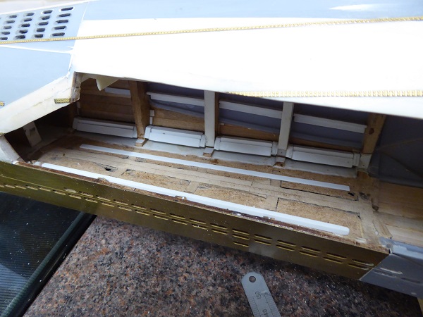

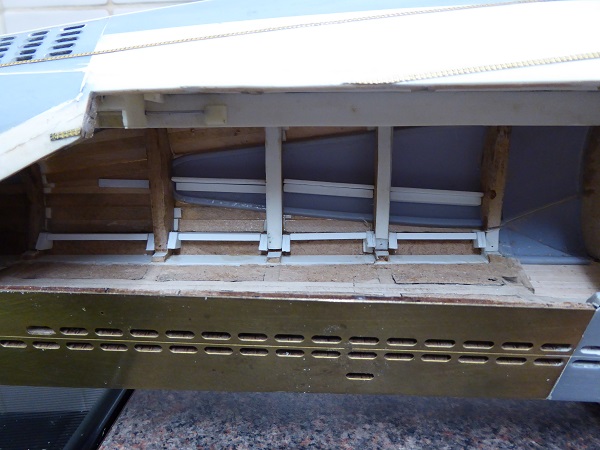

I then glued horizontal supports inbetween the hull ones to add extra strength.
#750 Posted : 01 June 2017 00:01:18
All horizontal strips fitted.

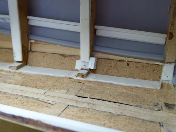

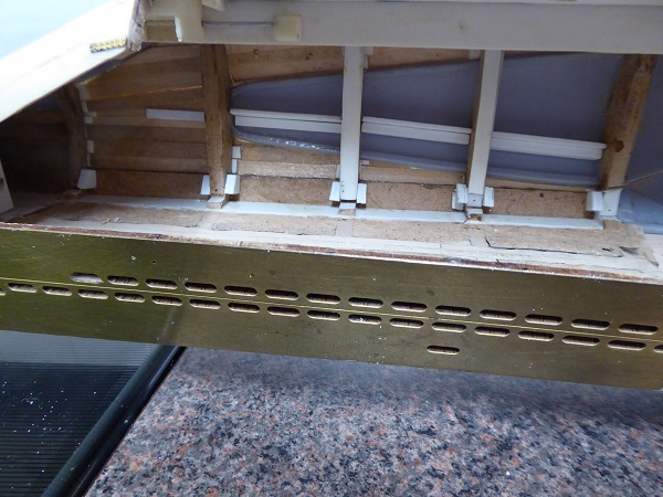

#751 Posted : 01 June 2017 00:03:33

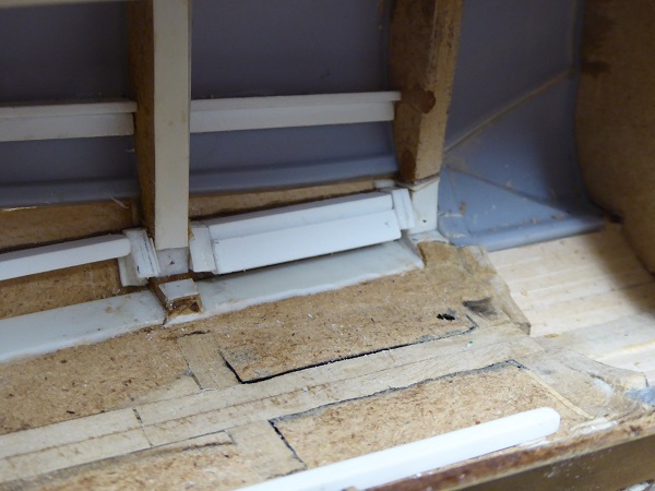

I then fixed strip, again inbetween the hull supports, but this time they matched the angle of them to provide anchor points for the shell.
This photo shows the first one in place.
#752 Posted : 01 June 2017 00:04:37
A close up of the angled support.
#753 Posted : 01 June 2017 00:07:38
This photo shows all angled supports fitted and also two, long runners fitted along each side of the centre line to fit underneath the shell.
#754 Posted : 01 June 2017 00:14:33

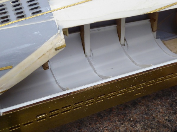

After many trial fits of the shell /hull, i was happy that everything aligned and was being properly supported. Before fitting the shell, i removed as much as i dare of the internal semi-circular templates as they had now done their job. Leaving a small section of each, they would still maintain the hull curve while the glue cures.
The idea being that when the glue dries i can proceed to file the remainder of the templates away leaving a nice, smooth curve.
This photo shows the templates cut right back, but still maintaining the curve.

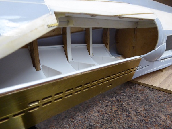

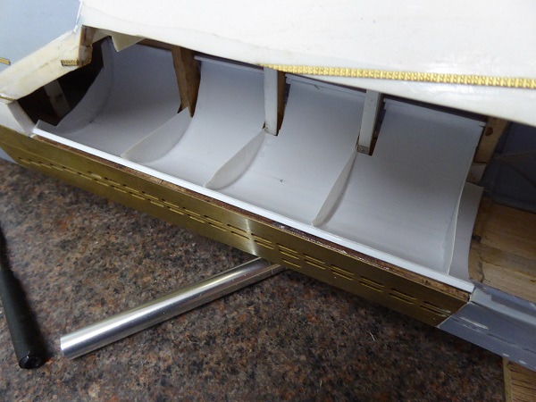

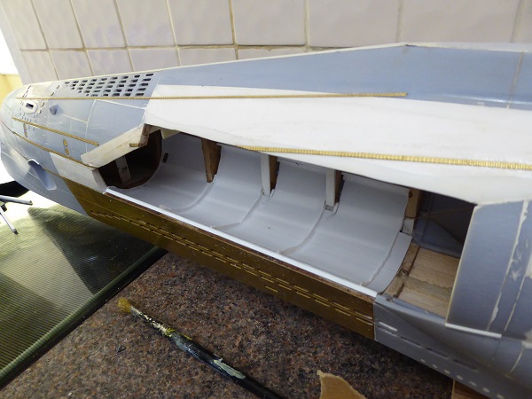

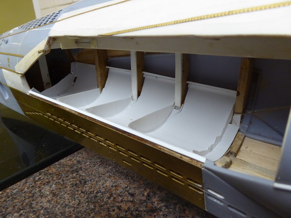

#755 Posted : 01 June 2017 00:15:34
The hull having it's final trial fit.
#756 Posted : 01 June 2017 00:16:49
The hull in place prior to removal for gluing.
#757 Posted : 01 June 2017 00:17:52
Again, the hull prior to gluing.

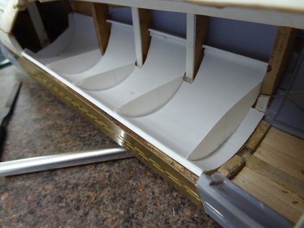

#758 Posted : 01 June 2017 00:28:47
I then removed the hull, applied liberal amounts of PVA on all of the hull supports and refitted it. I ran a bead of cyanoacrylate along the open edge to act as a tack weld and hold the hull correctly while the PVA cures. I also placed small nuts and bolts in the bottom of the curve to ensure it's apex makes contact with the mdf underneath and the long running supports.
Once all of that is dry, i will file away the remainder of the semi-circular templates i mentioned before. I can then fix a 0.5mm thick piece of plastic sheet on the inside of the shell/hub to make it really strong and robust. It will then be ready for the t-frames, fixtures and fittings.
All of that work will be spread over the next two updates.
Thanks for looking in and happy modelling!BigGrin
