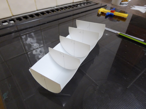

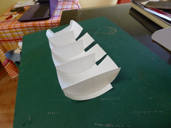

All templates fitted.

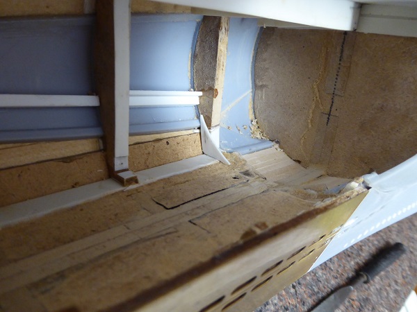

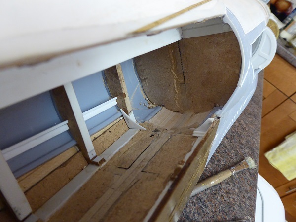

I then had to remove sections of it to accommodate the vertical mdf supports. The cuts were rough but at this stage i just wanted to gauge how it looked and work out how i was going to strengthen and support it. Confused
The attached photos show were i had cut.

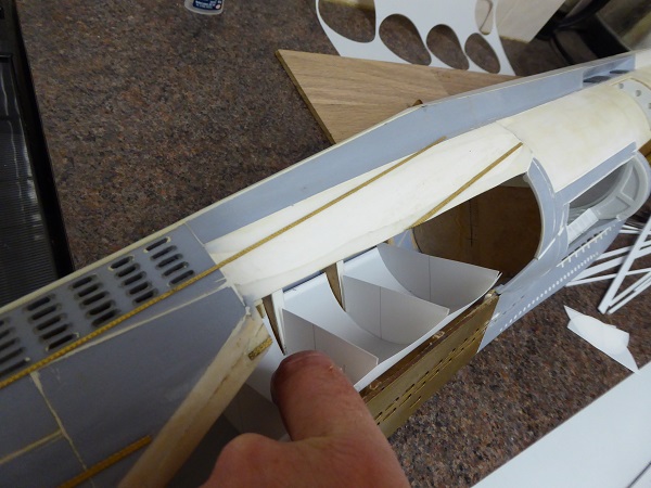

#723 Posted : 31 May 2017 22:54:27

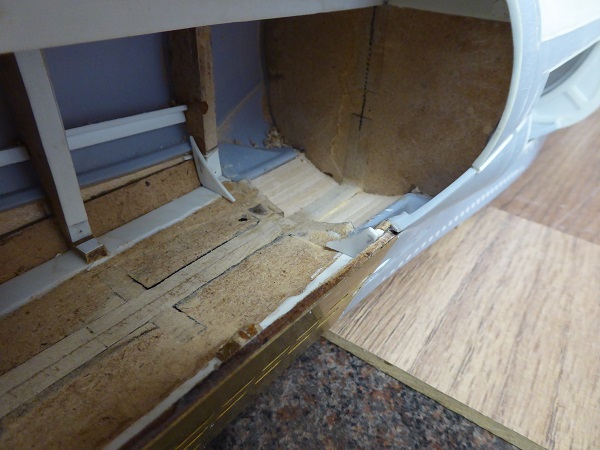

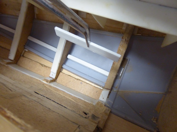

Once i had the shell sitting about right within the torpedo compartment, i marked it's edge onto the inside of the planked hull. I proceeded to glue in plastic strip along that mark so that the edge of the shell had something to butt up against.
The attached photo shows the strips being fitted.

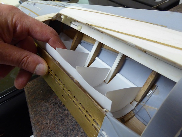

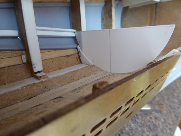

#724 Posted : 31 May 2017 22:56:22
This photo shows the shell being test fitted with it's edges butted up against the strips.
#725 Posted : 31 May 2017 22:57:54
Test fitting the shell.

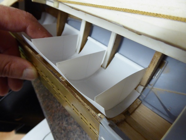

#726 Posted : 31 May 2017 22:58:49
Another angle showing the shell and support strips.

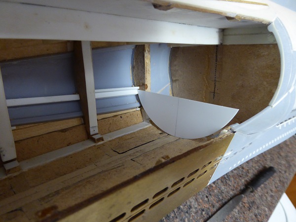

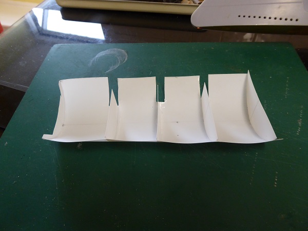

By using the other half of the semi-circular templates, i could butt them up against the supports and begin to gauge the shape and size of the supports to fit underneath the shell.
This photo shows No.1 template being positioned.

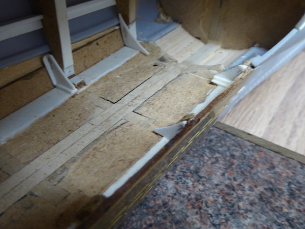

#730 Posted : 31 May 2017 23:12:11
This photo shows one of the supports to fit under the shell where No.1 template is positioned. This piece, although simple looking, took nearly an hour to make. I had to continuously offer it up against the template to obtain the correct profile, while both were free floating and not fixed. Very time consuming!
#731 Posted : 31 May 2017 23:13:41
This photo shows the curved support and semi-circular template positioned in place
#732 Posted : 31 May 2017 23:15:41
I then glued the curved support in place.

Template being checked for fit.

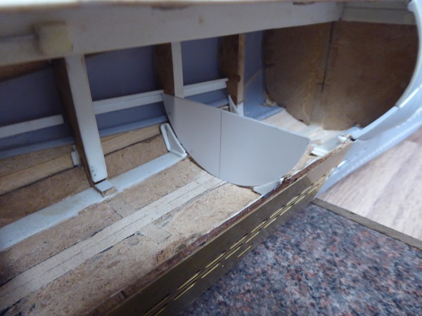

No.4 template being checked for fit against the curved supports.
#738 Posted : 31 May 2017 23:30:22
No.4 curved support fitted.

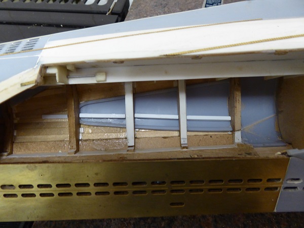

#740 Posted : 31 May 2017 23:32:43
Supports in place.
