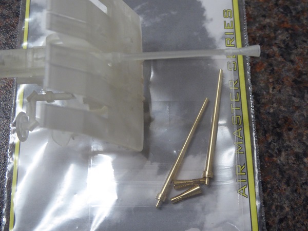

This photo shows the brass barrels alongside my 3d printed 3.7cm gun.

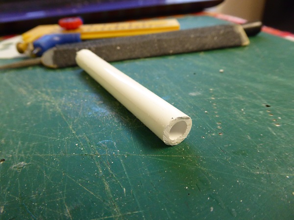

This week i started making the two water-tight ammunition canisters for the upper deck. They are smaller in diameter than those for the lower deck with added extra detail.
I used 9.5mm diameter plastic tube, bought as a 1 meter length, for the main body of the canisters as seen in the photograph.

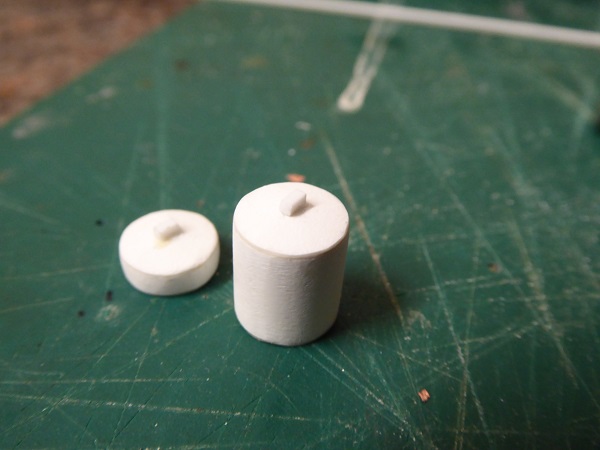

From this tube i cut two small lengths; one 2mm and the other 10mm to form the main body of the canisters. I then cut four plastic discs using the compass cutter from 0.25mm thick plastic sheet and topped and tailed the tubing with these to form cylinders as seen in the attached photo.
When the glue was dry, I filed the edges of the discs flush to the tubing.
#694 Posted : 22 February 2019 09:29:36
Using 2.0mm diameter plastic rod, i cut two 1.0mm lengths and fixed these to the top of each cylinder.
#695 Posted : 22 February 2019 09:31:40
The next step was to cover the top of the cylinders with Polyfilla and let it dry overnight. Once dry, i filed a taper from the top of the cylinders down to the edges.
#696 Posted : 22 February 2019 09:33:40

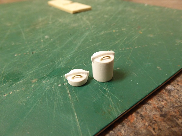

The next step was to fabricate the locking bars that hold the top of the canisters down. For this i started by using 1.0mm square strip, cut two pieces to 2.0mm in length and fixed to the centre of each cylinder.
#697 Posted : 22 February 2019 09:36:26
Using the 1.0mm square strip, i continued this down from the centre, leaving a slight overhang so i could file flush to the body. To make the catches i fixed 1.0mm x 0.5mm strip, cut to suit and glued to the ends of the 1.0mm square strip.
#698 Posted : 22 February 2019 09:38:46
The next step was to make two handles for the cylinder tops from 0.5mm diameter brass rod.
0.55mm diameter holes were drilled into the tops of the cylinders and the brass rod bent to shape.
#699 Posted : 22 February 2019 09:41:04
I have a little more work to do on these water-tight ammunition canisters; fitting hinges and making a surround for each. i'll cover these steps in next weeks update.
Meanwhile i took delivery of the brass gun barrels for the 2.0cm guns that will locate on the upper deck. PB Models of Poland is the supplier.
