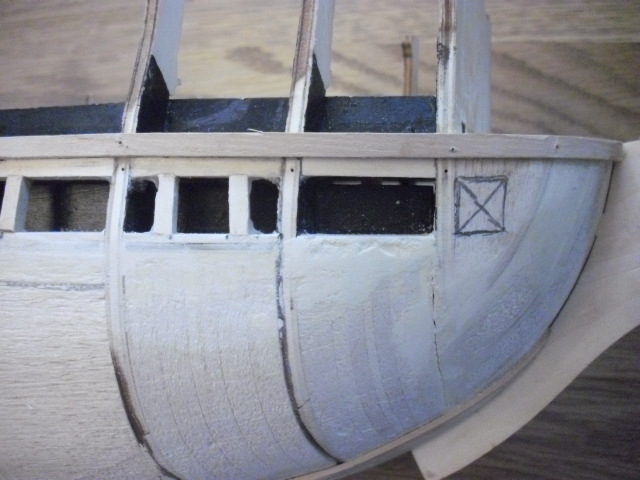

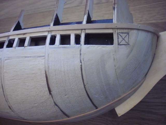

#671 Posted : 11 May 2013 12:08:23
13 GUN PORT (first deck)
I have just been reading my Sovereign of the seas by James Sephton, and what a great source of information it isBigGrin
On many of the illustrations it shows there may have been 13 gun ports on the lower deck --- Sergals model shows it to be there, also Culvers model is showing it.
I have decided to fit this gun port on my model, it will sit just behind rib 2, this will not interfere with the stem or involve me in any major changes on the model going forward.
Kind regards Mike

#675 Posted : 11 May 2013 12:36:05
THE 13th GUN PORT
I have attached a couple of photos of where I will site the port
Kind regards Mike

#676 Posted : 11 May 2013 12:49:41
This is an awkward one Mike,as you have it in your photo it will foul the prow.I was think of making the center of the port in the center if bulkhead two and then altering the angle of the prow edge so it just misses the top corner similar to what sergal have done.
Kind Regards Nigel
#677 Posted : 11 May 2013 13:26:06
Kind Regards Nigel
Hi Nigel, I am going to go for this position all the photos I have seen suggest the gun port is forward of rib 2 even Sergal`s however I think having a closed gun port is a good idea, it gives light and shade to the build, and will not interfere in my opinion to the bow or prow stemBigGrin Kind regards Mike

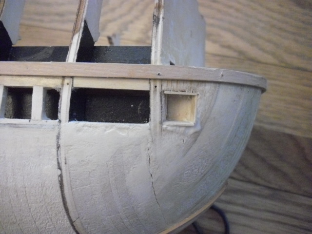

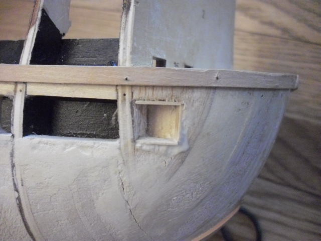

#679 Posted : 11 May 2013 13:32:41
THE 13th GUN PORT
Here I have cut the Gun ports in my desired position, with a first lining, when the adhesive is dry I will paint them Dull black
