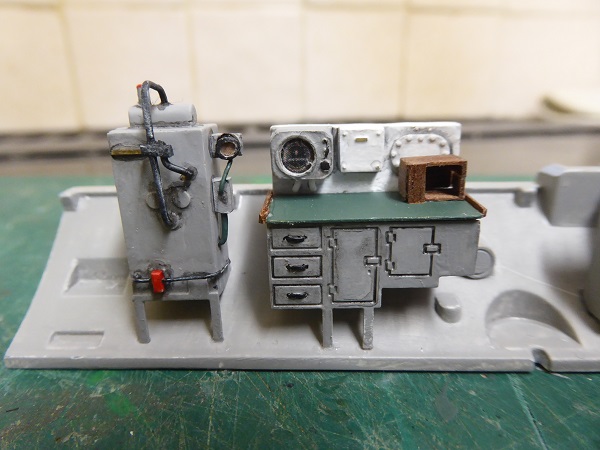

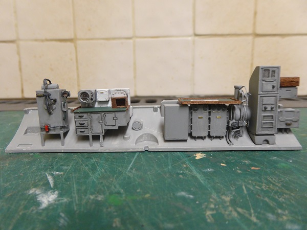

Both items i've described were then fitted to the their hull section.
#662 Posted : 29 July 2021 20:22:05

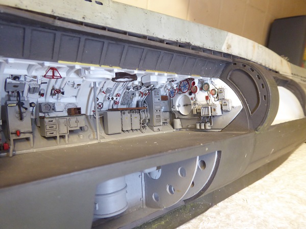

Full length view of this hull section showing all the equipment i've mentioned in the last few posts.
#663 Posted : 29 July 2021 20:22:27

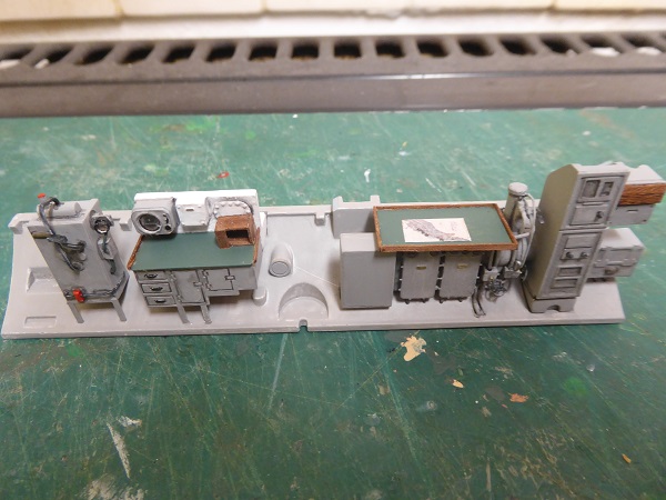

From above.
#664 Posted : 29 July 2021 20:23:31

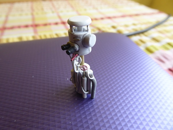

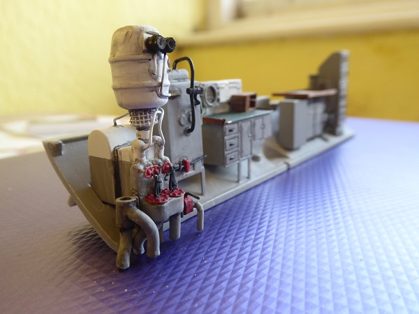

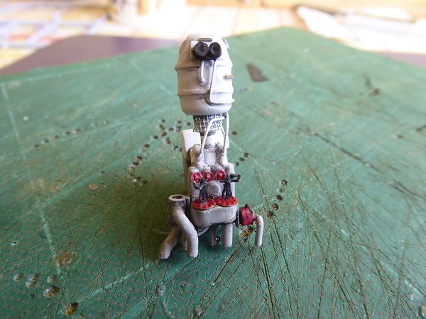

The attached photo shows the trim pump, enhanced with many scratch-built parts to bring it to life.
The trim pump is used to move water from one internal tank to another throughout the submarine to keep it level when dived.
#672 Posted : 05 August 2021 21:36:49

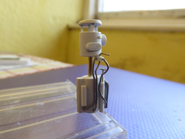

Looking from another angle.
#673 Posted : 05 August 2021 21:37:20

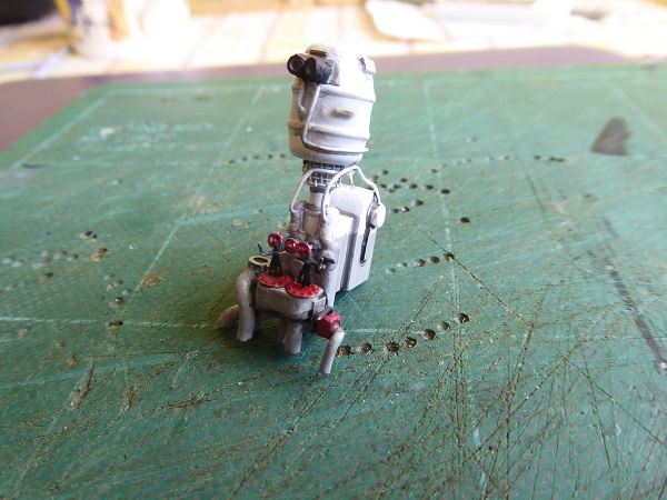

Trim pump fitted to the hull section.
#674 Posted : 05 August 2021 21:44:12
I then started on the ballast pump, again, adding many scratch-built parts. This pump will be fitted to the aft bulkhead once i have the deck plate fitted next week.
The ballast pump is used to pump water out of the submarine or bring water in. For example, if a torpedo is fired, the weight of the torpedo has to be compensated for and this is where the ballast would be used to pump sea water into the submarine into the torpedo compensating tank. When alongside, it would be used to pump out the sewage tanks and discharge to a tank on the jetty.

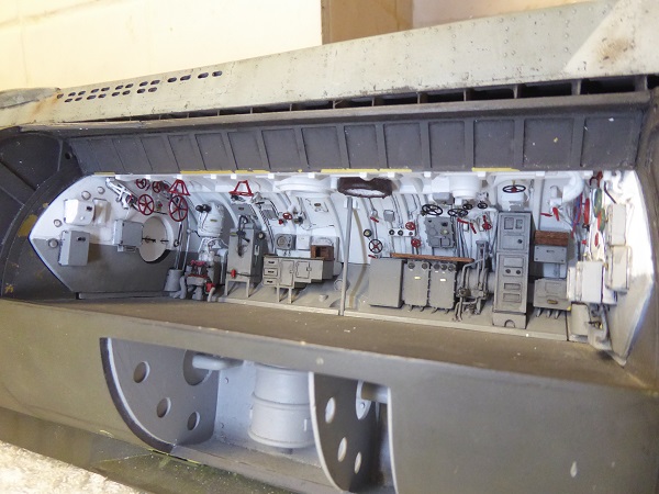

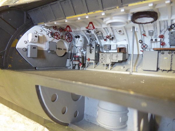

Now it was time to fit the forward and aft bulkheads, deck head and lower hull section into the Control Room and start to bring it to life!BigGrin Lots of fiddly work and nothing would go together straight away as a valve handwheel would catch or the pipes would be in the way, but eventually i got all the parts located and glued.
The attached photo is looking aft.
#677 Posted : 05 August 2021 21:48:56
Looking forward.
#678 Posted : 05 August 2021 21:50:09
Side view.
#679 Posted : 05 August 2021 21:51:16
