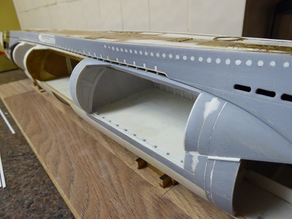

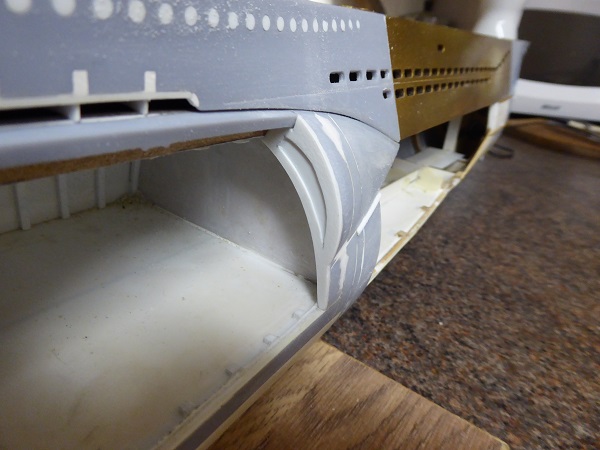

Another photo of the aft inner pressure hull strip fixed in place.
#662 Posted : 18 May 2017 07:53:55
Forward inner pressure hull strip located and fixed.
#663 Posted : 18 May 2017 07:55:24
The U-boat in upright position showing the forward inner pressure hull strip.

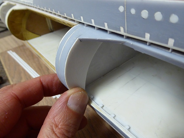

#664 Posted : 18 May 2017 08:04:12

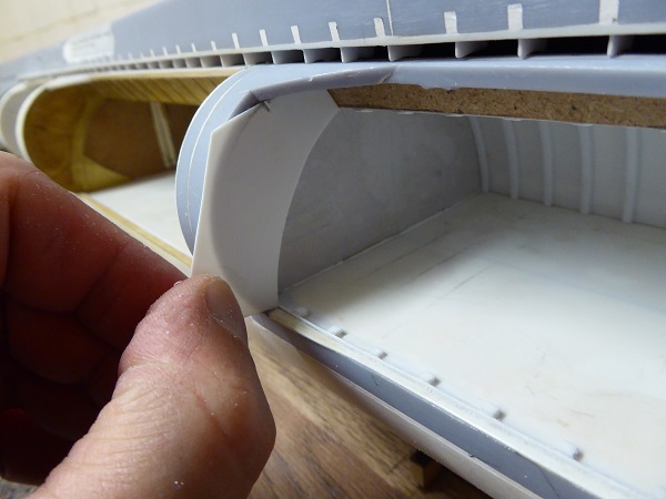

The next step was to make a profile piece from 0.5mm plastic sheet. The important part of this is to get the inner edge to align correctly. The outer shape of this piece will be filed to match the saddle tank later.
The attached photo shows the aft profile piece being test fitted.

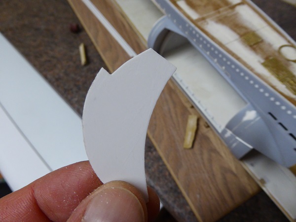

#665 Posted : 18 May 2017 08:06:24

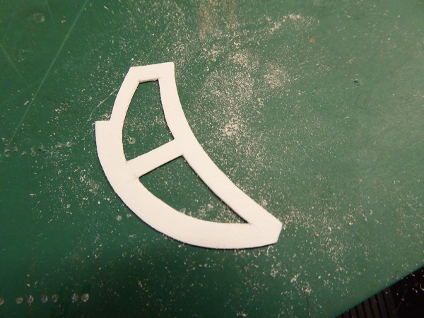

Once the inner edge aligned correctly I proceeded to shape the outer edge.
The attached photo shows the finished profile.

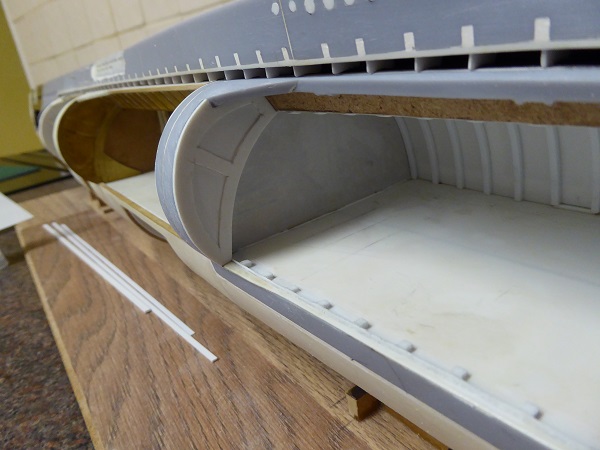

#666 Posted : 18 May 2017 08:10:10
The profiled piece being test fitted. It sounds like a very quick process when I write these words but there involved lots of test fits not to mention several versions. This was my fifth profile piece I made before I got it right.
#667 Posted : 18 May 2017 08:11:12
Another photo of the aft profile being test fitted.

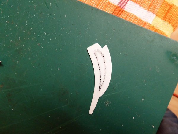

#668 Posted : 18 May 2017 08:13:15

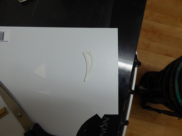

This photo shows the inner saddle tank shape being marked out ready for cutting.
#669 Posted : 18 May 2017 08:18:39
This photo shows the cut outs.
#670 Posted : 18 May 2017 08:21:16
I then glued this piece to another sheet of 0.5mm plastic to give it strength and also provide relief to give the impression that the tank has depth to match the other saddle tank profiles along the U-boats length.

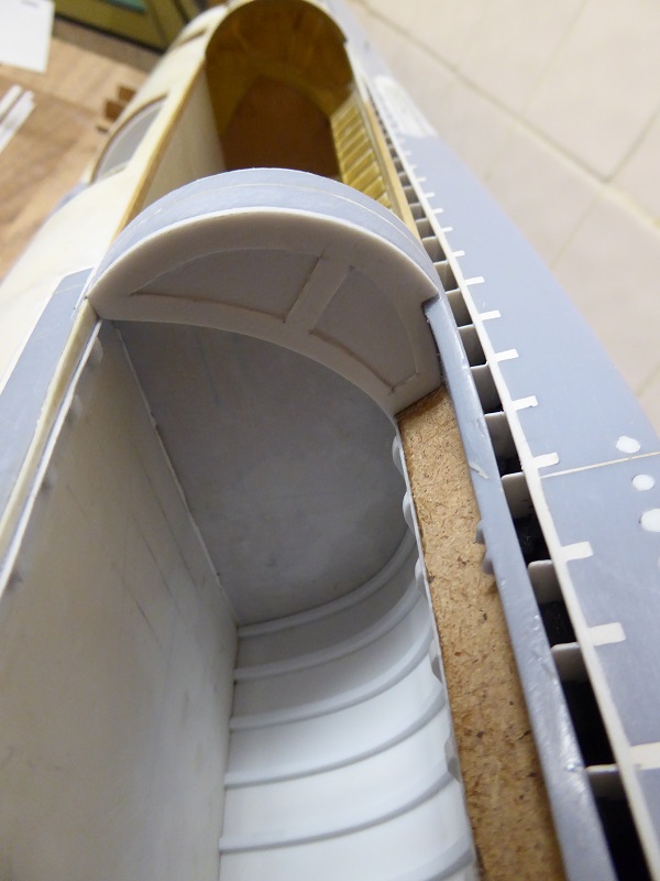

#671 Posted : 18 May 2017 08:23:36
This sheet was the filed to match the profiled one. This photo shows the completed, scalloped saddle tank end fixed in place.
#672 Posted : 18 May 2017 08:24:29
Another photo of the completed aft, saddle tank end.

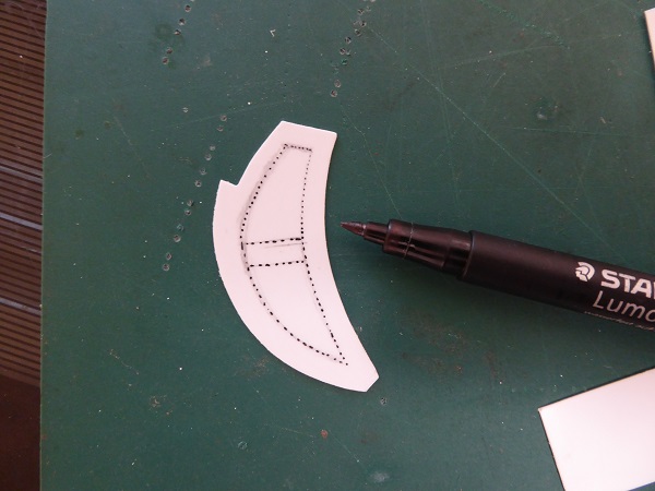

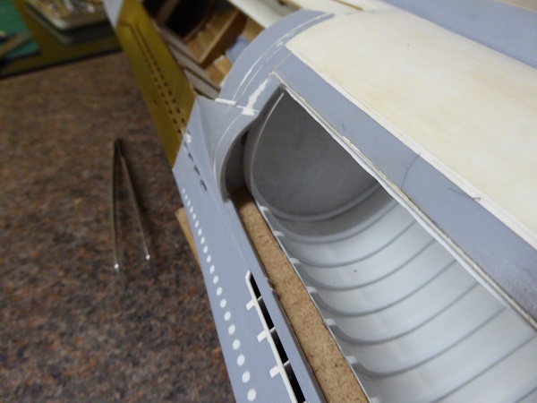

The same procedure was utilised for the forward saddle end. In this photo the profiled piece has been made and the inner tank marked. The piece is being test-fitted.

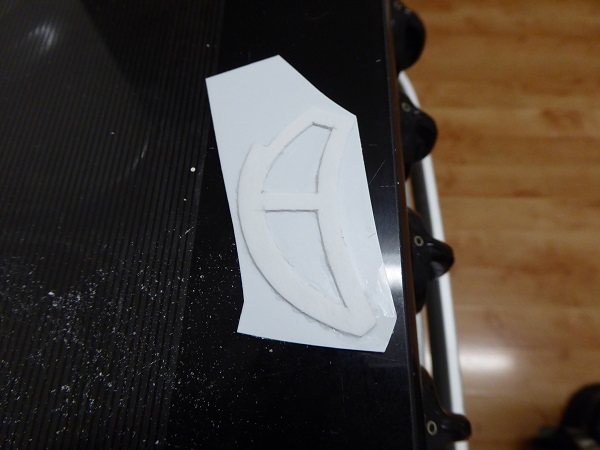

#674 Posted : 18 May 2017 08:27:24
The forward profiled piece with inner tank cut outs marked up.
#675 Posted : 18 May 2017 08:28:43
Inner tank cut outs removed and glued to the backing sheet.
#676 Posted : 18 May 2017 08:32:04
Completed forward, profile piece fixed in place.

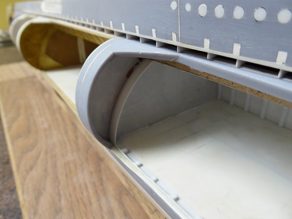

#677 Posted : 18 May 2017 08:33:21
Another photo showing the forward, scalloped saddle tank end in place.

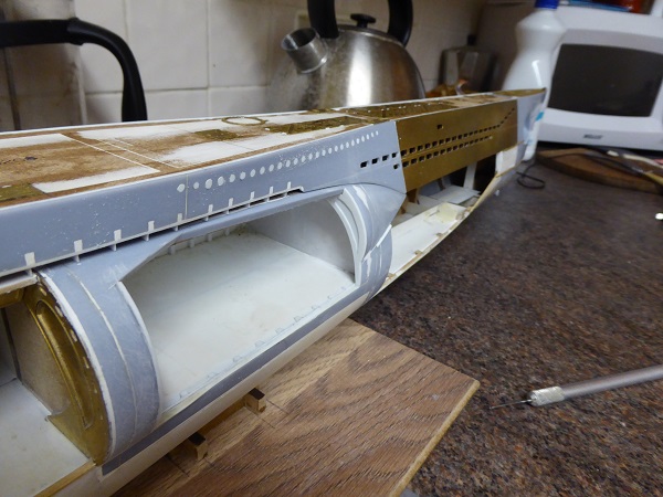

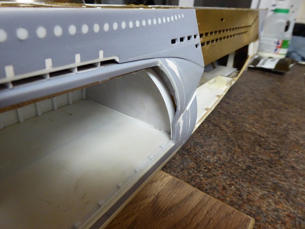

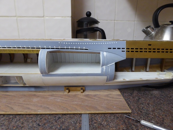

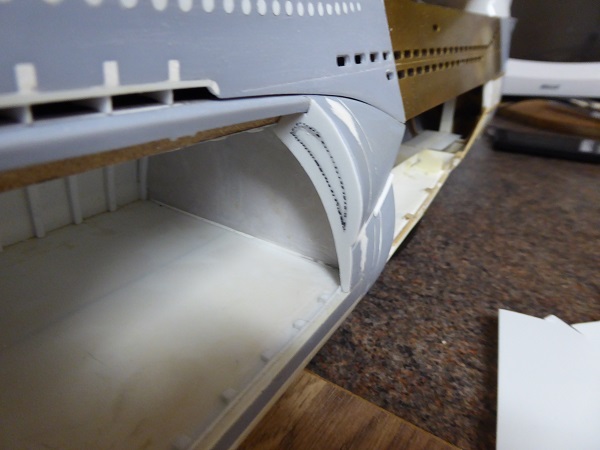

#679 Posted : 18 May 2017 08:34:20
An overall view showing the aft, profiled piece in place.
#680 Posted : 18 May 2017 08:36:07
An overall view of what will eventually become the Senior Rates Mess, Radio and Sonar shacks.
