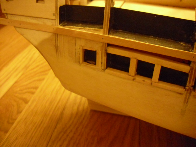

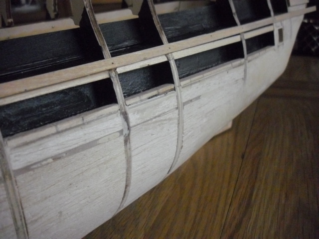

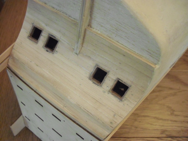

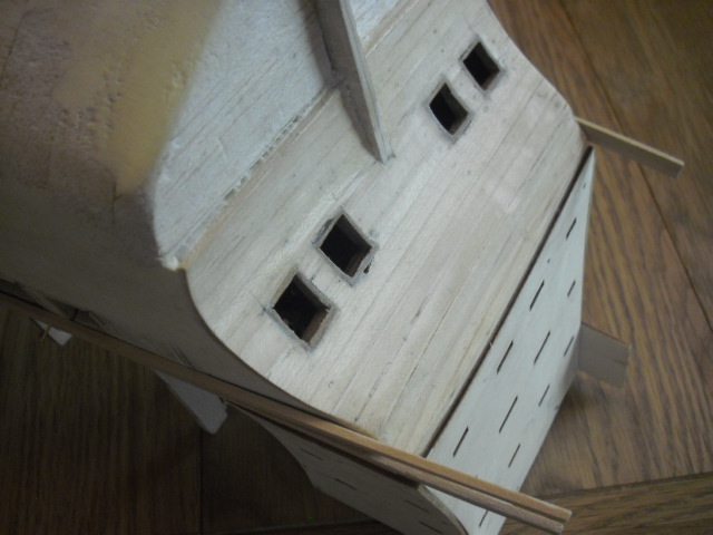

FRAMING THE GUN PORTS
I had decided early in the build not to plank and then cut the gun ports but to make a frame and plank up to the gun ports here is the start using 5mm x 2mm on the base of the deck, and the top and side frames 5mm x 5mm basswood. :- here are a couple of photos, thank you for looking in Kind regards Mike

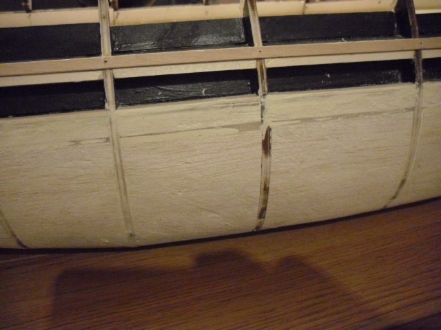

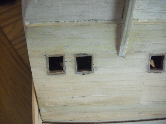

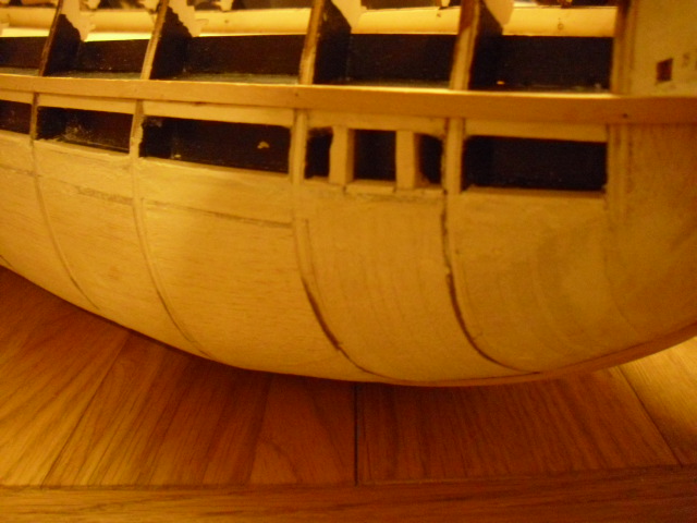

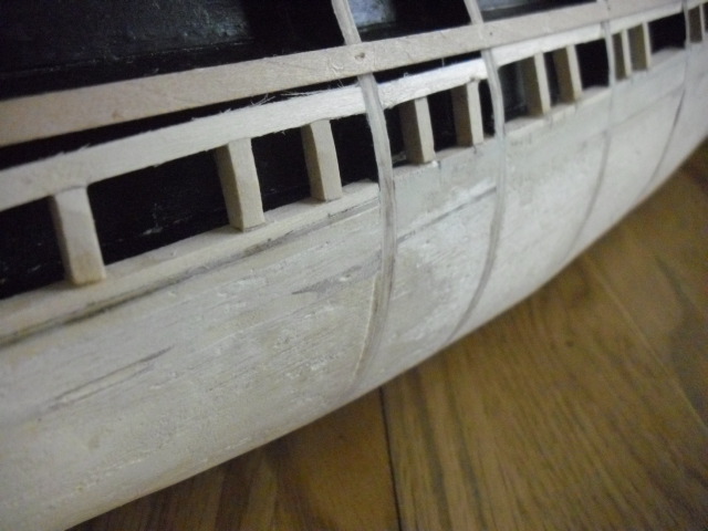

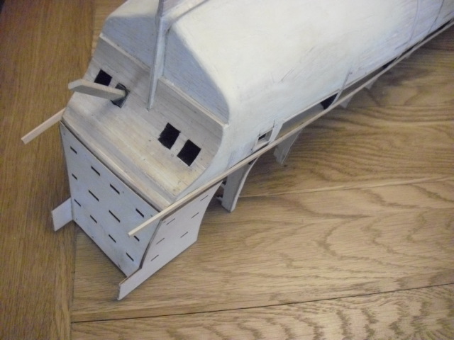

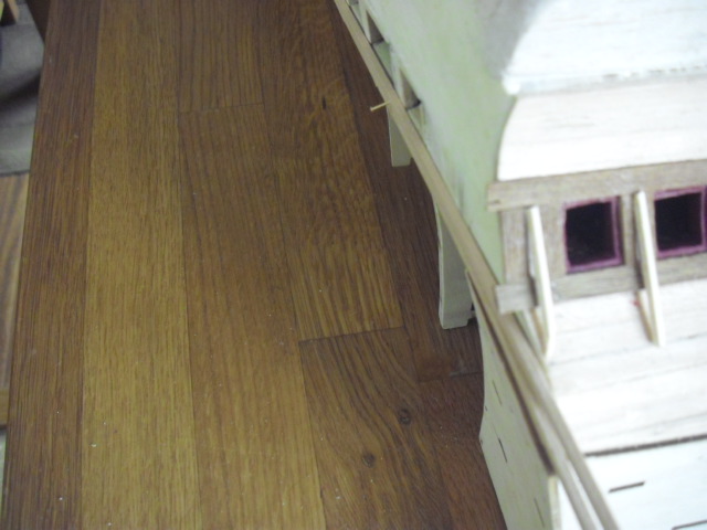

FRAMING THE GUNPORTS.
Hi I made a little more progressBigGrin I finished the lower deck on the starboard side, and got half way with the top baton on the Port.
Thanks for looking in Kind regards Mike

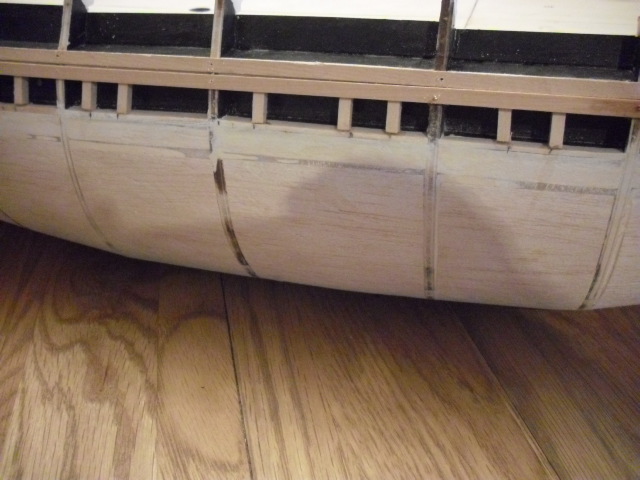

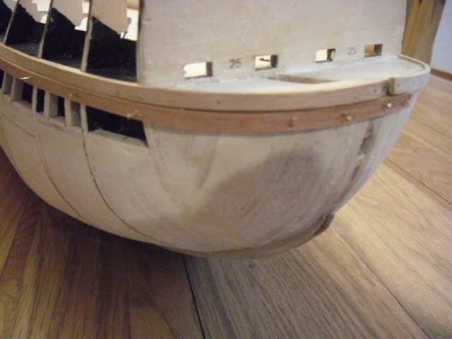

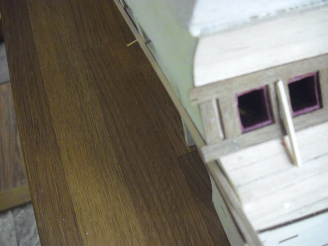

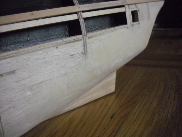

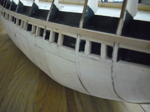

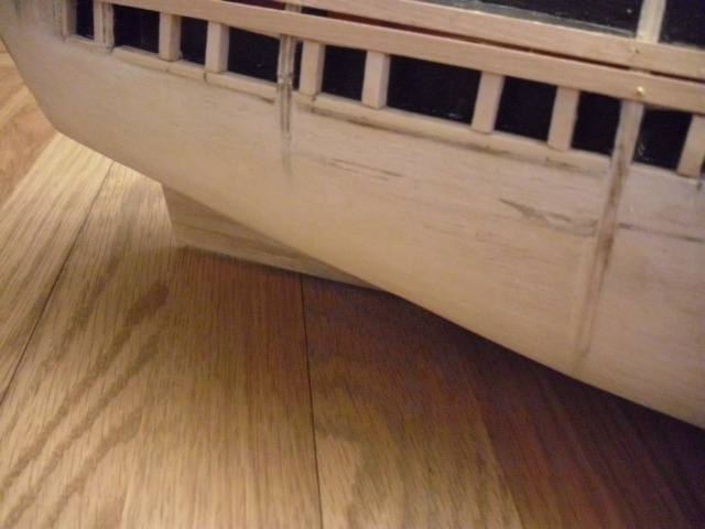

PLANK BENDING
I decided to bend a plank to go round the bow and down the side.
I soaked the part of the plank which comes in contact with the bow, and then I chose the best side and fitted it wet to the ship to dry for 24/48 hours, I drilled holes to take the pins.
Kind regards
Mike

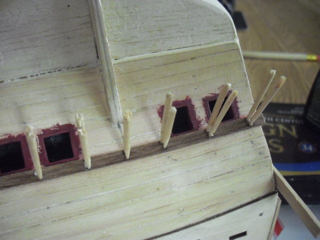

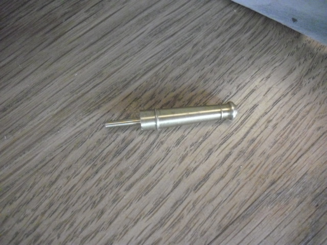

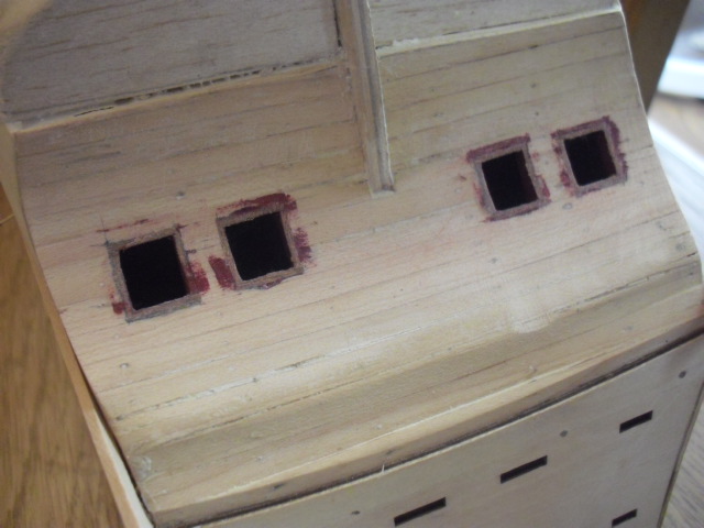

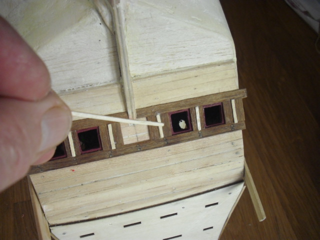

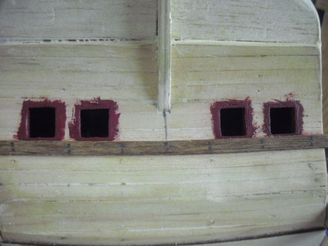

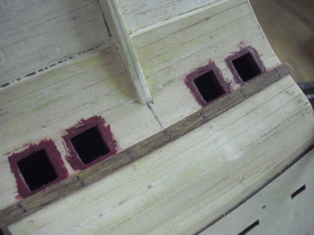

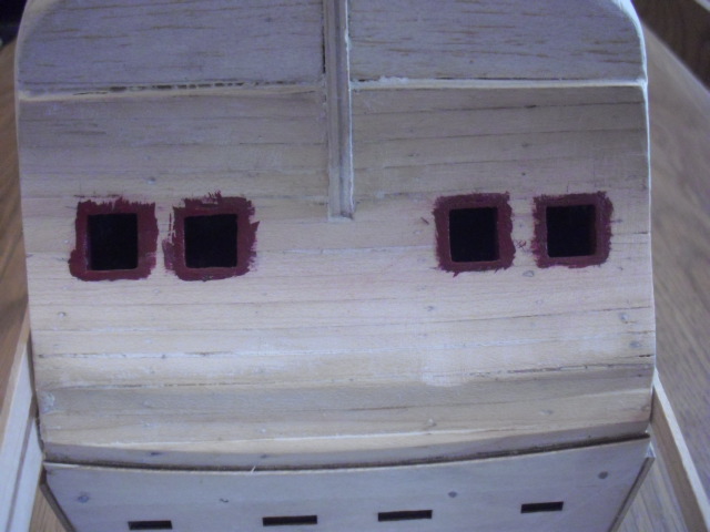

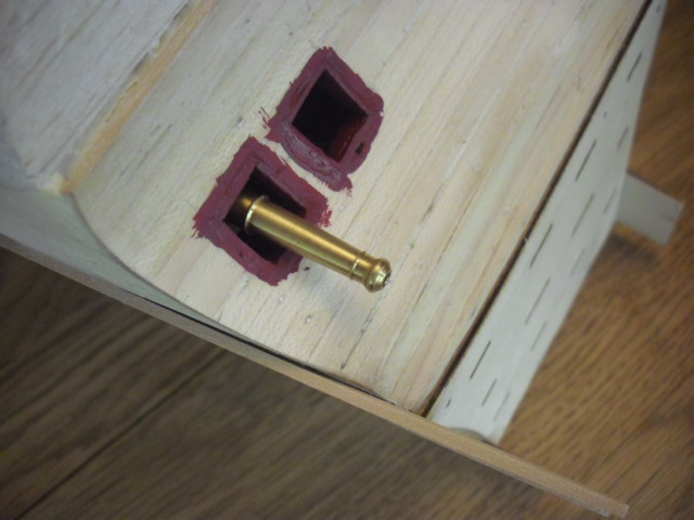

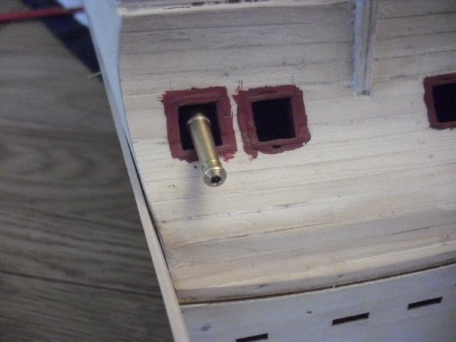

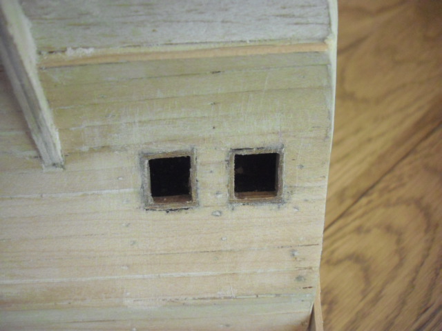

TRANSOM OPEN GUN PORTS MODIFICATION
To continue the modification, you will see from the photos I have lined the ports with 5mm x 1mm walnut sanded them flush, then painted the linings with my preffered colour -- Citadel Scab red.
You will see a dummy gun which I will use (this is the gun I sourced for the Victory Dummy 24 pounders ) I like the look of it and it fits well.
After the first painting I sanded the gun ports then painted a thin layer of Citadel paint once again, I hope the photos tel the story:-
Thanks for looking in thats all for this sessionBigGrin Kind regards Mike

#655 Posted : 05 May 2013 18:52:48
Hi Mike,BigGrin
Ref: my rear gun port post #642, I now see how it all pans out. I looked at the angle you were cutting the ports and now see the gun barrel straightens up when fixed to the rib behind it.
Yet another good lesson from a master.Cool Cool Cool

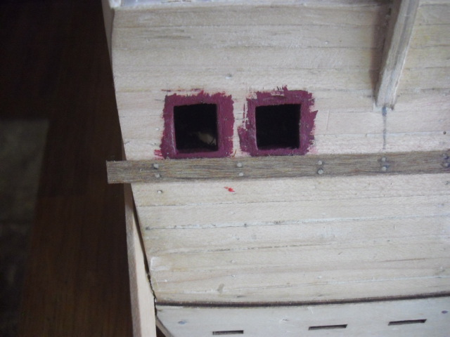

THE TRANSOM
After cutting the Gun ports, lining and painting them, it was time to lay the second planking in this area.
I have decided to give the transom a decoration which is my interpretation of how I wish it to look. I feel this ship was so full of colour and glitter that within reason anything goes.
I am planking in walnut and I have trenailed every 18mm, first I marked out with pencil then drilled .5mm holes and used cocktail sticks to achieve the desired effect.
I will be adding a .5mm plank (which has been coloured with red ink )between the walnut planks.
More later
Kind regards Mike

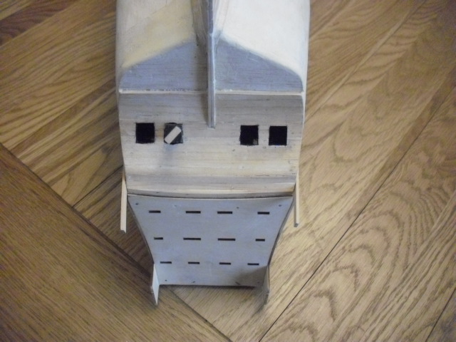

#660 Posted : 06 May 2013 17:47:43
TRANSOM AND STERN GUNPORTS
Here is an update of the work I started yesterday.
Still second planking in walnut and added strips of boxwood which will be sanded flat, then coloured and of course more trenailing to comeBigGrin Kind regards Mike
