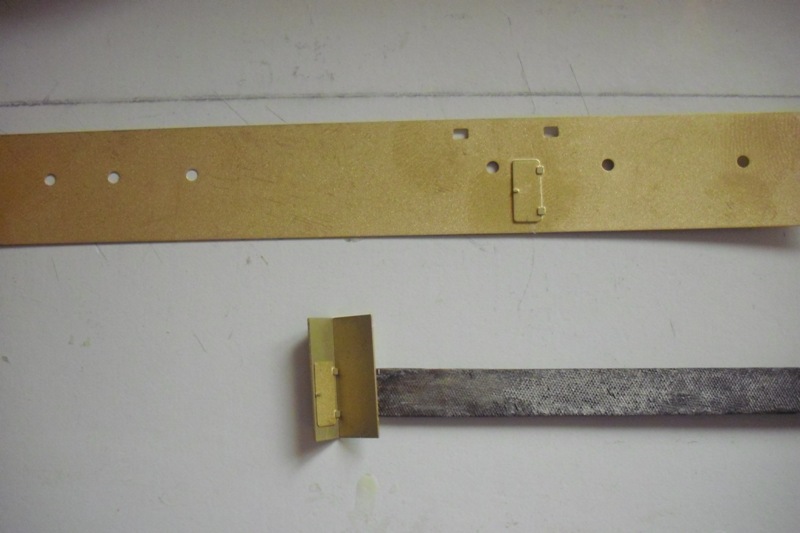

I trimmed the pieces as usual and filed the burrs:-

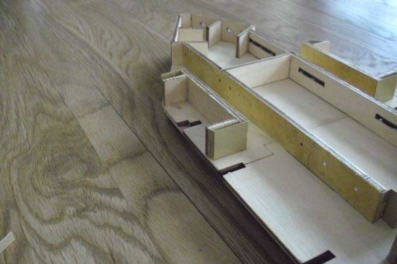

Then I fitted the doors with super glue gel, and bent the corner piece over the edge of the conti board, and after the part was bent I fitted the door (My advice do not fit it before):-

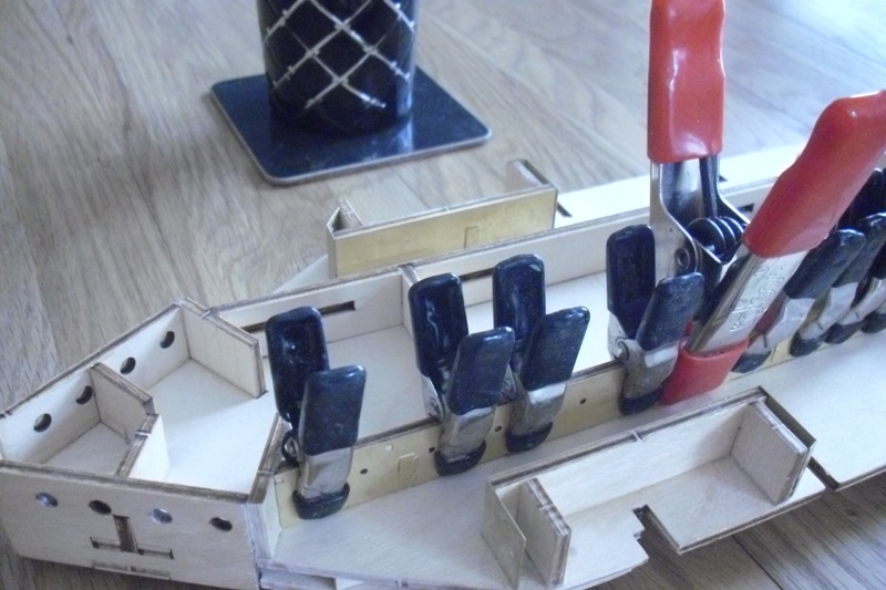

Time to fit the part which I did using my clamps for 5mins while the glue takes:-

And finally the job is done fore this weekBigGrin Questions and comments welcome
Regards Mike

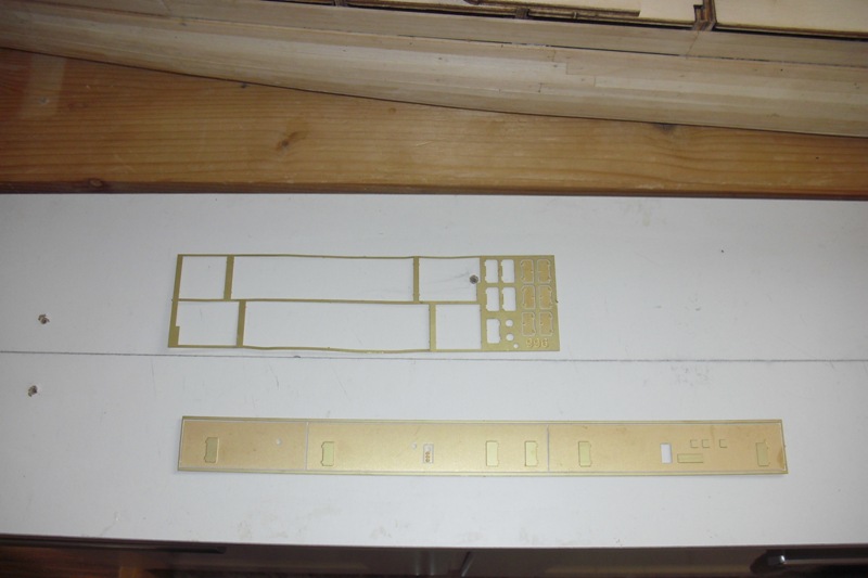

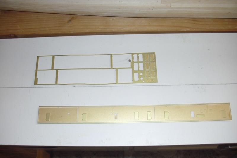

Hi Team this is what we received this week:-
More Brass etch to clad the deck, it really is nice stuff to useBigGrin

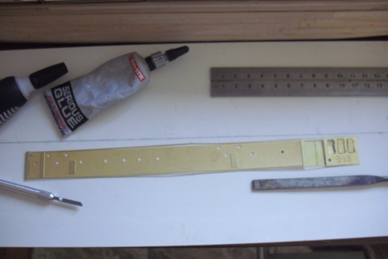

You know how to cut the brass out now, if not please refer to my previous postsBigGrin
I found it is very important to make sure you have taken off the burrs (where the brass part is attached to the fret) on this issue as I nearly left some on and just in time I remembered, it would have affected the fitting tolerances.
I followed the instructions and bent the brass as the visuals show (very slowly):-

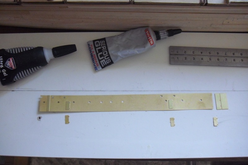

I fitted the doors with Gel Super glue, and fitted the parts with serious glue from Evo Stick:-

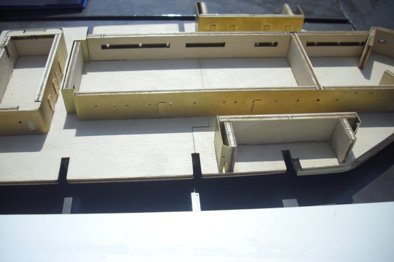

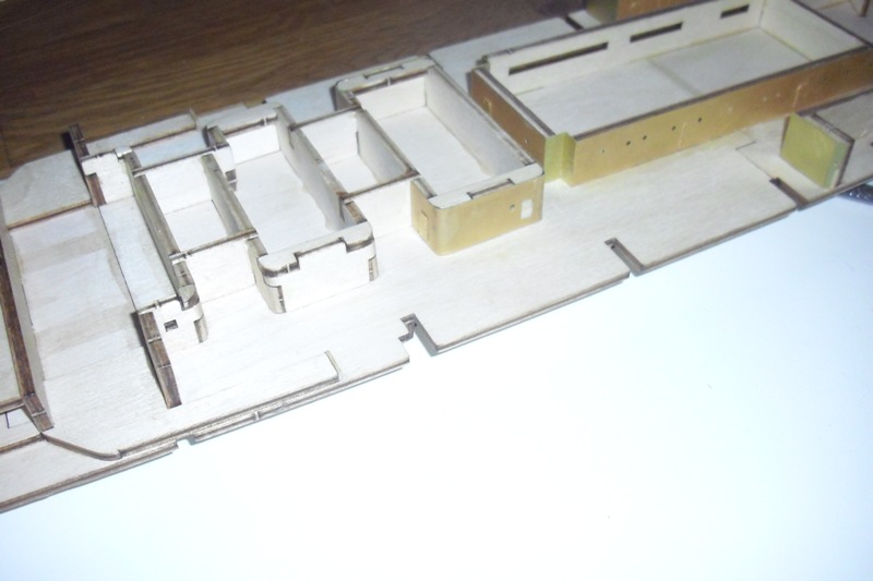

I used my clamps to fit the brass untill the glue had dried (15 mins) I also found it essential to remove any adhesive overspill from the wood in the corners, bottems and sides, so I could get the best fit possible with the brass. and here is the finished build this week:-
Questions and comments welcomeBigGrin

The gap between certain bulkhead sections does not look very big
so would you reccommend for people who have not reached this stage yet to join the sections of bulkheads together but NOT to glue those sections to the deck untill after brass bulkheads painted (for ease of access)or would this pose another problem
Cheers
#658 Posted : 23 May 2012 22:28:07
Hi Budgie, thank you for your kind commentsBigGrin and no blood yetBlink
Thanks for your question, in my opinion follow the instructions and stick everything down, because we are going to have to fill all the brass joins in order for the surfaces to look good when paint is applied (I will use white squadron putty)if you do not stick them down, your finish will not be goodCrying I hope that helpsBigGrin Regards Mike
