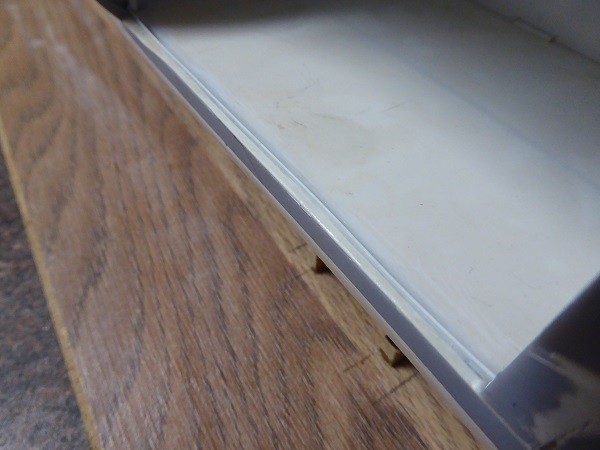

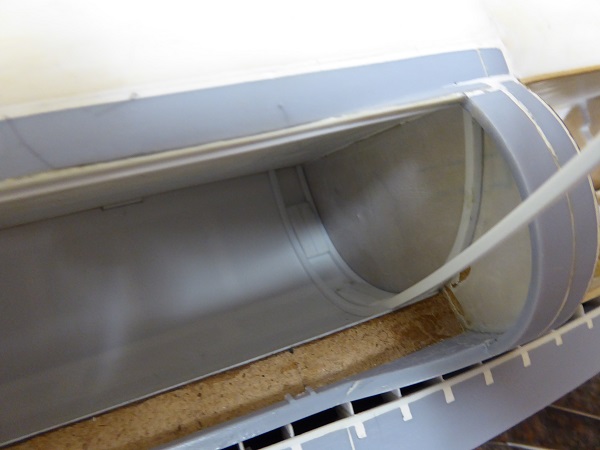

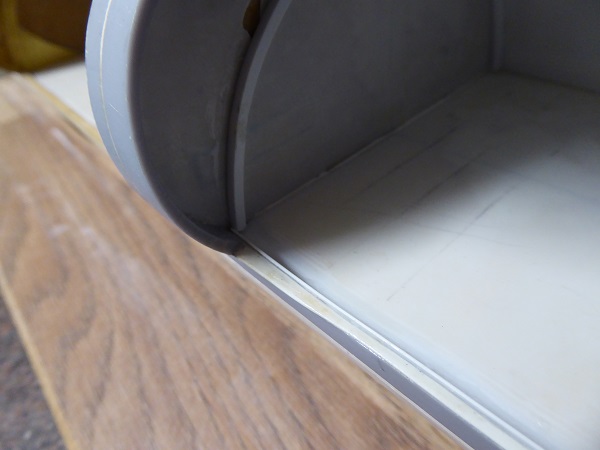

The inner hull shell was then glued in place making sure that it was pushed right up against the strips as mentioned before.
I then added a lip of plastic sheet 0.5mm to the front edge giving the impression that the hull has been cut through. This lip also acts a guide for the ribs at each end to sit against.

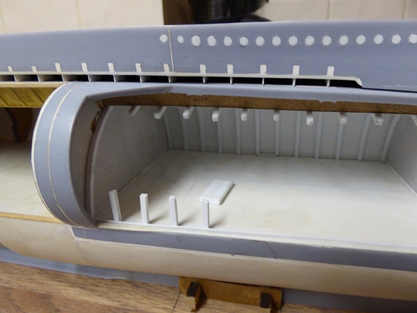

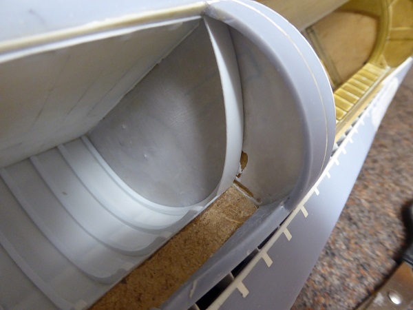

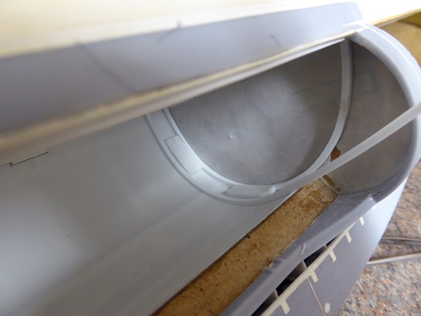

#642 Posted : 11 May 2017 08:07:55
This photo shows first rib fixed in place. This rib was pushed up against the inner hull to get the correct curve and as can be seen the lip provides an edge for it to butt up against.
#643 Posted : 11 May 2017 08:09:20
Another photo of the same rib.

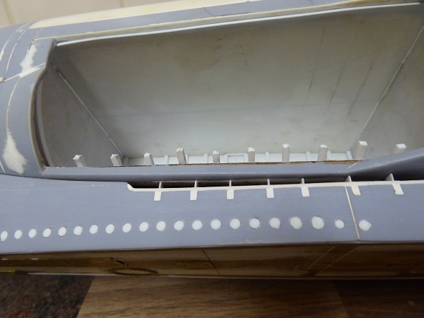

#644 Posted : 11 May 2017 08:12:01
This photo shows the second rib being fitted. Using my spacers I made in a previous post when fitting out the Junior Rates Mess and Galley ensured the ribs are fitted parallel to one another.
#645 Posted : 11 May 2017 08:13:04
Another photo of the second rib being fitted.

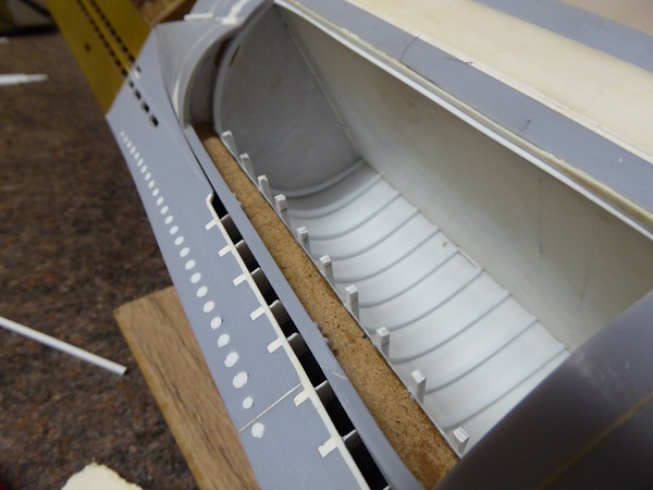

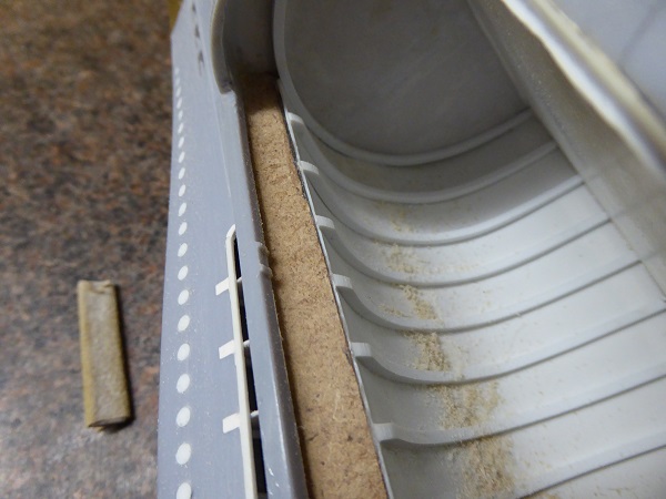

#646 Posted : 11 May 2017 08:15:38

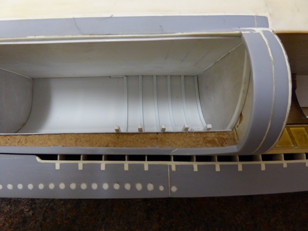

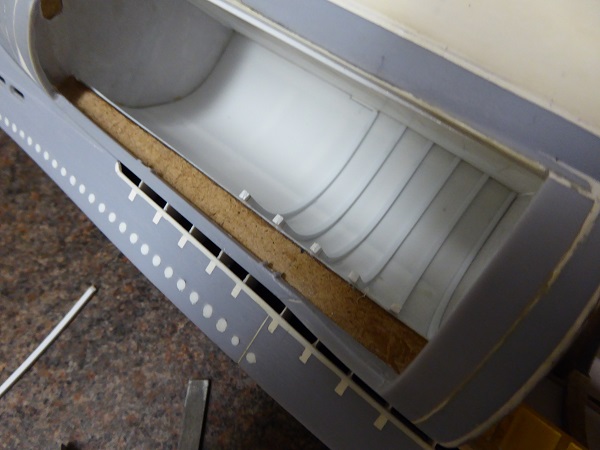

Using this technique I proceeded to fit the rest of the ribs. This photo shows the half way stage.
#647 Posted : 11 May 2017 08:17:07
This photo shows the ribs being left slightly longer than required as it's easier to trim them to length when fitted.

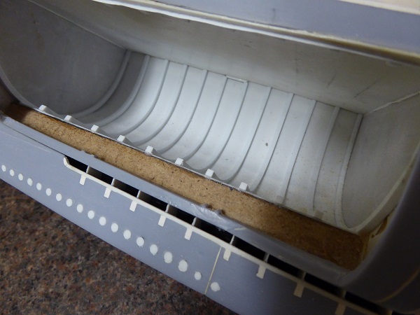

#648 Posted : 11 May 2017 08:18:13
All ribs fitted.
#649 Posted : 11 May 2017 08:19:38
This image shows the completed ribs cut over-length prior to trimming.
#650 Posted : 11 May 2017 08:22:55
To simulate that 'cut-through' impression of the compartment I glued smaller ribs butted to the lip I mentioned before. These were also cut to length after fitting.

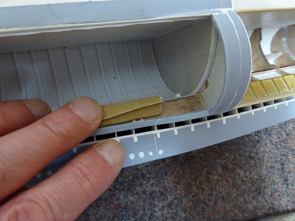

#651 Posted : 11 May 2017 08:25:02
I used a dremel to remove the excess from all of the ribs then sanded them flush. This photo shows the main ribs being sanded down.
#652 Posted : 11 May 2017 08:26:07
This photo shows the ribs sanded flush.
#653 Posted : 11 May 2017 08:27:51
Once the ribs were sanded flush I completed the look by sanding a bevelled edge to them so that they 'carry on theme' I applied to the Junior Rates Mess and also the Engine Room.

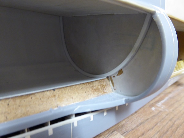

The first job was to cut out a thin strip of 0.5mm plastic sheet and fix it to the ribs at end of the compartment. This strip represents a part of the inner pressure hull.
The attached photo shows the aft inner pressure hull strip being fixed in place.
