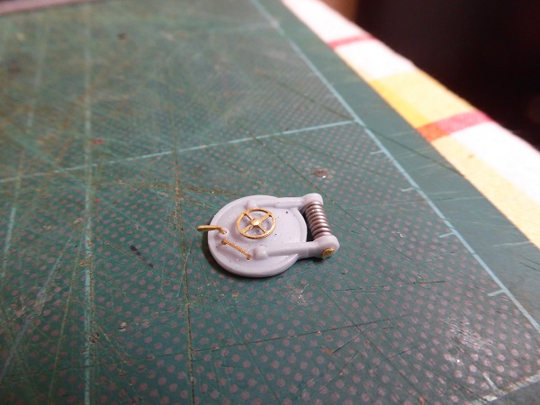

This week continues with the addition of part-works supplied items to the conning tower.
The first step was to prep the conning tower hatch by which all look-outs would gain access to the bridge.
The only thing that I didn't like about the moulded plastic hatch was the spring. So i decided to cut this section out and replace it.
The attached photo shows the moulded plastic spring removed.
#630 Posted : 17 January 2019 09:03:25
I then drilled through the hinges and fitted a small length of 1.5mm diameter brass tube.
#631 Posted : 17 January 2019 09:05:37
To fabricate the spring, i used a piece of solder wound around the brass tube and cut to suit. I then completed the hatch with the part-works supplied PE.
#632 Posted : 17 January 2019 09:06:59

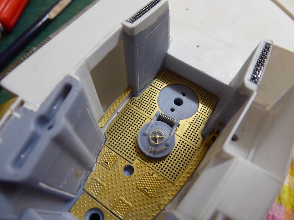

Hatch in position, not glued at this stage as i will paint and weather it separately before fixing it permanently.
#633 Posted : 17 January 2019 09:12:24

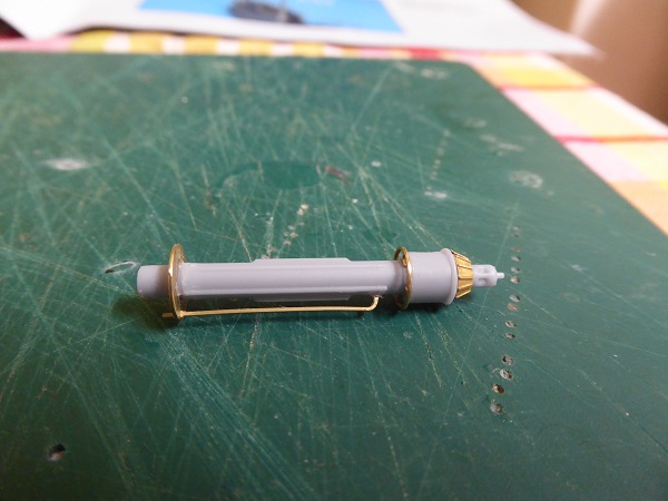

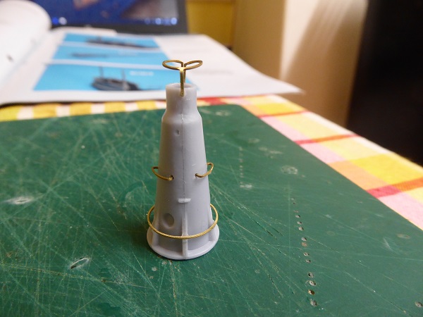

I then made up the search periscope mast housing as per the part-works instructions. Similar to the hatch, this will be painted and weathered separately before fixing in place.
#634 Posted : 17 January 2019 09:17:57
I then made the attack periscope mast housing and will paint and weather as a separate item.
The difference between the search and attack periscopes is that the search periscope is binocular, while the attack periscope is monocular and thus smaller in cross section and less visible, hence its name.

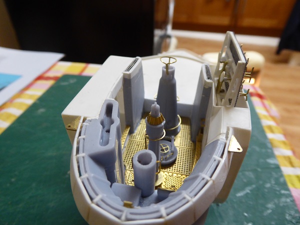

The attached photo shows all of the masts and periscope housings temporarily fitted to give an idea of how they will look. As I've mentioned before, all of these items will be painted and weathered separately prior to fitting.
#637 Posted : 17 January 2019 09:24:31

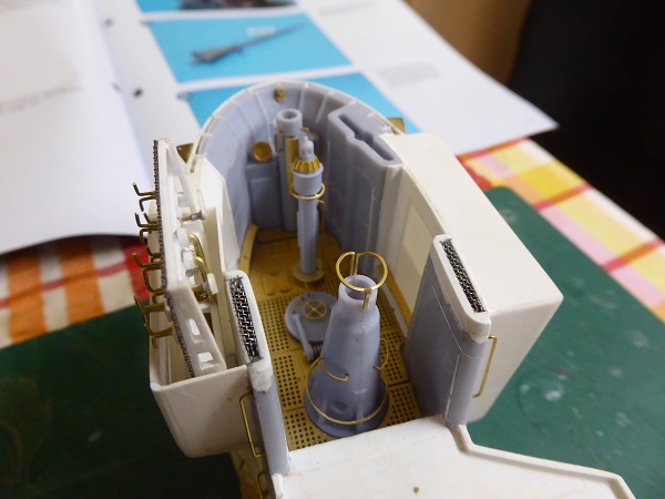

From another angle.
