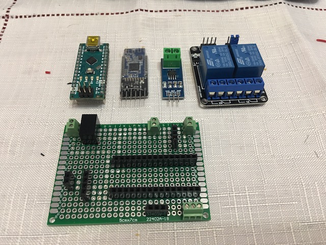

I haven't posted since few weeks, but I was still busy with the display cabinet.

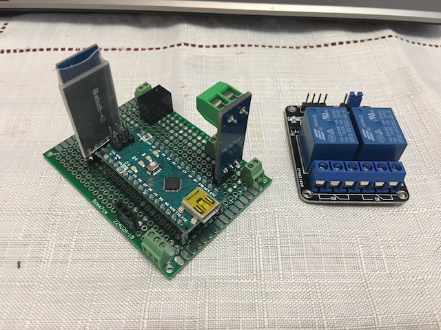

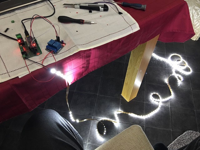

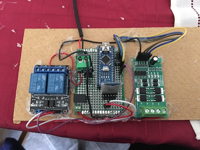

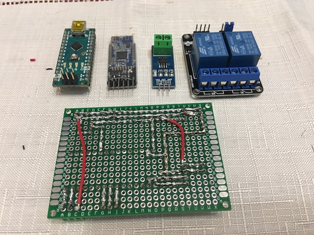

- Circuit board made to accommodate micro-controller, current monitor and bluetooth boards, as well as connectors.
- Relay board connected, and LED light strip tested, check. BigGrin
- All boards mounted to a piece of hardboard with hot glue and connected, check
- Micro-controller (Arduino) code corrected to squeeze some bugs, check
- Electronics connected to mechanics, test performed without load, check.
See link to a video on my public facebook profile about the test. It's a bit noisy, but who cares, when it's in the loft. Cool

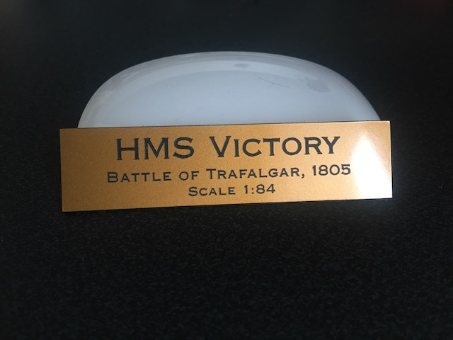

- Name plate ordered and arrived, looks very good

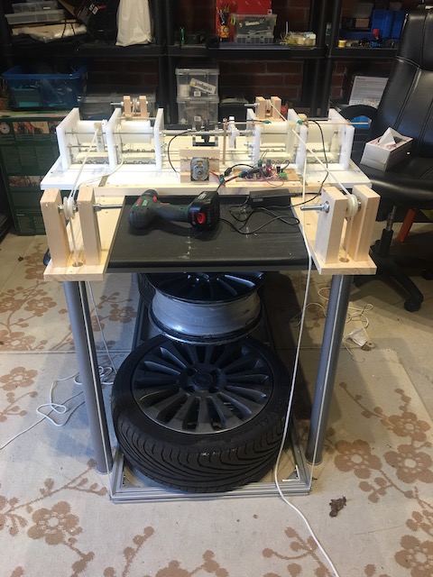

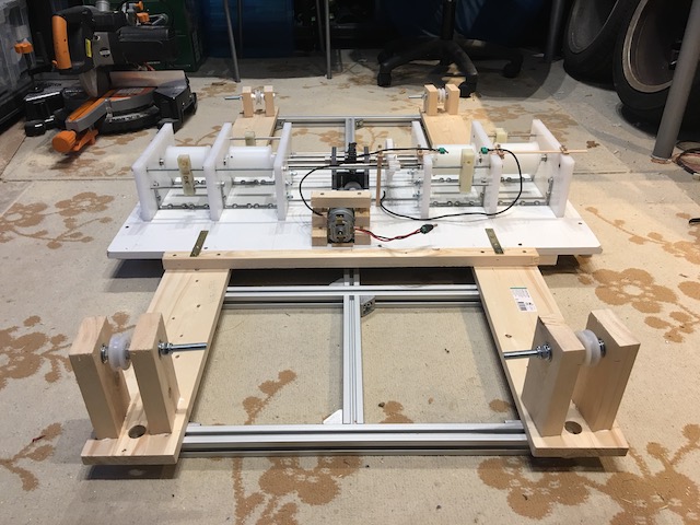

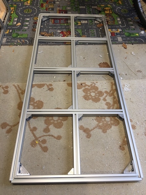

- First, I bought and assembled one size bigger (30x30) aluminium profile, you might remember that the 20x20 was bending too much under 45 kgs load.

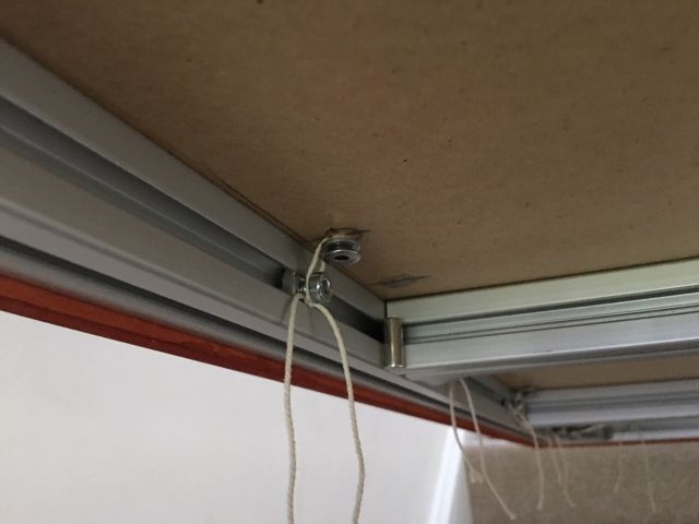

- The lift mechanism is now extended, I made the four pulleys leading the ropes from the spindles to the corner of the cabinet.
- The whole mechanics put onto a table. How incredible it is, the alu frame just fit in between the legs. Cool Cool Cool
- The frame was loaded with 45 kgs (representing the glass panels and all the cabinet parts), and yay... the mechanics is able to raise/lower the frame (driven by a battery drill driver). Cool BigGrin
Unfortunately after all these success, quite a few failures came.Crying Angry
- The selected 12V DC motor was not strong enough to raise the mechanics, regardless how much power (amps) it was provided.
- Hence I bought a cheap 12V battery drill driver, as per experienced with my 18V driver, due to its geared motor is strong enough to bear the load.
- However now the 5A power supply wasn't big enough, the drill driver takes more than 5 Amps.
- I managed to get hold of a power supply from a tower PC, which, in theory, can provide 17A on the 12V outputs. However this also failed... Crying Angry Cursing In order to get the total 17 Amps out of it, I joined all the 12V outputs together, but now the power supply shuts off on higher load. I guess one of the 12V outputs has some protection on high load making it turn off.
- Now I borrowed a 12V motor cycle battery with 110Amps output from my colleague. If it won't be able to move the load then nothing.LOL I'm hoping that I'll be able to measure the current requires to move the load and then get a suitable proper power supply.

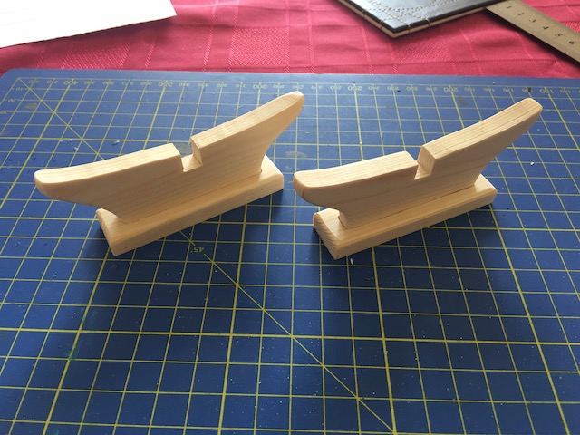

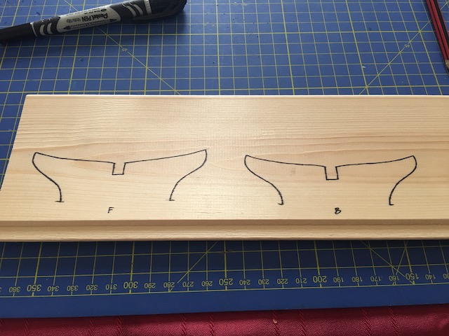

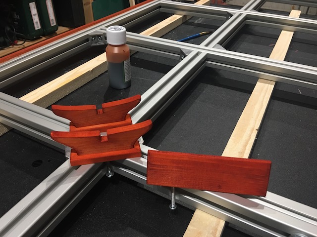

- Ship cradles made

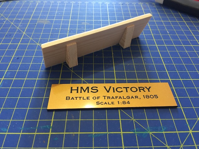

- Stand for the name plaque made
They will be stained either to walnut or red chestnut colour. Not decided yet.

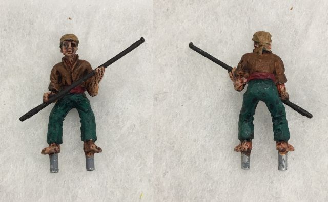

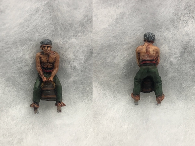

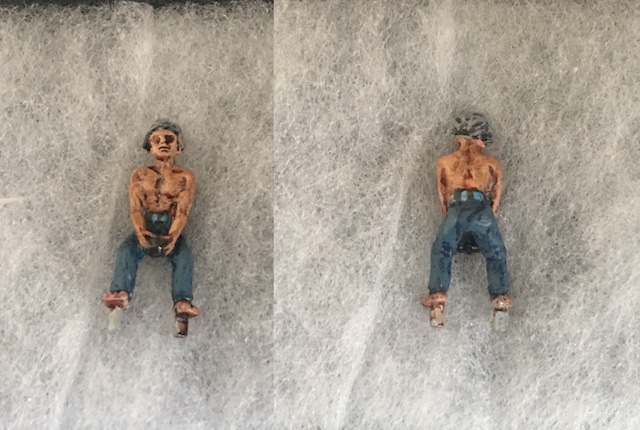

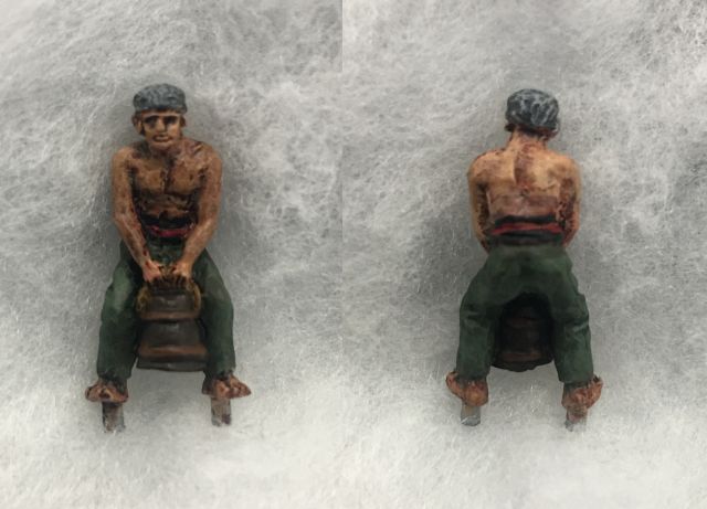

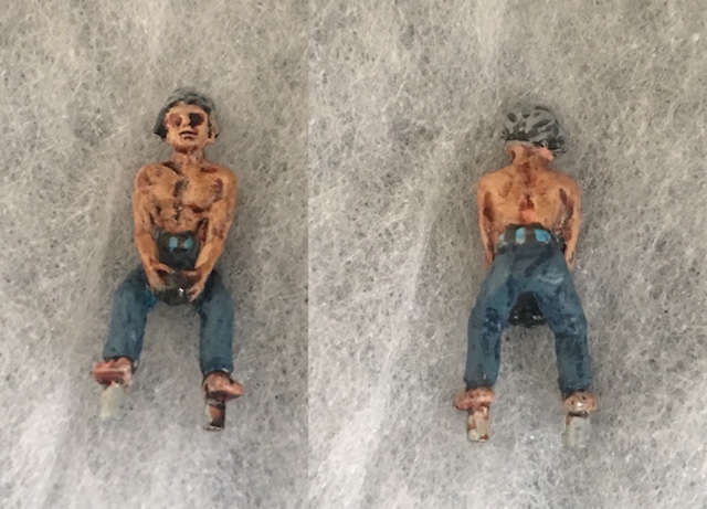

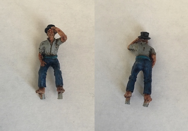

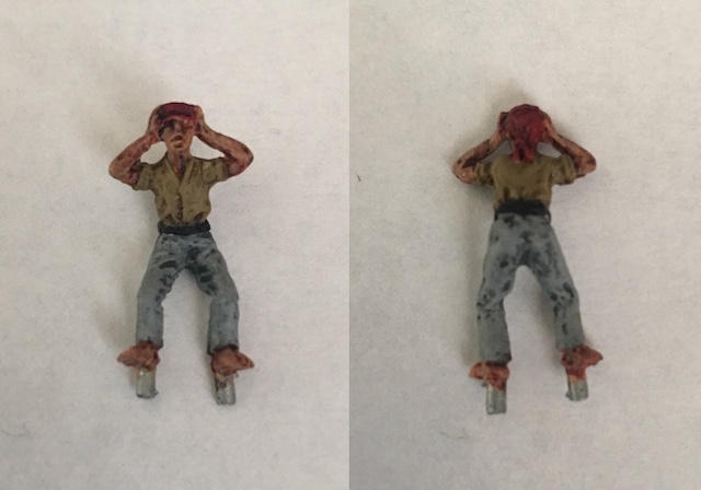

Also, thanks to my colleague, now I've got four figurines in total:
- crouching crewman with shot
- crouching crewman with barrel
- crouching gun captain
- crouching crewman covering ears

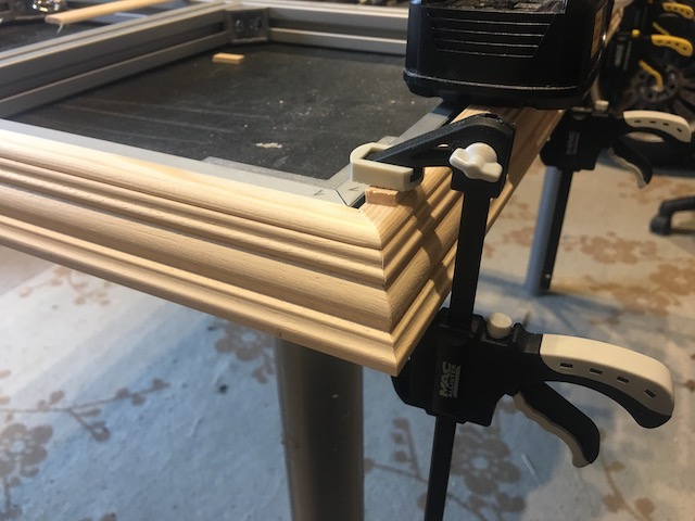

Further progress with the display cabinet:

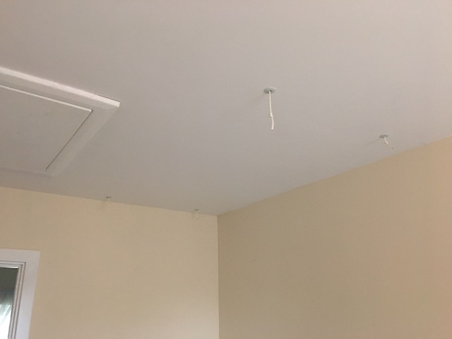

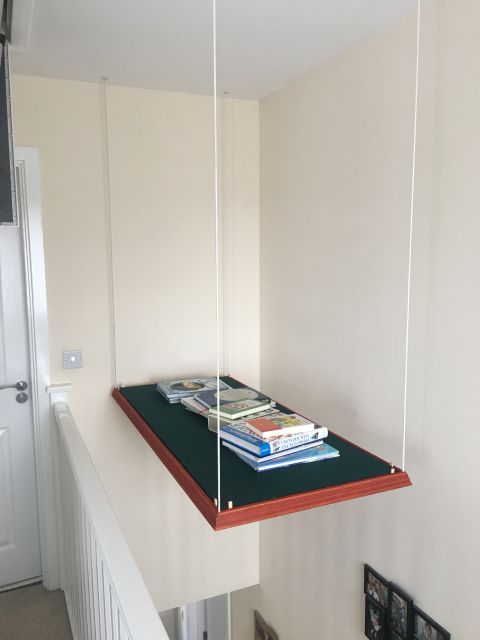

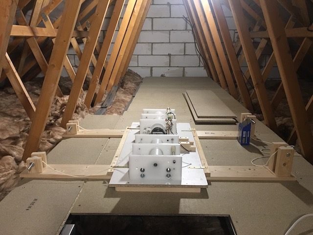

- Ceiling drilled and temporary ropes feed through
- I used decorative covers to make the holes look nice, this cover usually used for satellite cable fed into the room but perfectly suits for my application Cool
- Mechanics installed to the loft

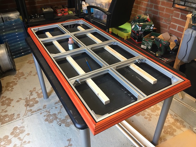

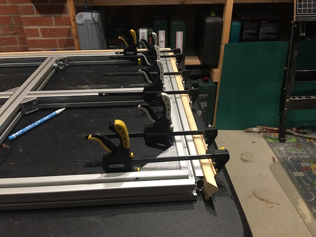

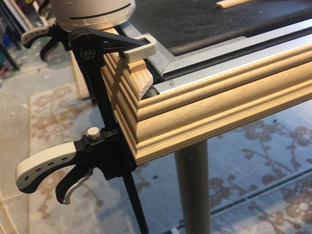

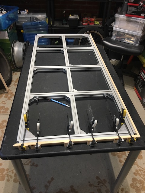

- Decorative hardwood moulding fitted to the side of the frame with gorilla glue. That was the only type of glue what I found to able to fix wood to aluminium reliably. It's very a good stuff.
- Another moulding fitted but his one onto the top of the frame. This half will be on the outer side of the glass panels.

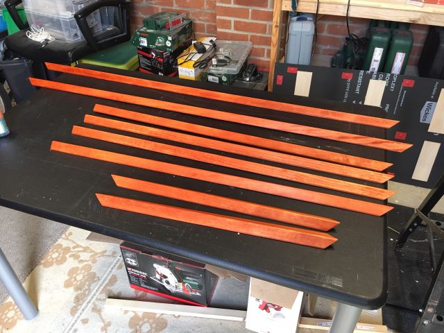

- Once everything dried, two coats of wood stain applied to the mouldings
- The ship cradles and the name plate stand also stained
Slowly getting there. Cool BigGrin
Happy building!
Laszlo

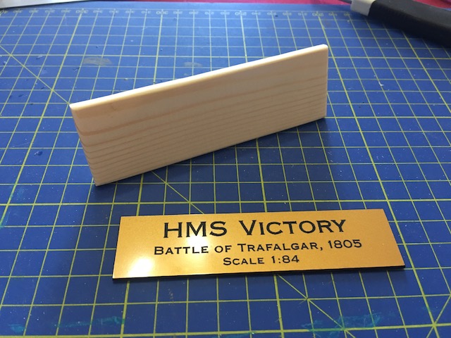

gingerale75
#627 Posted : 11 June 2019 15:58:16
Joined: 30/11/2017
Posts: 493
Points: 1,482
Location: South Norfolk
Hello All,
Further progress with my cabinet:

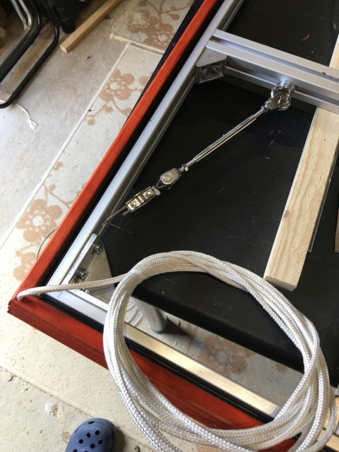

- wire rope fed through the decorative white nylon rope and then fixed to the frame with adjustable rigging screws.

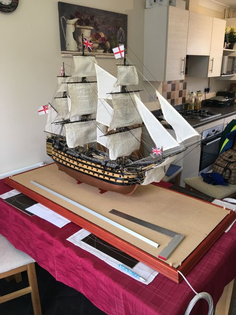

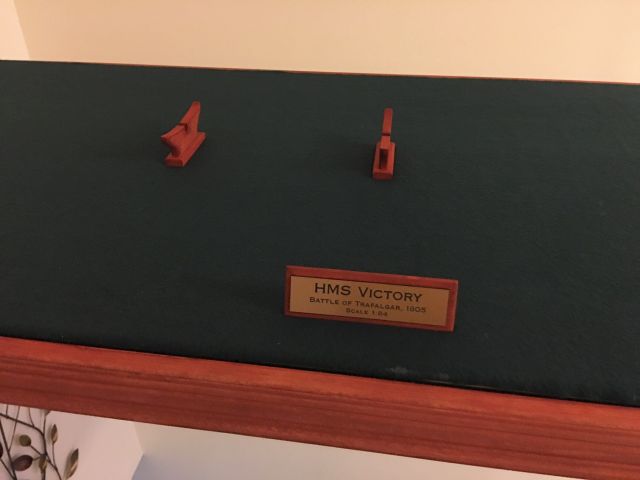

- base board cut to size and, by placing the ship in its final place, marked the position of the name plate and the ship cradles.
- frame hung up and set to level
- the fifth crew member figurine painted
Happy building!
Laszlo

gingerale75
#631 Posted : 18 June 2019 09:30:33
Joined: 30/11/2017
Posts: 493
Points: 1,482
Hello All,
Latest progress on the display cabinet:

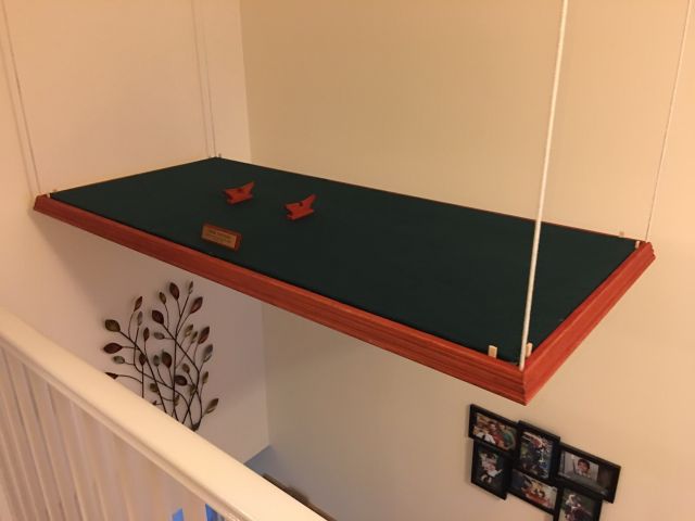

- name plate and ship cradles fixed to the board.
- board fixed to the frame in multiple points because the hardboard tend to 'curl up' around the edges if not pulled down.
The next big task is to fit the glass panels.
This task scares me a bit Crying Blink
Never done anything like this before.
Also the LED lighting needs to be done on the same time because the channels for the LED strip lights need to be fixed to the glass.
Happy building!
Laszlo

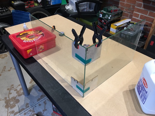

#632 Posted : 13 July 2019 12:00:27
Joined: 30/11/2017
Posts: 493
Points: 1,482

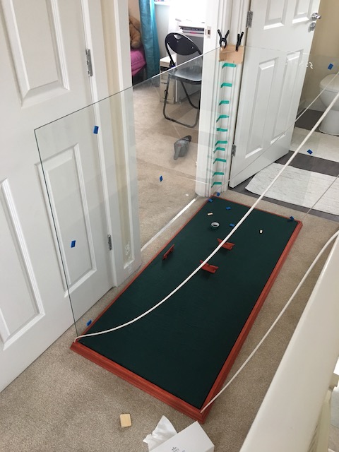

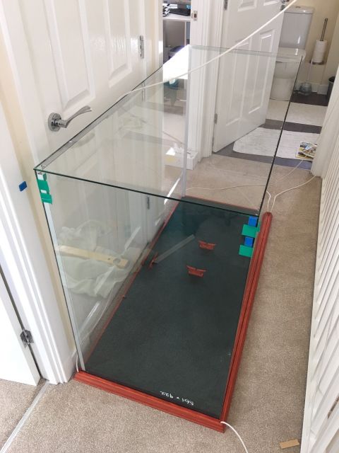

Operation Code: “Don’t chop your fingers off”...
Your mission, should you choose to accept it, to fit glass panels onto the frame without being injured and/or breakig the glass... As always, should any part of your hands/arms be injured, the H&S Secretary will disavow all knowledge of your actions. Cool Cool Cool LOL LOL LOL

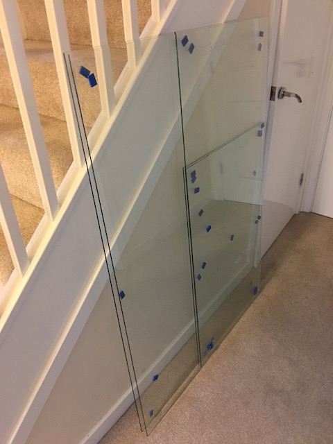

Hello Guys,

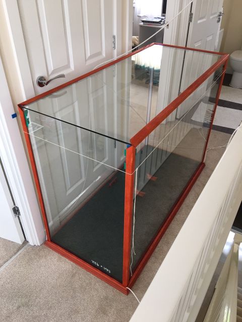

After two weeks of waiting, finally the glass panels arrived. I also got some off cut pieces to try out what glue I should use.
The first trial was already successful with clear gorilla glue, so I stick (LOL) with it. BigGrin

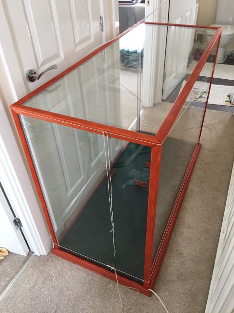

Cabinet frame lowered down to the upstairs hallway floor and the first two panels placed into the slots and glued together.
Now waiting for the glue to dry.
Next step will be to fix the LED strip light channels to the panels already in place, then fit the second long side panel.
Slowly, but getting there to complete the cabinet. Cool
Happy building!
Laszlo

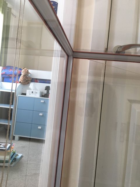

#635 Posted : 22 July 2019 12:14:57
Joined: 30/11/2017
Posts: 493
Points: 1,482
Hello Guys,
Thanks for the good comments.

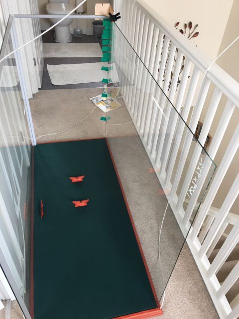

Progressed further with the cabinet:

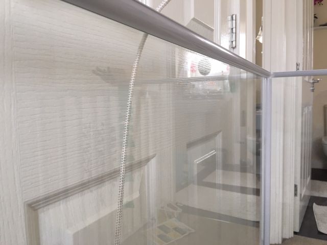

- LED aluminium profile glued onto the panels
- LED stripes fixed, wires led through the base at the corners
- Milky covers snap in place
- Third and top panel glued to the existing ones
- Corner mouldings cut to size and stained
- Mouldings glued to to the edges
- Remaining LED strips fitted
- Finally the mouldings glued to the removable side panel. This is where the ship will be slid in once the cabinet will actually hanging above the staircase.
With this the visible part of the cabinet is finished. Cool
Now I just need to get couple of my strong friends to help me to lift the cabinet over the staircase hand rail... LOL Blink Blink
Remaining tasks:
- Connect LED wires to the wire rope (inside base)
- Create and fit cover panel to the bottom to hide the frame
- Finish electric circuit for the lift mechanim
Happy building!
Laszlo

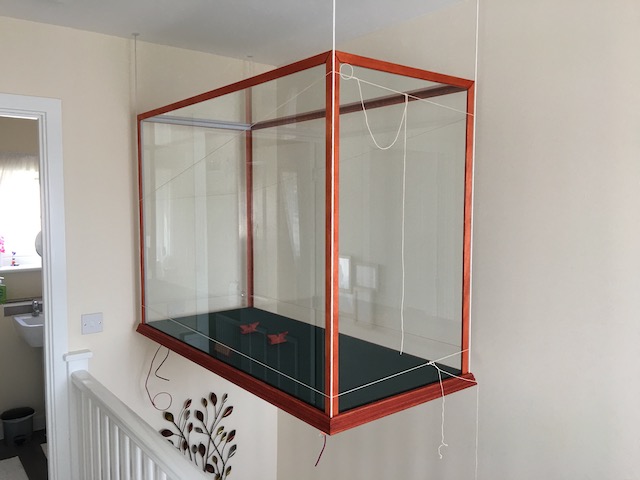

gingerale75
#636 Posted : 04 August 2019 10:47:56
Joined: 30/11/2017
Posts: 493

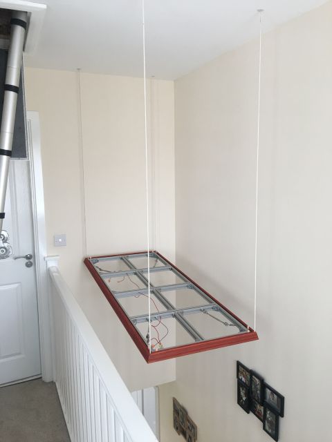

Points: 1,482
Hello All,

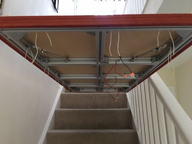

Today the cabinet was lifted to it's final position.
With the help from couple of my friends we lifted the cabinet over the handrail while the rope was winded up in the loft with the lift mechanism.
I think the cabinet looks good, now I just need to connect the electric wires for the LED strips and cover the bottom of the frame before I place the ship inside.
Happy building!
Laszlo
