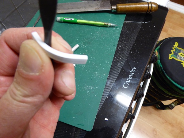

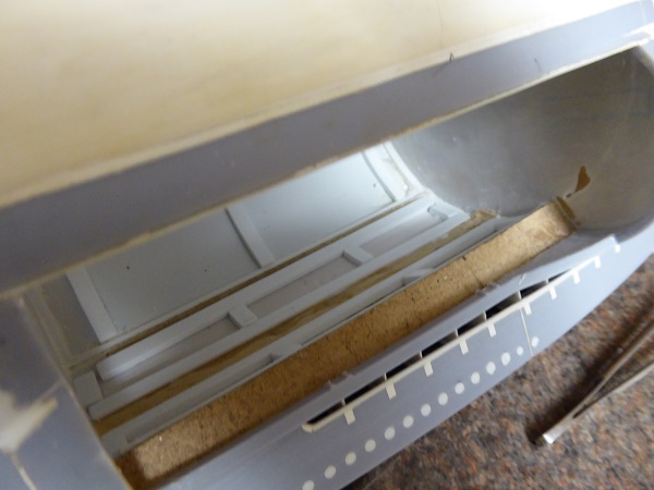

This weeks update on my build log of U-boat U230 will focus on fitting the inner pressure hull and t-frames [ribs] to the space that will eventually become the Senior Rates bunks, Captains Cabin, Sonar Shack, Signals Shack and Senior Rates WC.
As with a previous post when I fitted the inner pressure hull to the Junior Rates Mess and Galley I started by fixing spacers to act as supports. These were cut from 4.5mm wide by 2.5mm thick plastic strip.
The attached photo shows one of these strips cut to length being bent around a file handle to aid fitting.

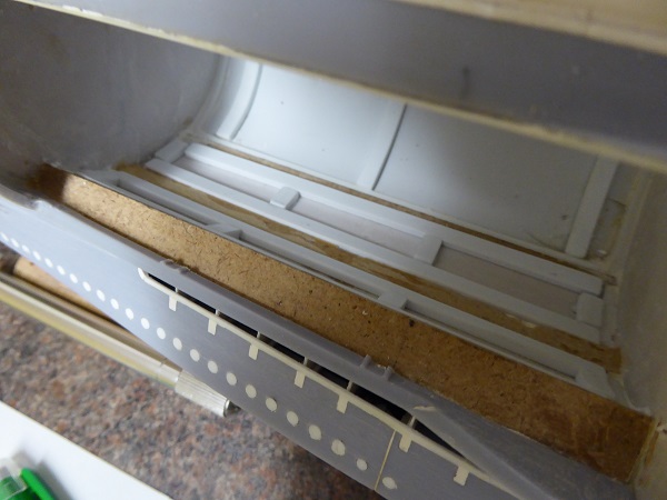

#629 Posted : 11 May 2017 07:36:41

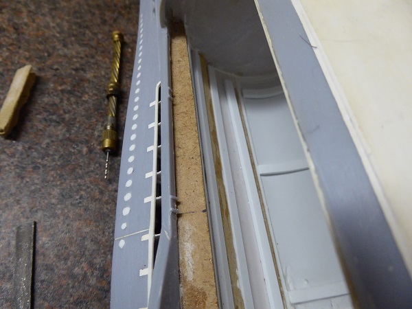

This photo shows the start of fitting out with some of these strips.
#630 Posted : 11 May 2017 07:39:02
This photo shows some of the strips fixed length ways to aid support of the inner hull.

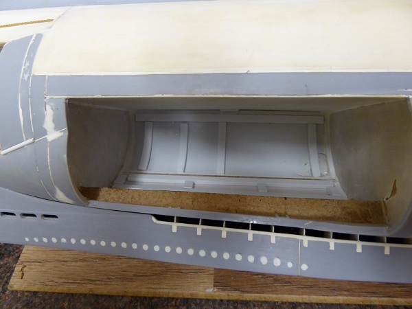

#631 Posted : 11 May 2017 07:40:31
This photo gives you an idea of the different length of strip used.
#632 Posted : 11 May 2017 07:41:49
Smaller pieces fitted at the ends.
#633 Posted : 11 May 2017 07:42:40
Further strengthening strips added.

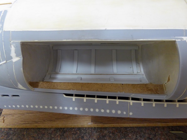

#634 Posted : 11 May 2017 07:43:45
Another view showing the gradual build up of these strengthening strips.
#635 Posted : 11 May 2017 07:44:43
This photo shows the curved strips being fitted.
#636 Posted : 11 May 2017 07:46:07

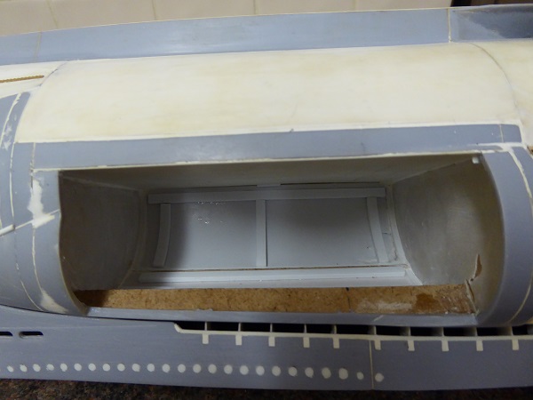

All strengthening strips completed.

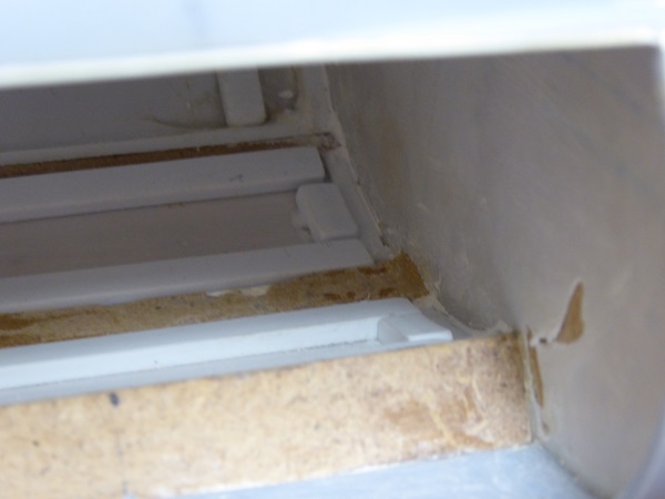

#637 Posted : 11 May 2017 07:50:46

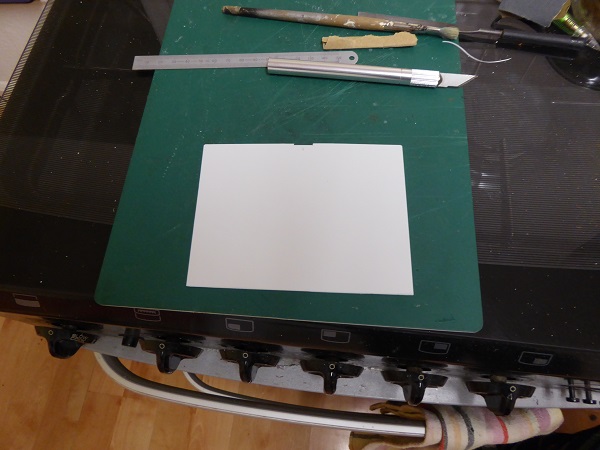

The next step was to make the inner hull shell using 0.5mm plastic sheet. Careful trimming and filing was required to ensure a snug fit.
The photo shows the sheet cut to size.
#638 Posted : 11 May 2017 07:51:27

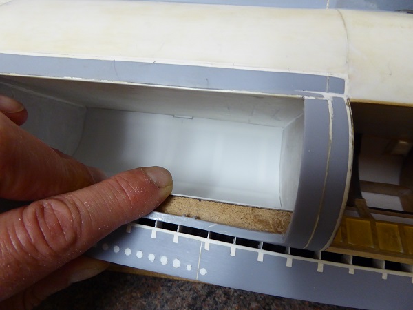

This photo shows the inner hull shell being test fitted.
#639 Posted : 11 May 2017 07:53:44

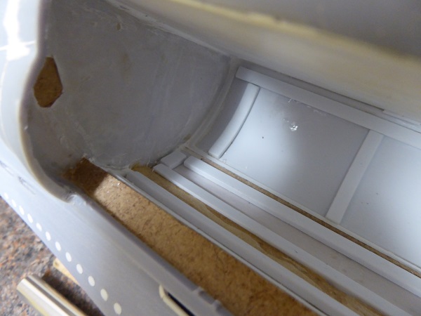

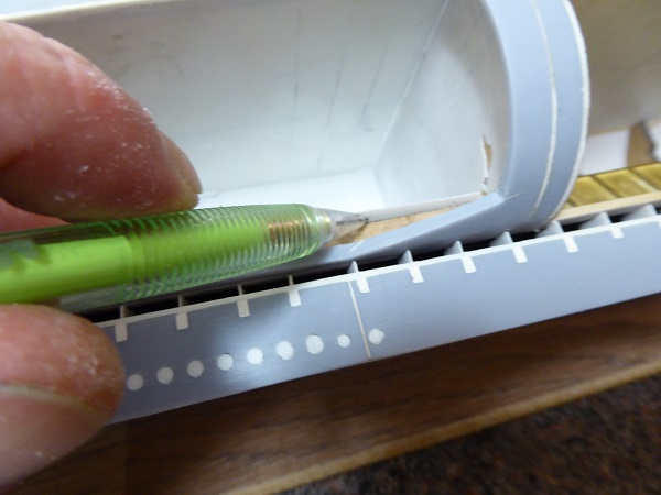

Once I had the inner hull shell test fitted I marked with a pencil a cut line to remove the excess.
#640 Posted : 11 May 2017 07:54:32
This photo shows the cut line.
