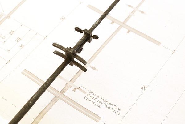

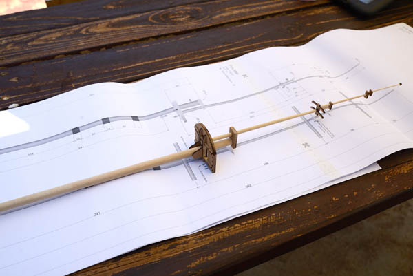

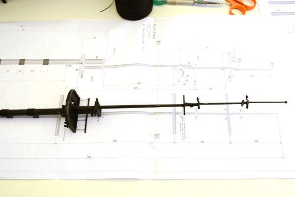

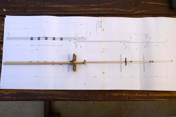

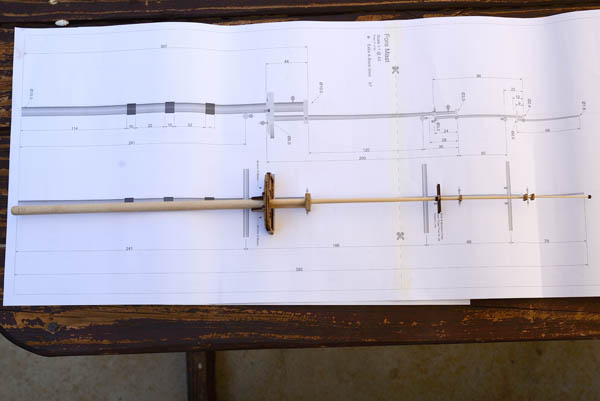

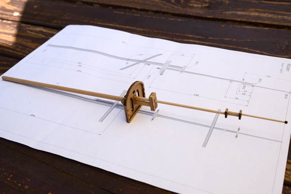

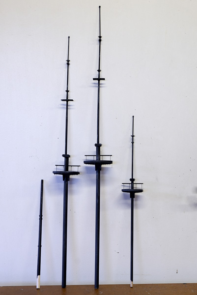

Masts & Bowsprit Cont. Part 02
Down to business with the masts, finally feel like I'm moving again!BigGrin

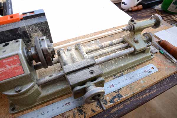

First off, thanks to Mark (the owner of our company) for the loan of his mini lathe. Using the lathe to taper the masts has really simplified the process.
First, I turned down the masts to the dimensions on the plans and then cut everything to size. Please note if you are building from my build. The diameter measurements given in the instructions are not the same as the parts into which they must fit. Cursing So, all the parts that I turned down were too small. I only noticed this when I started assembly. Pity I did not measure first. I had to build-up the parts with thin slivers of masking tape. Other than that, everything went pretty much as the instructions show.

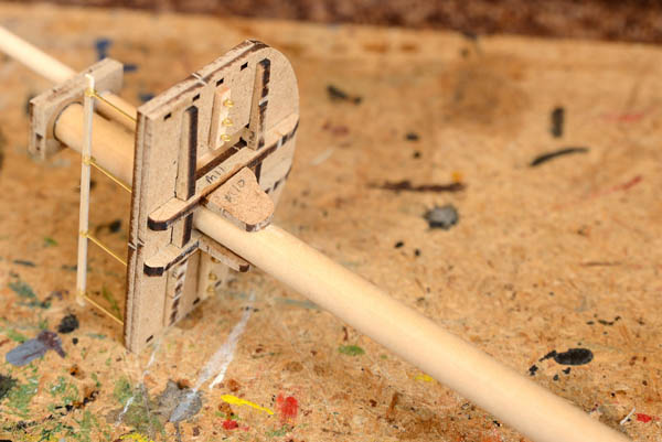

Next, I added the 3mmx3mm blocks under the fighting tops of the fore and main mast for the running rigging.

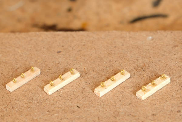

Lastly, before painting, I drilled and glued in all the eyelets with superglue.
Painting, as with the rest of the ship – matt black with progressively lighter dry-brushing. Remember to clean any paint out of the eyelets once it has dried.

#626 Posted : 23 June 2020 17:32:19
That looks neat Garth.
I think making the masts is one of (if not the) most difficult part of the build.
Yours look really very well done.

Excellent work on the masts Garth, certainly a job made a lot easier with the use of a mini lathe but it still requires skill.... Very well done....Drool Drool Drool

Lovely work on the masts Garth. She's coming along very nicely!

Hi Tony,
You are right, some of the bits are turned down to about Ø1.4mm.
The other challenge is keeping everything squareCrying
I used superglue & activator here. It seemed to work.

Hi Alan,
Thanks for looking in and for you kind remarks. I would probably still be busy if it weren't for that lathe.

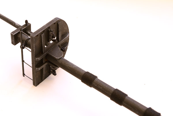

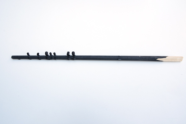

Hi All,

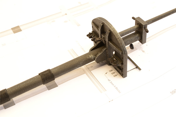

Masts & Bowsprit Cont. Part 03, Lashings & blocks
Fitted the blocks and the lashings to the masts.
Remember if you are building from my diary:
- add the 6 extra blocks below the fighting tops below the main and fore mast
- add the extra block on the fore mast for the jibs running rigging
- add the extra blocks on the bowsprit for the additional stay and the jibs running rigging
- start the bottom lashing on the main mast about 5mm higher than in my drawings. It got in the way of the capstan.
Apologies for all the different colour casts in the images. I was out on the veranda on a windy day. The clouds would come over, next bright sun, then cloudy again …..Blushing
