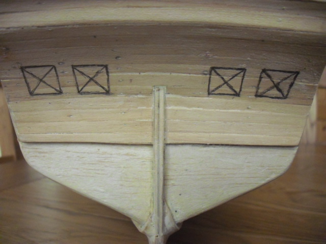

#605 Posted : 27 April 2013 21:24:08

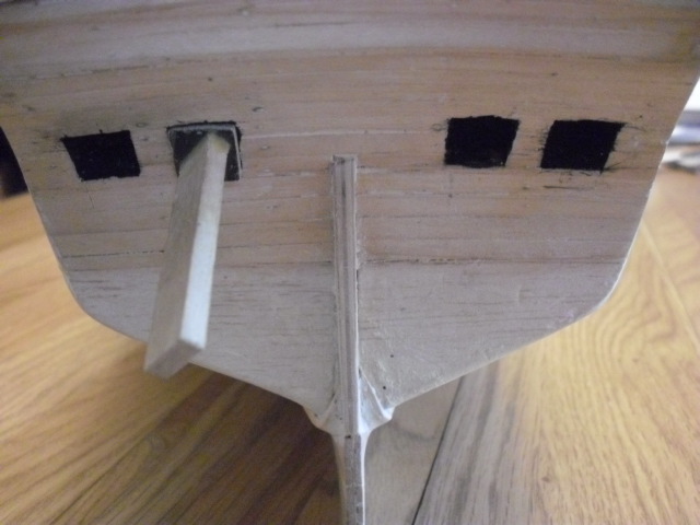

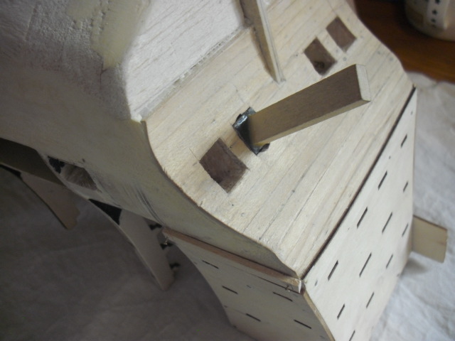

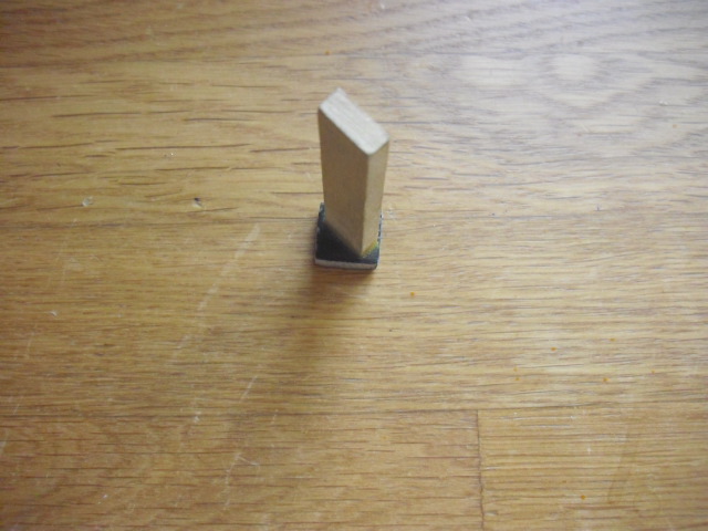

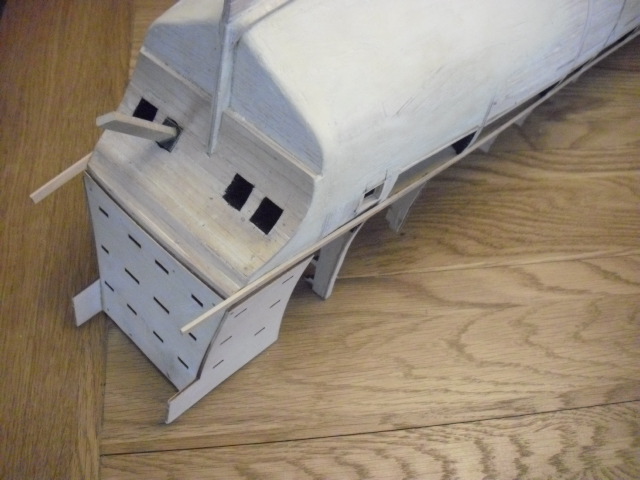

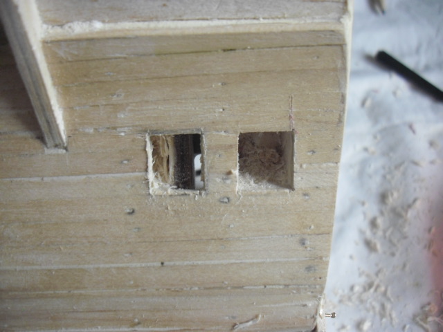

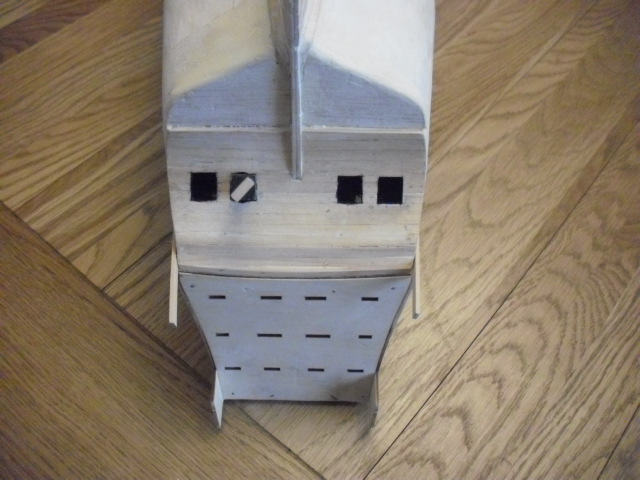

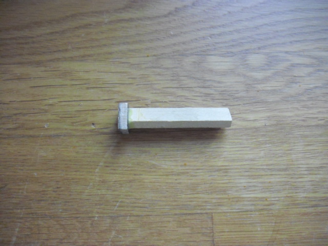

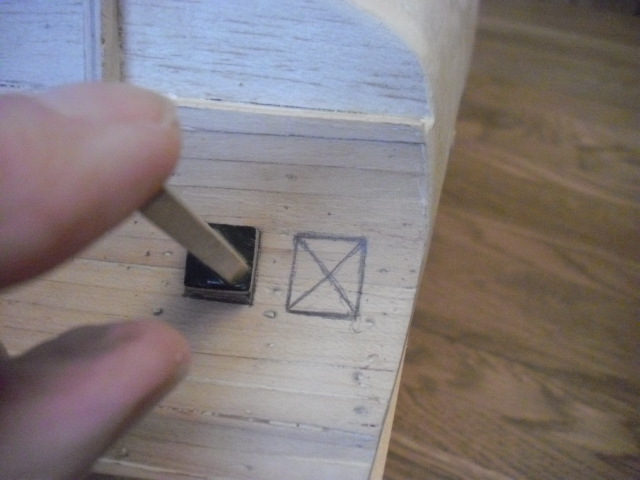

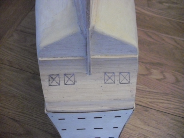

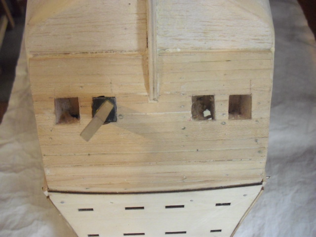

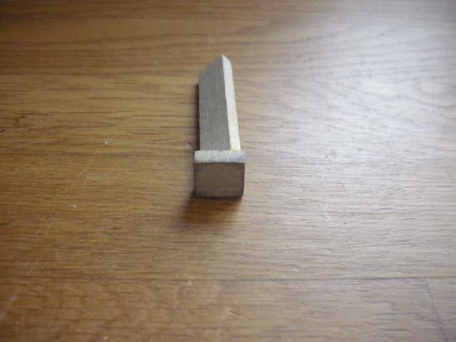

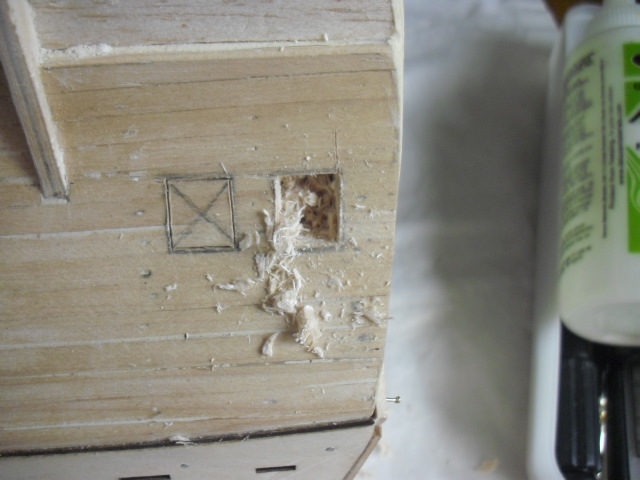

STERN GUN PORT MODIFICATIONS
I decided to have my stern gunports open ,I purchased 6 extra of issue 1 which has the extra guns I will require.
As you will see from my build diary I alredy put balsa infills in the stern around frame 27 so fitting the gun ports was staight forward.
I have made a former to use to mark the gun ports, this is 12mm x 12mm (I am not doing 12mm x 13mm as it says in the instructions)this size is my preference.
what you will see is a selection of photos which should tell the story of the Mod:-

#607 Posted : 27 April 2013 23:23:46
Hi Mike, another very useful tutorial.... thanks for posting....BigGrin BigGrin

It`s the inquisitive one here again,Confused
A quick question about the rear gun port modification. Looking at your pics (it may just be the camera angle)it seems they are aimed down at the waterline, I`m thinking it is dependent on the angle you cut the dummy ports at, in relation to the shape of the stern?
The simple pic below may explain what I`m trying to get at a bit better.
SandyM

Thank you Alan, Nigel, Martyn, Sandy and Claret for all your nice comments.I love the debate over the build of the shipBigGrin keep it coming
Derek the guns will be mounted straight out, and not pointing at the water, the gun ports traverse approx 25mm back to rib 27 which forms a natural fixing point for the guns.thanks for asking the question, good oneBigGrin
