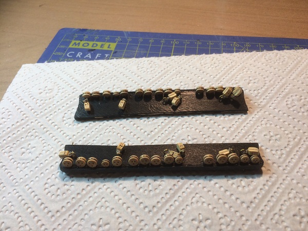

There`s very slow process at the moment as i`ve got litle time for modelling.
But here`s a small update of the now attached custom-made fore-chainwales.

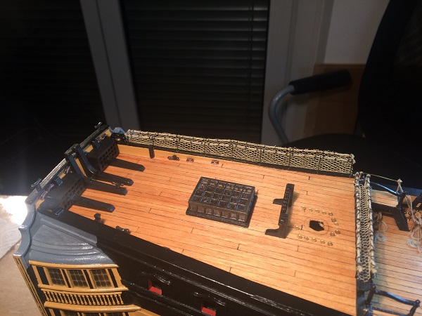

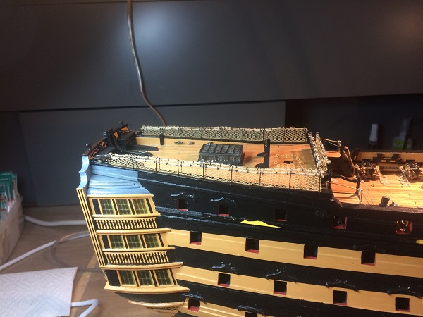

#604 Posted : 28 February 2018 11:23:01

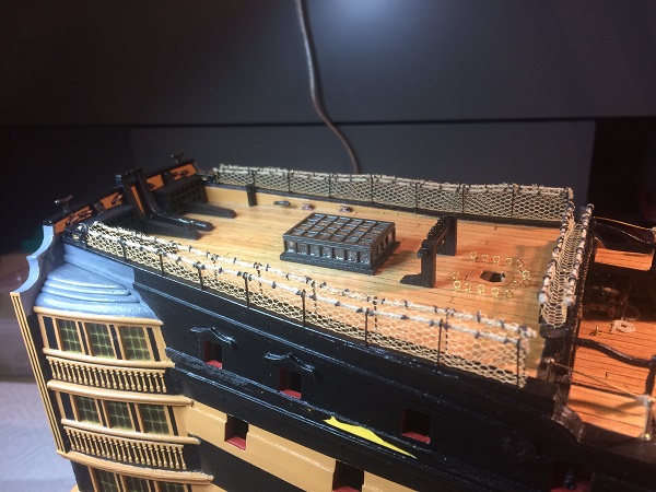

Currently i`m working on the hammock nets of the poop deck.
A time- and nerve-consuming task!!!
Unfortunately there are two little steps in the height of the nets as the cranes don`t fit exactly the course of my bulwarks. But there`s no way to change that!

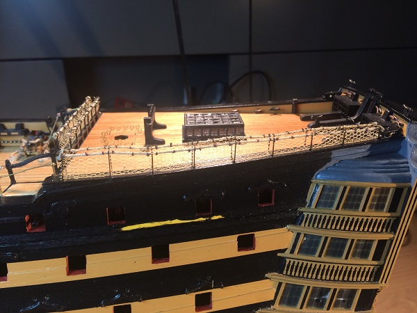

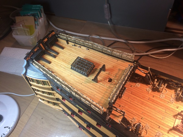

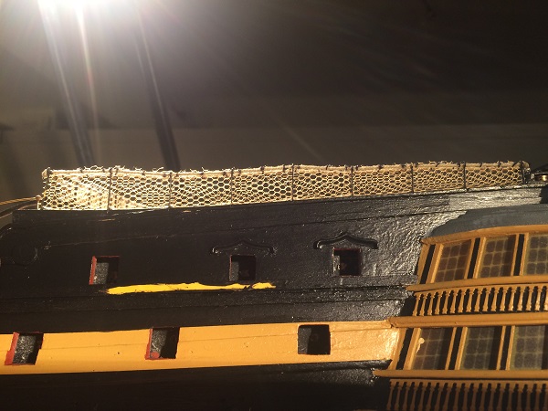

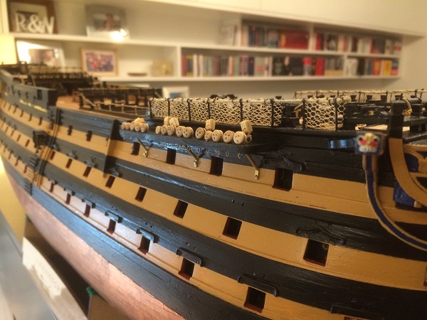

#611 Posted : 06 March 2018 11:46:59
Finished the poop deck nets.
Looking at the pics i really don`t know why i used black thread for the bindings ??
I´m not quite satisfied with the somewhat patchy look it creates.
I guess i`ll try a lighter thread for the rest of the nets.
What do you think?
Gibbo
#612 Posted : 06 March 2018 12:02:59
Joined: 26/05/2014
Posts: 912
Points: 2,773
Location: East Sussex UK
I think it looks good Walter.
Paul

#614 Posted : 07 March 2018 14:27:16
Thanks guys!

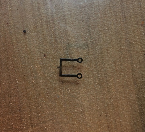

I think i`ve seen those tips elsewhere - but i just wanted to give some advice to those who haven`t built the nets yet.
When cutting the cranes from the Frame - leave a little pin on the underside.
Then you cut a little slot into the bulwark caps and drill a hole in the middle.
This way the glue has more area to hold on and the hammock net cranes are holding quite strong.
