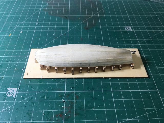

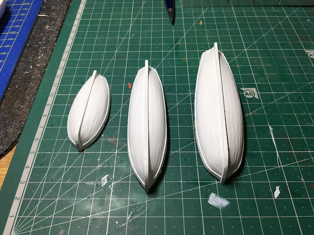

Hello Guys,

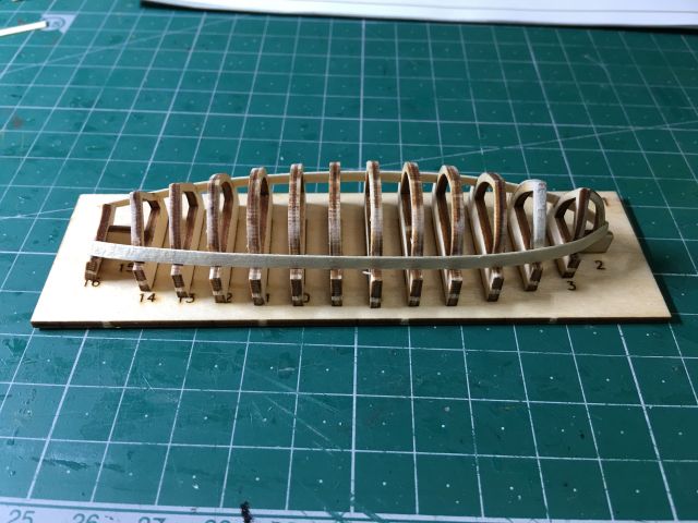

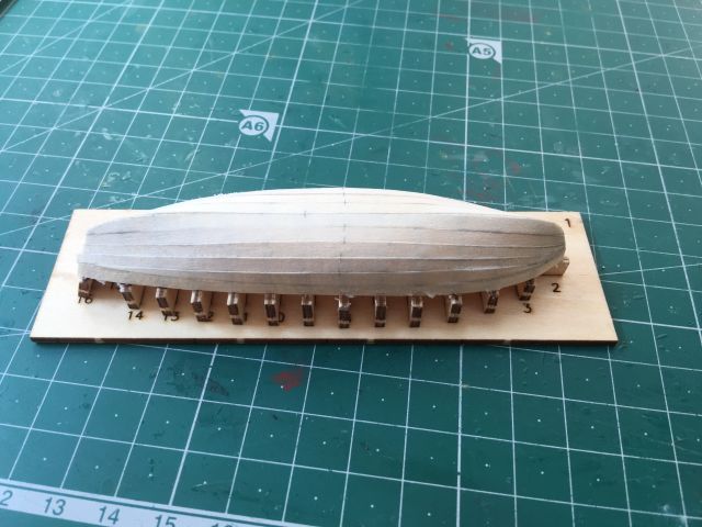

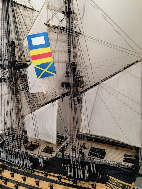

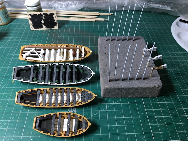

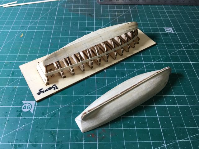

After being quiet (but still working on the ship) here is another update of my progress.
Issue 120 started:
- pennant and sign flags fitted
Various issues:
- pinnace frame assembled and planked
- barge frame assembled and planked
- boats removed from building jig, gaps filled with wood filler, then sanded smooth
- keels fitted
- all three boats painted inside
- floor boards cut to size, painted and fitted
- gratings cut to size, sprayed black and fitted
- thwart support rails added to pinnace and cutter
- inside of the top plank painted white on the barge
Happy building!
Laszlo

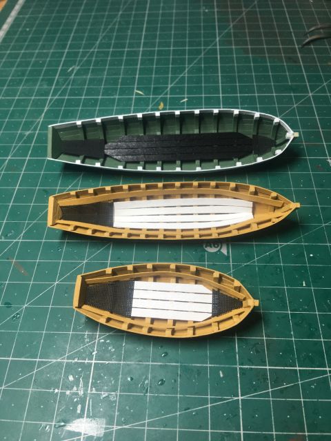

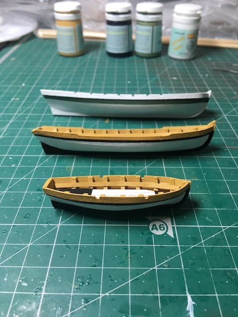

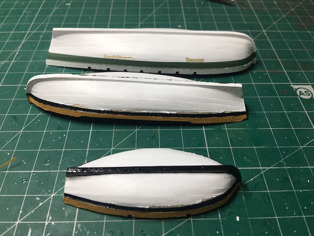

Hello Guys,
Thanks for the good comments.

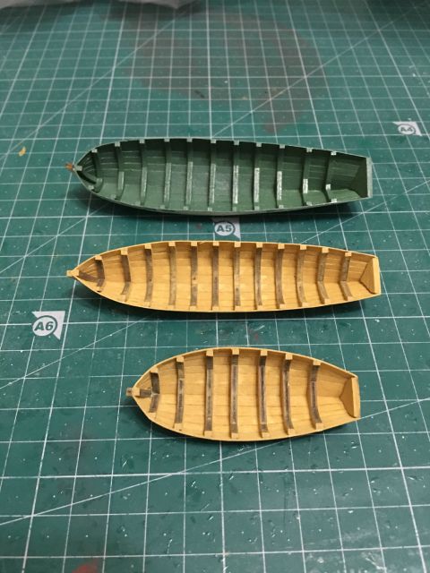

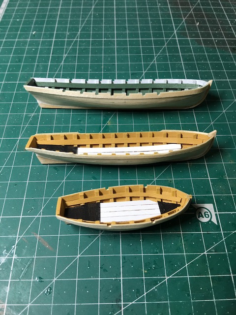

Various issues:
- enforcing planking added to the gunwales
- notches filed to the boats as rowlocks
- bottom of the boats painted white
- upper rows painted yellow ochre on cutter and pinnace
Then came the trouble...I don't know what have I done wrong, but when I removed the masking tape it peeled off the white paint from the hull Cursing Scared... I used the same masking tape I used earlier, never happened this before... maybe I sanded the hull too smooth, hence the paint didn't stick to it...
- I removed the flaking paint and masked the hull for the black and green stripes. Of course, same thing happened after I removed these masking tape too... Cursing Cursing Cursing
- I didn't see the point to use the masking tape again, because I was sure, that it will keep peeling off the paint. So I ended up painting the keels and correcting the missing white paint with free hand. Definitely this isn't a job to someone with shaky hands. BigGrin
Anyhow, I managed to correct the trouble and paint the keels without any noticeable error.
- thwarts and seats cut to size, painted and fitted to all three boats.
- barrel and bucket painted and fitted to launch
- three rudders assembled and started to paint

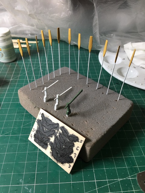

- oars sprayed with primer, started to paint with white
Happy building!
Laszlo

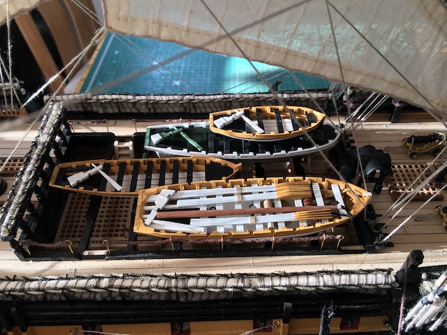

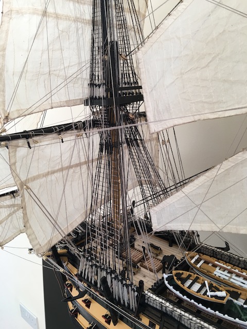

Hello Guys,

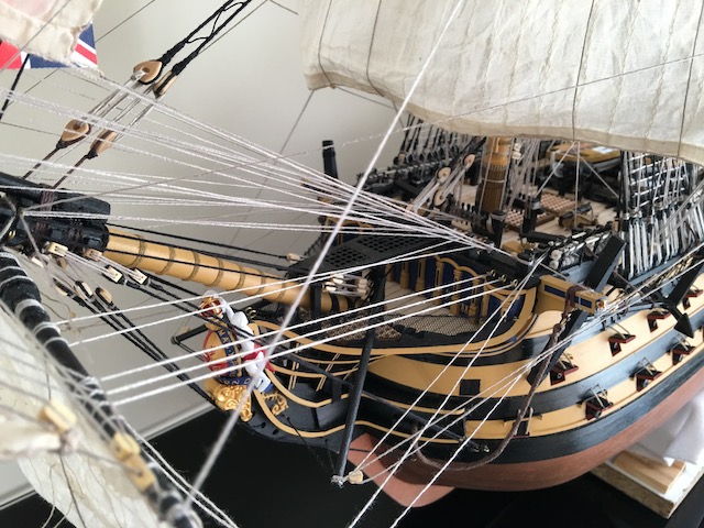

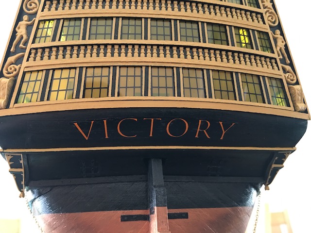

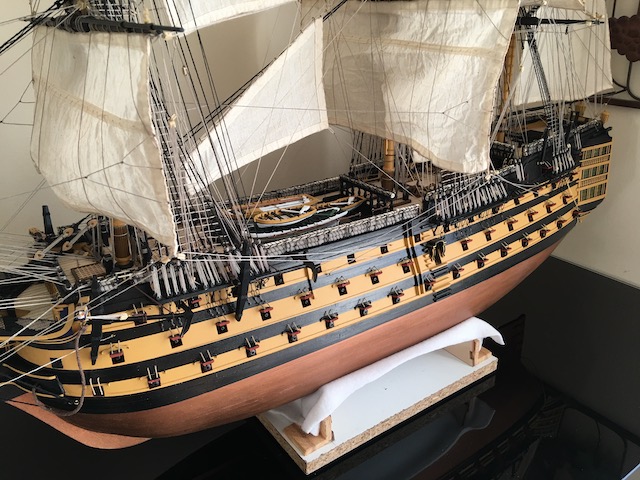

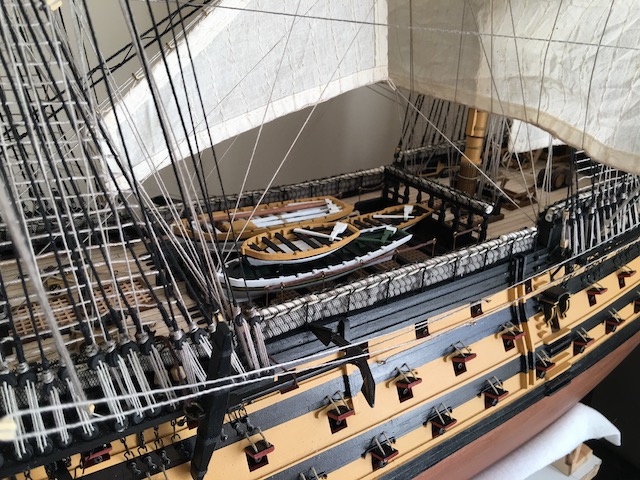

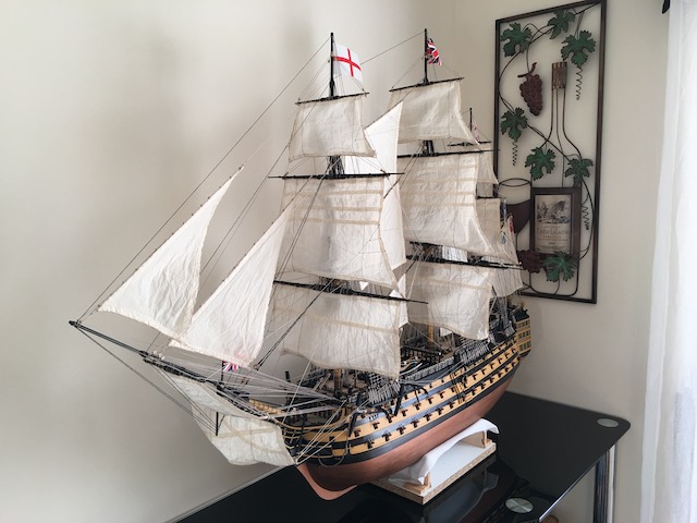

I proudly announce that the ship is now COMPLETED. BigGrin BigGrin Cool Cool
Last steps were:
- painting the oars and rudders
- fitting the boats to the deck
- applying the 'Victory' name to the stern
Net build time: approx. 2500 hours
Gross build time: 8 years, mainly in 2017-18
Thanks to all who followed my build diary.
My wife is very pleased that after one year she got the dining table back. LOL LOL LOL
MERRY CHRISTMAS EVERYONE!!!
I'll now start working on the display cabinet and will keep posting updates about the progress.
Happy building!
Laszlo

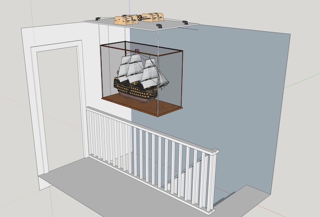

Hello All,

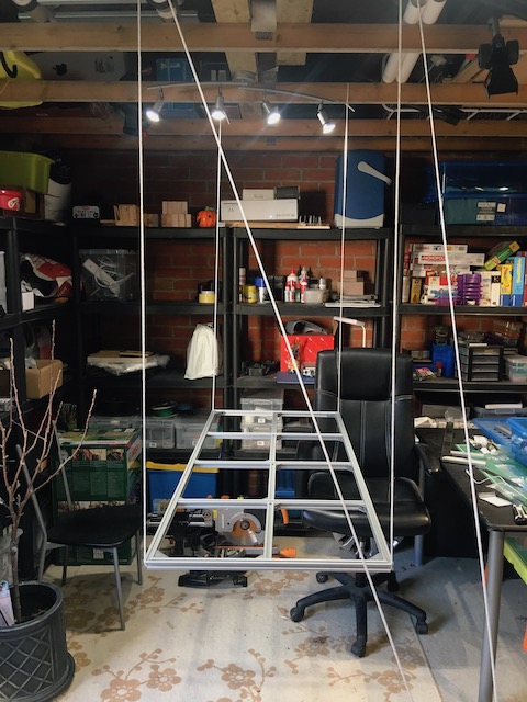

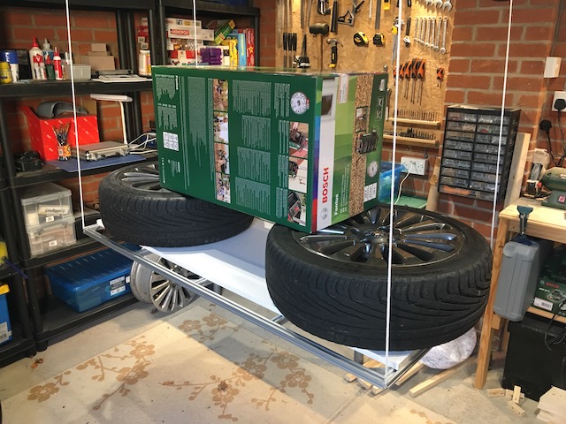

As I mentioned, I'll keep posting progress about the build of my display cabinet.
Although it's not a model, hopefully the admins won't have any issues with posting them here, as it's related to my Victory build.

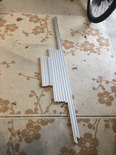

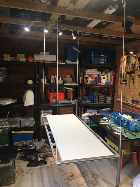

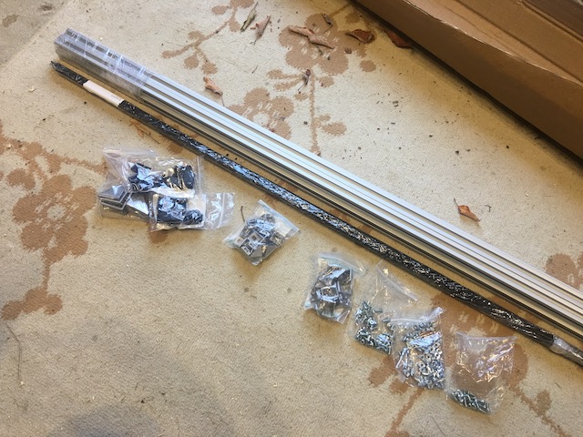

As a first step, I cut the 20x20 aluminium profiles to size and assembled.
It will be the frame for the base. Initially I wanted the base as a one solid sheet of wood, but I found it being way too heavy, hence the use of the profiles.
After assembly I hung it up with nylon ropes (as intended in the final design) and concept is ready for load test, as a first step mainly for the ropes. Cool
Total load of approx 45kgs placed on frame, the load represents the weight of the glass panels.
The ropes look OK (well, hope so, as they specified for 150kgs), however on the profiles I might need to go for one size bigger (30x30) because the long ones bend approx 6-8mm in the middle Blink Blink
Anyhow, as currently the ropes are the subject of the test, it doesn't really matter if the frame slightly bent.
I'll leave it hanging for a while... Obviously, I would be devastated if the cabinet would fall down... of course mainly for Health&Safety reasons but I also would be heartbroken for the ship.
Happy building!
Laszlo

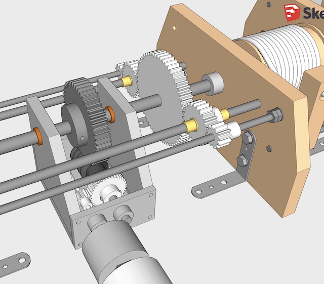

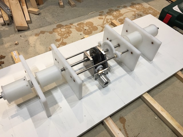

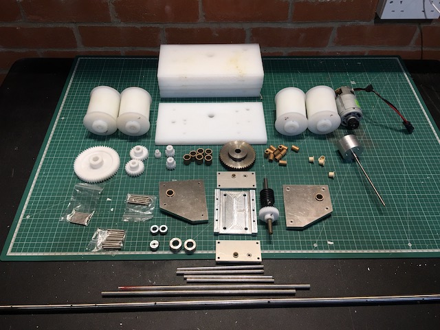

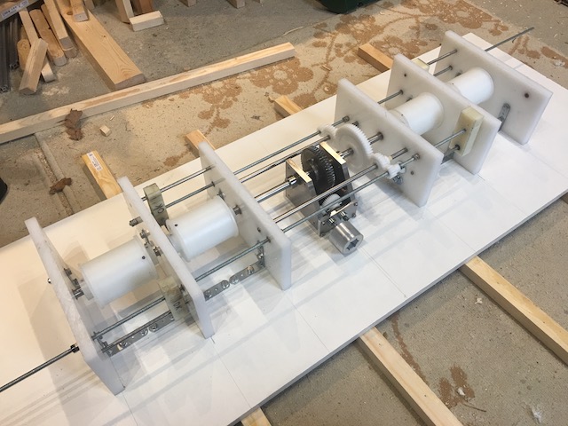

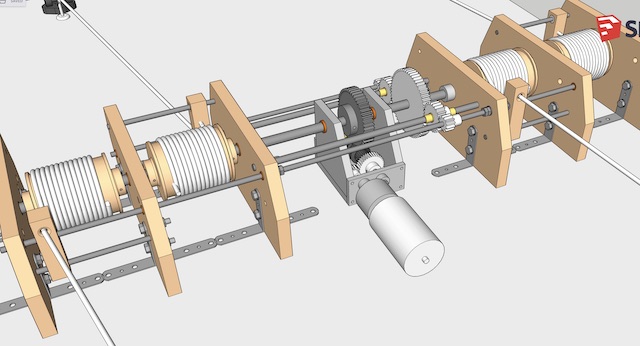

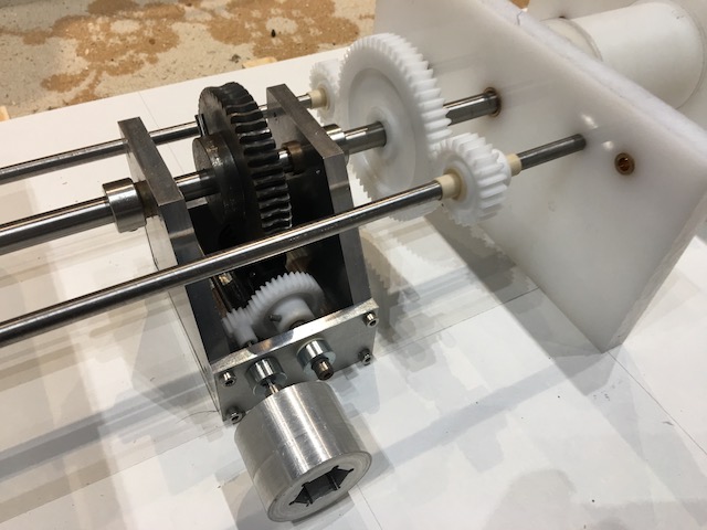

First, let me wish a late happy new year to all, I've been busy with my display cabinet lift mechanism.
- Gear box parts were machined (CNC) from aluminium.
- Vertical support brackets precisely drilled on CNC.
- All parts assembled.
End result is pretty much the same as on the plan. Cool Cool Cool
1st no load functional test performed... Passed... motor shaft actually driven by a battery screwdriver, but proves that the mechanics works seamlessly, four sliders (guide the rope for even winding) moves nicely.
You can check a video about trial on my public facebook album:
https://www.facebook.com/laszlo.for/posts/2293533973990756
Happy building!
Laszlo

Standing the boats oars in oasis and paint them....
