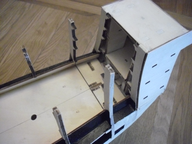

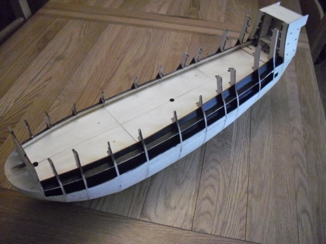

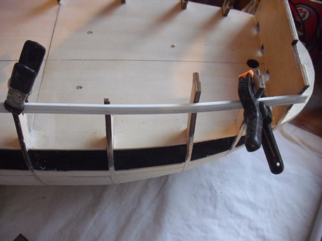

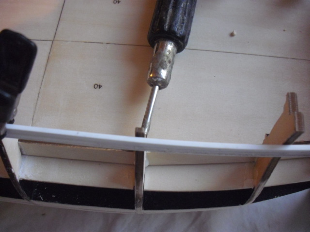

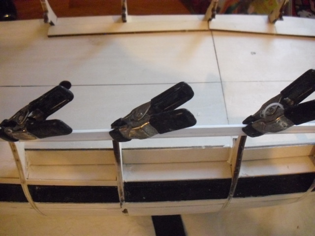

FITTING THE DUMMY GUN SUPPORT BEAMS
Hi All, you will notice I have done very little planking, I have concentrated on making sure the basic construction of the ship is to my liking.
During this process I noticed 3 ribs were off line so I cut them off and realigned them.
At this stage I can access parts of the ship easily, particularly when it comes to fitting the stern gun ports, which I want to have open not closed.
I have fitted the Dummy gun support beams, while doing this I pinned the beams through to the ribs,to make a stronger fix, plus I ran a good layer of adhesive along the back of the beam where it comes in contact with the deck, here are the photos:-
#588 Posted : 01 April 2013 16:47:01
Well thats it for this session, this is how the ship looks at the momentBigGrin Thank you for looking in,Kind regards Mike

Mike you may encounter a problem marking out the gunports as the cannon support beams are now fitted on the middle deck.The instructions will say to drill tiny holes from the inside in line with the top of the middle deck through the planking.This would enable you to mark the edge of the deck on the outside of the planking.All of the dimensions we are given for the gunports use the top face of this middle deck as a datum.All i can suggest is that when you do the first planking you make the top edge of a plank flush with this deck.You will then have a line to follow on the outside.
Regards Nigel
Regards Nigel
Hi Nigel,
I am not following all the instructions with my build, I am adding my interpretation of how the ship should look i.e. Offset bowsprit, deeper shaped hull at the stern,rear open gun ports and stern(transom) opening gun ports.
I will be cutting my gun ports at 12mm square (not 13) as this will represent a better scale size in my opinion. I will be adding frames for my gun ports and planking up to the exact measurements, with no need to cut out, as they will automaticaly appear as the planking is fitted.
I hope this answers your question.
I am looking forward to seeing your build,BigGrin thank you for looking in
Kind regards MikeBigGrin

No worries mate just didn't want you to end up in a pickle,but you've obviously got it covered.My gunports are all cut but if i was to do the build again I'd drop the lower ports by 5mm the gap between bottom and middle ports is to small as designed by deag.
Regards Nigel
