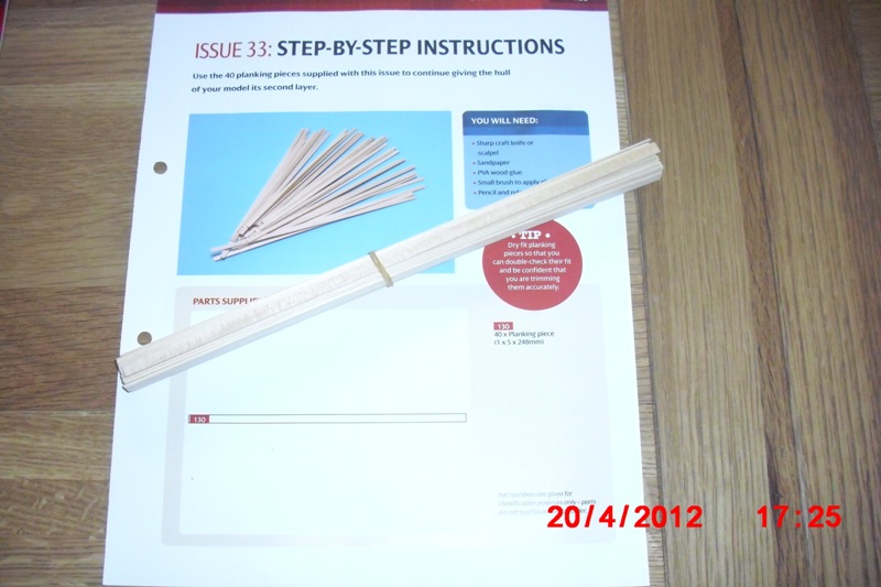

#585 Posted : 20 April 2012 19:27:41
ISSUE 33
We received more planking for the second sheathingBigGrin Regards Mike

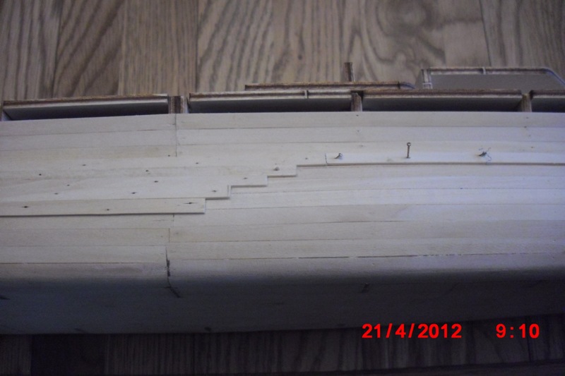

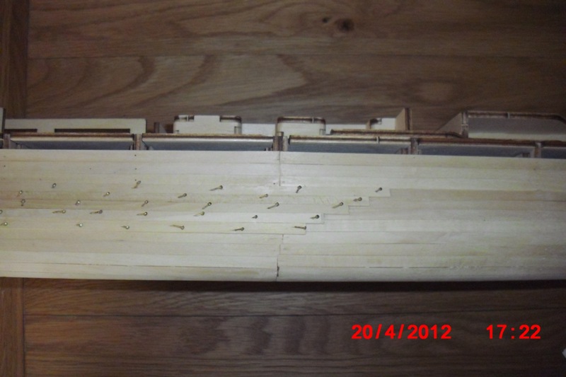

Here you will see I have started the second planking, some of the planks are thinner than others but this will not be a problem as we will be sanding again when the planking is finished.BigGrin Prepare your first planking by sanding and shapeing well.
Please make sure you step the planking as in my Photos, and use pins with PVA, to fit the planks, the PVA is easy to wipe off the wood ,contact adhesive is to messy and not easy to wipe off, and the vapours are not good if someone in your family is asphmaticBlink
Regards Mike BigGrin Comments and Questions welcome

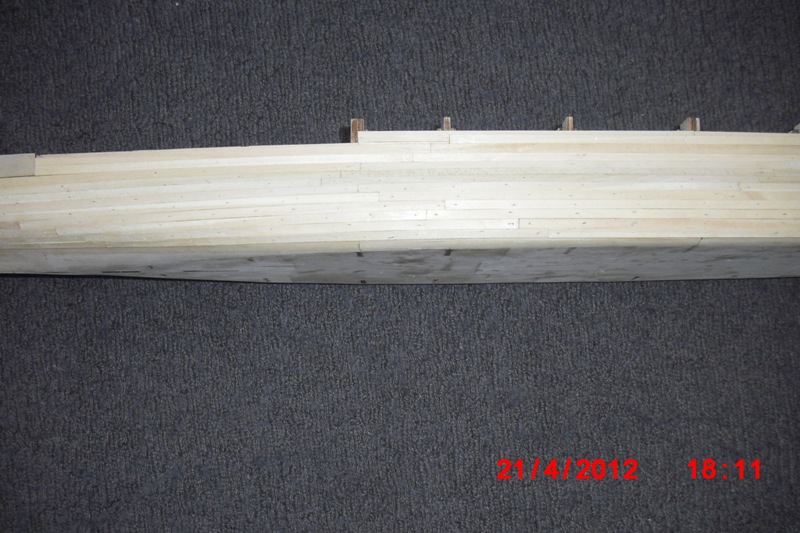

#590 Posted : 22 April 2012 12:32:01

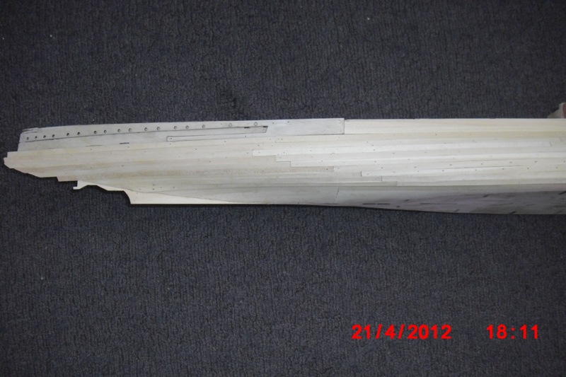

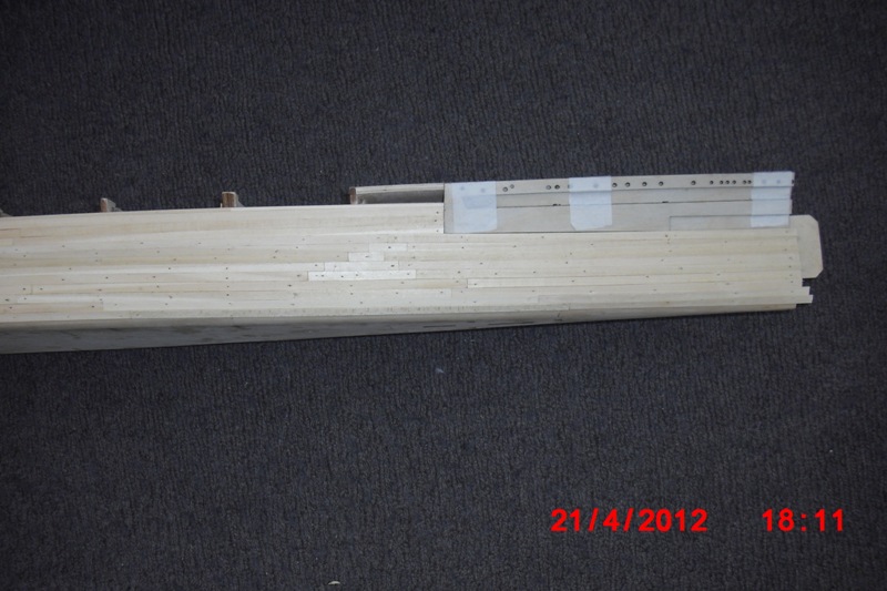

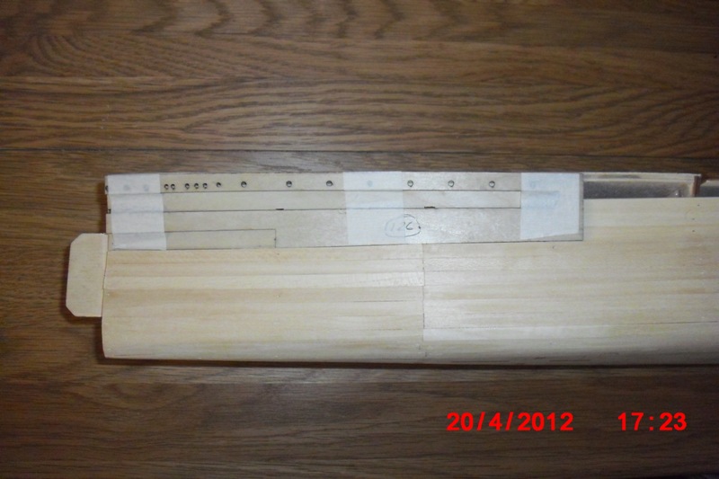

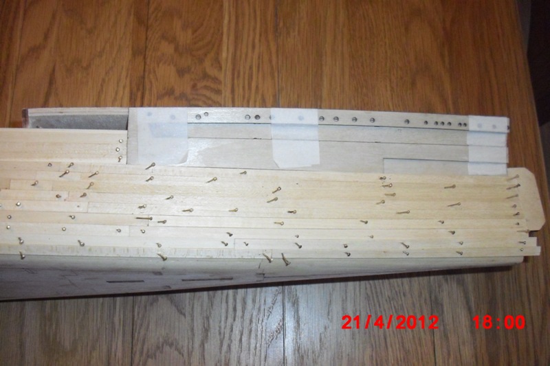

SECOND PLANKING ISSUES 29 to 33
Hi Team,
Here are more photos of the second planking. Please notice the stepping of the planks, we also need to bevel the planks so that each plank butts up to each other as the planks go around the Hull and curved parts.
When I started the second planking at the rear (as per the instructions)I then ignored the sequence in the instructions and planked the whole starboard side in one go, made much more sence to meBigGrin Have a look:-
Regards Mike
PS I chose to use lots of pins to fix the planks with PVA adhesive. Please note if you use this method you must fill in all the pin holes before sanding as all blemishes will be seen, it is more important on the second planking than on the first.
I believe the fixing you get with the pins is worth the extra workBigGrin Questions and comments welcomeBigGrin
