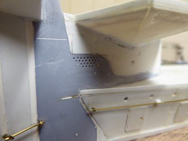

On the original conning tower there are two sets of small free-flood holes on each side. Due to extensive scratch-building some of these had been filed away, so it was a case of opening these back up, albeit with a slightly different pattern as per my b/w photo.
The attached photo shows the starboard side. The three small dimples on the right hand side are the locations of the original holes and these will be filled in and sanded smooth at a later date.
#584 Posted : 21 December 2018 09:24:22

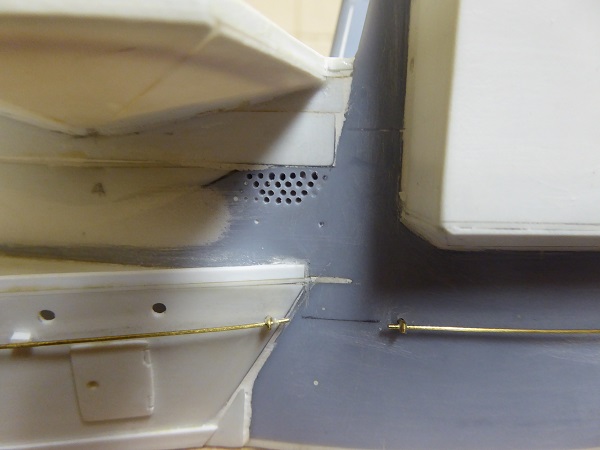

The attached photo shows the free-flood holes opened up on the port side. As with the starboard side, the holes to the left are the originals and will be filled and sanded.

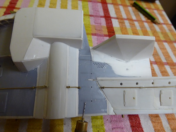

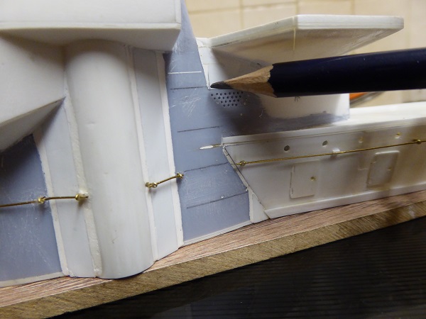

The next step was to mark out the locations for the steps that lead up each side of the conning tower. The attached photo shows the horizontal lines being drawn out using the 'pencil clamped to an engineers square' method.LOL
#586 Posted : 21 December 2018 09:30:15
All marking out finished on both sides including the vertical lines. These were drawn on after a bit of measuring to ensure the step location holes would be drilled to the correct width.
This photo shows the step location holes being drilled out with a 0.55mm diameter drill.

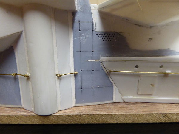

#587 Posted : 21 December 2018 09:31:22
All location holes drilled out on both sides. Port side shown in this photo.

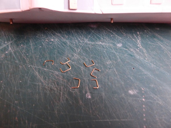

I then made up 8 steps using 0.5mm diameter brass rod. I bent them around a piece of wood which happened to be the correct width and checked them against my drilled holes for alignment.

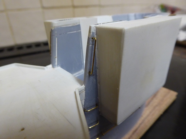

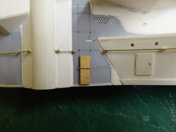

This photo shows the first step being test fitted using a piece of balsa as a spacer to ensure all steps protrude equidistant.
#590 Posted : 21 December 2018 09:39:47

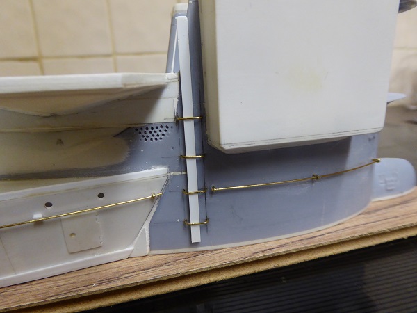

#595 Posted : 04 January 2019 09:25:51

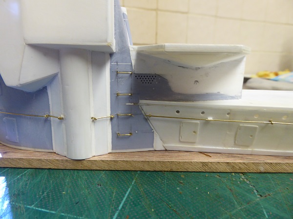

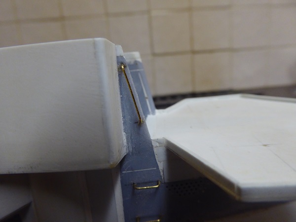

This update continues with the addition of the step ladders to the sides of the conning tower.
The attached photo shows the four steps fitted to the port side.
#596 Posted : 04 January 2019 09:28:31

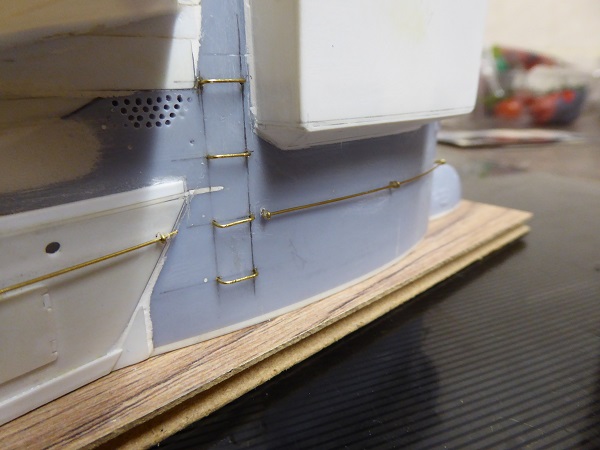

The attached photo shows the steps fitted to the starboard side of the conning tower with a 1.5mm square strip used as a spacer to give them equidistant depth.
#597 Posted : 04 January 2019 09:30:41
Spacer removed, steps completed.
#598 Posted : 04 January 2019 09:33:20

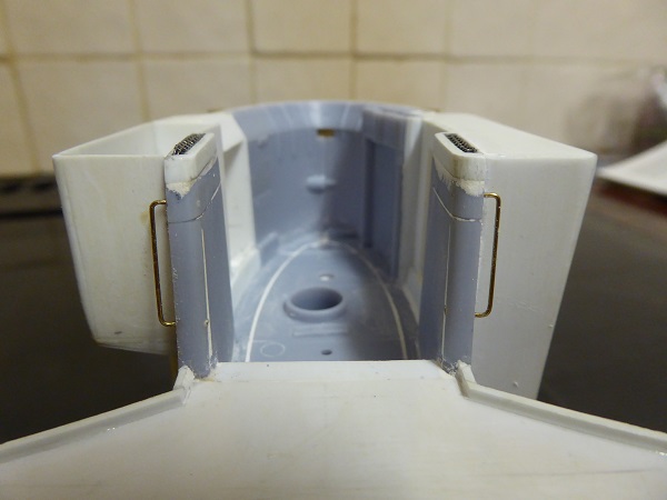

I then made and fitted grab-handles using the same technique and method used for the steps. The attached photo shows the port grab-handle.
#599 Posted : 04 January 2019 09:34:11
This photo shows both grab-handles fitted.
#600 Posted : 04 January 2019 09:35:10
Starboard grab-handle.
