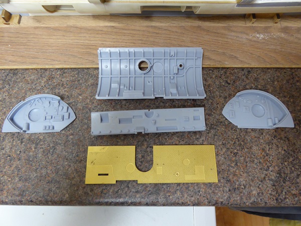

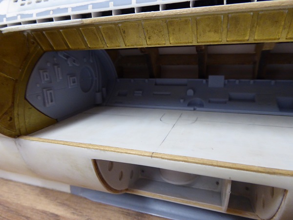

#587 Posted : 03 May 2017 22:24:41
Good Evening from 'The Dockyard'.
In this weeks update of my U230 U-boat build log I will be looking at the part-works supplied components that make up the Control Room; forward, aft and port side bulkheads, deck [floor] and deck head [ceiling].
The attached photo shows the parts laid out next to the boat.

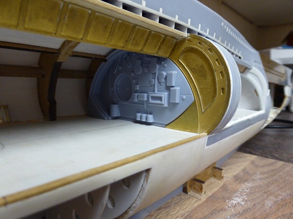

#588 Posted : 03 May 2017 22:35:27

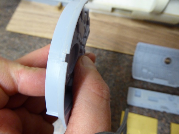

In an earlier part-works issue the instructions tell you to remove part of the hull above the Control Room. The reason is to make it easier to fit the parts mentioned before. I didn't really want to do that as I had spent a lot of time fitting the planking that would then have to be cut away only to be refitted later.
Because of this decision I had to cut out grooves in the forward and aft bulkheads so that they would fit around the MDF supports. The attached photo shows the forward bulkhead with the groove cut out.
#589 Posted : 03 May 2017 22:37:53
All the parts at this stage are dry fitted to check for alignment. Later on in the build I will paint and fit them out with the part-works supplied details such as; valve hand wheels and bulkhead handles.

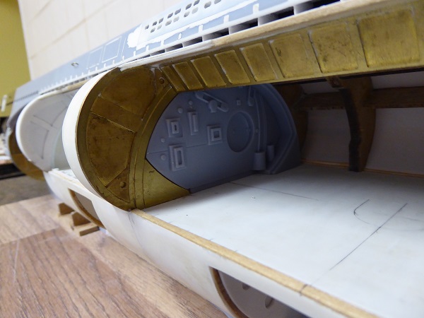

This photo shows the forward bulkhead in place.
#590 Posted : 03 May 2017 22:39:03
The aft bulkhead in place.
#591 Posted : 03 May 2017 22:52:28
From the previous photos of the forward and aft bulkheads you can see the etched brass saddle tank profiles. These parts had to be extensively filed to match the curve of the saddle tank and for them to align with the bulkheads.
As a side note i have been checking the German part-works issues to establish what to expect and the fitting of these brass profiles doesn't happen until issue 148; the part-works instructions show the fitting of these appears to be very straight forward but that wasn't the case.
I collect issue 140 this week, so i'm glad I took the time to fit them now rather than have to file and sand them later when the U-boat is painted and weathered.

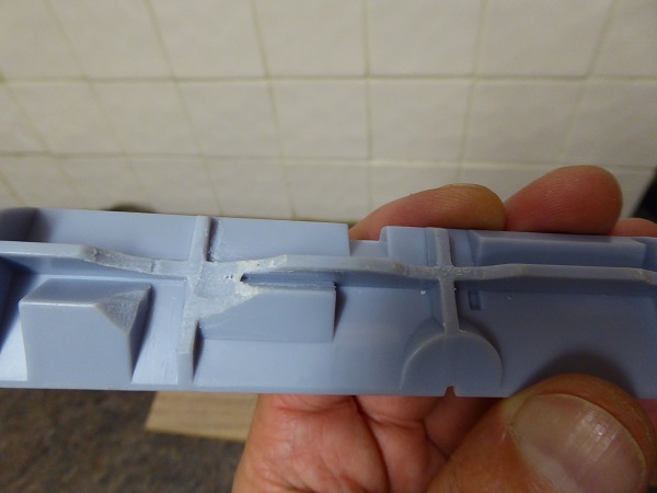

I also had to grind away most of the locating side of the plastic port side bulkhead and deck head to get them to align as the moulded ribs that act as locators were preventing the parts from fitting correctly.
The attached photo shows the port side bulkhead with the locating profiles filed out.
#592 Posted : 03 May 2017 22:53:34
Another photo of the port side bulkhead.
#593 Posted : 03 May 2017 22:54:37

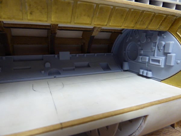

Port side bulkhead test fitted looking forward.
#594 Posted : 03 May 2017 22:55:18
Port side bulkhead test fitted looking aft.

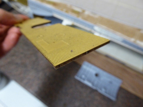

#595 Posted : 03 May 2017 22:56:54

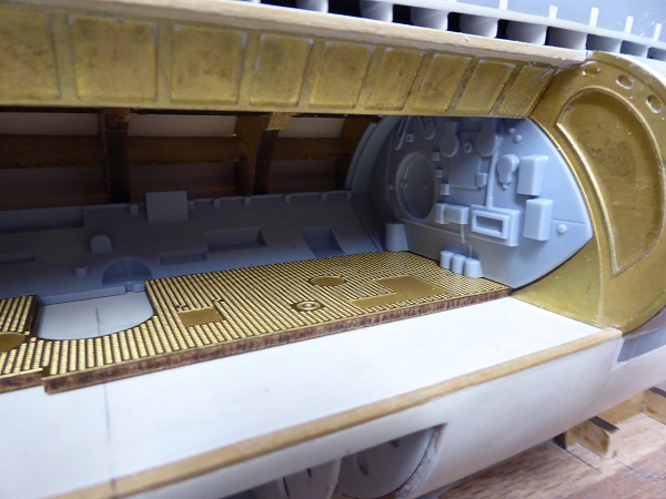

This photo shows the part-works supplied etched brass tread plate fixed to the MDF deck.

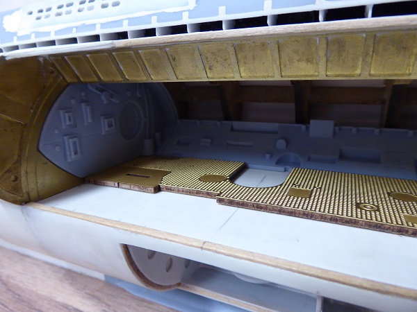

#596 Posted : 03 May 2017 22:58:34
The deck and tread plate in place. Only a small amount of filing was required for it to slide underneath the forward and aft bulkheads.
#597 Posted : 03 May 2017 23:00:20
Deck fitted looking aft.

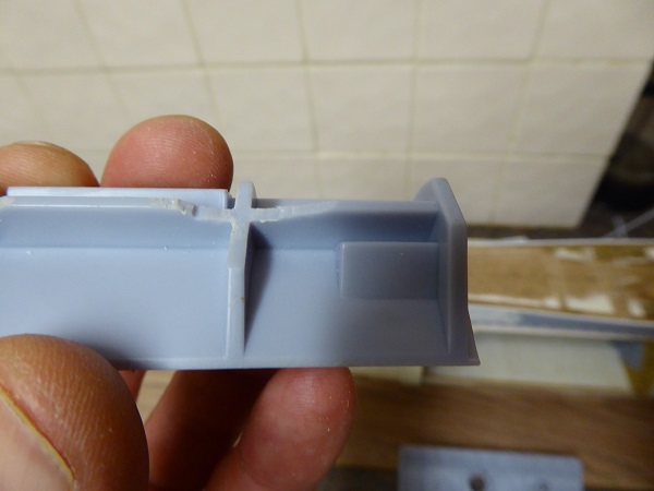

#598 Posted : 03 May 2017 23:02:04

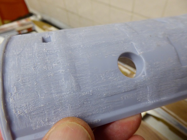

This photo shows the underside of the deck head [ceiling]. This part proved to be the most problematic to fit to such an extent that I had to remove all of the moulded locators with the dremel.
#599 Posted : 03 May 2017 23:04:29
Another photo showing the extent I had to go to make this part fit by removing everything on the underside that was preventing the deck head from fitting correctly.
#600 Posted : 03 May 2017 23:06:20
Another photo of the underside. Plastic shreds covered the floor by the time I had finished!Blink
