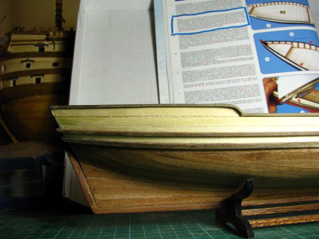

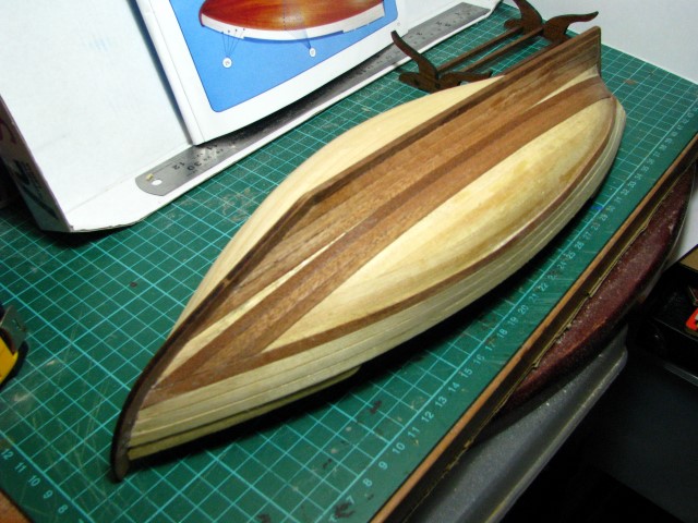

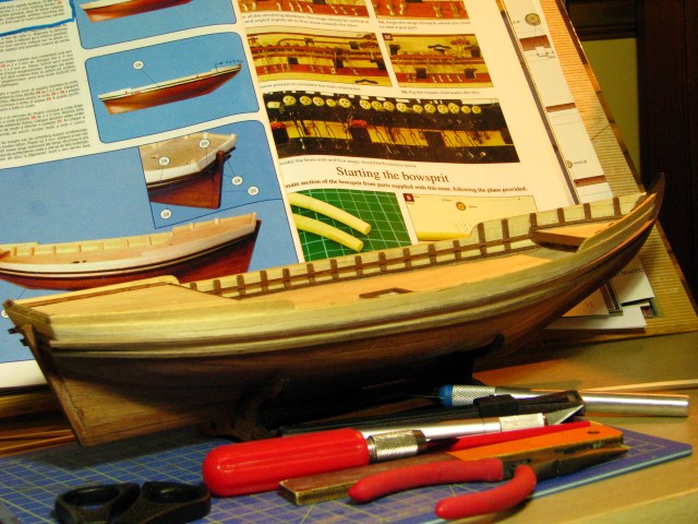

UPDATE #11
Thanks for all the kind words and help.

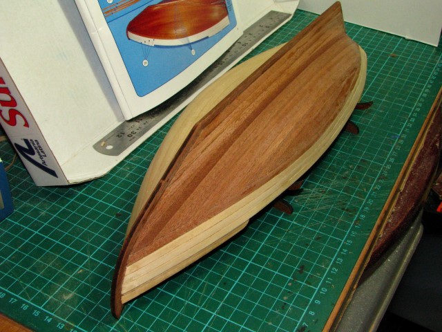

Well I've almost finished the 2nd planking and I've hit a snag. This is the first time I've built a model which needs a second layer of planks so this is all new to me. I found that I was having problems getting the tapered ends of the veneer to adhere to the hull so I used 'Zap medium CA' glue here to get a strong bond. Despite my best efforts, some of the glue 'leaked' over the veneer that was already laid and in smoothing off, a white residue has been left on the planks which I can't seem to remove and I'm concerned that if I apply sealer before sanding and varnishing, that this discolouration will show up on the finished build Confused Blushing Crying. My thoughts are that I may end up having to stain the veneer to cover it up. Any comments very welcome.
Happy building and thanks for looking in
David
Ive posted a few photos of the work in progress

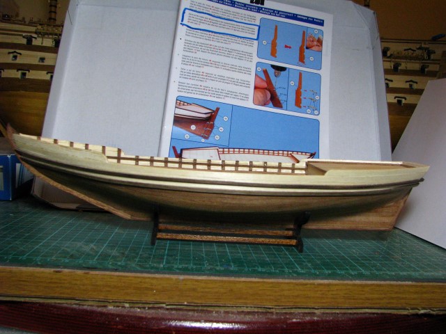

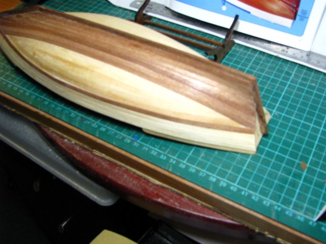

UPDATE #12
Welcome back guys.
The 'rubbing strakes' have been added to the hull, and I was ready to move on to fitting the 'gunwale capping' but the timber provided in the kit - 1.5 x 4mm walnut - isn't wide enough to allow a slight overhang along the outside of the boat, so have remedied this by ordering some extra timber from Cornwall Model Boats. It'll probably take a couple of days to arrive so I'll get on with some other jobs in the mean time - the 'rudder' assembly is next so will get on with that to fill the time gap.
Happy building and thanks for looking in.
David

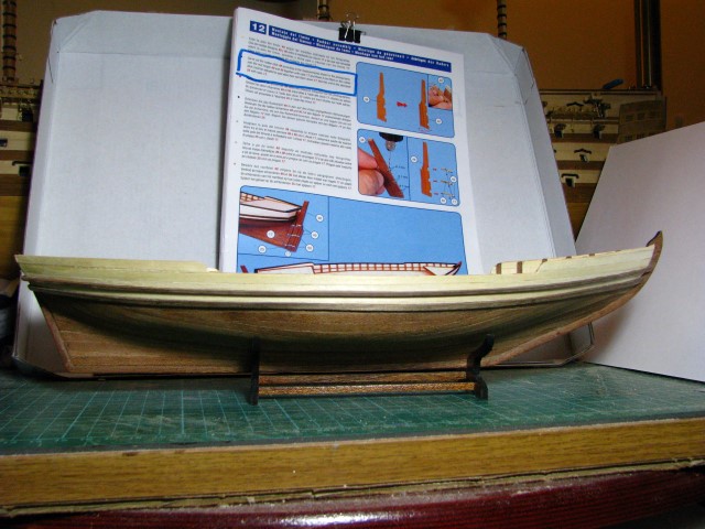

#46 Posted : 27 January 2014 19:57:25
Looks great. by now you will have noticed the stand is not a great fit alsoBigGrin
daffy09
#47 Posted : 27 January 2014 21:14:44
Joined: 08/07/2010
Posts: 1,036
Points: 3,086
You're right there Jase. Think I'll add something to pad it out a bit, a piece of self-adhesive draught excluder might do the trick.
Happy building
David

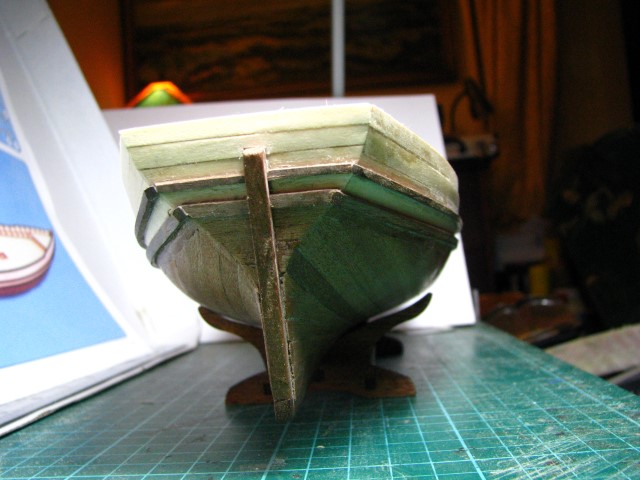

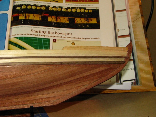

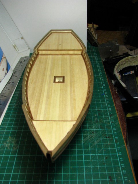

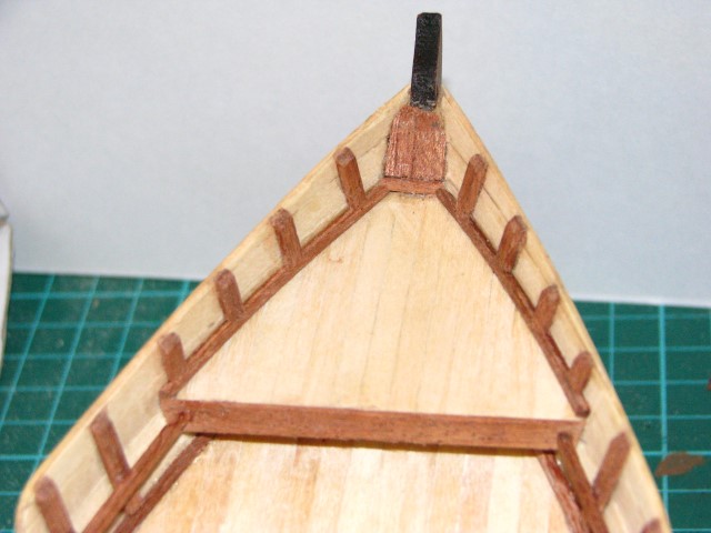

UPDATE #13
Hi and thanks for the comments.
My walnut strip arrived today so I got on with adding the 'Gunwale covers' all round which is now completed.
The walnut strip supplied with the kit - 1.5 x 3mm - wasn't wide enough to leave a lip all round above the the basswood veneer, so with the new walnut strip - 1.5 x 4mm - I started the capping. A 'low-tech' solution was used to achieve the contours of the hull - the strip was left to soak in very hot water for about 45 minutes, taken out and worked between my thumb and fore finger along the length to achieve the desired curve. For shaping the curved ends, I used an electric plank bender, but because the curve required is very sharp, the plank bender was not sufficient to finish the job, so I resorted to 'soaking - bending by hand - and re-soaking' the planks until the necessary curve was achieved.
After dry-fitting to check the lengths lined up okay, the strips were subsequently glued into position using 'Zap Slow-Zap thick CA' glue.
That's it for now and thanks for looking in
Happy building
David
A few more pics of work completed:

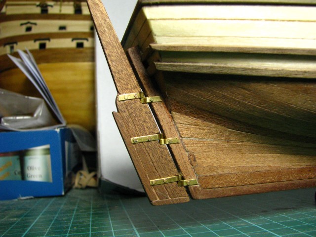

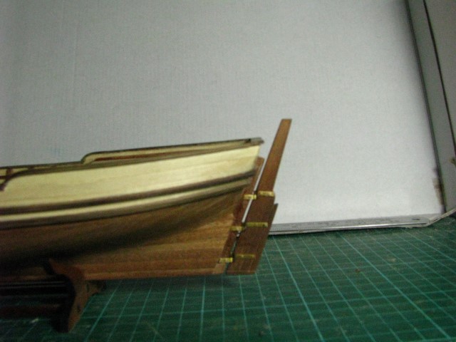

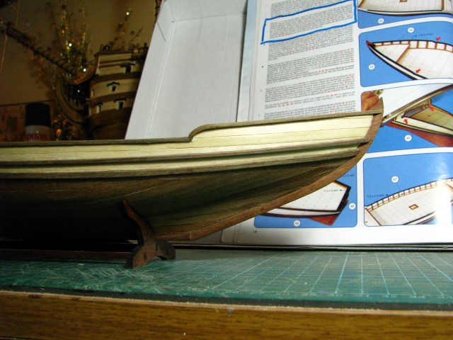

The rudder assembly has now been made up and fitted, but the instructions leave a lot to the imagination, giving only minimal information, but the photos are quite self-descriptive. The lines were made following the measurements with a steel rule and a scalpel. They were then given more definition using the sharp, pointy end of a needle file. The part was then sanded to get rid of the laser burn on the edges and followed by a polish up with 'Micro Mesh'.
The instruct
ions go on to say to fix the brass hinges with nails but its plain to see what would happen if I did. So what I did was to drill some guide holes with a 0.7mm bit, cut the nails down to 3mm in length, carefully located them through the hinge and into the guide hole, then used the 'pin pusher' tool to drive them fully home.
Fitting the assembly to the stern post wasn't exactly straightforward: the brass parts were too long so had to be cut down to fit which left only one hole instead of two. This was remedied by using CA glue to hold them in place, then using the same technique as on the rudder - drilling pilot holes, cutting the nails to 2mm, locating with fine point tweezers and driving home with the pin pusher.
The next stage will be the painting and fitting of the decorative embellishments around the stern deck.
Thats all for now and thanks for looking in, as usual, comments welcome.
Happy building
David
Pictures of the rudder in place on the build:
