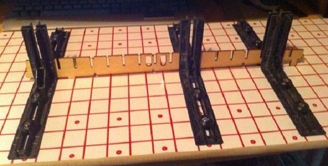

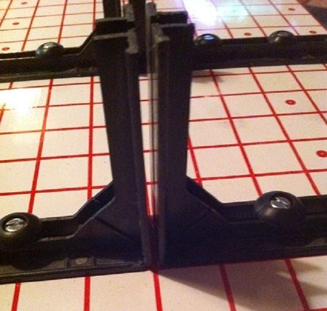

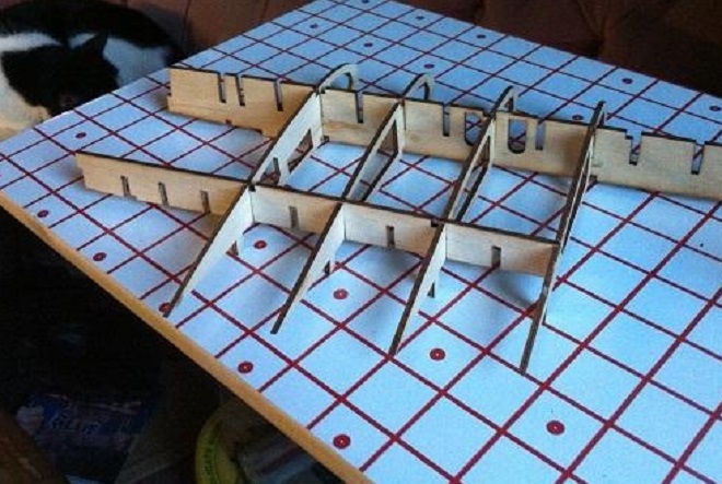

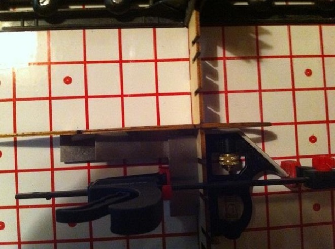

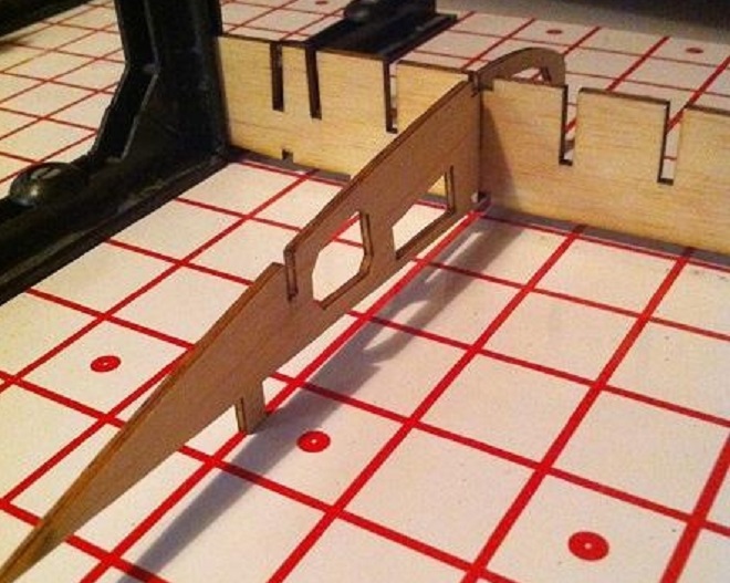

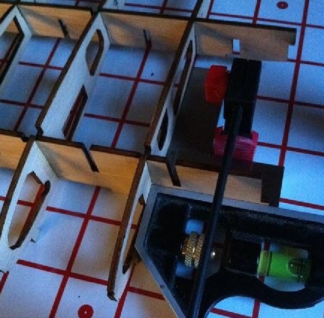

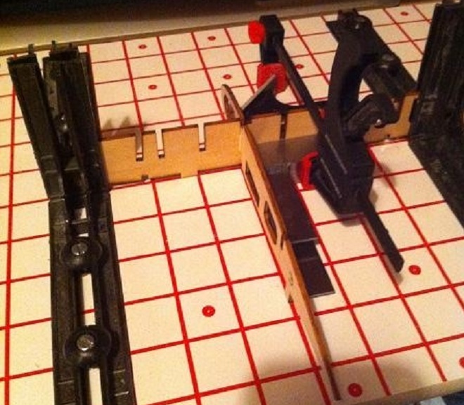

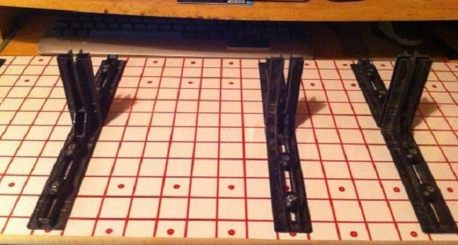

This is the start of the right wing build,(inc the jig).
I used this jig to set up my Victory build and have adapted it for the Spitfire.
The jig consists of a grid base and right angle brackets, as below Pic 1.
I spaced the brackets at different distances apart to allow for varying gaps between the wing ribs.Pic 2
This then gave me a sliding clamp for the main wing spar. Pic 3
I could then position the first wing rib and place it directly on one of the grid reference lines. Pic 4
It was then a case of positioning the clamps to make sure all angles were ok, then remove the rib, apply adhesive, replace the rib and allow to set. Pics 5+6
From this point all I had to do was slide the main spar right or left, to get the next rib in line with the grid and duplicate the last procedure.
The next picture shows the rear spar in place (not glued) to aid in the setting of the ribs. Pic 7
Having set a firm base frame, for the next rib I removed the rear spar, glued the next rib, put it in position and then clamped it in place with the rear spar as an extra support. Pic 8

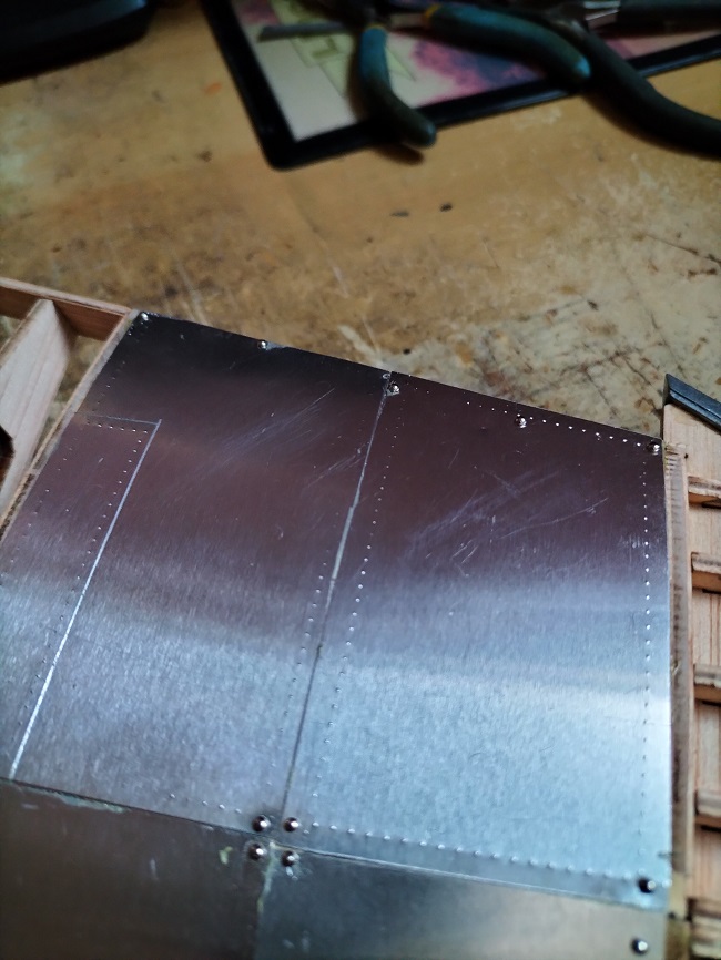

Enough of all that, here`s some productivity on the Spitfire, you will see some marks where the pins have been hammered in and the strike was not exactly on target.
Depending on how many marks are made will depend on whether I go the painted/unpainted route. Just doing the best I can as I`m fed up not building.

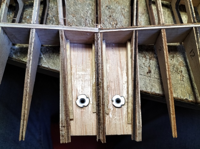

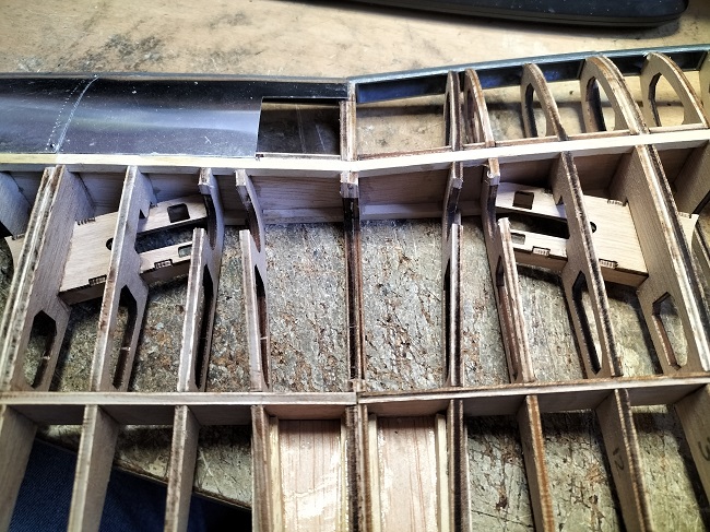

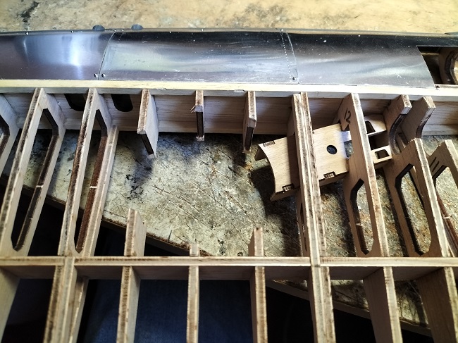

UPDATE BigGrin :
I`ve done some bits and pieces ( not necessarily in the correct order) so I can make some more progress.
Pic 1: added another panel.

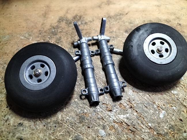

Pic 2: start of the undercarriage.
Pic 3: undercarriage box sections made and fixed plus cut away sections.
Pic 4: First wheel well cut away.
Pic 5: Rear of wing mounting plates fitted.
That`s what I`ve managed in four days, but at least its progress.Blink
More to follow when enough to post.

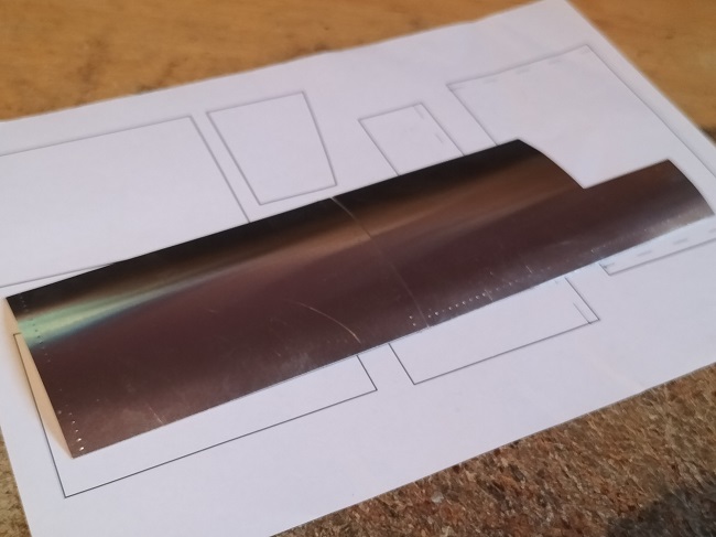

#59 Posted : 16 March 2022 18:12:10
Hi all, BigGrin
Just a small update for now:
Have made up the next two plates for the right wing, (see attached pic).
Need to purchase some new sand paper tomorrow, before I can proceed with fitting them.

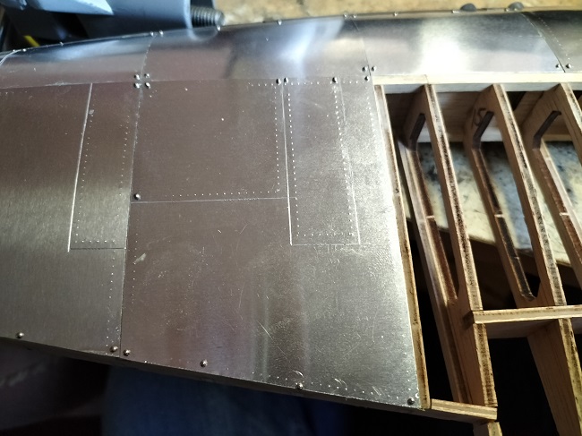

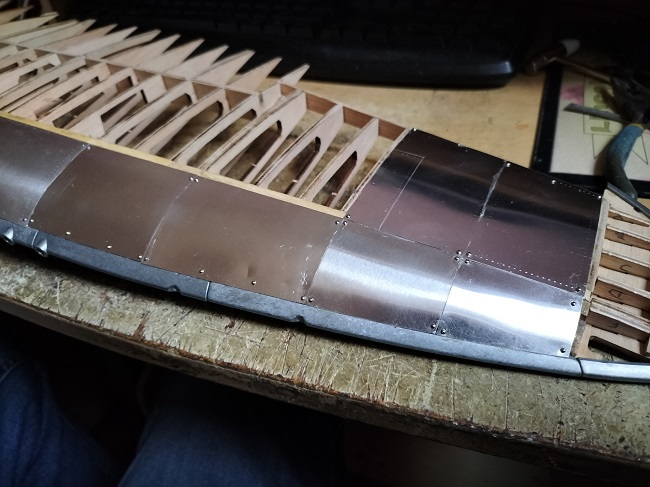

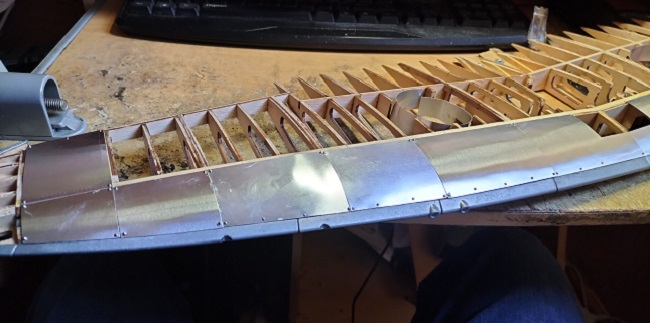

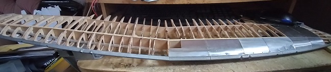

#60 Posted : 31 March 2022 19:07:30
Hi All, BigGrin

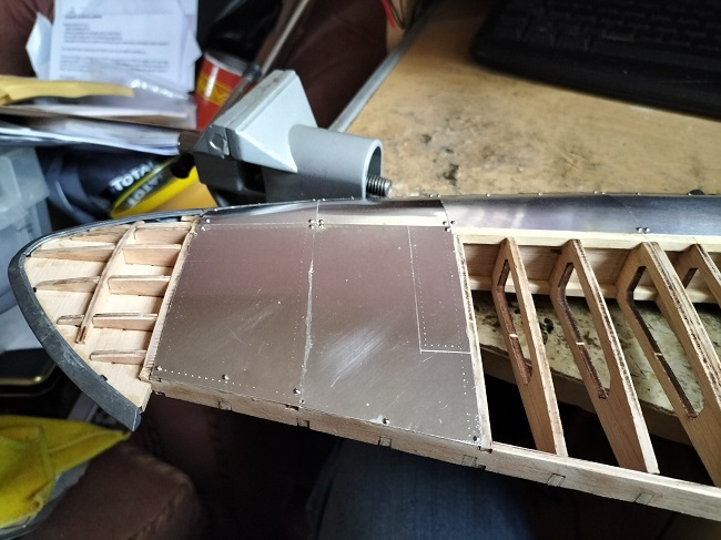

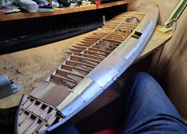

Some more progress made on the wing plating.
I`ve now managed to get the right wing leading edge plates completed and the first rear plate done.
I`m thinking that I`m still on course to finish this in the shiny metal finish, but time will tell. Still lots of panels to fit and if that goes ok, then a good polish up before the final decision.Blink
Have attached a couple of pics of recent progress below.
