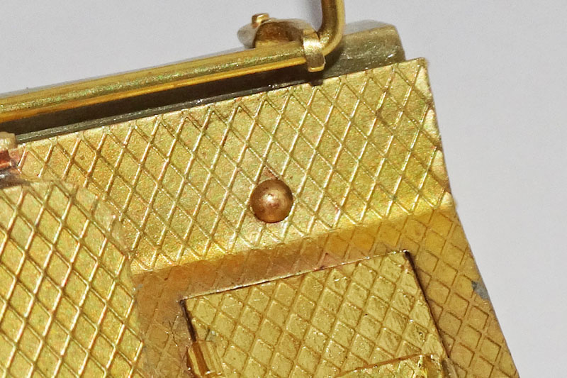

D51 Parts 03 use of brass rivet instead of M2 screw in side steps
In post 26 I soldered the side steps in place and explained that I aimed to replace the M2 screw that would normally hold the side steps with a rivet.
I obtained some 1/16" brass rivets and after cutting to length these were soldered in place. The rivet head fits the space left by the missing screw perfectly.
Since the screw is missing where a checker plate type effect is present, soldering up the hole and blending in is not possible.
In later part sets of this model other areas are similar, such as the running boards so the rivets will prove an ideal solution.
I feel that the rivets look authentic.
Dennis

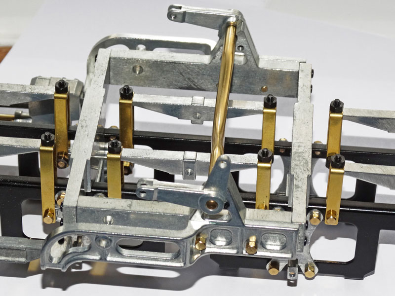

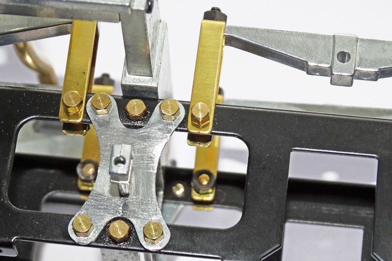

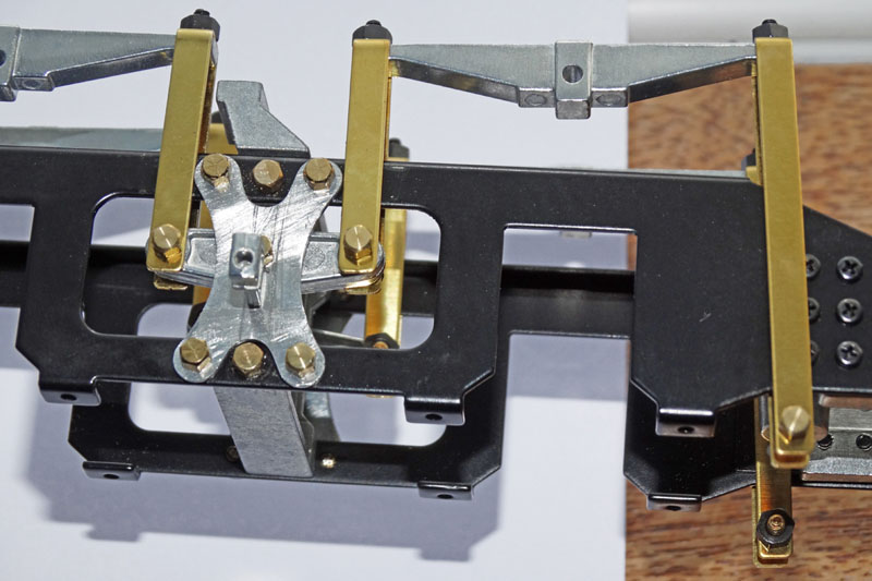

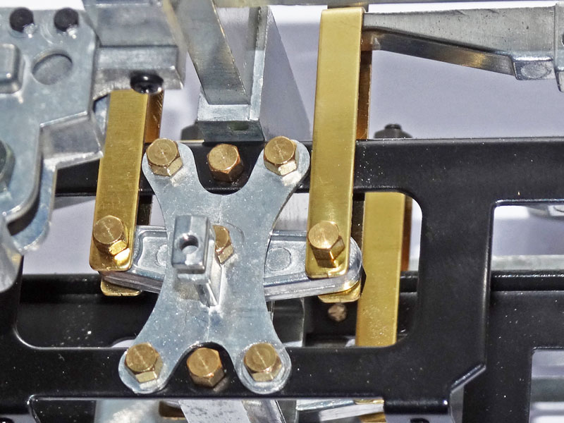

D51 - parts 06 - 21/22/23
Parts 06 were straightforward. I have made extensive use of the hexagon headed brass screws. All the nuts on the suspension have been threadlocked in place.
I must agree with other postings that the quality of not only the parts but the packaging is excellent. In this the latest set of parts I was particularly impressed by the double packaging of the bushes and nuts.
I have not worked on parts 06\24 since I will leave the wheels and the motion gear until either the chassis is complete and painted or other parts can only be fitted once the wheels etc are in place.
Sorry but I have now moved all the images to posting 49 having now mastered presenting them as visuals.
Dennis

Following some communication and help from Karl.I am putting on the same set of D51 - 06 pictures as direct view rather than download.
Dennis

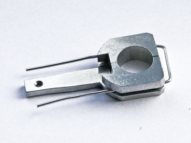

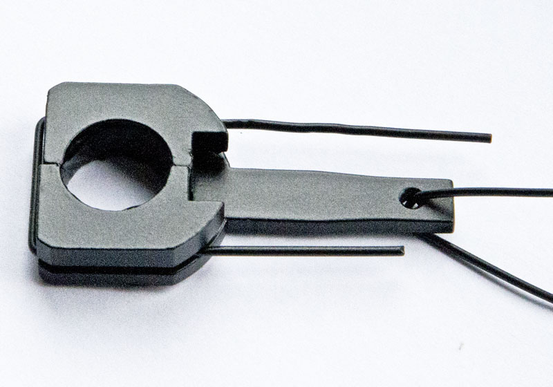

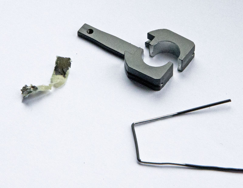

Parts 07 - Hornblocks
Now that parts 07 have arrived I was able to start painting various components.
The hornblocks needed to be black but how to hold them. In the end I found that a reshaped paper clip could be easily slid into the chassis groove. This held the two halves together.
To protect the axle bearing surface I used a coating of liquid mask. The 2mm screw hole provided an excellent way to hang the hornblock using wire when spraying.
I checked the castings over first removing any burrs with a needle file. The parts where clipped together and degreased. The bearing surface was then protected with mask. Once the mask was dry the hornblocks were airbrushed firstly with etch primer, then primer followed by an almost matt black.
Once dry the clip was removed and the layer of mask easily removed. Slight removal of paint was required from the edges of the bearing surface using a scalpel.
I have left the mask residue on one of the images so you can see the result.
I will run a tap through the threaded holes to remove any paint.
I will now follow up with the wheels. At this stage I am wondering how to prepare the motion gear, rods etc. I am not sure that paint can provide the correct appearance. I may try light bead blasting followed by matt lacquer. Any thoughts?
