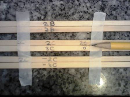

With all the knots in the bamboo strips, I came up with the idea to mark and tape the strips in place on my bench.
After I checked my stock of bamboo strips for knots and flaws, I locate a suitable place for the the strip, so that the knot do not to interfere with the pins or bending process (the knots have the tendency to break). I avoid placing the knots in a bend/twist or on a rib. I want the knot in the strip to be relaxed in the middle of two ribs.
The strips are marked according to their location:
(Row 1)
Starboard 1A; 1B; 1C
Port-side -1A; -1B; -1C followed by Row 2, etc.
The strips are now taped down on a flat surface in the order they would appear on the hull. I study the seams for gaps and dips as illustrated in the photo at the pencil. The bad ones get marked and replaced.

NMBROOK
#50 Posted : 23 August 2013 15:26:53
Good work MarcelCool A very thorough and logical approach to solving the issues with the bamboo.
Kind Regards Nigel
#51 Posted : 23 August 2013 18:58:40
Hi Marcel, a very simple but very effective idea and I am surprised it wasn't thought of before..... Lovely work, keep it going....Cool Cool

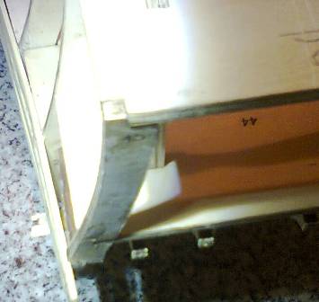

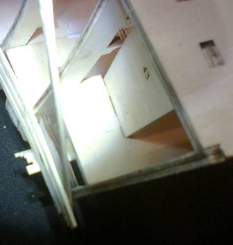

I am a bit worried about the trimming of the planks under the gallery.
Instructions says (Issue #17) to cut the strips beyond #30 brackets and trim it untill anligned with the profile of of rib-frame 27.
I laid the first 3 rows from Bow to Stern before I planked the Underside of Gallery. This will give me an idea of the profile of the stern's underside.
Blink I want to know the distance of the planks from centre to end where hull's side planks will join with the underside.
I want the underside to have a natural inwards curve to the end of the keel to 'reduce drag'. It looks to flat if kept straight aligned.
If contour changes is made here only, will it have an effect to the point that the instructions on the rest of the build will become useless.
Pic 1 shows the natural run of the planks. In pic 2 the is minupulated with a 2mm insert (demo use only) to adjust the width of the underside.

NMBROOK
#59 Posted : 25 August 2013 19:37:24
Hi Marcel
I can't help with dimensions because my stern is completely altered for the kit.However I am not sure how you want to change the shape,a little sketch may help,then I can advise as to what effect it has on the rest of the build.
Kind Regards Nigel

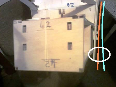

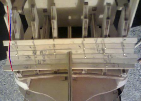

I am not an artist and have to rely on PAINT to edit the photo.
The blue line is the suggested profile by the instructions.
The orange line is my new profile.
It is 1.5 mm inwards at bracket #45 (back support of Gallery) from the 1st to the 4th plank of the bow planks (the first 4 planks you put on the side). Hereon it follows the standard profile as formatted in the original build.
