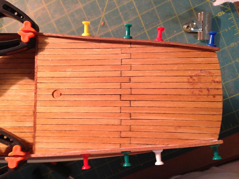

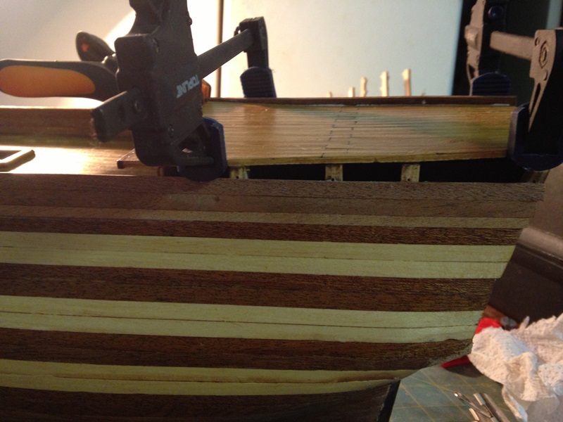

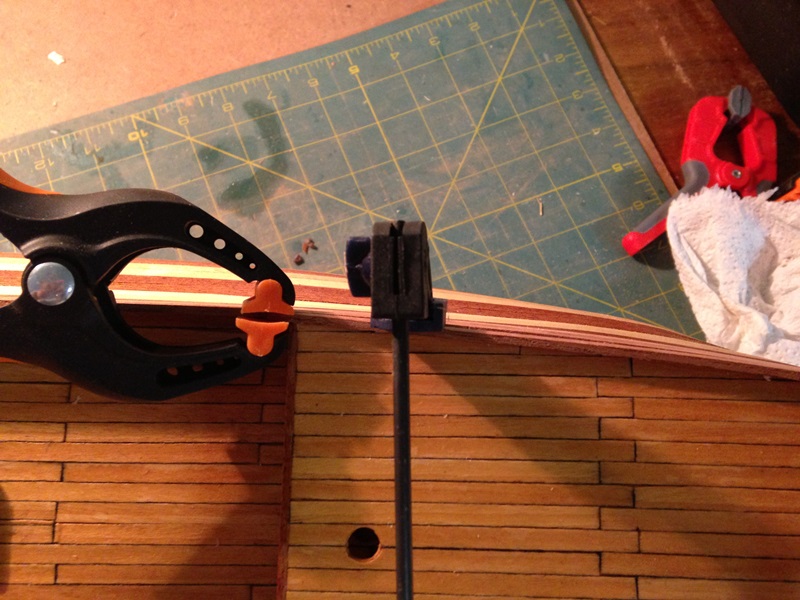

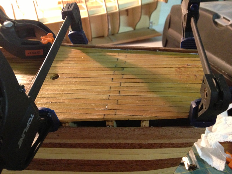

I found that the back is vertically challenged Blink
COmpared to the instructions that I have on the model where they say I merely add a 6ml width of Sapele strip on there, it just wouldnt make sense because I would be left with a strip on top that would have nothing to "Grip" onto.
Decided to change it around anf then have a gap which I would need to fill on the hull with a strip that would have to be severely tapered to fit.
Praising the clamps here

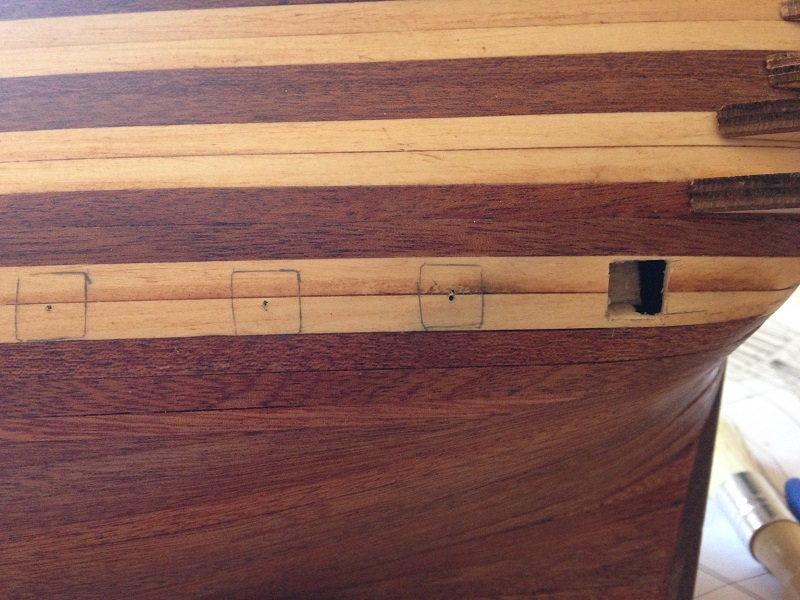

Location: Benoni, South Africa

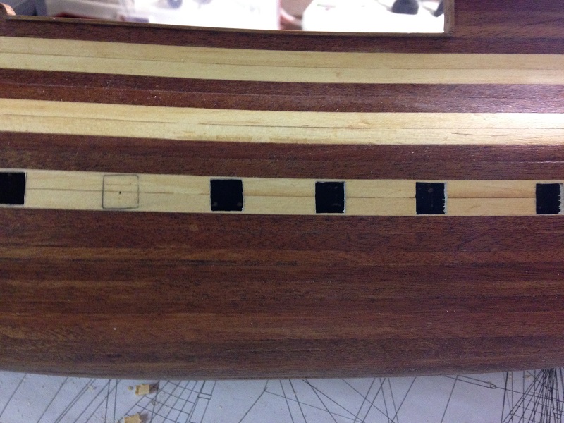

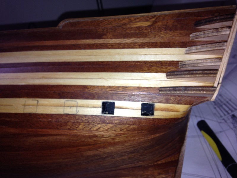

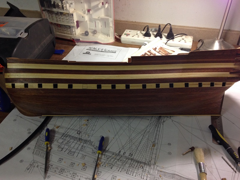

Been working on 2 ships, HMS SOTS and this HMS Victory.
I have started cutting the gunports on the victory. It has been pretty easy so far. I have made a few minor mistakes in terms of the getting them to line up but I don't think its too much of a train smash.
I have found that the measurements on the plans are not correct and that I have ended up cutting a gunport or 2 over a rib frame - where I have had to cut the rib frame to accommodate the csnnon.
Your thoughts?

Hi cuandv
She's looking exceptional with that self coloured wood. With regards to cutting the gunports into a rib or two, the way you have gone looks perfectly good. The other solution is a very simple one - if you hit a rib simply model that gunport closed!
If you have a look at other Victory models in various manufacturers catalogues you'll find that many of them exhibit a closed port here and there, the reason is - they're over the ribs underneath! Even my own DelPrado had four moulded closed ports for the same reason.
Whichever way you go its looking a real classy build!
Robin
