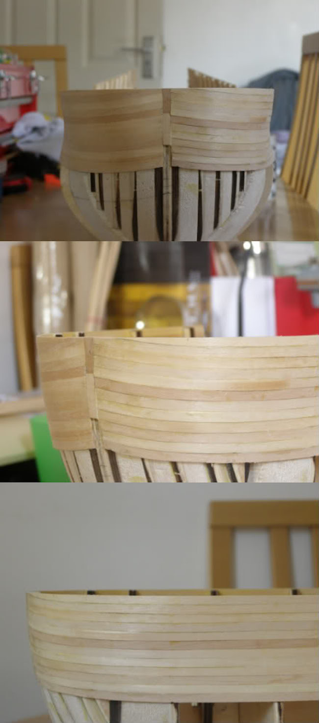

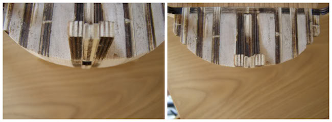

Starting to look good magpie1832, my next parts (9) are on the way.
I have noticed you have not shaped the first two formers on the bow, do the planks come in to full contact???.
Rob
Bridlington.
Built Flying Scotsman (Train). Collecting HMS VICTORY
#42 Posted : 10 August 2010 10:31:42
Hi Rob, Thanks for your comment BigGrin
I have managed to get planks to sit completely flat on those formers with filling the gaps with balsa and shaping. Here is a straight down view. I am also working on trying to get the straightness down the side from the dodgy ribs..

Yes I see, that looks excellent job you have done and will help you no end with the planking.

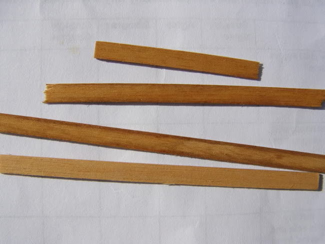

So for the tanganyka, you first stained with medium oak stain, then once dry, with antique oil?
Thanks again mate,
Tom
#45 Posted : 10 August 2010 17:59:40
thomasmoult wrote:
Thanks a lot! I must say your build is looking incredibly good!!
Thanks again mate,
Tom
Yes, you just get little on the edges as tanganyka is orangy anyway, you just need a little of the dye then antique oil. which protects it.
The bottom strip is bare the next one up is stained along the edges, next again stained and oiled and the top is plain wood but oiled.
Thanks Chris..

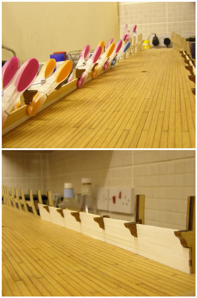

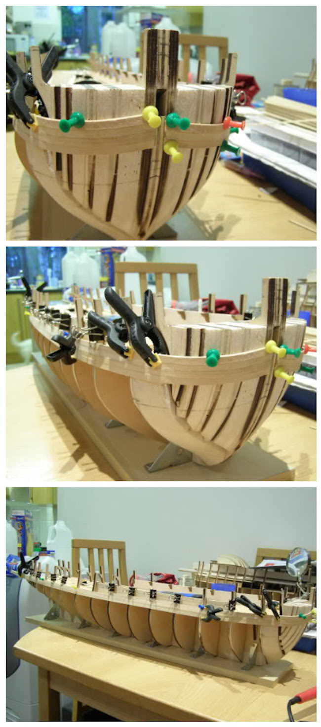

Here I have lined the inner of the ship first instead of after planking the hull. I think it is easier to get them lined up better. Just my opinion..
I have not smoothed the joints on these as looking at interiors of ships they are not smooth joints. I have chosen to paint the inners white on the lower deck as the Jotika prototype Surprise has mentioned in there research that the lower decks where white washed.
Thanks for looking Chris.

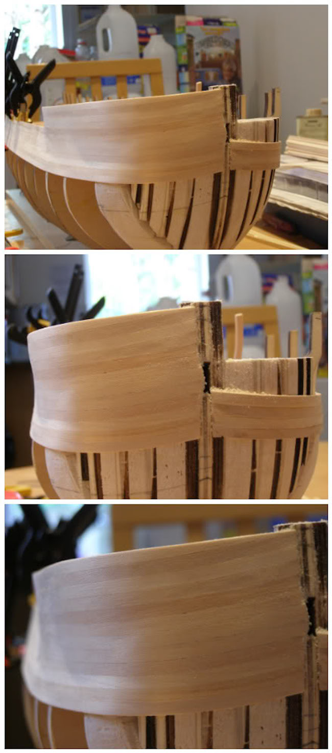

Hi All,

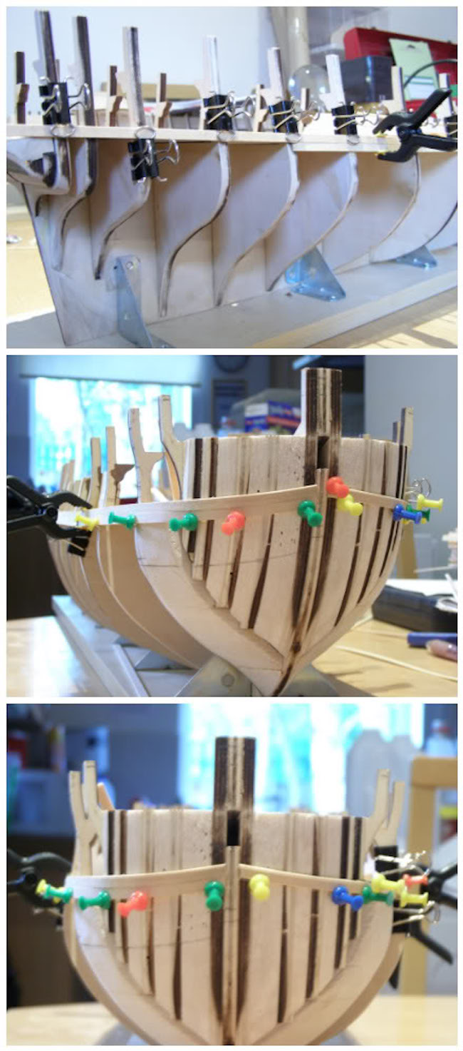

Here I have started to lay the planks. Its took me a while to work out the correct starting place an d position so I can get a nice straight flow.
#49 Posted : 23 August 2010 21:55:42
Here is the rest of today's work. I haven't used 1 pin yet lol..

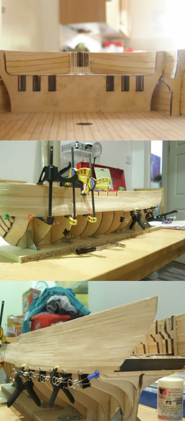

#53 Posted : 25 August 2010 20:59:51
Hi All Thanks for the comments, :) BigGrin

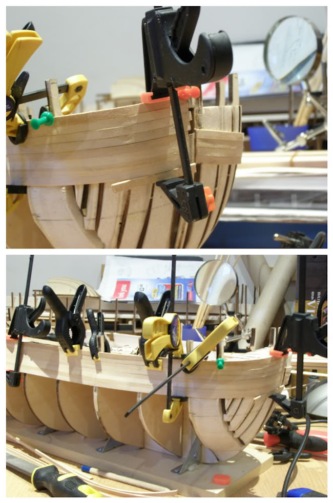

I am trying to get away without using pins on all the planking on both Ships. Most modellers only pin to tack them in place then pull them out. The deagostini pins are not brass only coloured brass. Once they are snipped and sanded they are silver and prone to rust. I found that out on the San Fran 2.
Planking, If you are choosing not too pin, then you can only do a couple of planks every 2-3 hours if using Alphatic Glue. But you get good finish. Pinless on natural wood finish is very nice especially in this sized ship too.
I'm dreading the gunports too. The instructions are really good(LOL LOL )not.
cut hole here is round about what they say...
Anyways... Here is the latest instalment of a few more planks. I had to rip off 4 off them and redo them this morning because I wasn't happy with how they lay and where they finished on the front.So I've got the replacement on now and am pleased with them now..lol..

#60 Posted : 05 September 2010 22:05:59
Thanks Rob,Jonny and Secretreeve for your comments.BigGrin
I'm sure you can achieve what you want without out pins, Just remember to only do a couple of planks a time and use alphatic glue which has great grab. Measure every plank first before you put any glue near it.
@Secretreeve, I have beveled the top edge of each Plank ever so slightly but more on sharper curves so I can get a nice joint. And don't try and bend the plank where it won't go, let it lie where it wants to go give or take a little of side to side to but up to next joint.
Here are my latest Pic's...
