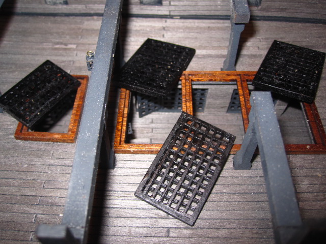

Last week issues 32-35 arrived. In the first issues the gratings have to be made. In the diary you can see, that I´ve made my own gratings. The original gratings are made of some photo edged parts which are glued one over the other. That´s really ugly, wooden gratings are looking much better. My gratings are in one part glued on the deck, original in the new issues are nice wooden frames and the gratings are removable. IThat´s the reason, why I had to remove my grating and make some new, now it´s OK.

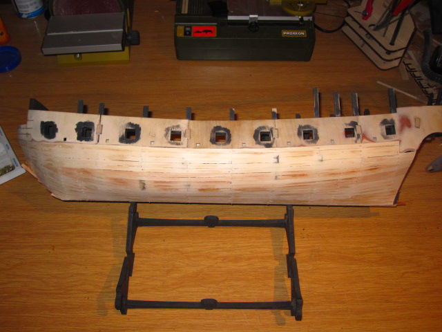

In the last issue the planking of the hull begins, one side of the model is completely to be planked (!). I´ve got 6x1mm lime wood strips, bad dimensions I think (4x2mm would have been better for a small model like the Pearl). In the instructions the strips only have to be glued without any nails. Nice idea, I don´t trust in this method and nailed them all. In the instruction is written (free translated):
"don´t worry if the hull is a little bit bumpy, with the second layer everything will be looking nice"
There is not any word about sanding or filling.........
Of cause I know I´m not the world-best-modeller, but I don´t think that will be possible. If newbies build this ship as written in the description, I´m sure a lot of models go the direct way to the wastebag.

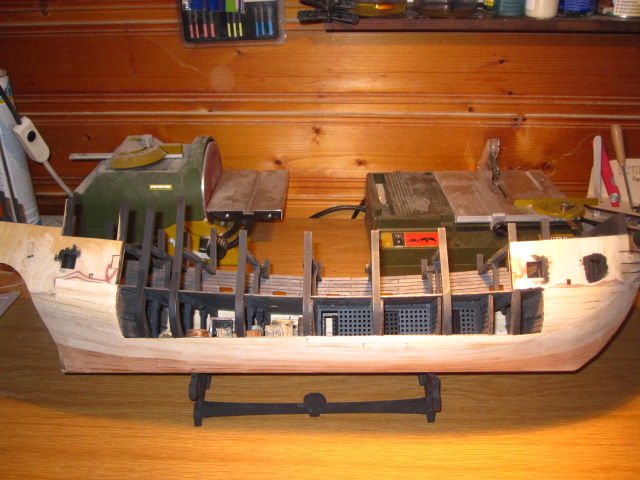

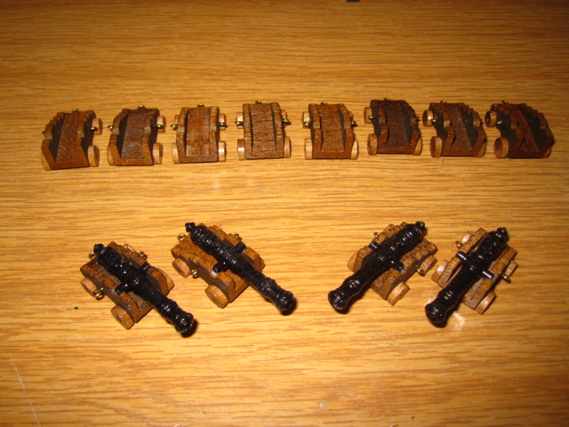

Now the second half of the pearl has got it´s first planking, on the pic you can see how much of the hull will be open. Also the first guns are prepared.
