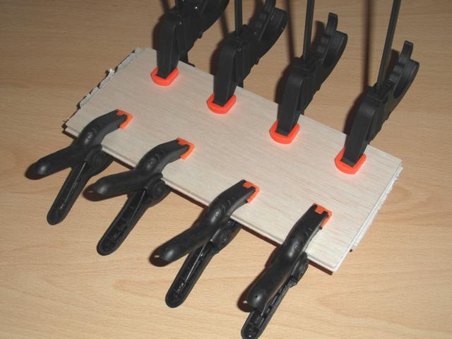

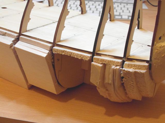

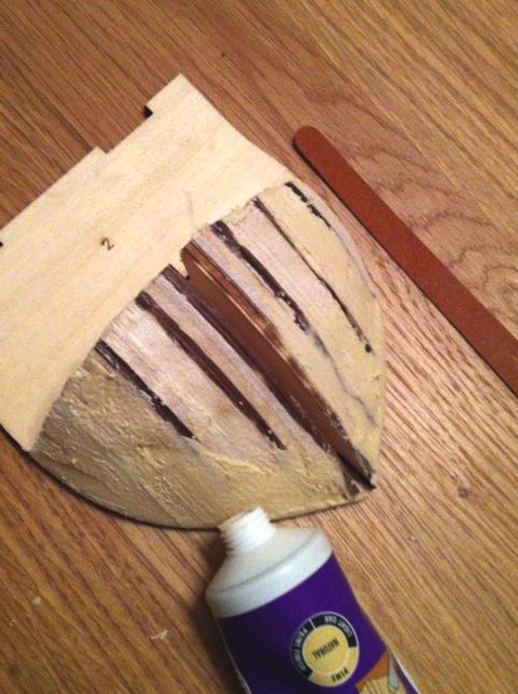

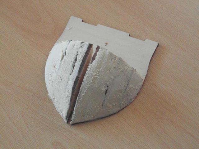

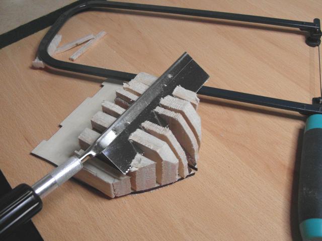

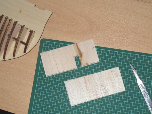

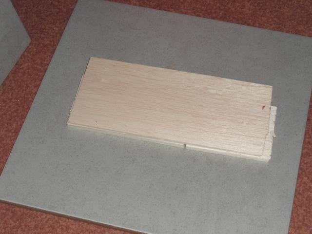

Thought it was about time I got some more work done, been working on putting the balsa in the bulkhead.
Photo 1 - 5- Fairly straight forward, work out the thickness of the balsa required & glue together before glueing into the bulkhead.
Started off by using clamps to hold the balsa together while it glued but then realised I would be better off using my tile press.

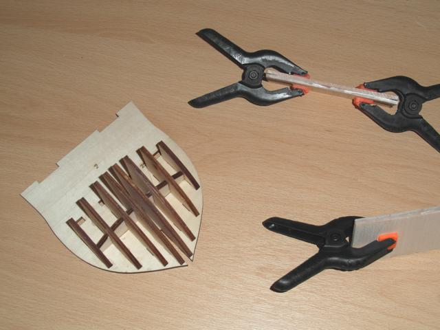

Photo 6 - Some cutting out required to enable the balsa to fit.
Photo 7 - Not the neatest looking but will be by the time I'm finished BigGrin
Photo 8 - Cut off the excess before sanding into shape.
Photo 9 - Time to use a little filler to fill any of those not so smooth lines Laugh
Photo 10 - Second layer of filler before a final sanding to finish it off.
Now that looks better ThumpUp

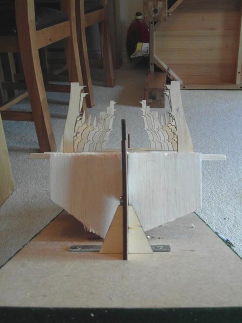

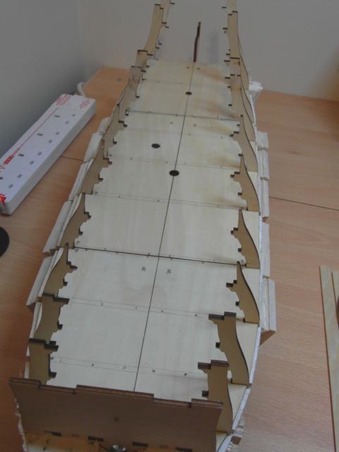

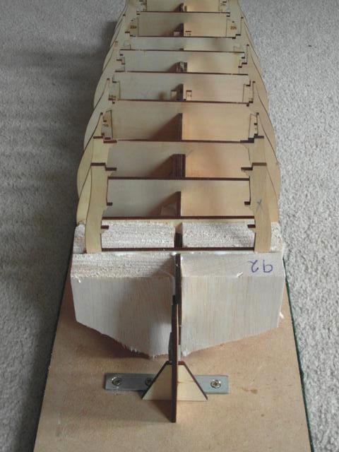

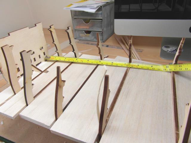

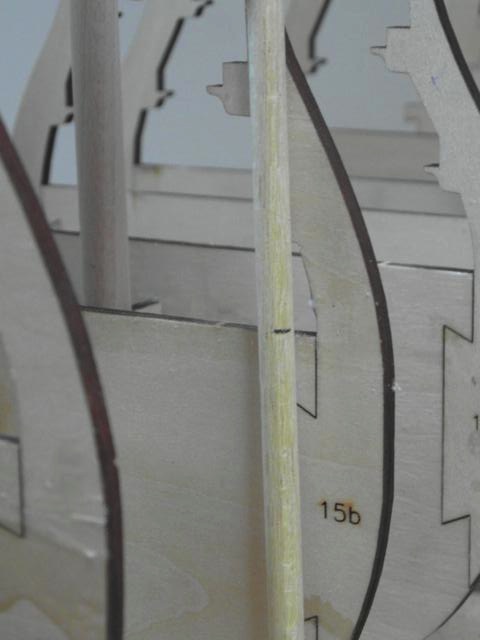

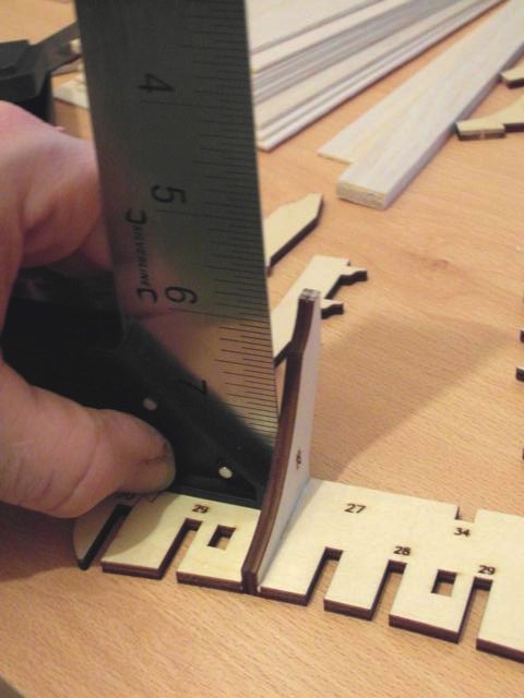

Photo - 1 Even though I checked & double checked the levels of all the ribs as I glued them in place, did one final check, something I saw another builder had done, good idea & all ribs level BigGrin

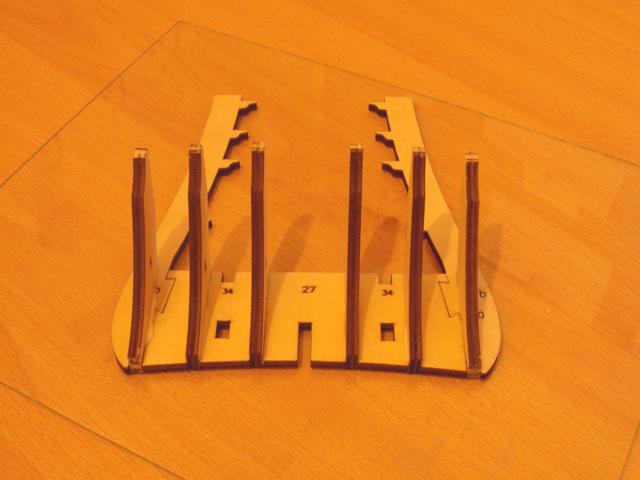

Photo 2 - Time to finish of the last rib 27. As always checking everything is square.
Photo 3 - Excuse the colour, camera must have been having an off day LOL

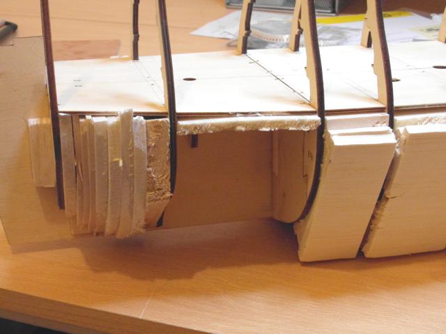

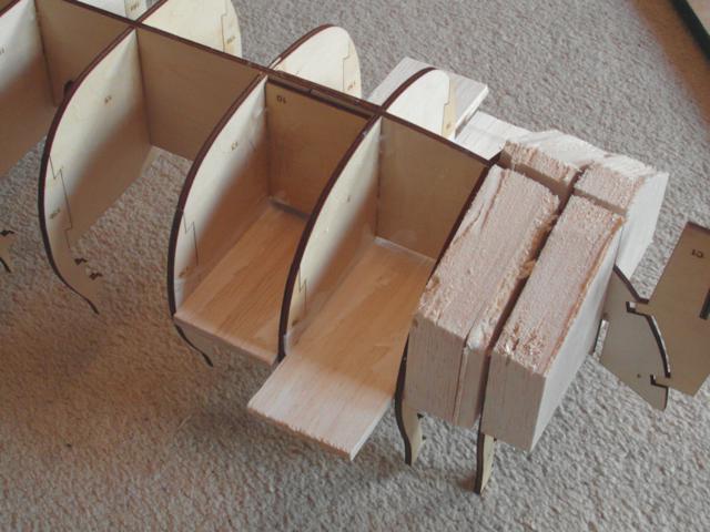

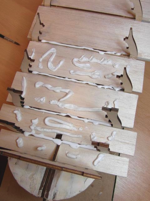

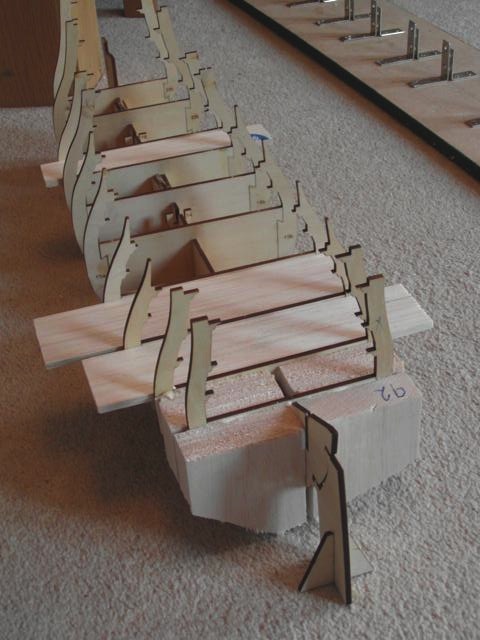

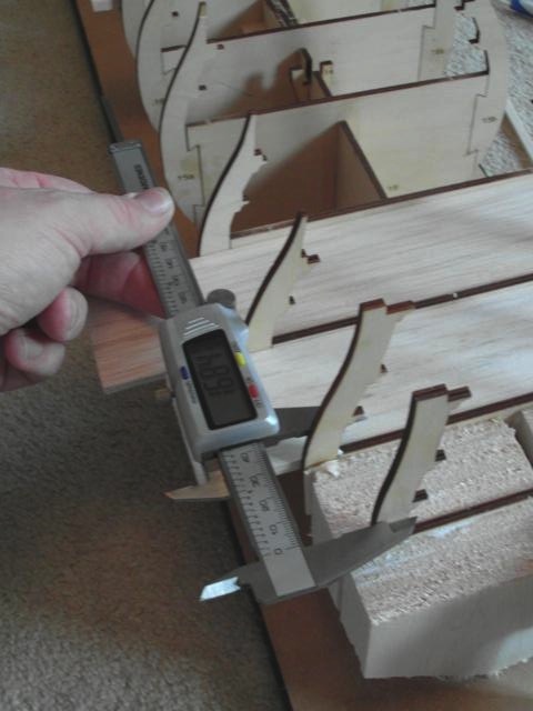

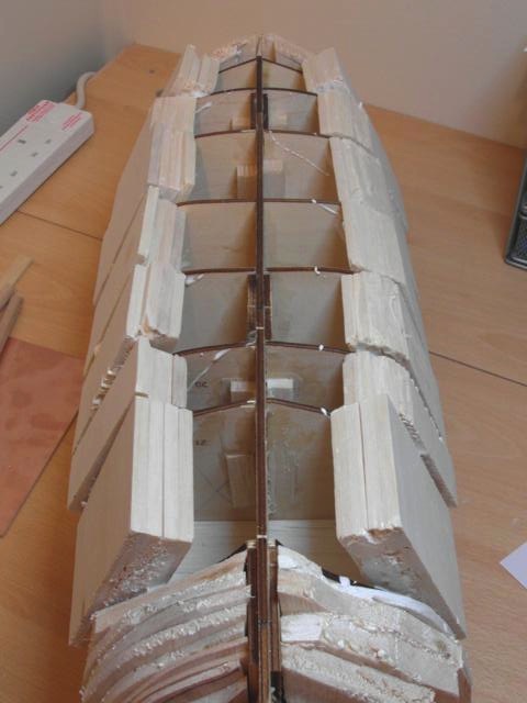

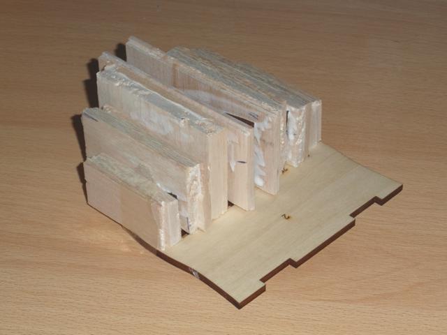

i didn't want to do all the balsa infill of the hull until I had the deck levels in place, wanted to check the decks fitted square & level, didn't fancy having to take out the balsa if everything wash't correct, I had checked & double checked everything but wanted to be totally sure Cool
Photo 1 - I followed the great tutorial by MWG, was a real help (as is his build diary), filled in the front two sections.
Photo 2 - 4 - Next was the other sections, using one piece of balsa to go the full width of the hull, measuring everything to make sure it was the same width all the way across, glued in place just below the deck level.
Same process used to work the length of the hull until all sections filled in.
Photo 5 - What some of you will have noticed from this photos is that the front part of the keel isn't straight Cursing
As balsa was glued in place & rather than try to soak/steam apart such large pieces, back issues ordered & started the front keel again.
Photo 6 - This time I did the front two sections the same way as the rest, one piece of balsa across the whole width of the hull. Everything measured up correctly. BigGrin

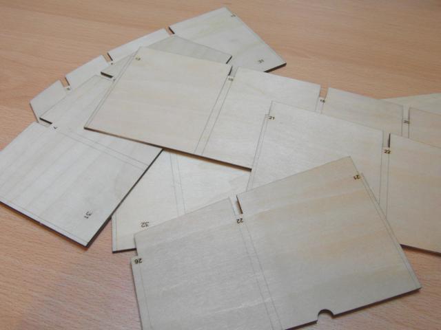

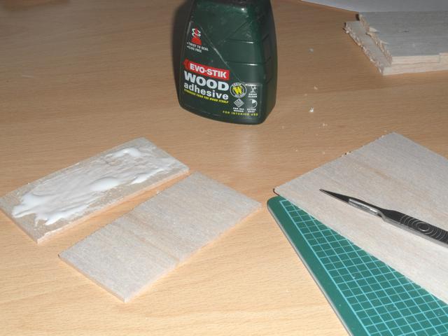

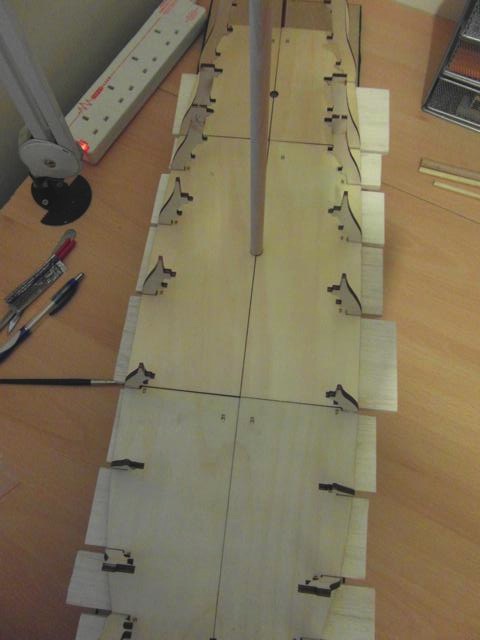

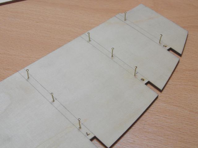

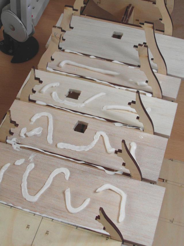

Got my deck pieces, I had held off fitting all the balsa to the hull sections until I had these in place, wanted to make sure they were a good fit, everything square & level, last thing I wanted was to be trying to take out balsa, square everything up Crying
Photo 1 - Started off by dry fitting the deck, had to do some light sanding where the decks fit around the ribs, only on a few, so looks like my measuring over & over paid off BigGrin
Photo 2 & 3 - Followed the instructions about drawing lines so I would know where the ribs are when pinning decks in place.

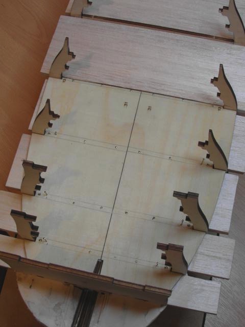

Photo 4 - Haven't got myself a pin pusher yet (need to get it ordered), so hammered the pins slightly into the decks to make it easier once decks in place.
Photo 5 - 7 - Another idea from MWG, adding some well know glue to the balsa & normal wood glue to the ribs, all adds up to a very sturdy hull.
Photo 8 - All the deck pieces in place BigGrin
For those of you wondering why I have an extra hole in the deck Confused
I am looking to put lights in the dummy gun port holes, will cover this off separately in a later post.
The hull has now become very sturdy, all I need to do now in infill the rest of the hull with balsa BigGrin

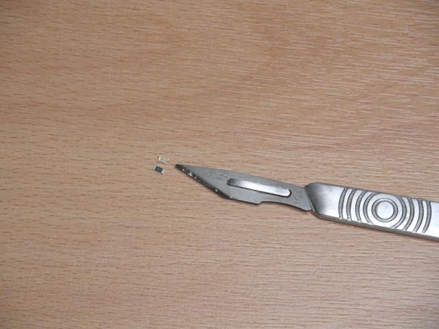

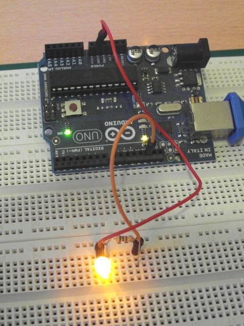

Lighting, something that I am interested in doing, is adding lighting to the ship, feel it will enhance an already amazing build.
I have already been in the early stages of some work on electronics, designing & want to build a reef aquarium, the first stage of this being the electronics to control everything.
Back to the SOTS, did some testing on LED's & fibre optics, I wanted to light the ship by using LED's away from the model & using fibre optic strands to light the model.
Photo 1 - The circuit board at the top is an Arduino, basically a very small computer that can be programmed to contol all the lighting.
After trying this out, realised that this wouldn't give off enough light, so would need to fit the LED's within the ship. Due to the small space available normal LED bulbs would be too big, so needed to look at SMD LED, very small, could be fitted out of sight.
Photo 2 - As you can see, they are very small Crying
Im in the process of building the circuit boards that these will be soldered to, will update you once I have some working.
Thanks for looking in, any comments or idea's would be appreciated BigGrin

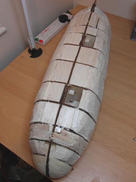

Done some work on using balsa to infill the hull.
Not the neatest at the minute but will be looking good once it is all finished & sanded to shape BigGrin
Photo 1 & 2 - At the front & back of the keel, I have filled these in completely due to the smaller size & shape.
Phot0 3 & 4 - Now have the side's in place, need to cut these down & fit the bottom piece's.
Can then have the fun job of sanding it all into shape Crying
Feels so much stronger & sturdy now the balsa is glued into place BigGrin

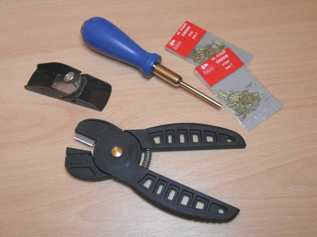

Got myself a few more tools to enable me to continue my build, tools that will make it easier & help me BigGrin
Amazing how much you accumulate as the build goes on, tools & more materials but looking at it, you only buy them once & can use them over & over as more builds take shape, I've got the bug to do more builds once this one is complete LOL

hi pabaz,when using the plank crimper for bending,turn the crimper blade around so that you only use the BLUNT side,otherwise you will end up with a lot of tiny pieces of plank! Blink

your pin puser if you buy a small coller to fit the outer sleave you can set it to give a certin depth to push the pins in the blue one you have use to have one of the collers,they are cheap at model shops normal used to keep air craft wheels on there axels ithink we have different tools so heres a photo of mune with the coller
