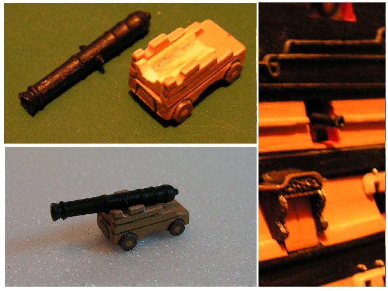

Out of all the eighteen 12 pounder barrels in this kit, there was only one that wasn't perfectly made. (Should have been zero, but never mind) The wonky cannon was ok except for the trunion pins which hadn't completely filled the mould during manufacture, as you can see in the top left photo the pins were too short to reach the carriage!
There were two possible ways to correct this, either a) file the stubby pins off completely, drill the barrel through and insert a new brass pin or b) keep the stubbies and make a wooden platform to support the barrel.
If the cannon was going to be in plain view I would have gone down the a) route but since I had a nice little out of the way place for this one, b) would be quite sufficientCool
The top photo shows the cradle built into the carriage and below that is the finished cannon. The right hand pic shows the miscreant cannon sticking out of its final position, (this was actually during a test fit before I painted the muzzle red ochre)
This is the same cannon which was manoevered through the waist section mentioned above, I told you it was an out of the way location!
I know that there is at least one out of the eighty plus dummy barrels which has no locating pin, there may be more but hopefully a simple drill and brass pin should be all they need to repair them. (Hopefully!)
By the way, my one and only 'big' 12 pounder from the first issue of the DeAg Victory (the one I'm going to put in a mini diorama later) is itself misformed, the hole for the trunnion pin is 45 degrees out of true leaving the breeching ring at a 45 degree angle on the carriage, did anyone else have this fault on one of theirs?

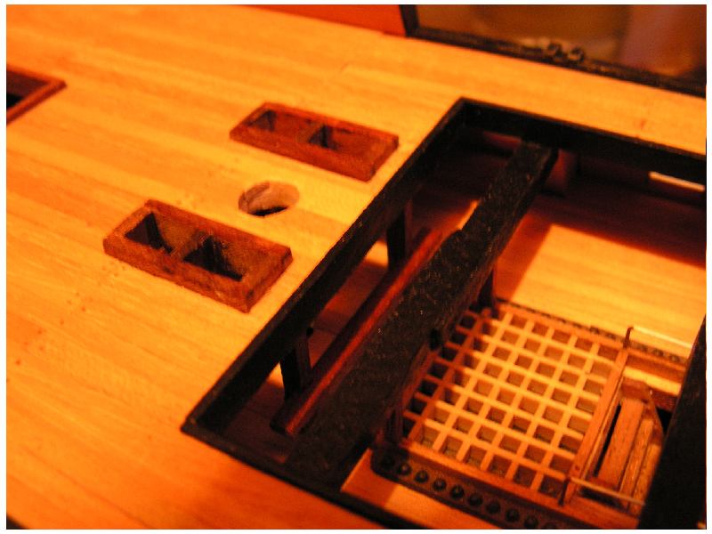

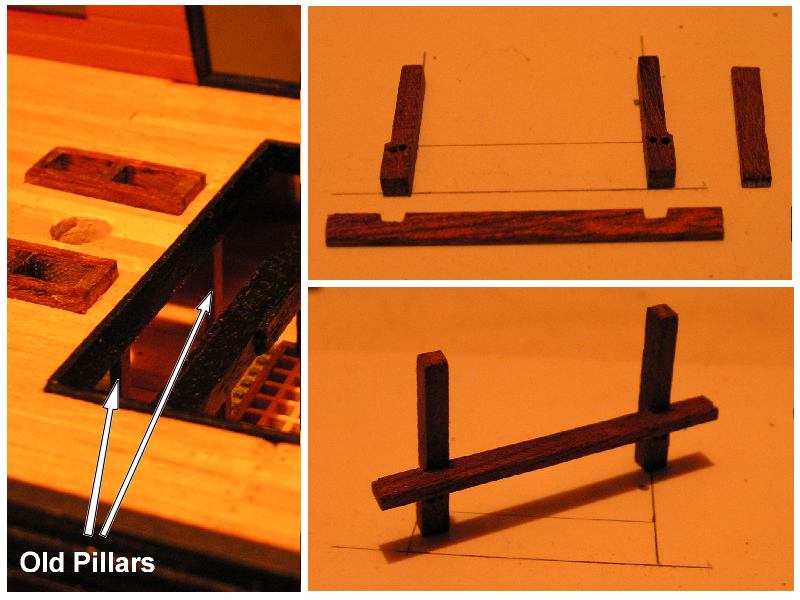

In a quick break from the guns, (thank goodness!) I've had to fit in a little up-grade to an earlier up-grade on the upper gun deck. The original kit has no provision for any of the pillars which run from the upper gun deck to the beams of the quarter deck. I had already fitted in the thin pillars which run down the middle of the waist and had also placed in the two wider pillars just before the main mast. Whilst going through my reference book I realised that the ones I had put in were far too thin in cross section so it was time to put it right before the waist started filling up with cannon.
The first photo shows the first pillars which were just two simple slats of wood and the three part replacement including the horizontal shelf. The piece on the right is one of the originals.
The second photo shows the better pillar set up in place.
The DelPrado kit supplies a simple metal main mast bitts which should be glued directly to the deck instead of passing down through the open hatch to the deck below. That will be replaced with a wooden full length pillar and belaying rack. I had intended to try and fit the lower shelf which should be there on the upper gun deck but there is no physical way to get in there, especially with those little pillars which continued under the quarter deck (damn my earlier "authenticity"!).Fortunately it's very difficult to see the shelf under there so I should be able to get away with that!BigGrin
I have also noticed a glaring kit ommission in the area of the main staircase but more of that later...after these flipping cannons hopefully!

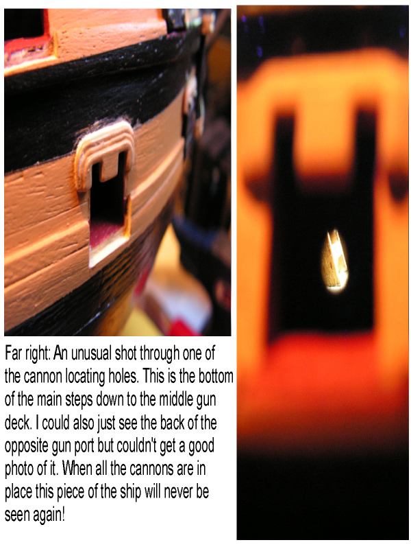

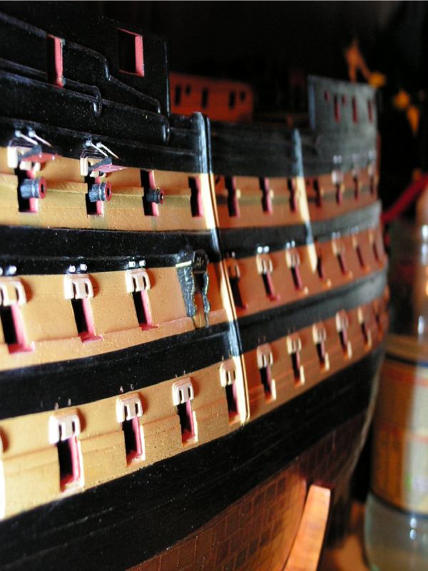

Managed to get a little more done over the festive season. The starboard fenders are now complete and the upper gun deck dummies are glued in from the entry port aft.
All of the starboard gun ports have now been rebated after the last of them were fitted out with their drip boards. (Couldn't draw around the port lids to mark out the rebates until the drips were in place to hold the lids!) Only one drip needed any filler and that was the one on the lower gun deck at the bow where the hull is most curved (second picture on the left).
Only the lower gun deck on this side needs the lead pipes to be added now. On the port side there are another 12 sets of pipes and another 7 drips to add (plus the rebates of course) At long last there are more ports finished than I've still got to go!BigGrin
The cannon tackle is also coming along now but I've resisted the strong urge to get them glued in place, I have an automatic tendancy to grip the opposite side of the deck/hull when working on the gun ports to hold the ship steady. Those fingers are very close to the waist gun positions and I've already had to re-glue one of the quarter deck guns after accidentally pushing against its barrel so I don't want a whole row of them going the same way!Crying
I can work on the aft half of the cannon complement without too much trouble but once the forward half of the ports have their drips in place I'm going to have to think about the catheads and the curved timber which runs down from underneath them before I start sticking protruding barrels and lids in the way!.
Hope you enjoy the unusual photo at the end and a Happy New Year to you all.Cool

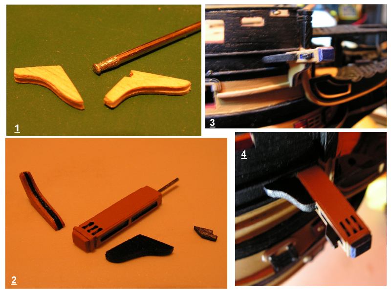

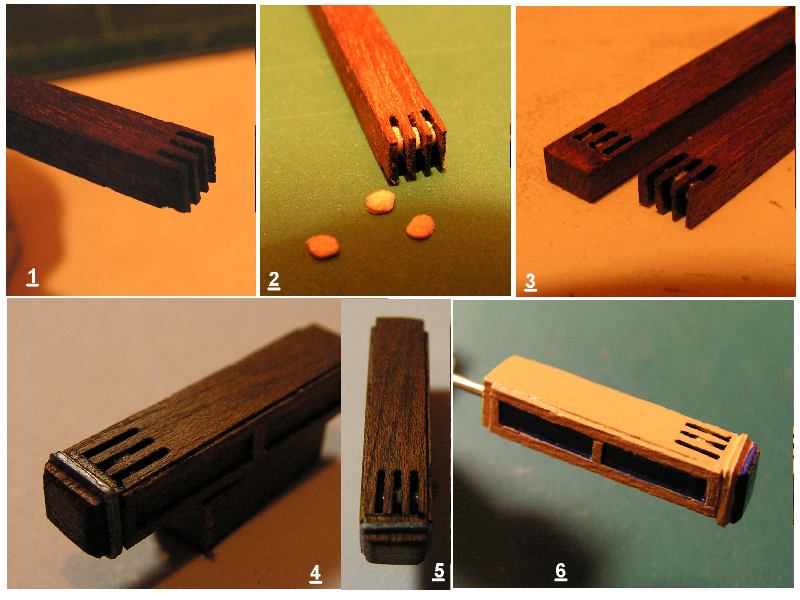

As mentioned earlier, I'm heading towards the bow area, gun-port wise and so the time to think about the catheads and curved timbers is getting near as well.
The official DelPrado instructions have the catheads made from a length of 4mm sq strip, cut to size and painted yellow and blue. No holes for any anchor tackle, the anchor is simply hung from a brass eyebolt stuck in underneath the timber (the actual sticking in of this eyebolt doesn't seem to appear in the instructions at all)
I was planning on drilling out the six holes for the anchor tackle but even the thinnest drill bits proved a little difficult to get three in a line in a 4mm piece of hard wood so I came up with a different approach.
Instead of drilling the holes which would have really been the ends of the three slots, I put the three slots in instead! This was fairly easy to achieve using the thinnest cut off discs on the rotary tool. (Photo No1)
After a little light sanding the next stage was to cut three very thin discs from a cocktail stick using a new safety razor blade to form the internal pulleys, getting them to the right thickness was a little hit and miss but the eventually successful outcome is shown in Photo 2. The pulleys were then secured with a drop of fairly thin superglue.
The third photo shows the two catheads under way, the right hand one as described above and the left hand one after supergluing the head cap over the front end (another piece of 4mm sq), this effectively cuts off the three slits turning them into enclosed slots as on the original catheads.
Again after a little sanding the front of the cap is slightly bevelled and the iron retaining band replicated with the same thin lead strip as I've been using on the cannon. The side decoration was built up with the very thin wood veneer left over from the second hull planking (after the cathead was cut to its' finished 2.5cm length). After this was all dried and sanded, a hole was drilled into the back of the timber and a thickish brass rod glued in place, this will be used to finally fix the cathead in place into the hull a little later on.(Photos 4 and 5)
The final result is shown in the last photo. The cathead still needs a touch of drybrushing to highlight the edges and then I have to work on the two curved supports which will be easier to fit once the timber is already fixed in place, and I also need to try and carve or mould the crown emblem for the front face of the cap!Blink
Once that is finished I'll stick another photo on.

This section shows the second half of the Cathead construction. Pic 1 shows the two sets of support brackets which fit below the cathead and against the hull. The one on the right has the cut out for the thin decorative beading which runs along the hull sides, the left hand one is still to be fitted and filed. Both brackets have been routered out along their outward edge, the resulting channel will be painted French Blue to match up with the same decoration on the curved head timbers. The diamond tipped mini router tool which produced the channel sits just above.
The photo below shows the four separate components of each cathead; the main assembly shown in the preceeding post together with the (now painted) bottom bracket, the black rear bracket and the tiny side bracket which is fixed to the cathead itself (haven't checked the rigging yet to find out what it's for!). The main brackets are both made from 2mm ply and the tiddly one from a piece of 2mm sq limewood (I think).
The two right hand photos show the Cathead in position with the drybrushed white highlights completed. At this stage the bottom bracket has not been glued in place yet, I want to be able to remove it to allow the head timber to be curved into position in the slot cut into the wale and then trimmed to size before refitting the bracket permanently. I'm hoping to complete this section within the week (materials in model shops permitting!)Blink
Happy building all.
Robin

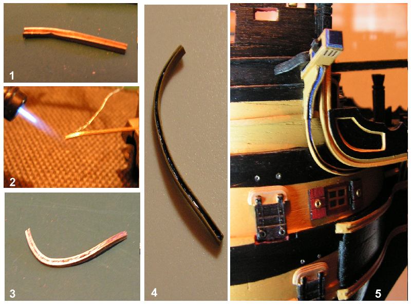

As I mentioned above, the final curved head timber did not go according to plan! My intention was to buy a length of Plastruct square section 1.5mm strip, router or file the groove along one side and then heat-bend the strip into shape with either a candle or gas flame. Unfortunately, once I got into the Model Shop in Plymouth I discovered that Plastruct square strip only goes down to 2mm!Blushing
In order to still use the plastic option I would have to file and sand the 2mm square down to a perfect 1.5mm square making sure that it was exactly the same width along its full length - possible with some effort but not a job I would particularly enjoy doing!
Before the plastic option reared it's ugly head I had considered using the same 1.5mm square brass strip which I had already used to make the other head timbers. If the strip had been just plain that's what I would have done but I kept coming back to that rotten concave groove that runs along the outer side (the bit painted French Blue on the original). I had tried fileing this groove but it was extremely difficult to get the file to stay in the centre and not skid off the edge. If all else failed I was going to mount a dremel type grinding wheel in my Mantua baby wood lathe and build a temporary 'bridge' below the wheel to slide the brass strip along, cutting a very shallow groove into it as it went.
While I was looking around the materials in the model shop however, I came up with possible option No3. This was still brass but instead of a solid square section it was a 1.5mm U section. If I could bend this into the correct compound curve I might be able to fill the centre in with milliput and shape the groove into that.
As you can see below in photo 1 that didn't work! As I suspected, trying to bend the U section simply made it kink at the bend. I could have tried using one of my miniature pipe bending springs but I think it would still have done the same thing, the springs are designed to bend tubes, not open profiles.
What I needed was a filler inside the U profile that was strong enough to prevent the side walls from kinking but at the same time soft enough to bend into shape along with the brass. It suddenly occurred to me that I had already been using such a material with the other brass items in my scratch building - solder!
What I managed to do is illustrated in photo 2 (and it was damned hard to photograph too!, my digital camera is right handed only so I had to operate the gas flame left handed and click the camera with the right all the time trying not to melt the plastic camera body!)Glare
What I did was to heat up the brass section until I could apply the solder into the groove where it instantly melted and flowed along the channel. Once a long enough length was filled in I played the flame over the top to level off the solder (as much as I could) and then let it cool and solidify. Once solid I could then file along the solder to create a smooth finish.
The solder filled strip could now be bent into shape, (before cutting to length, it's easier to bend a longer strip), following the contours of the Victory's hull mainly using the rounded edge of my work table (kitchen work top in actual fact). The result can be seen in photo 3.
Photo No.4 is this same piece with two coats of Yellow Ochre and the French Blue inner groove.
The final result is shown in the last photo with the curved Head (brass) Timber glued in place with superglue, (two attempts, the first didn't line up exactly with the bow timbers!Blushing )
Overall, it's not looking too bad but I did overlook one little detail, the brass was 1.5mm square and the plywood support bracket which it joins onto was 2mm thick! True the ply has been sanded down a little to smooth it off but there is still a very slight 'step' between the two so Harty!, if you go down this same road I would recommend slightly 'flaring out' the side walls of the end of the brass section before filling up with solder, that should improve the flow of the joint. (that's unless all the solder flows out the end of course!BigGrin )
