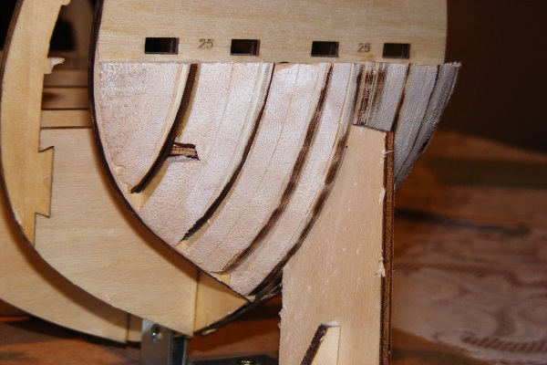

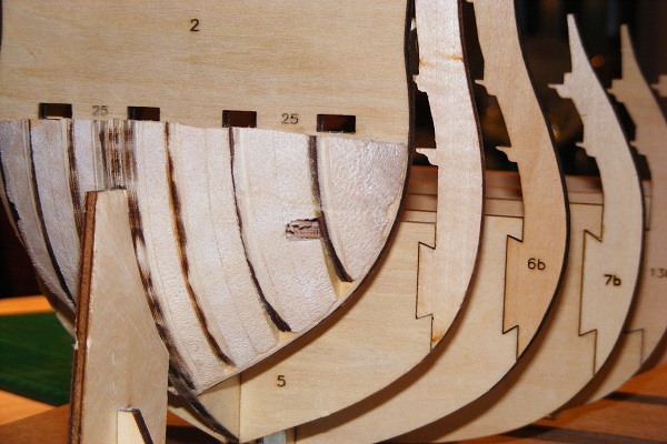

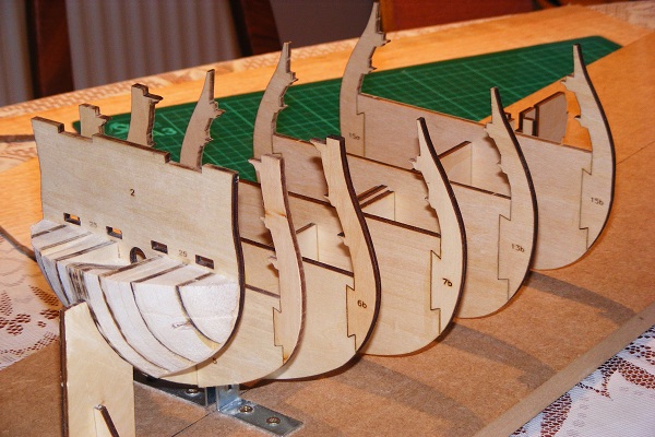

gandale,you have Identified the prob.now fix itHuh yes we were lucky,reduce the rib so it is the same as (b)prob solved,when I said lucky it meant that if the part rib was smaller then we would have added by filling in,I know some you will say send it back,and it should not have been like that in the first place,but we are all human,machines don't make mistakes,only the humans who operate them.this is not a problem,I have checked for alignment all is ok.this is what the forum is for,solving problems and fixing them.good luck.what i did was to file off the top edge of the joint on 13a. and when I fitted 13b. I pushed it into the top of the joint as my flange on 13 b was was slightly too small for the joint,and pushed a piece of scrap into the joint.
Karl, thanks for the update on your fix... have double checked mine and found my 13b fits perfectly... the first image I posted shows everything aligned with 13a being the back piece... filing the lower flange on 13a for my build I believe will correct the fault.... Thanks again, you are a star....Cool
#42 Posted : 27 September 2012 23:05:25
Would also advise builders to check the distance between each deck especially on parts 13a and 13b in relation to other ribs... i have a slight difference between the first and second deck, about half a mm.... Seriously thinking of just getting a replacement from the newsagents but am concerned I will pick up another faulty part...

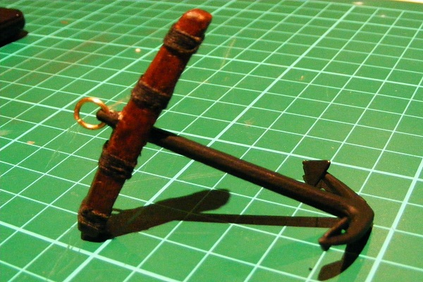

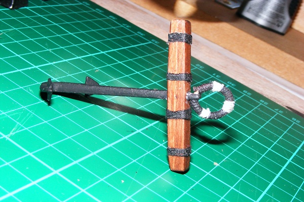

Decided to press ahead with my anchor... am pretty pleased with the texture and the grain of the wood showing though... Stock was stained with Walnut satin and dabbed with tissue to get the texture... may yet do something with the ring, will wait and see... here are the pics as promised....
#44 Posted : 27 September 2012 23:55:08
def different,the ring needs to be a bit larger I think?also the ring has binding it's called puddening.if you want a scale like anchor.Cool
#45 Posted : 28 September 2012 00:07:45
Thanks Karl, thought I had aged it quite well but hey, that's why I am here, to try and learn especially from mistakes.... will have a look at puddening and see how it is done.... appreciate the comments ......

Yesterday and today I cleaned all the ash off of the bow formers part 12, glued and fitted ensuring everything was square.... carried on with the balsa infills on the bow section and left to dry. Then using a file and sanding block started shaping the balsa infills, only have to fill indentations with wood filler and finally sand smooth... That maybe a task for tomorrow.....
Just for the record, ribs 13 and 15 have been dry fitted only, will not be gluing in place until new rib 13 arrives....
Here she is so far......

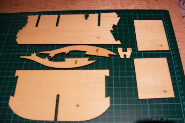

Issue 5 arrived and all looks well.. carefully cut all the parts out of their framing and got work cleaning all the loose ash from the fittings using a fine file and emery board... Happy to say all the parts fit together this time...
#53 Posted : 05 October 2012 20:36:54
Tried a dry fit of the new keel piece and found it was slightly out of line... closer inspection of the new keel piece showed it was so slightly warped, resulting in a dip in water for a few minutes. While the keel piece was soaking I glued in place parts 16a and 16b to make up the rib... The wet keel and the rib were now placed into my makeshift press where it will stay for a while....

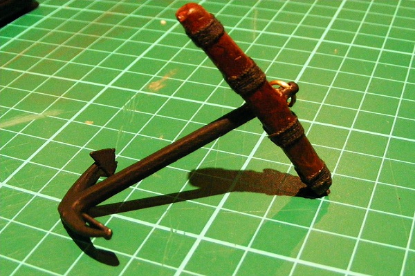

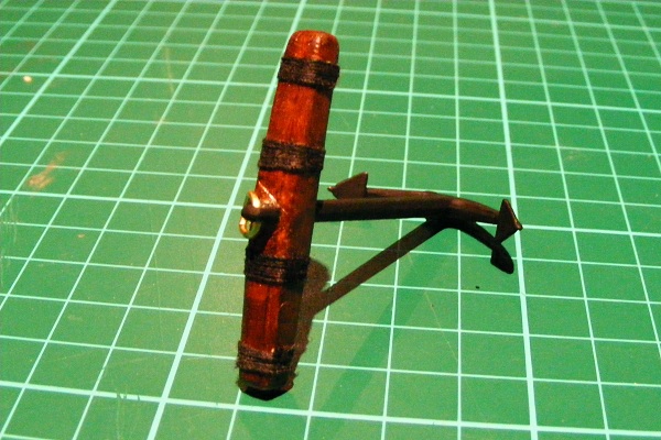

Decided my earlier attempt at my anchor was not up to scratch and made a number of mistakes during its construction... Threw the stock away and created a new stock from scratch. Replaced the ring with a larger one made from brass wire wrapped round a 12mm drill bit... Applied the puddening to the ring using rigging thread and painted it black... finally added the white bands using normal sewing thread.... Intend purchasing 1mm brass rod, inserting it into predrilled holes in the stock to represent fixing pins... Feel this is a much better attempt....
