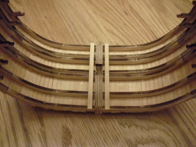

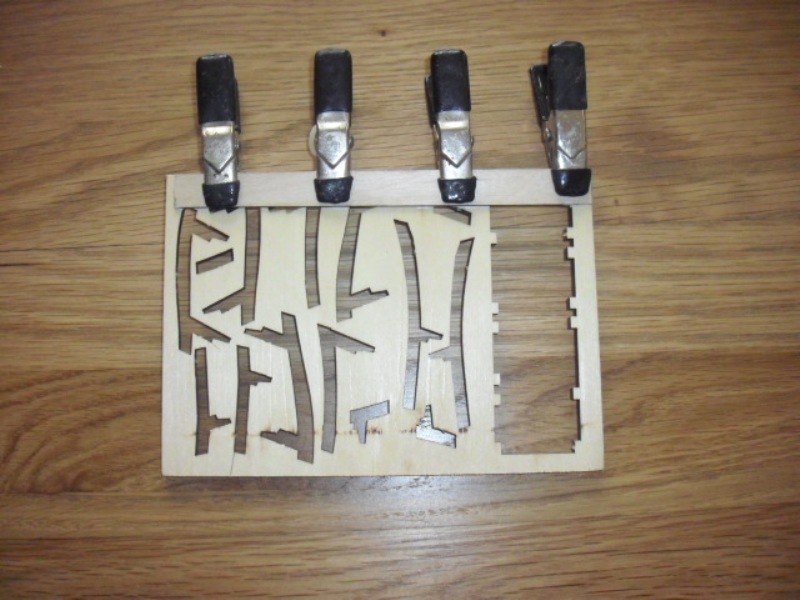

ISSUE 124
Hi Team this is turning out to be a great Partwork, I am really enjoying it.
We received 5mm x 2mm planking, plus grating strips.
As advised in previous posts the timber has been badly cut, so I had some yard lengths in lime wood and I am using that, also I am not using map pins I am using my small clamps with a piece of timber under the jaws to stop the clamp marking the planking, this has worked very well.
At the same time I have used the Jigs that came in issue 123 to keep the ribs at the correct spacing while planking.

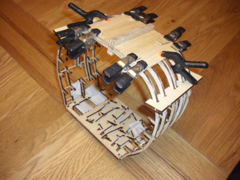

The first photo is of the Magazine and my new planking:-

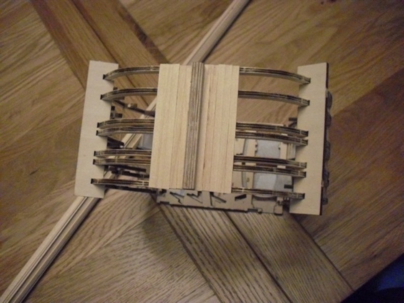

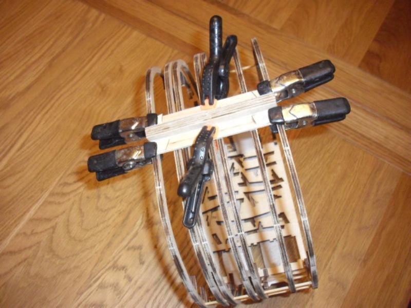

#45 Posted : 10 September 2012 21:44:00
ISSUE 124

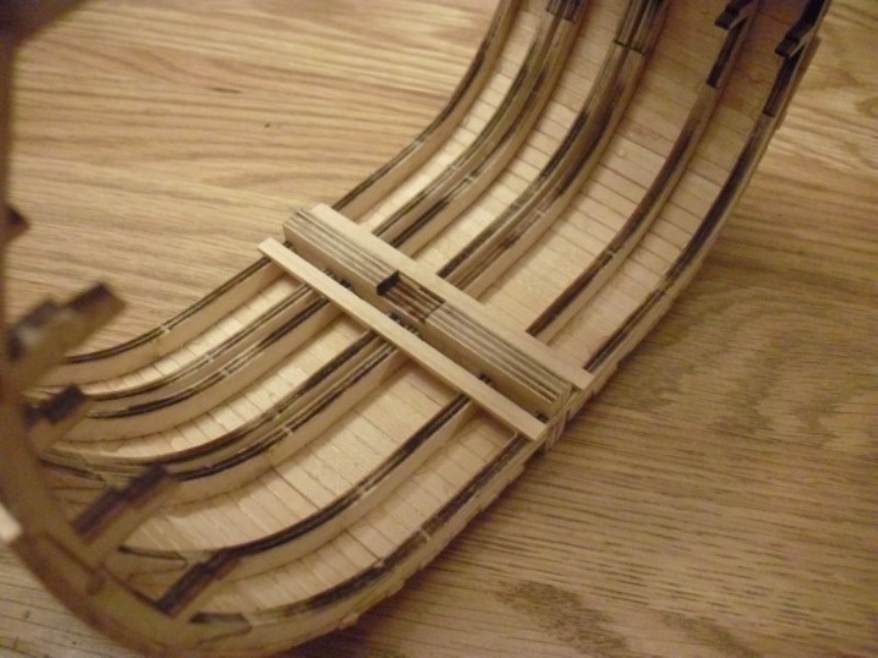

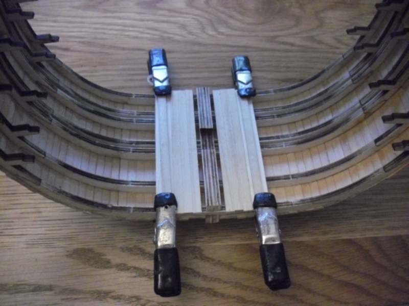

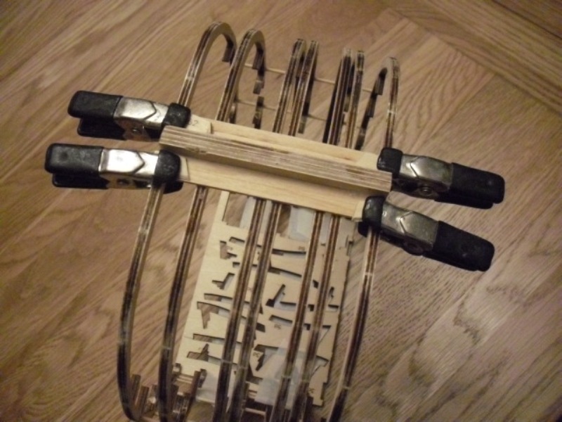

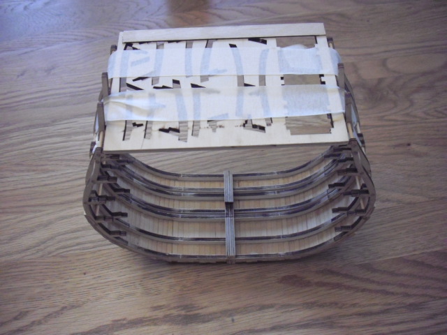

I followed the instuctions, and made the brace for stability, then proceeded to plank:-

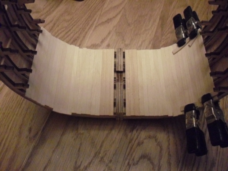

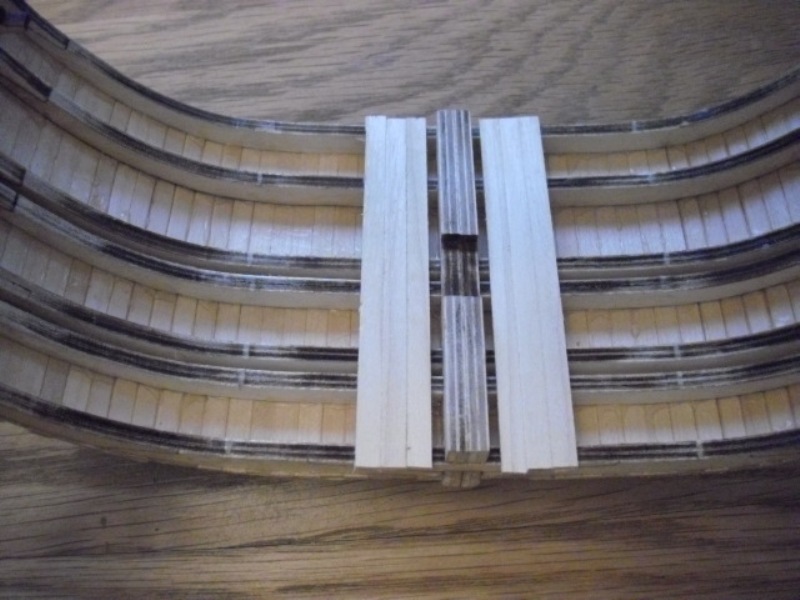

saintsman123
#46 Posted : 10 September 2012 21:51:30
Joined: 30/01/2011
Posts: 865
Points: 2,410
Location: Cambs
just watch the nasking tape at the top mike, you really want to wrap it round the very top dowel, otherwise you'll be taking it off a few times as you get near the top of the outside planking.

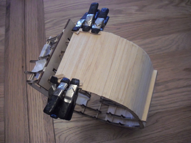

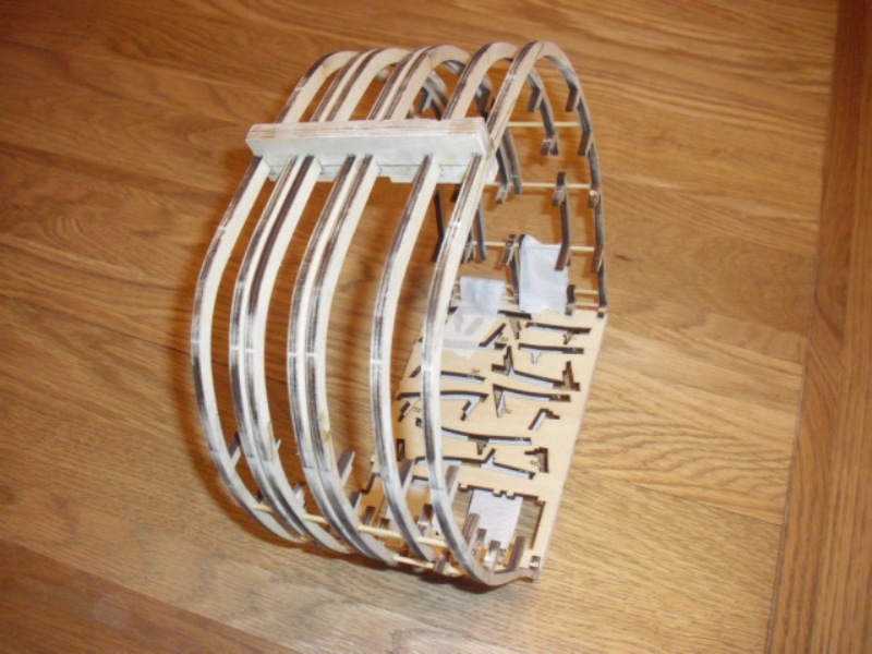

#47 Posted : 10 September 2012 21:52:33

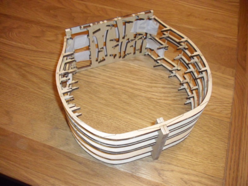

ISSUE 124
And here is where I am upto at the moment:-
thanks for looking in, questions and comments welcomeBigGrin regards Mike

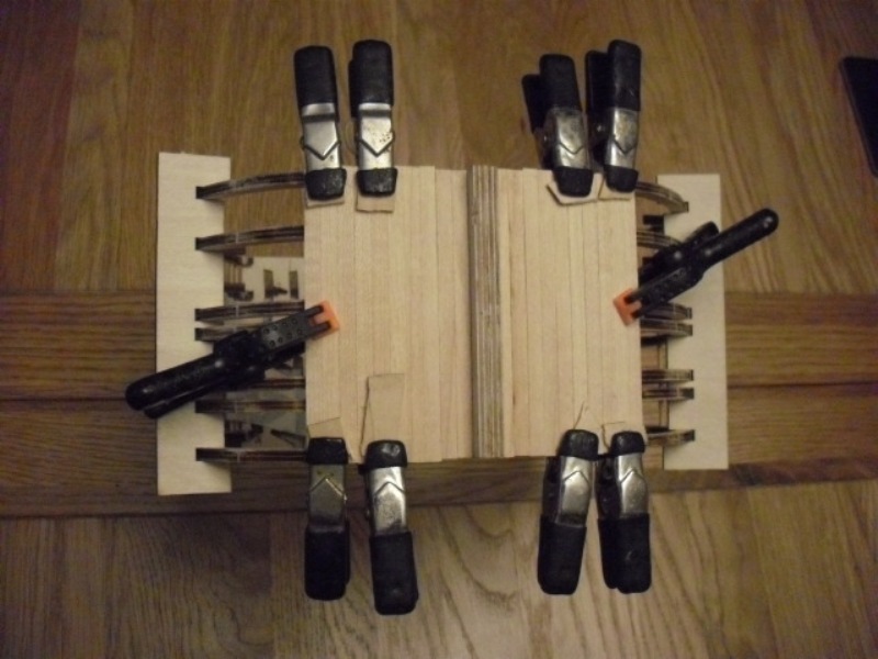

Hi again, I have now finished issue 124 apart from sanding the plank edges;-

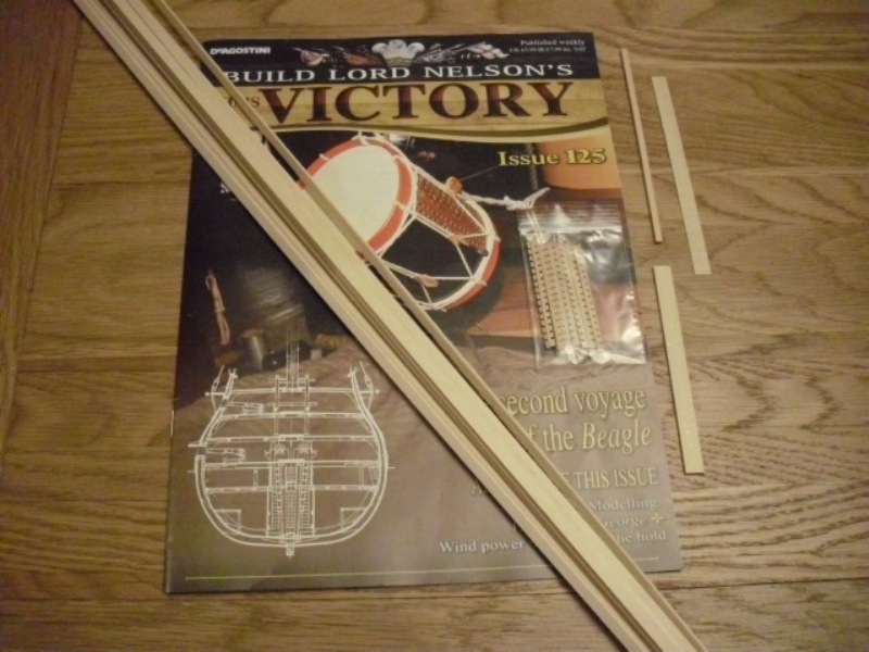

ISSUE 125 BUILD
Hi Team here is my latest build on the X section, this is what we received this week.
I have purchased new wood 1.5mm x 5mm I prefer to use it;-

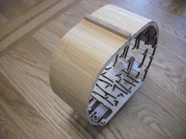

Then I followed the instruction and planked the inside to just under the deck supports.
I Bevelled the planks on the bend of the Hull,I used adhesive on the edges of the planks also, again I am using planks (I do not like map pins) I have no marks with the clamps:-
