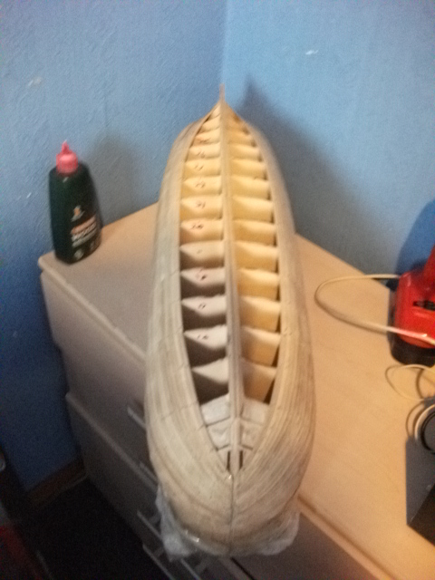

Hi all,
I am just about to measure the distance of the last 10 planks needed to finish the hull planking (issue 38).The distance id 52mm on rib 21,
would it be advisable to put another plank on to make it 47mm or just work it out from where I am which will be 11 planks.
any help would be great.Wink
sandnesspeats attached the following image(s):

Although it measures up to be more I never found it a problem since there will always be a slight spacing between the planks no matter how tight you make them. It should come down after a couple of planks are laid.
You might find this useful also - Last 10

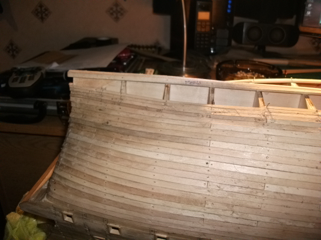

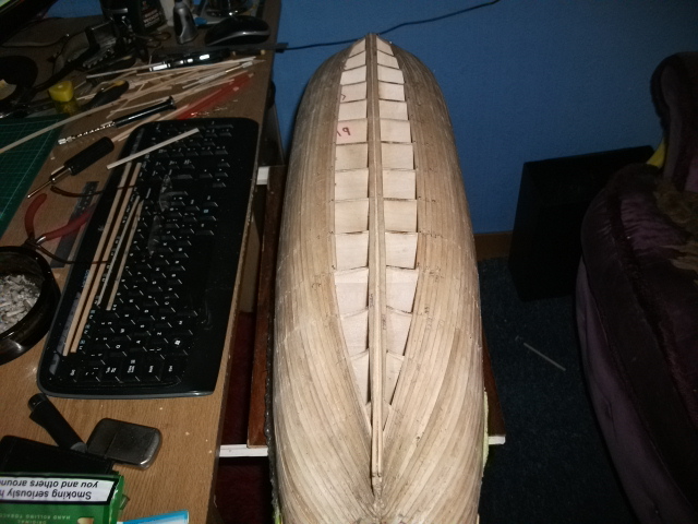

Enclosed are some pics just not sure how to proceed.
The measurement at the stern is only 20mm and the middle of the keel to plank is 45mm.
I have never put a dropper in yet anywhere but it looks like I will have to now,Any advice would be greatly appreciatedBigGrin BigGrin BigGrin

A quick look through some members build diaries will throw up some options for you!
Darren has produced a graphic in his diary showing how and where to taper the planks to get a snug fit. If painting is going to be your desired finish, then the planking will be covered in paint and will obscure the run of the planks, that will make it easier to blend in some smaller odd shaped filler pieces.
Take your time and have a good read at what is on offer.
All the best Steve..

I agree, wood filler little bit of sanding and paint problem solved.
The thing is, if you going to build an another model and you want the planking
to be visible, don’t you think it’s a good idée to practice on the Victory while
you are busy with the planking. Only a suggestion.

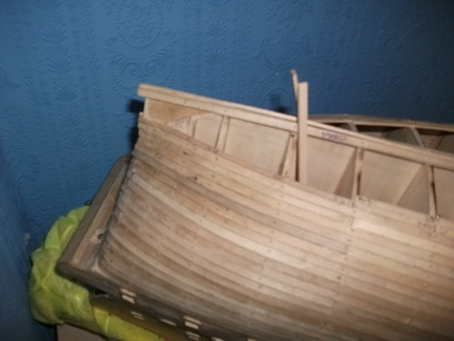

Hi guys,
I am at a tricky bit,the thing is the stern measures 17.6mm,the widest part is 42mm that is about 8 planks,will I have to reduce the very stern plank to just over 2mm instead of 2.5mm.Confused Confused
Any advice or pointers would be greatBigGrin BigGrin

You need some droppers. The instructions should have already covered these already.
Have a look here (scroll down).

Have another read through the instruction to check. It does say you may need to use droppers and/or steelers even on the last 10.

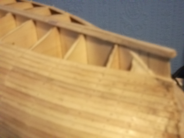

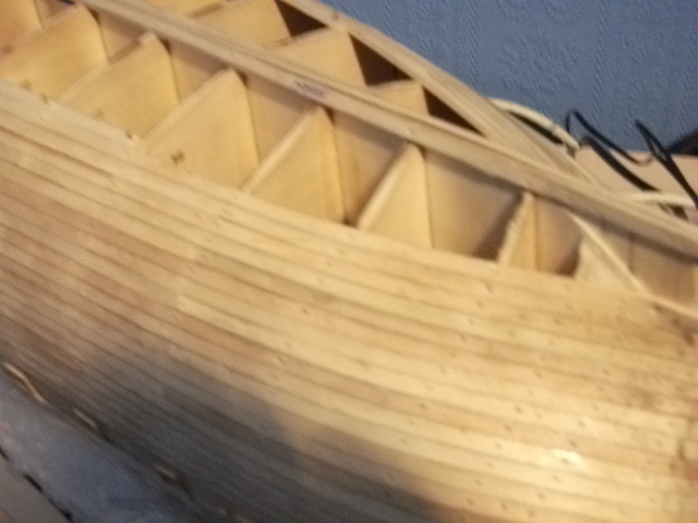

Hi all,
Would you look at the pictures and advise me what to do next, I am running out of space before I finish the hull.Do I just keep going as I am and sort it out near the finish or do I try and sort it out now. I have been on this for ages and would like to get it finished,(the hull I mean)
as usual any help would be great.
