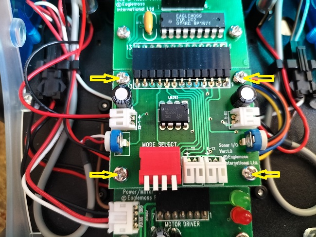

The update for issue 14 has arrived and along with it is Cybots second video (featuring "Lacey" the cat).
Before the video though another circuit board is added that includes a "mode select" switch where you can tell Cybot what you want it to do.

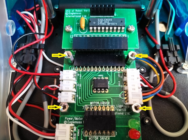

Pic 1: remove the four screws from the indicated positions.
Pic 2: replace the screws with the supplied pillars.

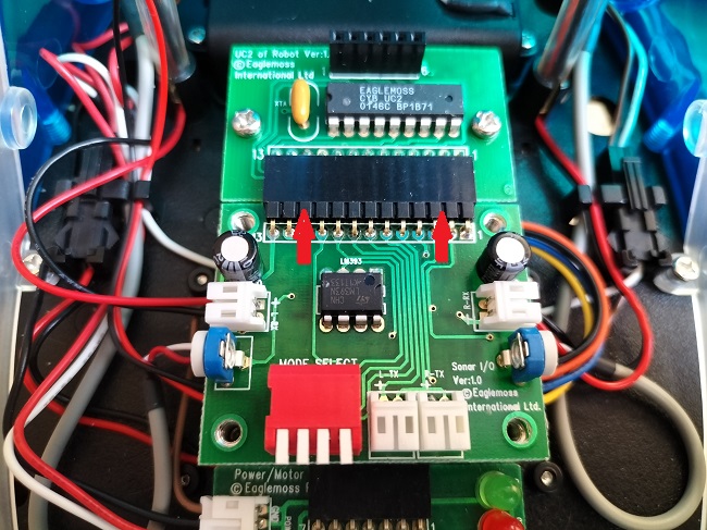

Pic 3: plug the new board into the horizontal expansion socket.

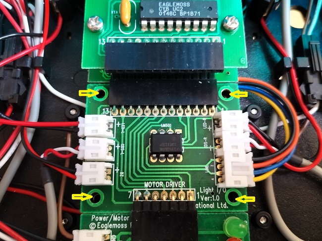

Pic 4: secure the board with the four shorter screws supplied with this issue.

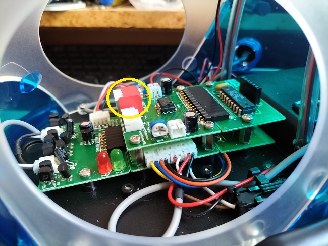

Pic 5: mode control switch indicated by yellow circle.

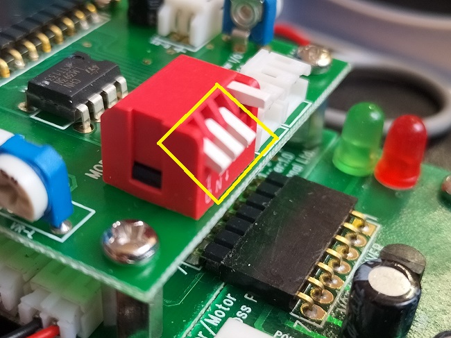

Pic 6: binary code switch set to line follow mode. Looking at the switches ,left to right they are sett to on, on, on, off or 1110.
Cybot is now ready for the "Line follow" test.
