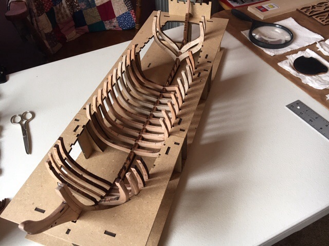

I received pack four last week and got into it today. Four more frame ribs. Two aft and two foreword. Now that I have frame ribs for every section of the ship it's interesting to see the hull take on its shape. It is difficult to clamp things with the curved shape of things. The parts slide on the glue as if it were grease. I just hold them together for a little while and let dry well overnight. I figure that there will be enough overlapping parts that it will hold together like a spider web in its finished form. What a beautiful thing this is. Working with wood is very pleasurable. I'm already daydreaming about another ship model only with sails, rigging and all. Having both hawse pieces to work on simultaneously will be nice. I still have to re-cut forward rib # I also. My mistake may not show in the end but it bugs me.
Medric attached the following image(s):

Looking great, Medric! Excited to see how the hawse turns out once you get to it.

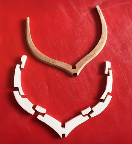

I've wasted a whole week thinking that I could re-cut frame rib "I". It is nearly impossible to match the precision of the factory laser cutting. I'm close but no cigar. Very small imprecisions in my cutting were magnified and I ended up with a rib that was passable but nowhere near as good as the one I oversanded the fairing on. I will live with it and not be so picky. It will only show when I'm looking at it. Lesson learned. Don't blunder ahead and improvise when I should take the time to work things out according to specifications. I have my fairing template issue sorted and I will now forge ahead.

#45 Posted : 19 April 2021 23:31:36
This is coming along beautifully, very well done indeed....Cool Cool

I have had some success replicating bulkheads on a plank-on-bulkhead model, but those leave a lot of wiggle room for small errors in the cut. Since these are actual exposed ribs I think you are right, and going with the laser cut rib is a good option. Looking at the photo and it appears the area you are concerned with is the top-most part of the rib? Is this correct? If so, based on photos of the completed model, from the whales on up that part of the rib will be covered and not visible as you stated. May need a shim or two to make the outer planking look nice, but overall would look fine.
However, I get what you mean when you say you will know it is there. This gets me as well. Many times I have put a bit of extra work into something to fix an error that would likely never been seen by anyone and only known to me. But, just me knowing is enough to drive me to correct it. However, there are also many times when I need to convince myself that it is okay to move on and accept the mistake as character.
Whichever way you decide to go I am sure your will be fine. Your craftsmanship is stellar and the images you post show that. Keep up the excellent work! Looking forward to how it works out with this rib and what you choose to do.

Yes, that's it. It's a mistake that only I will know about and it really bothers me. You are right that the planking will cover the mistake. I am going to go with the factory part. This is my first ever wood model and I wanted it to be perfect. I guess that perfection won't happen but that being in the "pretty good job" category will be alright. The one thing about this is that it has steeled my resolve to be more exacting from here on out. I got half of the other hawse piece glued up yesterday and I will finish it today, let it dry good and start shaping it this weekend. Build the cradle and the lifeboat yard and then wait for pack five in about another week or two. I sure hope that our readers will be motivated to run out and get this model. This is one that is very interesting to build. I've never seen anything like it.

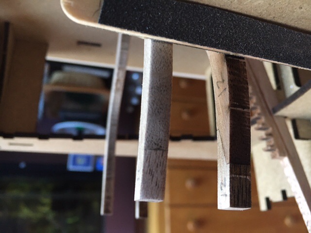

I had to pick Tenderfoots brain a little bit on the sanding. I'm having a devil of a time getting the laser scorch marks off the sides of my ribs. After reading his advice I tried a new tack and voila ! I made myself some little sanding sticks by gluing 150 grit wet or dry sandpaper to a Popsicle stick. I am going to use those to sand the fairing on my ribs but I had an idea. I had an epiphany and noticed that the wood grain goes different directions on the individual rib parts. Using my homemade sanding stick I rubbed at the scorch WITH the grain. Came right off with very little effort. A little follow up with a 220 then 400 grit sanding sponge gave me the elusive results I wanted. What an imbecile I was to not take the grain direction into account. Oh well, live and learn, at least I left it alone until I figured the correct course of action. One other thing is that in places where I was sloppy with my gluing, the excess glue seems to have set the scorch marks. So, I can proceed having learned something and fully expecting another problem to rear its ugly head at another time. Talk about going to The School of Hard Knocks !

Good to see you found a solution. If you are like me and others you will soon find you have dozens of home-made sanding sticks - some long, some short, some pointy, some rounded - it is quite often that one finds need for a custom sander and these types of models multiply the need.
School of Hard Knocks is so true...but what a fun and rewarding education you get. Great work on your ship!

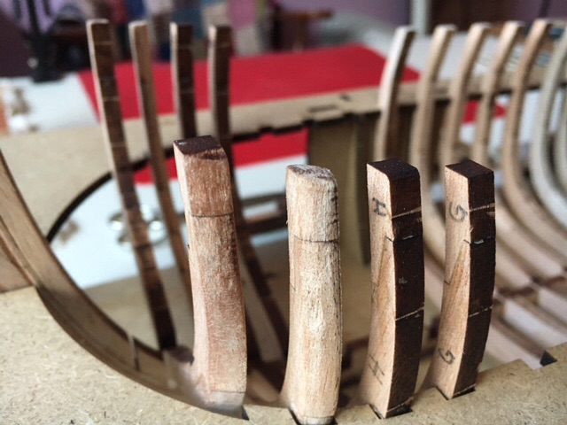

I have everything from pack 4 glued up and I got the email that pack 5 is on the way. Frame rib # "I" and the poor sanding and fairing that I did on it is tormenting me to the depths of my soul. I can't live with it. I got on the horn to customer service and ordered replacement parts. $15 bucks per rib plus $5 bucks shipping. I also ordered frame rib # "L" as I am afraid that my first one won't match up right to my hawse pieces. The fairing of that rib and the shape of the hawse blend together and would look pretty amateurish if not exactly right. Another factor is that these two ribs are the very front two and are a focal point of the finished model. So, $35 bucks later I am a bit wiser. I am inspired by Tenderfoots build on this model and the painstaking efforts he is going to to produce a first class model. This is just too nice a thing to ham hand it together. I will probably be going a bit slower on my build now that spring is here and "She Who Must Be Obeyed" has a list of yard tasks for me that would be suicidal to put off. Rest assured, however, that I will be forging ahead and building this, just with that much more deliberation. Stay tuned.

I hear ya, Medric. I have often had my mistakes torment my soul until I decided to set things right. It is also a testament to the quality of the subscriptions as well as customer service that they make accommodations for our poor tormented souls. When working on the Victory several years back I actually re-ordered an entire month since I botched the hull planking so badly that I needed all new material. So you are not alone...we are here for you...all us tormented souls.
In the end, all that matters is that you are satisfied with the results, not just now, but also when the ship is completed.
