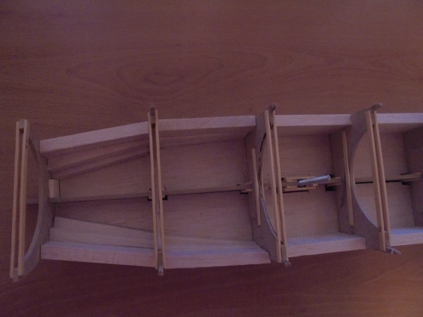

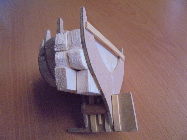

Hi Everyone

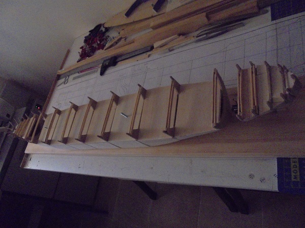

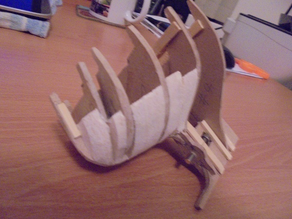

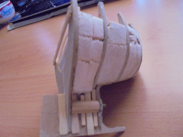

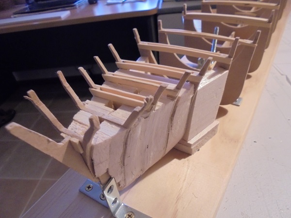

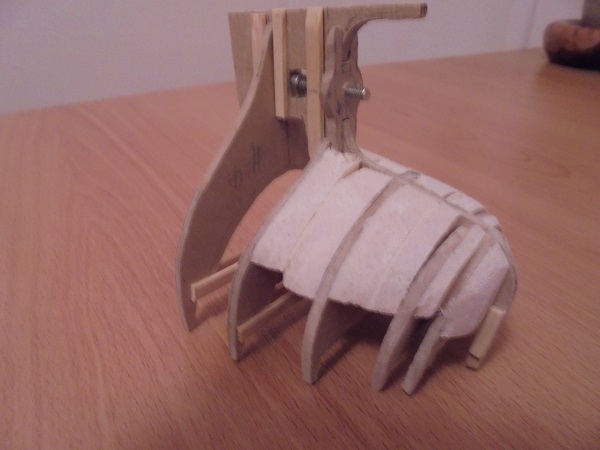

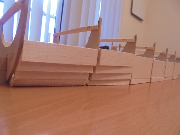

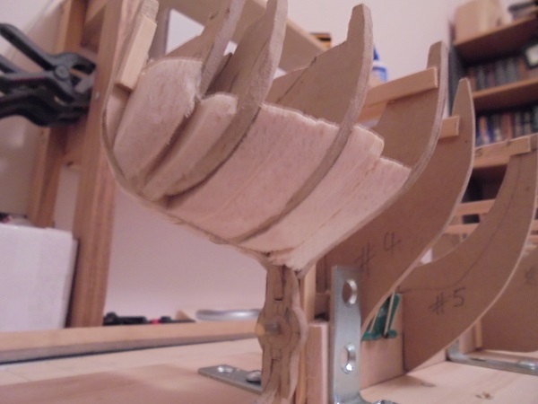

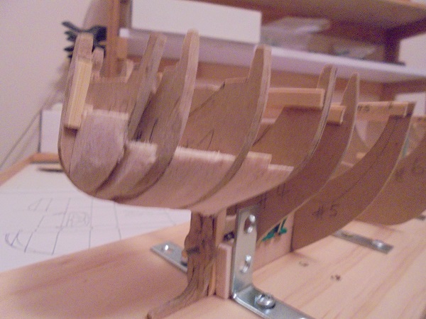

Here is another update, which shows start of infilling with balsa to the stern frames. The balsa is of bits left over from my SotS build, waste not, want not...Laugh
JohnP
John Passmore attached the following image(s):

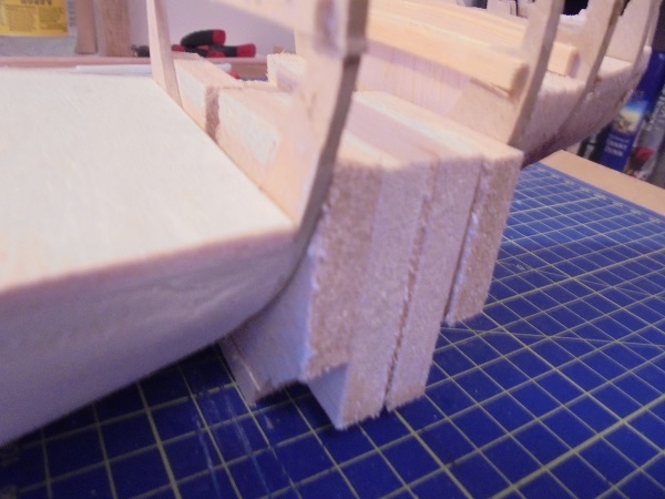

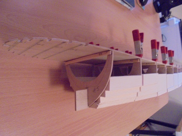

John Passmore
#42 Posted : 12 January 2021 02:37:25
Joined: 25/04/2014
Posts: 374
Points: 1,134

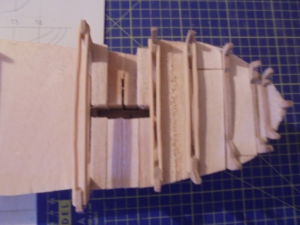

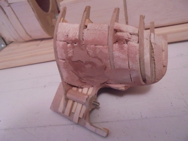

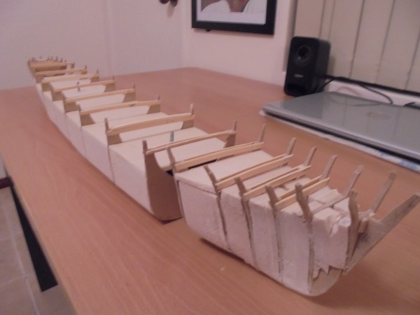

Hi Everyone

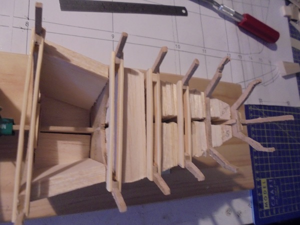

I have infilled the Stern and now the Bow flares with left over balsa from Sots...I think this will be a good basis for later cladding ( method yet to be decided....BigGrin Cool
JohnP

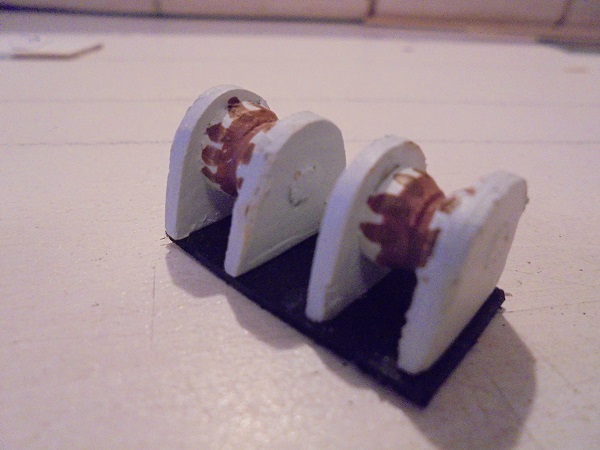

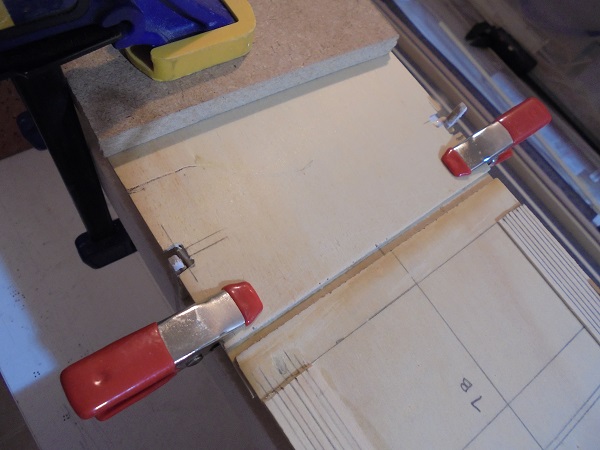

John Passmore
#45 Posted : 26 January 2021 15:02:59
Joined: 25/04/2014
Posts: 374
Points: 1,134

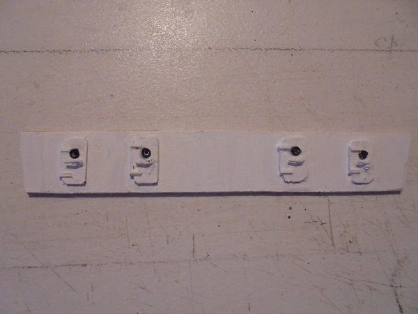

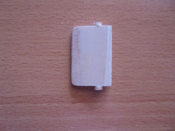

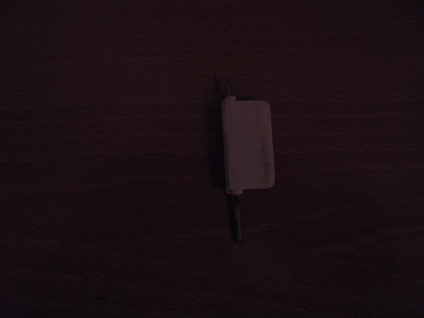

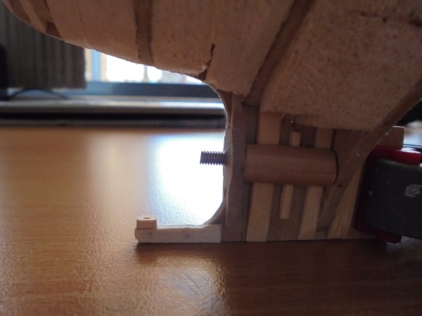

Hi Everyone
Here's a little more progress - working on the rudder / rudder frame...Cool A lot trickier than I thought and took quite a lot of trial and error before I was happy with it...Cool A bit more touching up to be done though....BigGrin
JohnP

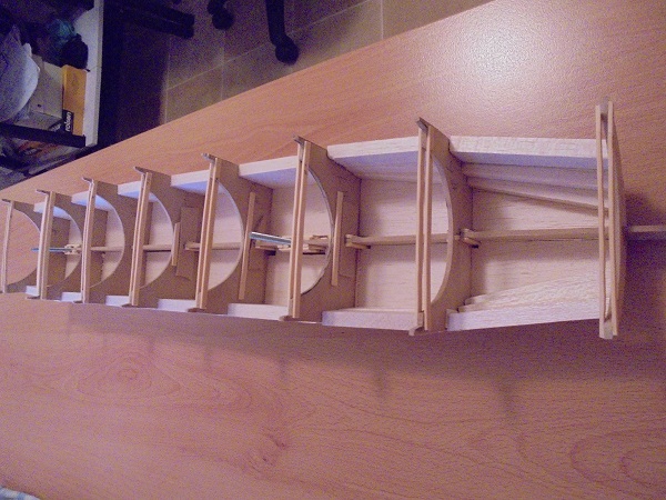

John Passmore
#46 Posted : 26 January 2021 15:12:00
Joined: 25/04/2014
Posts: 374
Points: 1,134

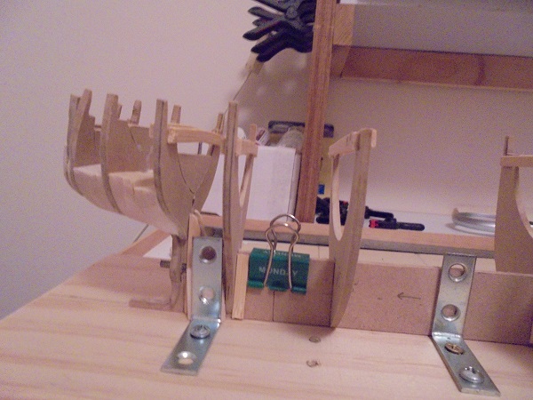

More progress now...Cool
Did more infill to stern section...Cool

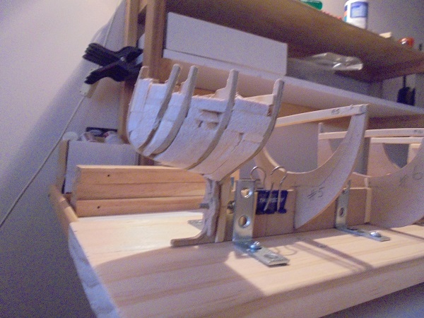

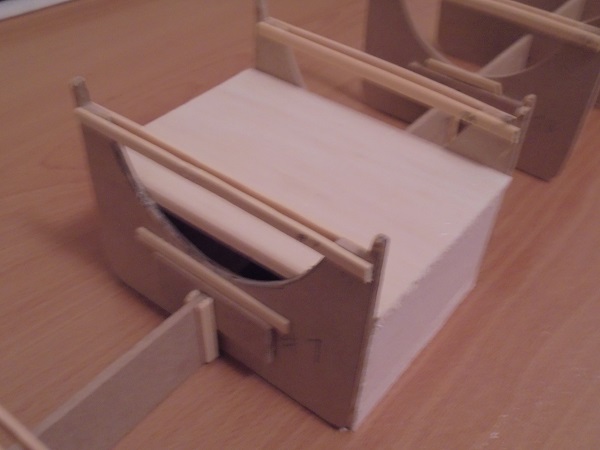

Have decided to infill the complete hull as it seems too fragile...Blink Each section will be filled by hollow box using 9.5mm balsa -instead of a solid infill - and just as firm as it turns out...BigGrin Cheaper too!...Laugh
JohnP

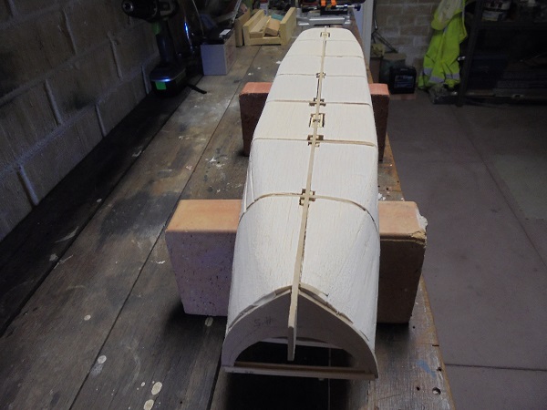

#47 Posted : 30 January 2021 19:56:47
Joined: 20/03/2010
Posts: 1,199
Points: 3,473
Location: Glenrothes
BigGrin Hi John
Looks like she is coming along well
With regards to comment you made on shaping the stern on my build
I think I will remove the filler at the last frame
Then once the planking is complete fill the last frame in again and sand to shape blending in with the final thickness of rest of hull
I think that may be the easier option
Looking forward to your next update

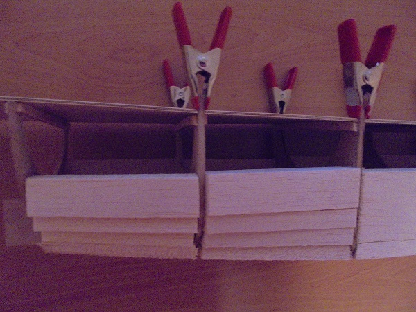

John Passmore

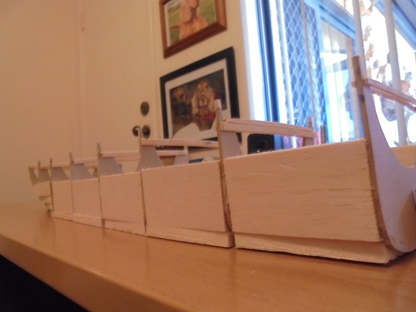

#48 Posted : 31 January 2021 08:05:10
Joined: 25/04/2014
Posts: 374
Points: 1,134
budgie wrote:
BigGrin Hi John
Hi Budgie
Thanks for looking in - I think you seem to have your little problem solved...good one...BigGrin

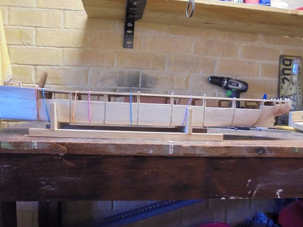

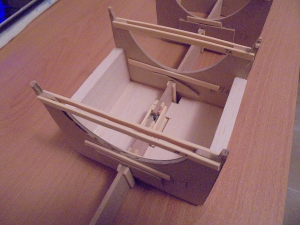

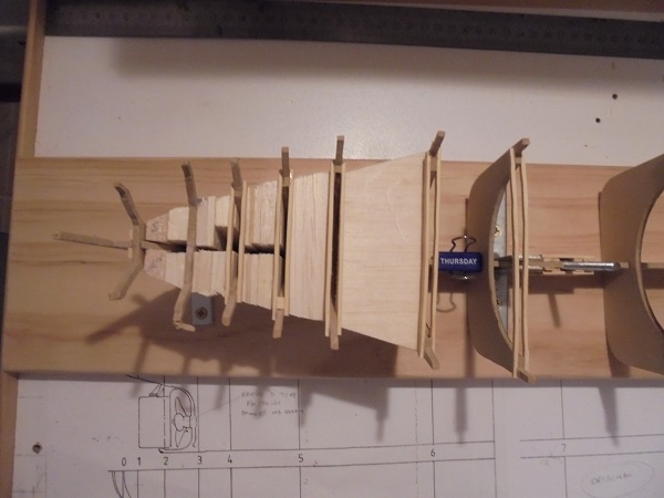

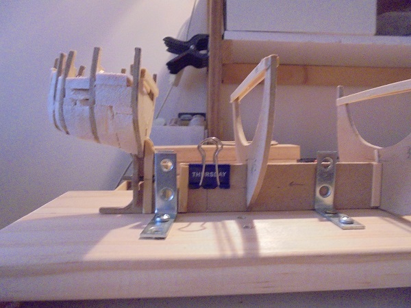

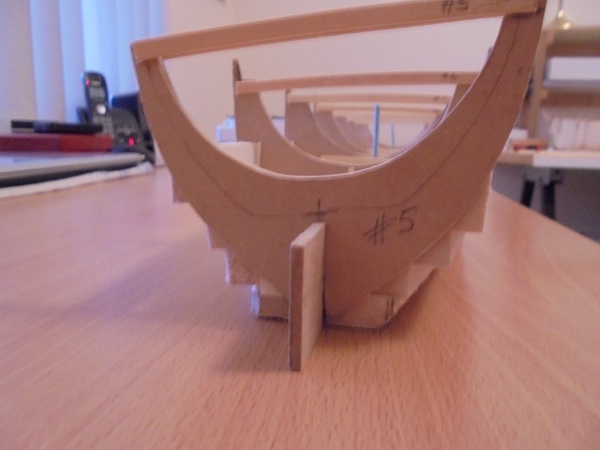

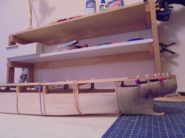

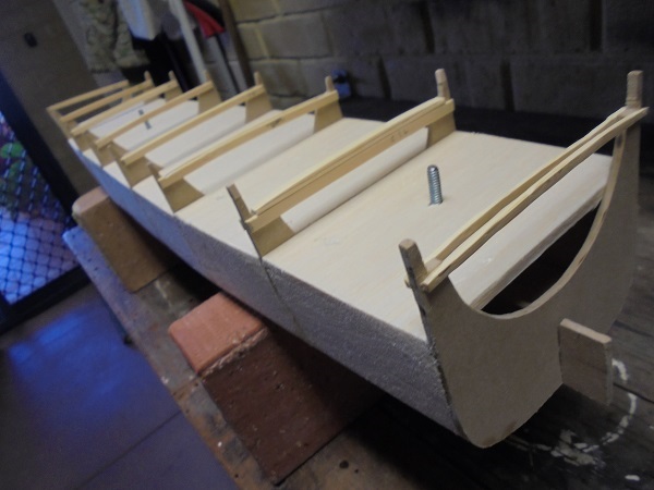

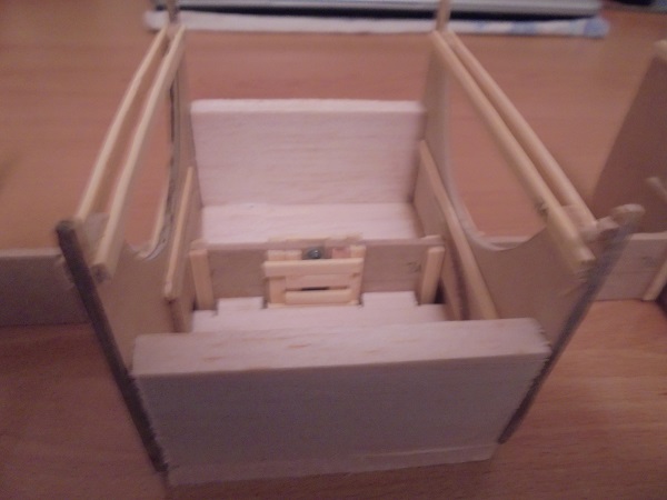

Here's my latest update
Infilling the midships section of the hull...will soon have to start sanding and fairing....Cool
3rd picture shows the flat bottom so I can now dispense with the dry dock...Laugh
JohnP

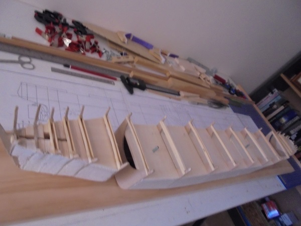

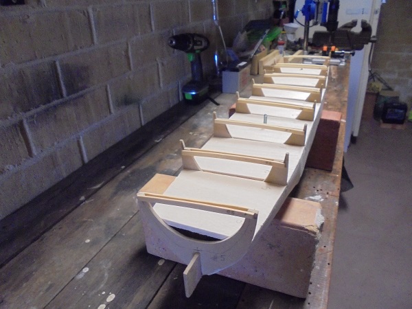

Hi Everyone
We are in lockdown here due to covid - we've got one community based infection after 10 months free!...Crying
So I've managed to push along...BigGrin

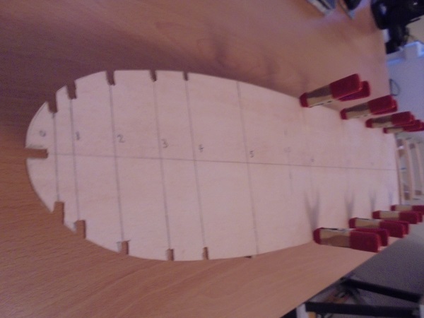

* Glued the lids on the infills
* Sanded the hull
* Trial fitted the 3 hull sections
Some minor adjustments to be done....BigGrin BigGrin
JohnP

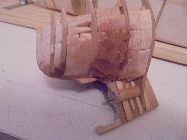

Joined: 25/04/2014
Posts: 374
Points: 1,134

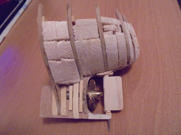

Hi Everyone

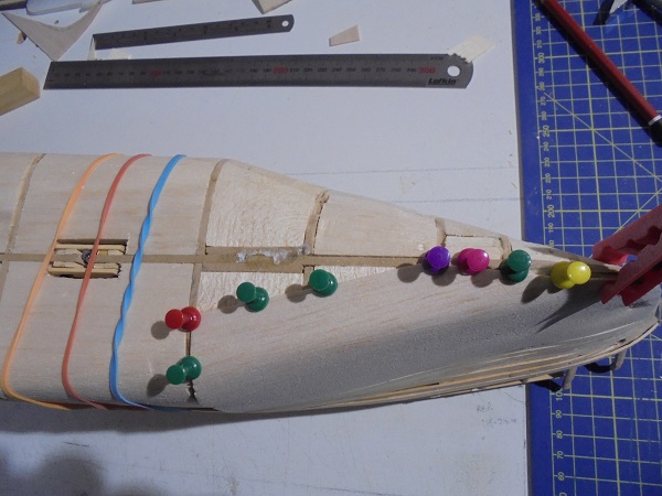

Working on the prop shaft tunnels to create a foundation for the infill...Cool
Infilling depressions in stern hull - looks a bit ruff dunnit?...Laugh But not to worry folks it will all come out alright in the end...Laugh LOL
JohnP

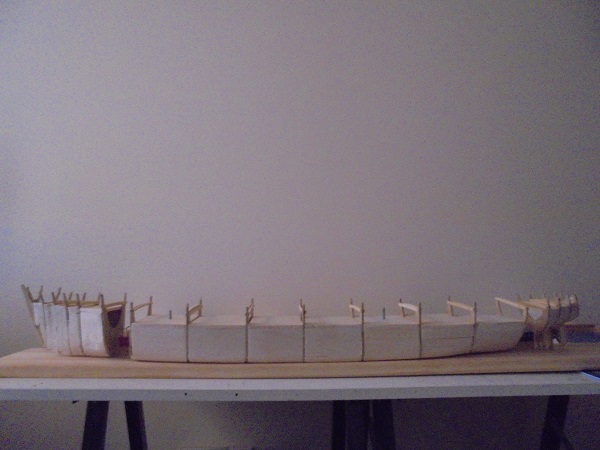

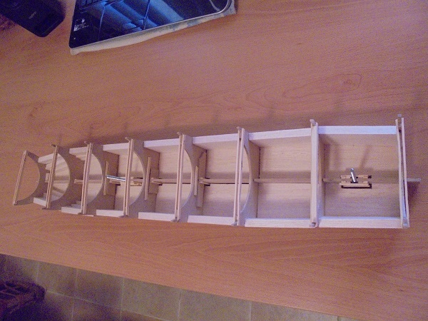

Hi Everyone again

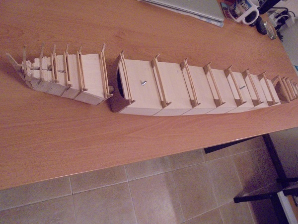

Just a little more progress - and a bit of a milestone...Cool
* Fitted the 3 hull sections together;
* and the 2 final infills done....BigGrin
Next time: Hull sanding...Crying
JohnP

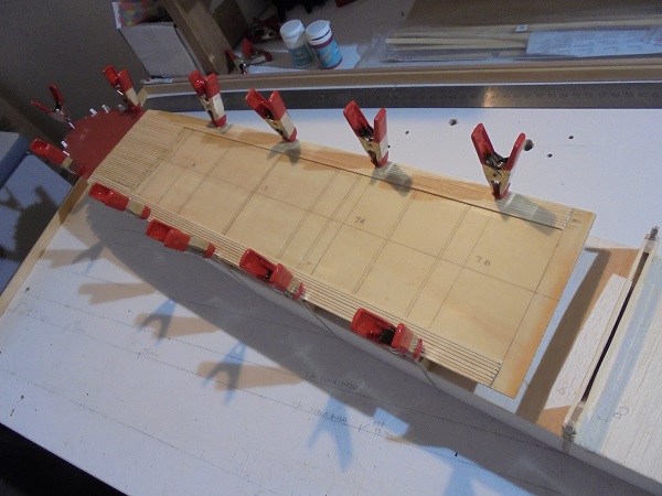

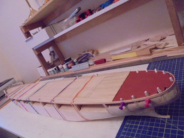

John Passmore
#54 Posted : 28 March 2021 06:39:41
Joined: 25/04/2014
Posts: 374
Points: 1,134

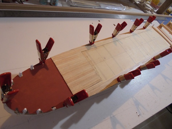

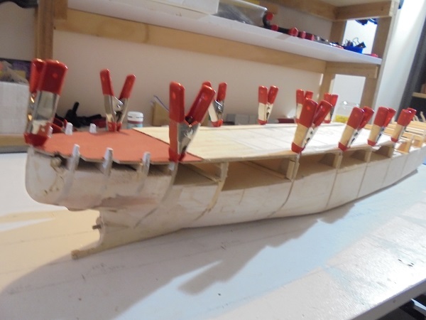

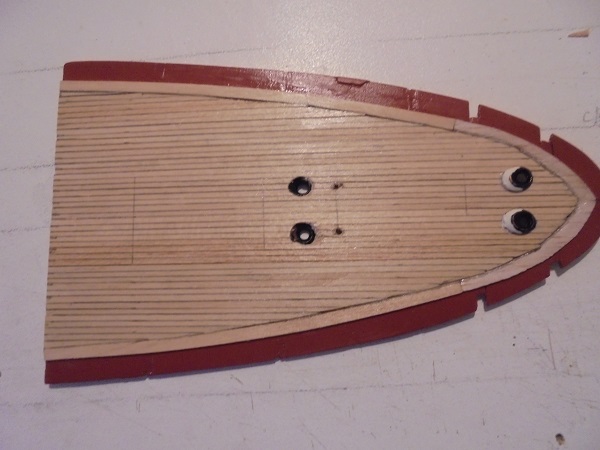

Hi everyone
Some progress for March...Cool
Fitting of the Maindeck (stern section)

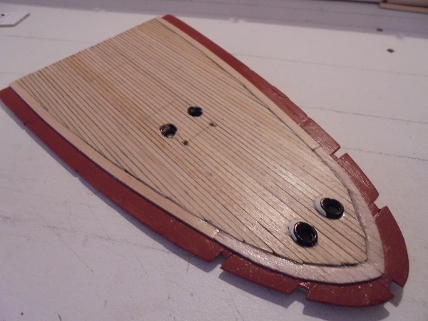

* Planked using 5mm x 1mm lime wood. Caulking achieved with a 2B pencil at 2.5mm widths to maintain scale. Then clear water based varnished - 1 coat only...Cool
* Extreme after deck is/was steel plate painted Red Oxide. Found a good colour match with Admiralty Paint Red Ochre...Cool
JohnP

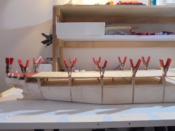

Hi Everyone
Here's some progress for April and May 2021
*Fitted Main Deck forward. Small gap of 4mm between that and the Main Deck aft...Blushing Easily fixed with a plate underneath and a strip inserted to plug the gap, the will be covered by superstructure later on...Cool
*Fitted Forecastle Deck with planks overlaid
*Made Forecastle deck bulkhead

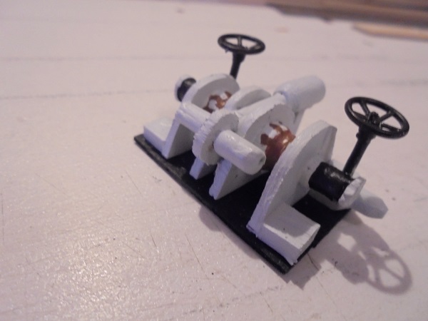

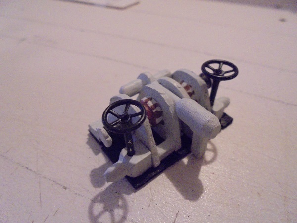

*Made Anchor Windlass and Anchor Chain Guides
JohnP

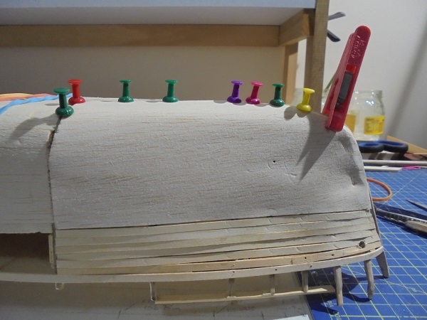

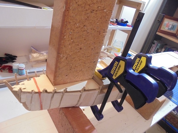

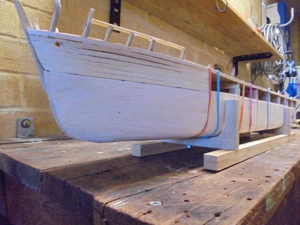

John Passmore
#58 Posted : 22 June 2021 06:36:27
Joined: 25/04/2014
Posts: 374
Points: 1,134

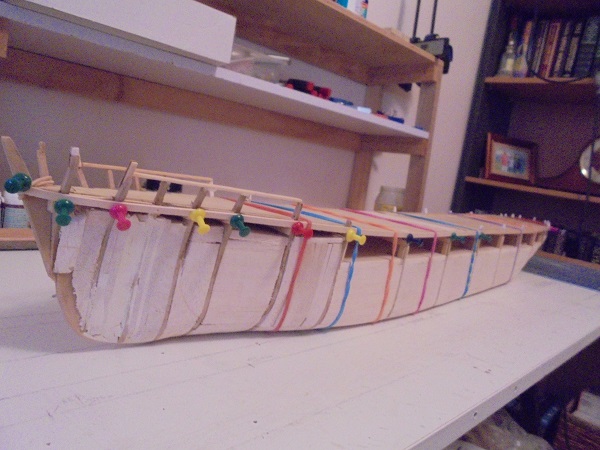

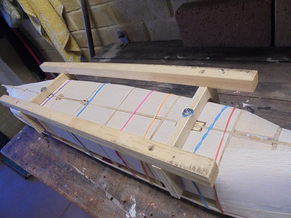

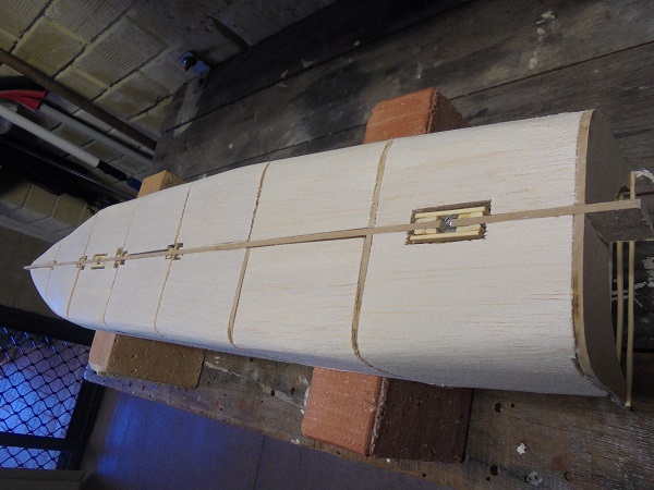

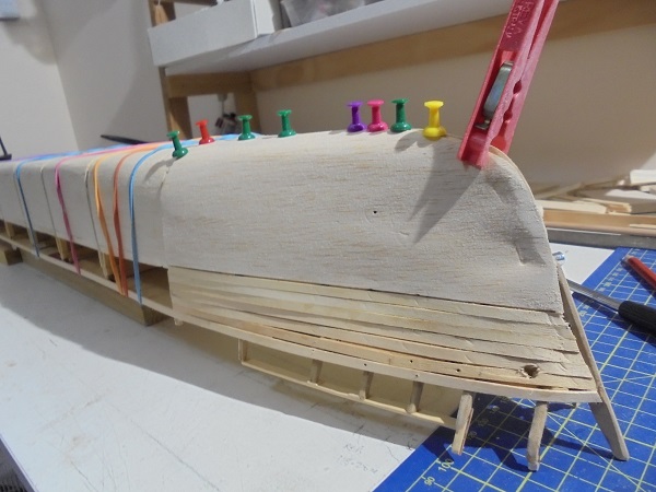

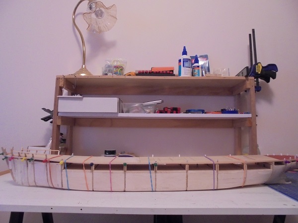

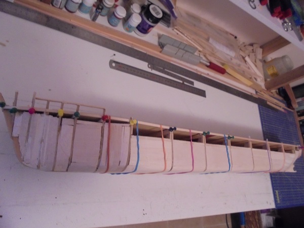

Hi Everyone
Here's my progress for June 2021.

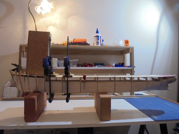

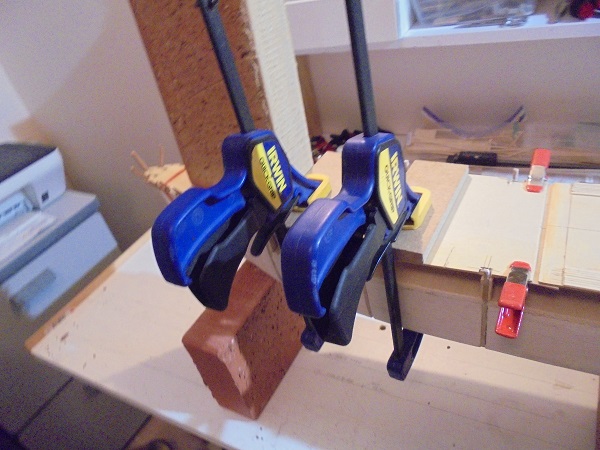

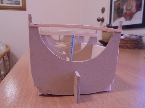

* Modified the old SotS build cradle - nice and simple, this one....BigGrin
* First guide plank install around entire hull at main deck line....Cool Hoping it works out....Blink

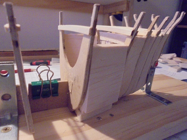

* Working on Bow Flare of hull, lots of problems but getting there...Cool Balsa is only 1mm thick and clamps were a bit fierce! will fix all with filler....LOL
JohnP
