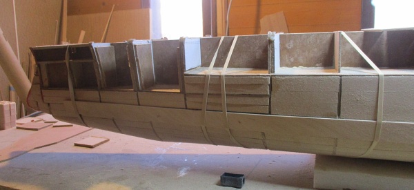

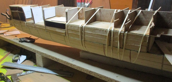

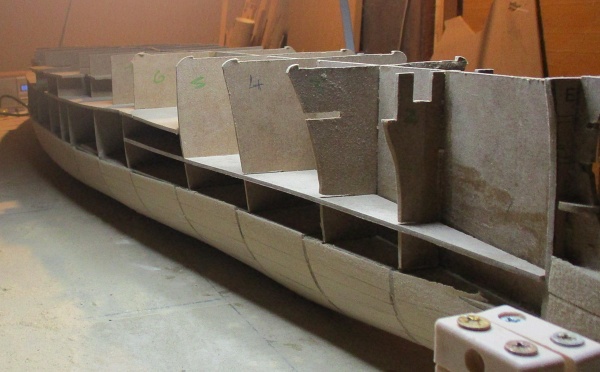

BigGrin Evening Folks.....thanks for taking the time to comment ....appreciated
Blushing Slow progress with planking between the lower frames (watermark line is further up the frames)
My aim is to achieve a smooth finish rather than a pretty one as it will be covered with a second planking or summit elseLOL
Cool Hats off to you Folks who do single planked period ships where the planks are in symmetry on each sideLove Love
This ship should actually have four torpedo tubes. Fwd, aft, port and stbd midship but this model only has the fwd one representedCrying
Anyhoos some pics off progress so far
Thanks for lookin'

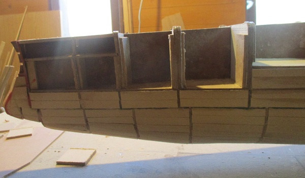

Location: Glenrothes

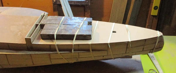

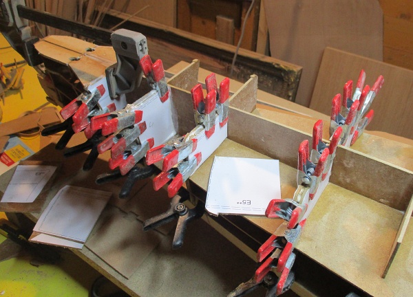

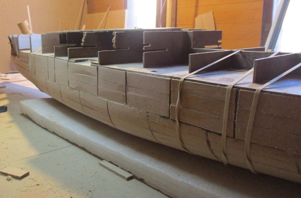

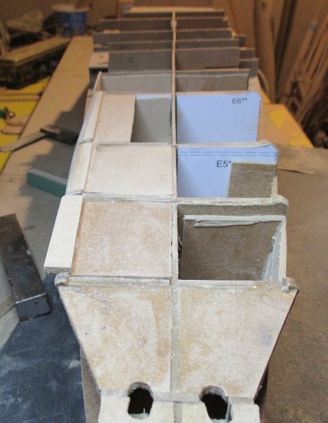

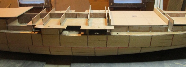

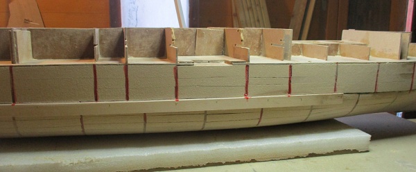

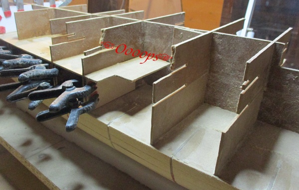

BigGrin Hi Folks
Managed to damage 2 upper frames when removing the elastic bands ...must have gotten stuck in the slots when I removed them Crying
Cool I have photocopied those frames again and will glue either side of the damaged area
Have started working up the way between frames 1 - 7
Glued in strips similar to the lower hull for planks to sit on between the frames
The fwd area between frames 3 and 6 ..the hull is rounded to join the upper deck...like a cross between Stickies U boat and Tigerace''s Schnellboot
I have made more of those frames to give me a larger surface area to play on when it comes to shaping those lines.
Well that's the planLOL
Thanks for lookin'
budgie attached the following image(s):

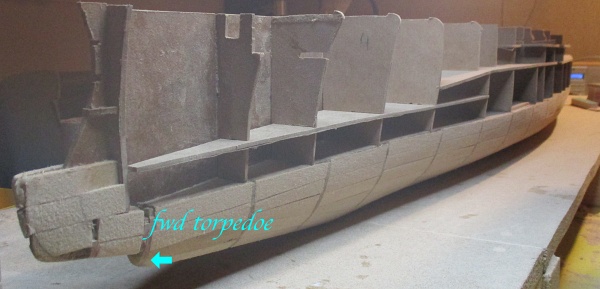

#46 Posted : 24 December 2020 09:30:29
Joined: 20/03/2010
Posts: 1,199
Points: 3,473
birdaj2 wrote:
Planking looks very good.
You are making a really nice job of this one so much so it looks as good as a pre cut out commercial kit.
There are always slight issues like those 2 frames breaking but you are well skilled in putting that right.
Hi Tony
Thanks for the reply
I am quite chuffed with how the lower planking has turned out so far
I will be a bit more worried when it comes to the area around the rudder and propsCrying

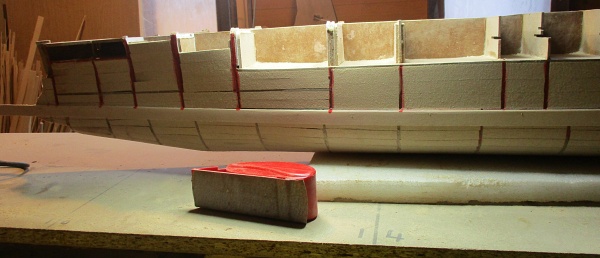

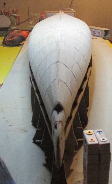

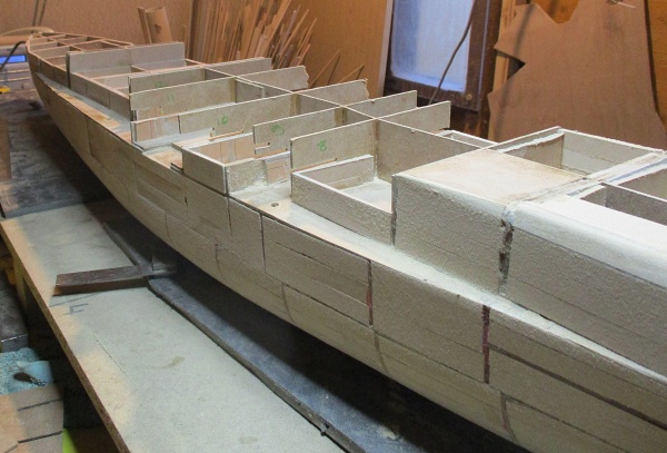

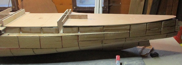

BigGrin Anyhoos Folks not done a great deal this week but pics of progress so far
Perhaps will get a bit more time over the ???"festive"??? periodLOL
Cool Hope Santa is good to you's and brings you the models and tools you's want
Merry Xmas A'body

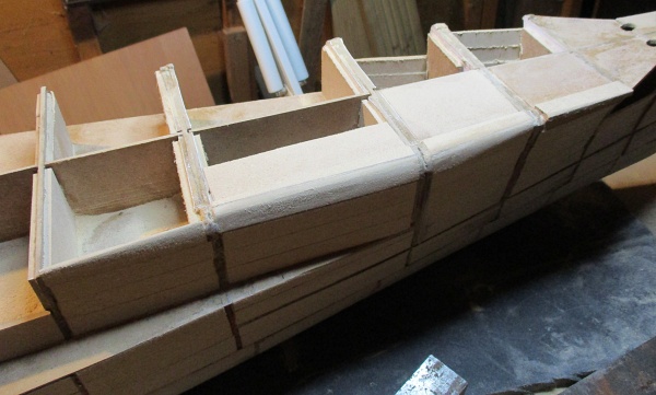

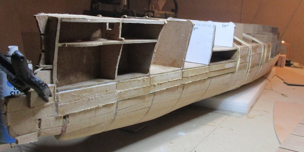

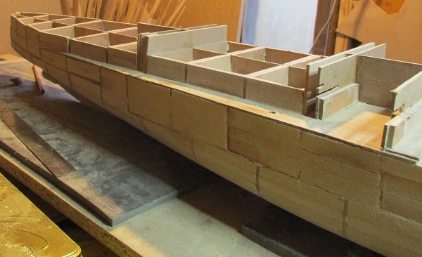

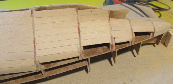

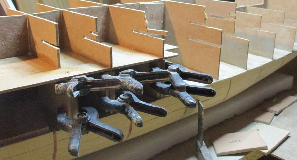

BigGrin Hi Folks

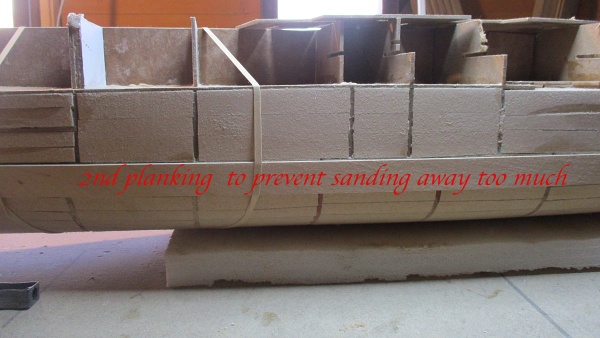

Plodding along slowly filling in the spaces
Sanding as I am going along but cannot continue sanding so it is flush with the upper frames at the moment
As the upper frames are not as wide as the lower ones I have stopped sanding in case I remove too much of the lower planking
Thinking about it,Confused I think I should add a row of the second planking thus giving an edge not to go below
Next I will need to make a sanding block by gluing sand paper to one surface only
I can then run the "baldy" part of the block along the edge of the 2nd planking till sanded flush with the frames
Sounds like a planLOL
Flapper This could have been avoided if I started from the top and worked downFlapper
Thanks for lookin'

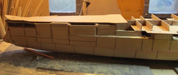

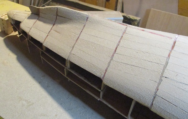

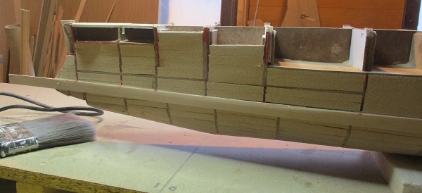

BigGrin Hi Folks

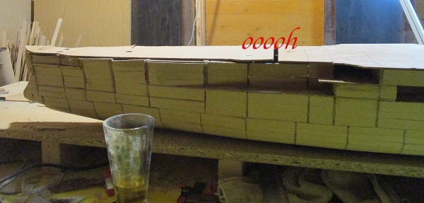

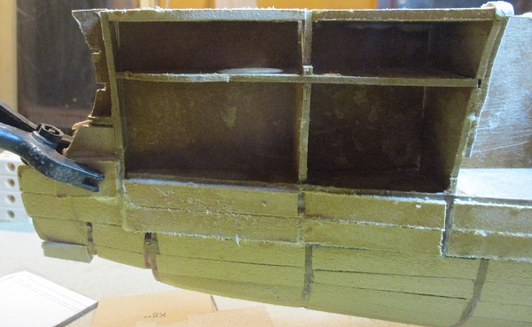

Bored Making slow progress filling in the gaps ..but getting there
Blooming' freezing in the shed
Sanding a bit more to break the monotony of filling
Crying Bad news is am having to do this by hand ...
Flapper Good news is I can turn off the portable heater
Thanks for lookin'

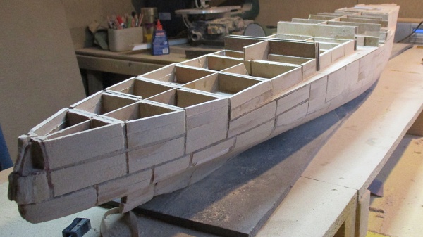

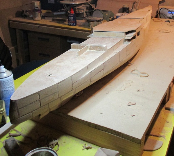

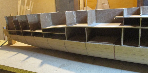

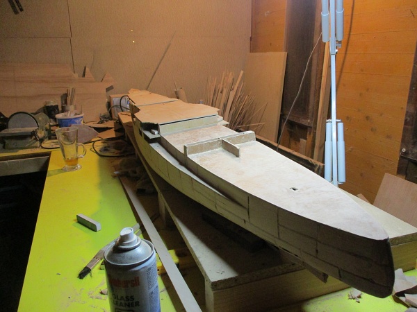

Crying Still sanding way at the hullCrying

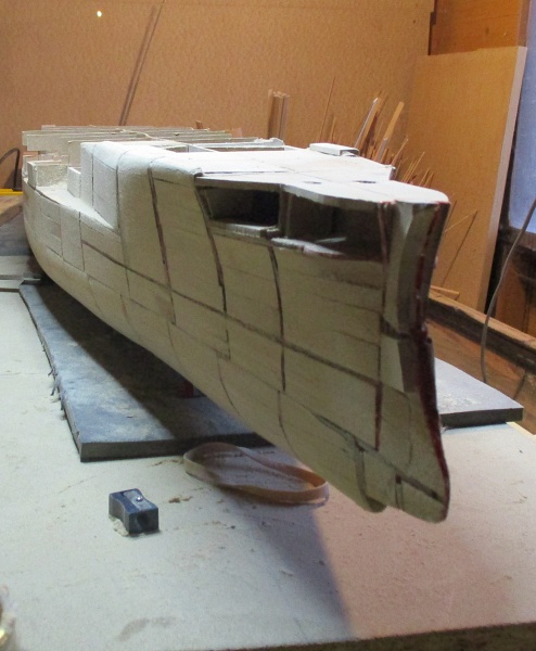

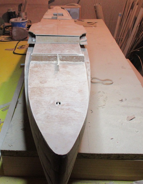

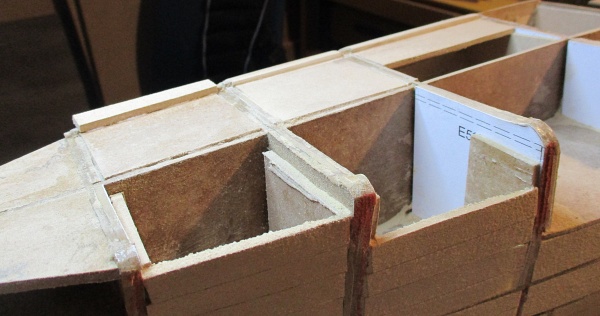

Decided to attempt "rounding" the upper part of the fwd hull which reminds me of a Schnellboot or Submarine
Think the shape is getting there and should improve with a 2nd covering
I will not be laying the deck template on TOP of the frames
I will be laying in-between the frames and sanding flush with the top
This should give me a depth for laying planks
Blink Thanks for lookin'

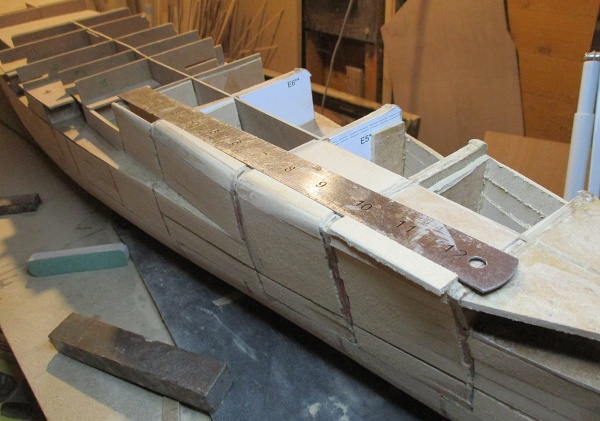

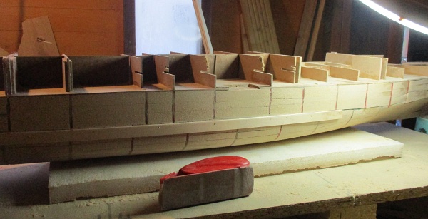

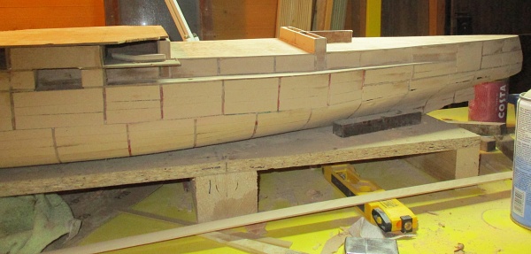

BigGrin Afternoon Folks
Furlough day for me so spent sometime in the shed

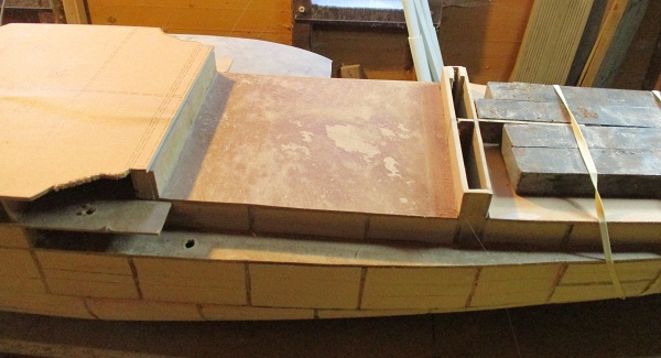

Some deck templates were cut out to see if I had wandered off course, hull too thick ,thin, short or long but seems not too bad.
Humming and hawing over whether I should use them, they are 2mm thick but when I lay the deck planks will it be to highCrying
Will need to check Vic or SOS diaries to see what the minimum thickness of the deck planking was used
Too thin and I won't get the planking effect
Glued some strips for upper bulkheads which will need to be sanded flush with frames
Thanks for lookin'

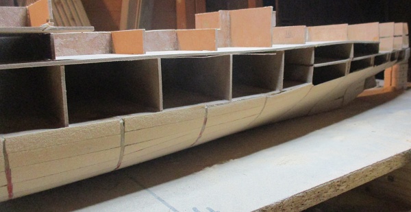

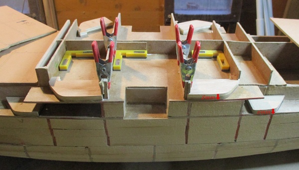

BlushingBlushing Cheers Alan
Crying Fed up sanding the hull ..just doing a wee bit at a time
Crying probably subconsciously delaying the shaping around prop areaBored
Cool Need to get some shapes added to keep me motivated

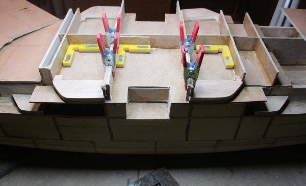

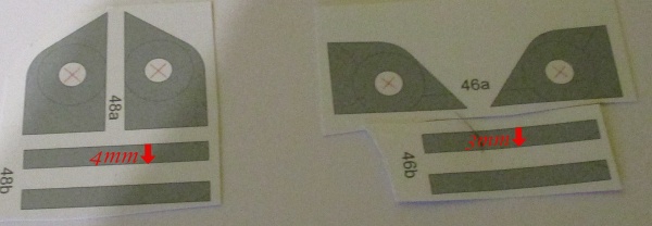

Starting with an easy bit...I hope .. the gun platforms midships
Templates already enlarged
Pic 1 shows colour card to be stuck to plain template for platforms
Thickness measured from card and doubled
Don’t have 8 or 6mm mdf or ply but do have 2 3 and 5mm so platforms were cut on 3mm mdf and stuck on to another piece of 3 and 5mm to make up the height
budgie

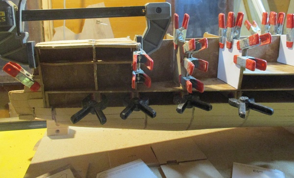

BigGrin Good Evening Folks
Decided to add the decks to aid in shaping the hull
As the 1/200 scale decks are 1mm I have used 2mm mdf
There are 2 further card layers on top of this (1/200 scale)1 for the metal deck and another showing the wooden planking I thought it safe to progress
The aft deck and the midship deck fitted with an acceptable tolerance with being enlarged and my abilities
But the fwd deck looks a bit short Confused Confused Confused
Flapper Evel Kineval would have difficulty in crossing that gapFlapper
If the keel was too long then the other false decks would not have slotted in to their designated placesConfused Confused
I will re photocopy this deck template as it does not fit on 1 sheet of A3 incase I erred on joining the two templates together
Thanks for lookin'
