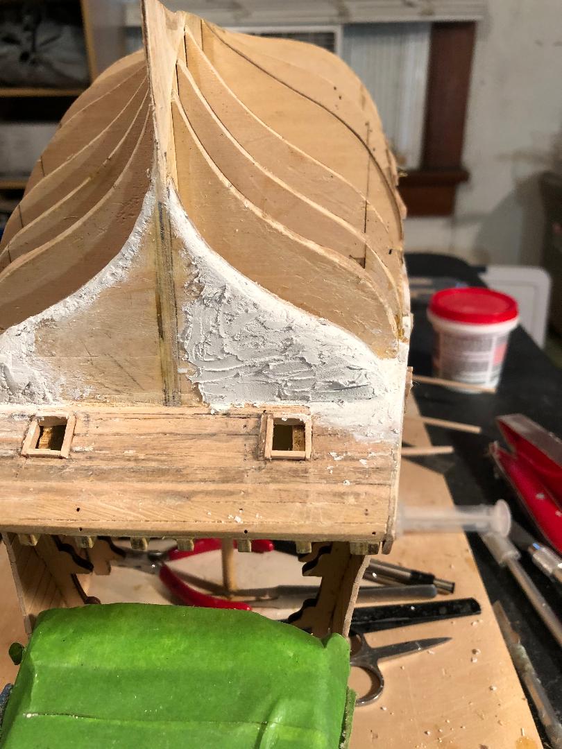

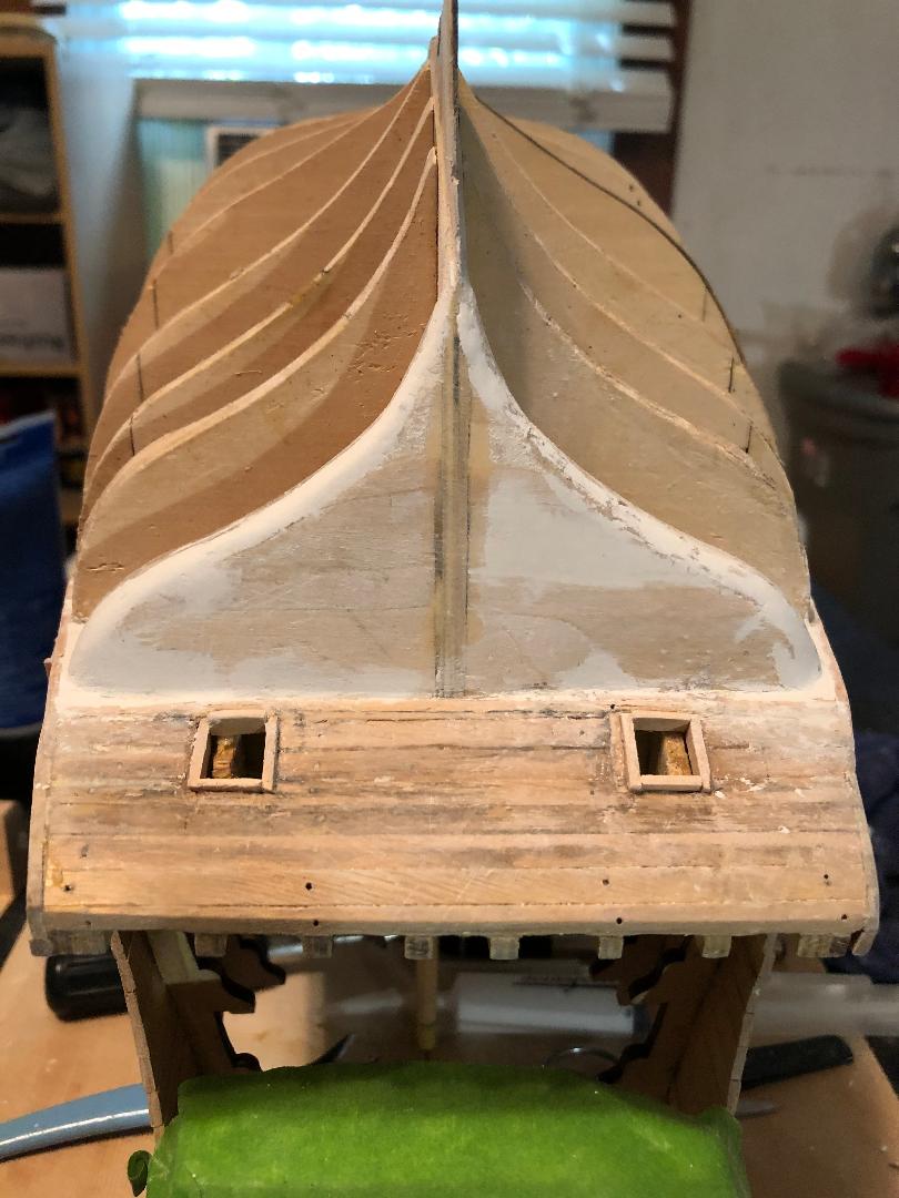

Ok Alan
I finished filling the right side of the stern with wood putty but had to spread some putty on the front because it was un even as seen in the photos
Ronald

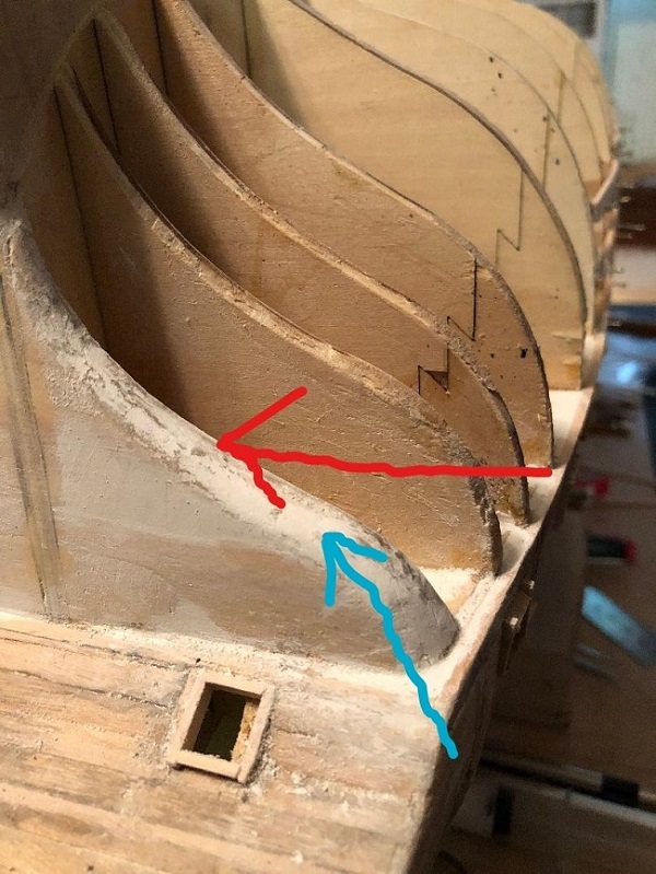

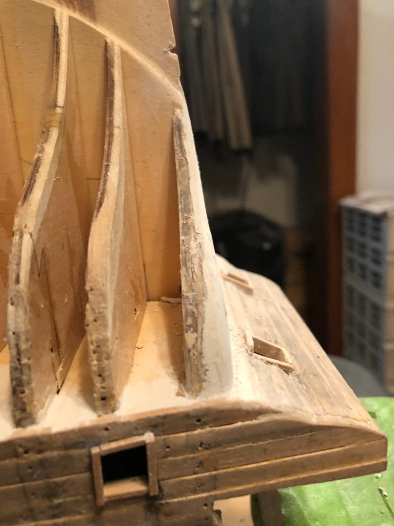

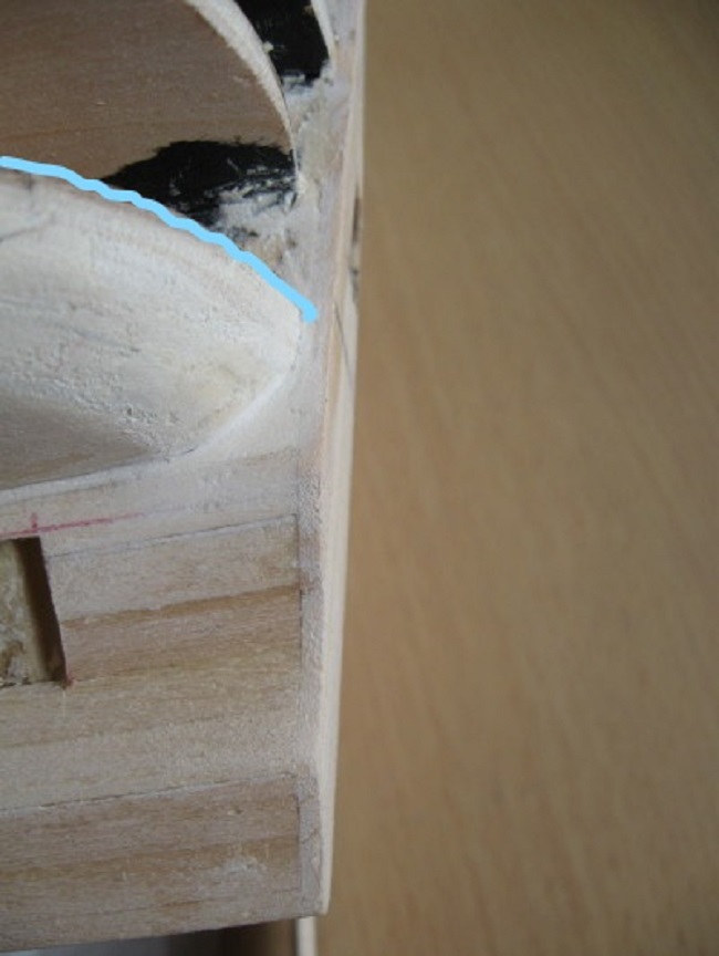

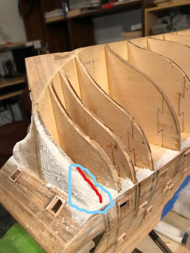

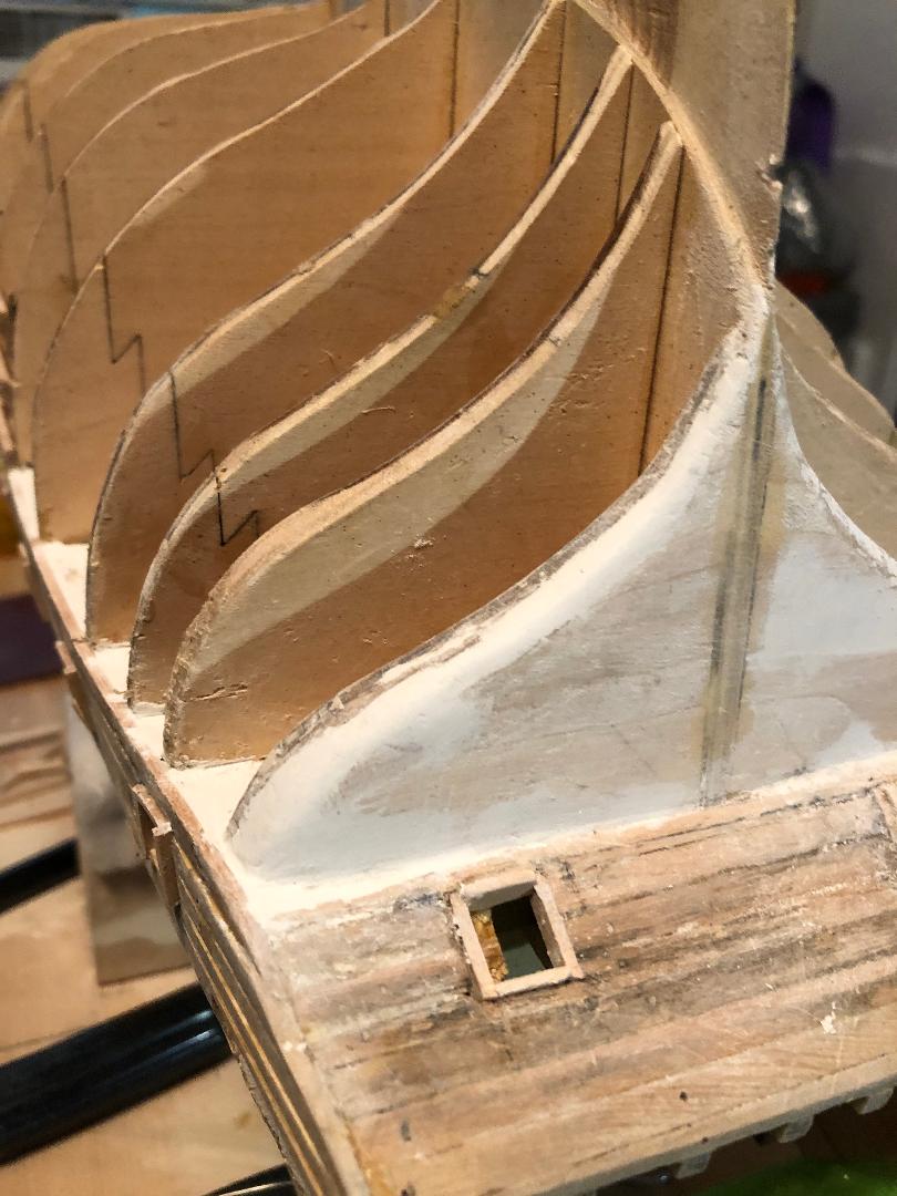

Ok Ronald, looks like we’re getting somewhere. The filler should be dry now so next you need to do some sanding. Take your time with this and keep checking the reference image (last pic) showing the shape you are trying to achieve.
Sand the area outlined in blue (first pic), using a rounded motion as shown in second pic. Do not remove material from the rib edge (shown in red). When you think you have achieved the desired curve then move on and do the same to the other side. Post pics when done....

#43 Posted : 23 September 2020 14:08:15
Posts: 1,937
Points: 5,823
Excellent illustrations, Alan! Thanks!

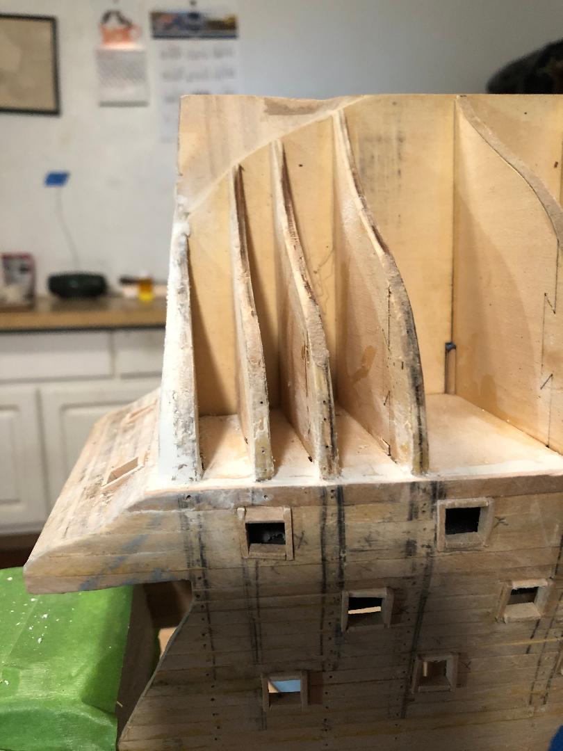

HI Alan
I just finished cleaning up and evening out the stern front when I notice you
sent me a new post, I'm sorry I must have missed the post with the 3 photos
with instructions to start sanding in certain areas as described, anyway I have
a photo showing the front of the stern cleaned up and even, also I wasn't
going to touch the top areas until you say so, but it looks like you got the
jumped on me LOL, so I guess I can start sanding the curved top, anyway what
you think of the front of the stern P.S. the shape in the last photo you want
me to achieve that goes for the whole stern all the way to the keel
right (second photo) it was the one with red cycle around it but wanted you to
view this one first
Ronald

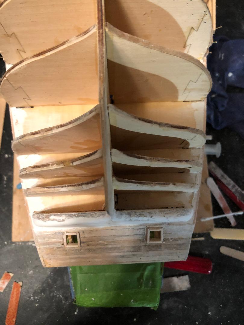

#45 Posted : 24 September 2020 16:35:48
Ok Ronald, it is rather pointless for me to give you instructions if you simply then decide to ignore the instructions given and do your own thing. You may have missed my last instruction with the three pics on the areas to work on but in post #36 I did say not to do any sanding just yet.
Now that you have started to shape the red area, do the same on the other side. Once done, I need 4 pics uploaded. One from either side looking square on, one looking straight at the stern and one looking straight down.
Look forward to seeing the pics.

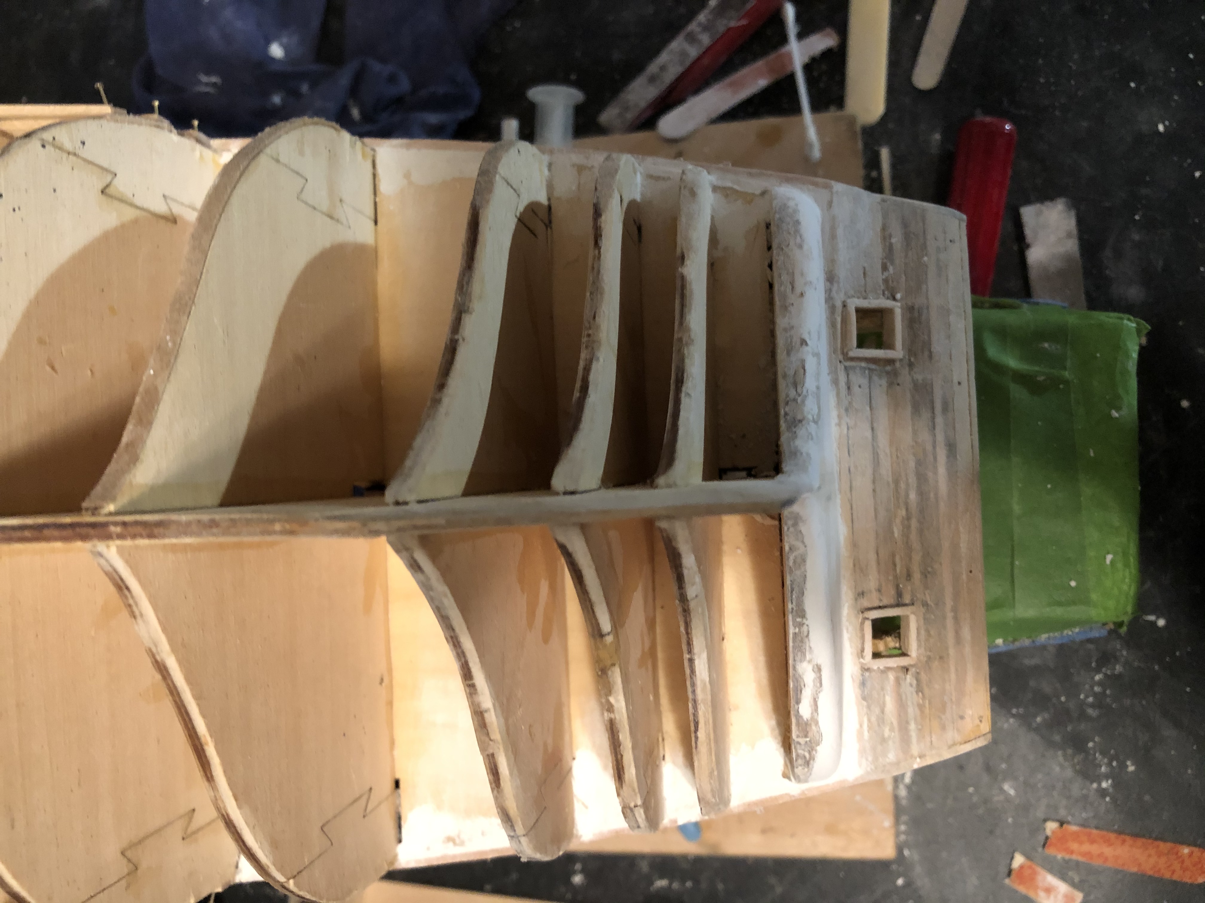

HI Alan
in my defense Sir. I have not ignored any of your instructions on the contrary I
did exactly what you told me to do and what not to do I did not shape the
red area as instructed I only sanded the areas you instructed to sand no more
less I will show you in the photos, along with the photos you want
Ronald
IMG_0368 (2).jpg (1,881kb) downloaded 19 time(s).
ronald305 attached the following image(s):
ronald305
#47 Posted : 24 September 2020 18:08:01
Joined: 08/02/2015
Posts: 426
Points: 1,259
Location: Louisiana
here are the other two photos
IMG_0368 (2).jpg (1,881kb) downloaded 23 time(s).

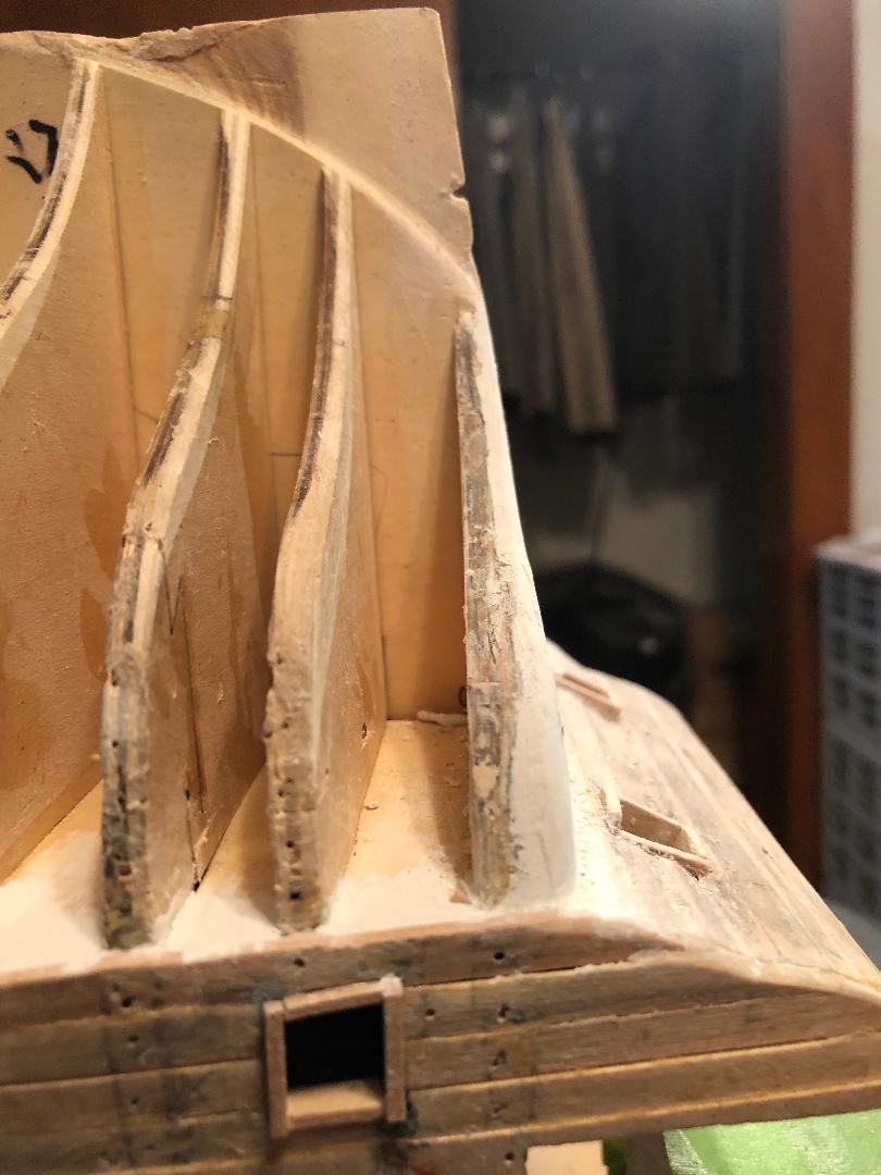

#48 Posted : 24 September 2020 20:55:49
Hi Ronald, I need two pics taken from the side, square on. As shown by the red arrow on the pic below. I need to be able to see the profile of the stern from both sides

#49 Posted : 24 September 2020 21:20:19
Joined: 08/02/2015
Posts: 426
Points: 1,259
Location: Louisiana

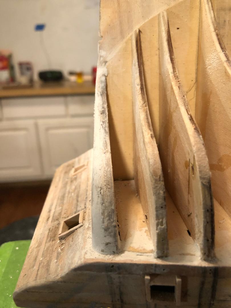

ok Alan I see what you want are these good, the bottom left side photo is better
anyway I tried to get the bottom corners to look like the ones in the bottom photo in post 27 and 42 as much as much as I can where the first plank goes
Ronald

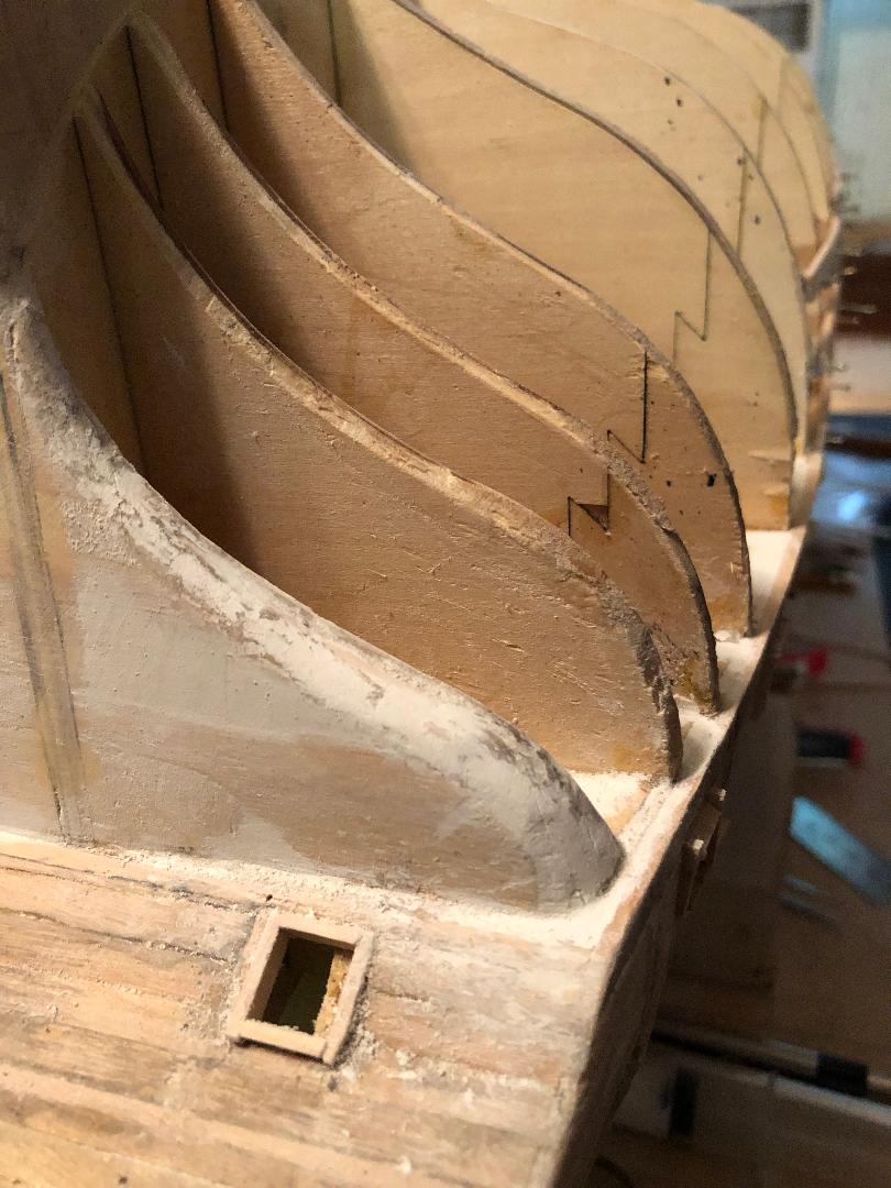

#51 Posted : 25 September 2020 20:45:23
Ok Ronald, thanks for posting the pics up, it really does help a great deal. Now I want you to have a go at preparing the first planks on either side. Carry out the steps in the instructions as shown in the pic below. Temporarily pin the planks in place and I would recommend you pre-drill the pin holes in the planks to prevent any splitting. Don’t pin the very end of the plank at the stern, it’ll be pinned if needed when you come to fit permanently and don’t glue anything in place.
I also want you to temporarily pin a plank along either side of the hull, roughly where the red lines are on the second pic. Don’t glue it down and don’t pin it to the stern rib.
Look forward to seeing the pics as usual.

Hi Ronald, on all your questions, do not pin to rib 30. I'm looking to see the flow of the planks when laid, looking for any dips or humps that may appear....
