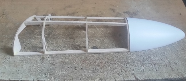

I`ve made a little more progress today.Blink Blink

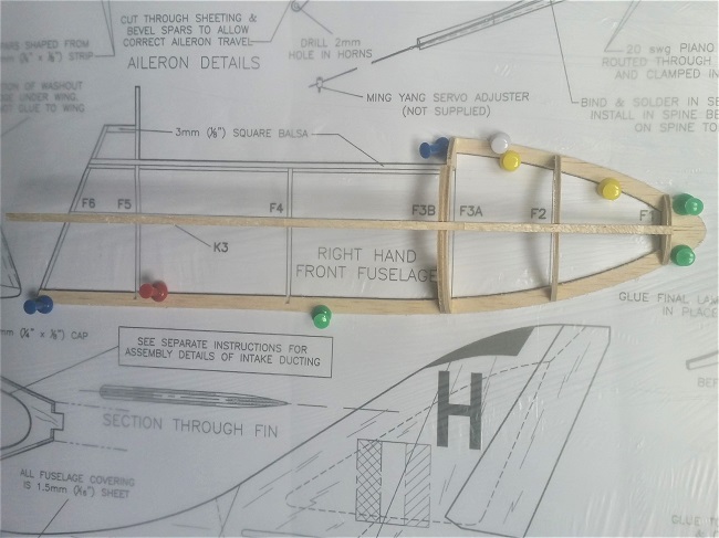

I set the small nose former (F1) in place and square. Waited till set and followed on with former F2 and the combined F3a/F3b. When these were proven to be square I placed (unglued) part K3 to retain the setting of the formers and all is testing nice and square.
I`ve changed adhesives from balsa cement to an aliphatic resin for the latest joints as the parts are now a mix of balsa and ply.
One pic to show how things are going so far.

Last bit for today,BigGrin BigGrin

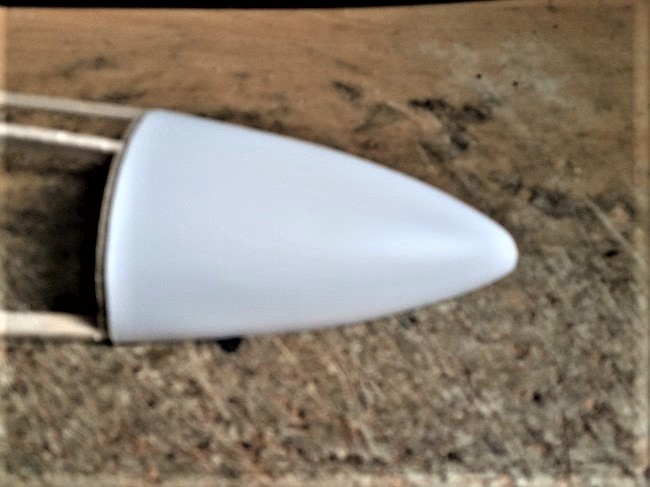

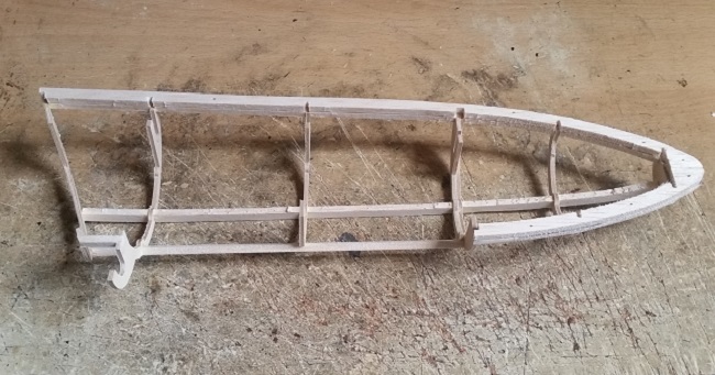

Fixed the rest of the formers 4,5 and 6 and added a couple of 3mm sq stringers, all of which have been glued up and set. Removed the frame from the plan and it sits very flat on the table. (Pic1)
Last job for the day was to trim up the pre-formed nose cone for that side. Will still need a smoothing along the edges after its glued in place, but its as close as I dare for now. (Pic 2)
Next job is to build the opposite side of the front fuselage. This will be a one pic update as its just a mirror of the side already done.

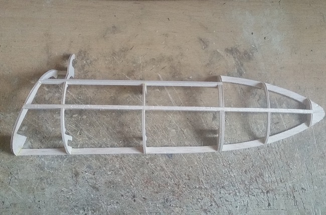

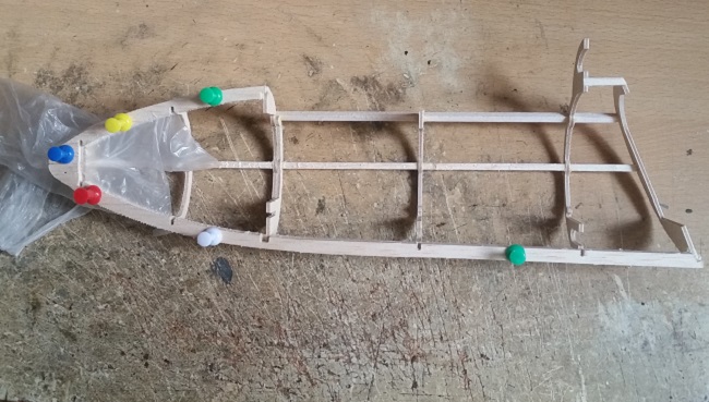

Hi All, BigGrin
Firstly thanks for the comments and all who have taken the time to look in.
Cool Cool Cool Cool Cool
Now as Trev very correctly said in his comment above this is the first crucial stage where I start building the second half of the front fuselage.
I think I can say that there are several options open here to achieve the same end result, so I`m going to show my method with some explanations as to why I do what I do.
As stated previously I wanted the plans to be as flat as possible before starting the build and the reason is that if a plan is creased and you build on the creases you could end up with two supposed identical sections being very different.
Here`s my method:
I use the first built half section as a template for the second half to start with.
I pinned the longest keel section ( that`s what the instructions call it - I know its not a boat, sorry ship LOL ) to its opposite side. I then put some very thin sheet plastic between the nose sections. Applied balsa glue to the joint face of the short section and laid it in place. With both sections lined up with the original half I pinned the short sections together and let the glue set.
See pic 1 of this post.

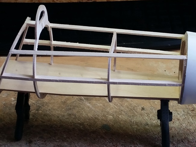

Having made sure that the glue is fully set, I remove the pins and plastic sheet. I then lay the new parts of the second half on top of the first and without applying any pressure make sure they lay correctly on top of each other.
See pic 2 of this post.
Now as I have stated this will not be a flying model, so you may ask "why the need for such accuracy?". My thoughts are that especially with a model of this scale/size, you can be less than 0.5mm out at one end and by the time you get to the far end it could be 5mm out. Crying Crying In the end, even if the sides line up you could end up with a twisted fuselage and then its a bin job.
The next stage is to complete the second half of the forward fuselage. So until then stay safe and enjoy whatever you`re working on.

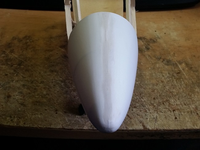

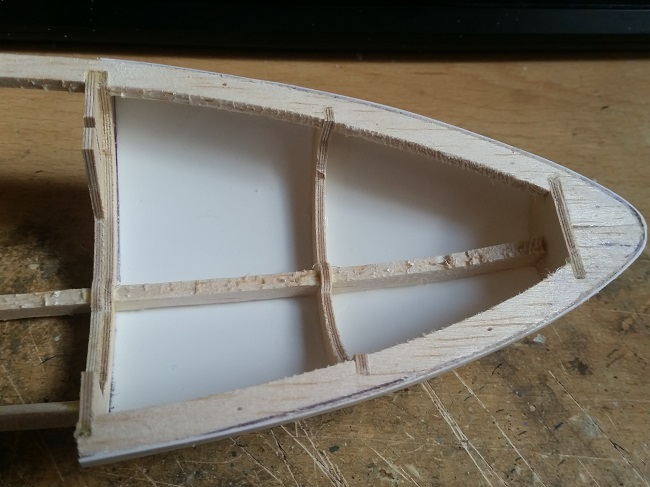

Just a small update before I continue with the left-side front fuselage.
I have glued and trimmed the right-side nose covering and I`m happy to report the fit was really good.
Two pics:
1st looking down on the nose covering
2nd Looking at the inside of same piece
As an adhesive I used "RC modellers canopy glue" by deluxe materials. It sticks plastic to plain wood and even painted and varnished wood. Its thick, flexible, high grip, dries clear and fills small gaps. Perfect.Love
Next update will be the completed left side front, so until then stay safe.

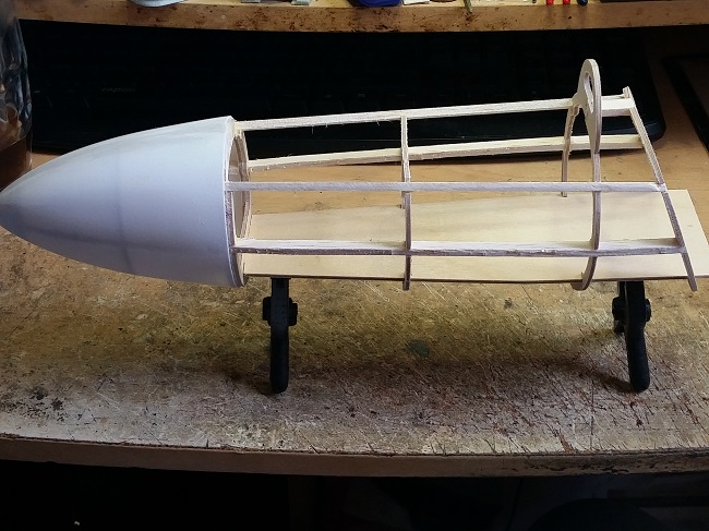

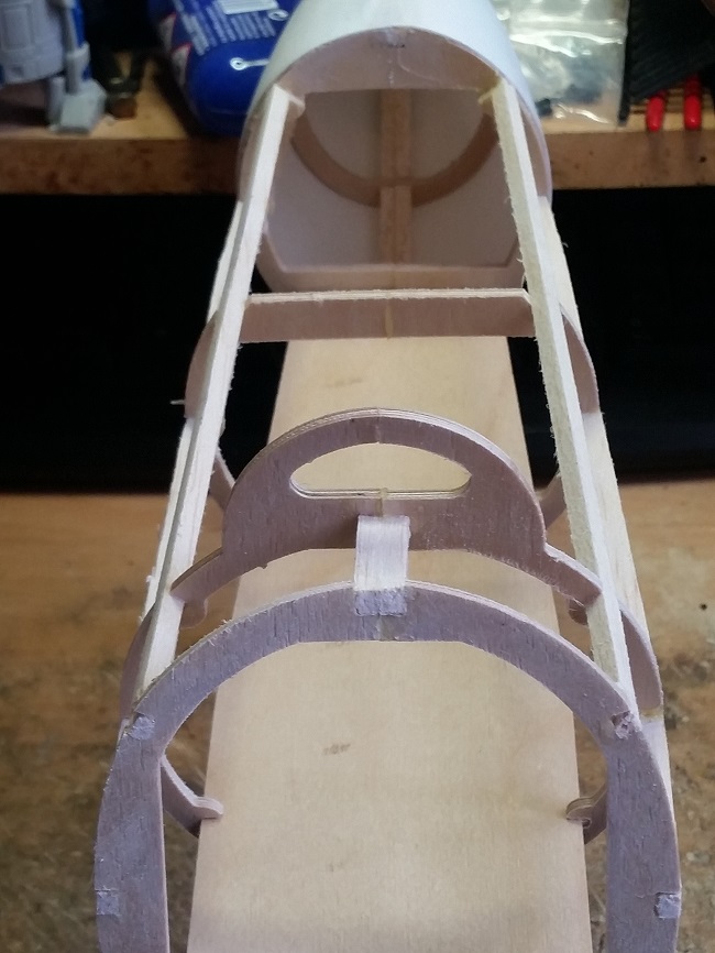

I have completed the second side of the forward fuselage (mirror of the first) and joined the said sides together. Also fitted the base section that would be the battery platform. Even though this is a display piece, this part will strengthen and align the coming construction.
The two nose cone sections did have a few ripples between then, so have used a small layer of "Plasto" to smooth things out and there is still a bit more smoothing required. (Good enough for now)
Next job is to start plating this section.
Until then, stay safe.BigGrin
