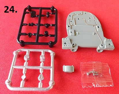

PARTS CHECKLIST – PICTURE 24
13-01 Fireproof Bulkhead
13-02 Frame with Bulkhead details A-F
13-03 Frame with Bulkhead details G-J
13-04 Hydraulic Fluid Tank
13-05 3 x PM 2 x 4mm screws (1 spare)

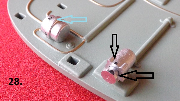

Here we can see some of the various components being installed onto the bulkhead.
One area worth noting (pic 28) is that for the silver painted parts we end up with missing paint were these have to be cut from the fret.
In some cases, this is not seen once installed but, on these parts, they are visible and will require touching in with some “silver” paint later.

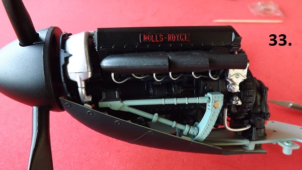

Next up is installing the engine and what a “right pig” that is.
Lots of jiggling and getting the engine at “odd” angles while trying not to put to much force in so as not to damage the myriad of parts that have been installed.
Got there in the end but it did take some effort.

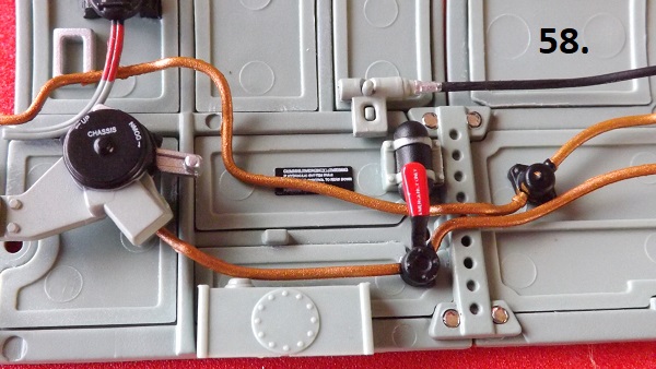

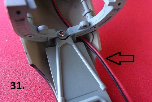

Pic 31 shows how I have re-routed the motor lead based on what I think it looks like in Pic 30. Time will tell if I have this correct or not.

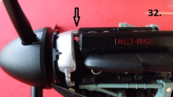

Pic 32
The instructions tell you to ensure the arrowed connection in this picture line up but I have found that there is some spring in this part of the engine and the section wants to sit higher than it should.
There are no “Pin/hole” connections between these sections which is a shame as this would have ensured a positive connection.
Will have to refer to and earlier build stage to see if there is something I missed when building this section.

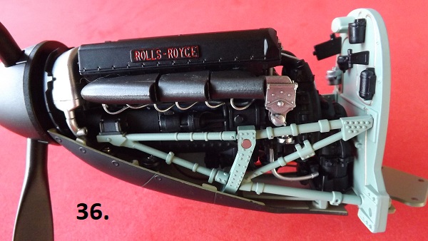

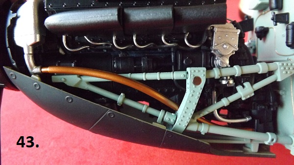

PICTURES 34, 35 & 36
We then press fit the read engine support frames into the fireproof wall which in turn has to be lined up and fitted to the engine section.
Again, quite a fiddly part of the build having to line up several holes and again a bit of firm pressure to get everything into position.

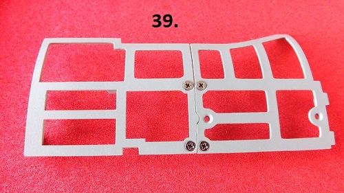

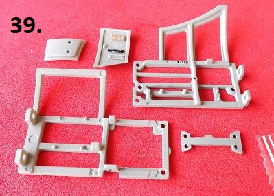

PARTS CHECKLIST – PICTURE 39
14-01 Cockpit Framework (Left Side)
14-02 Cockpit Framework (Left Side)
14-03 Connecting Strut
14-04 Cockpit Panel
14-05 Cockpit Panel
14-06 Five KM 1.6 x 3mm Screws (1 spare)

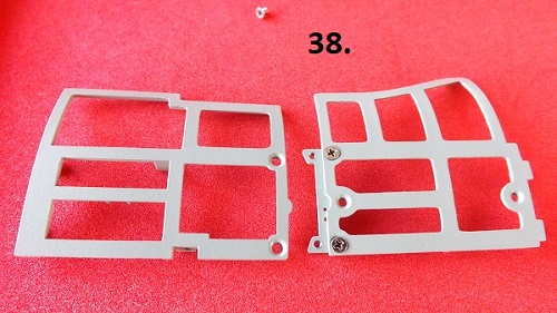

PICTURES 37 & 38
And again, in this issue we have another correction. This time a note advising the supplied screws are too long and that the replacements (cellotaped to the parts box) should be used in place.

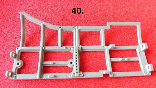

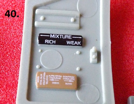

PICTURE 40
Here we can see one of the tiny infill panels and of particular note are the decals already in place and clear enough to read.

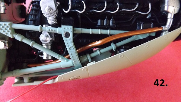

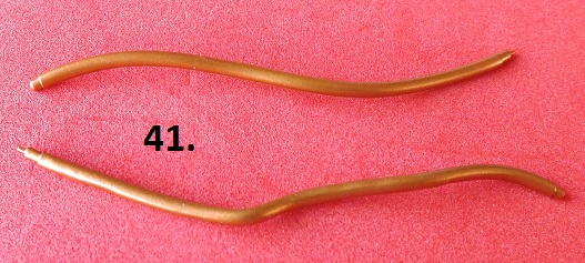

We need to start this build section by recovering the “copper” tubes from a previous section. These are actually flexible plastic but do like the part.
PICTURES 42 and 43
Further fiddly assembly here with the 2 pipes having to be threaded through the already assembled framework and secured ether end into 2 holes. Had to resort to a small torch just to find them.

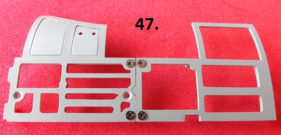

PICTURES 46 & 47
And this is were those replacement shorter screws get used.
We get a connecting strut that is used to secure the 2 halves of the Cockpit Framework in place.

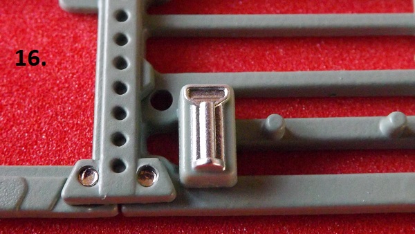

PICTURES 1 & 2

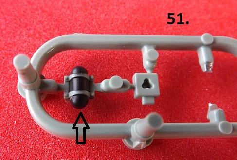

As the superglue I have been using has a tendency to leave a white fog (apparently called “Blooming” from what I recently discovered) I have purchased this version by Deluxe which apparently states its Non-Blooming so we will see.
In addition, where we are assembling plastic to plastic, I am using Tamiya extra thin for those parts.

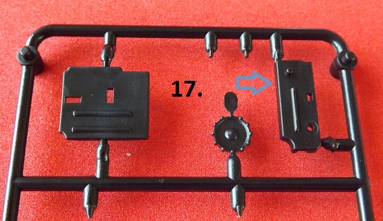

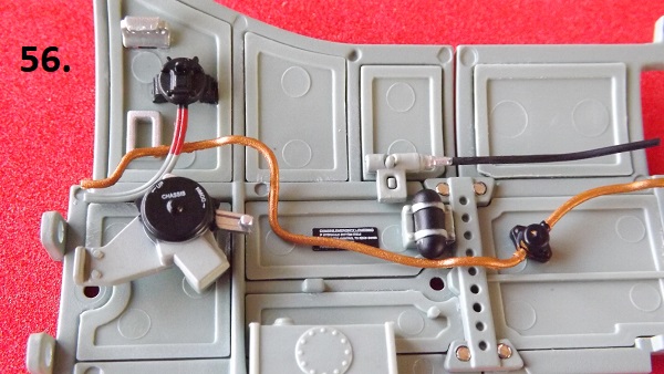

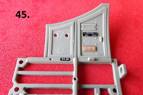

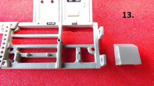

ISSUE 15 – DETAILS FOR THE COCKPIT INSIDE WALLS

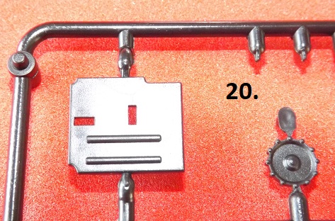

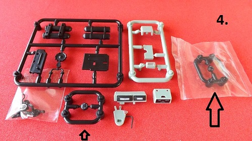

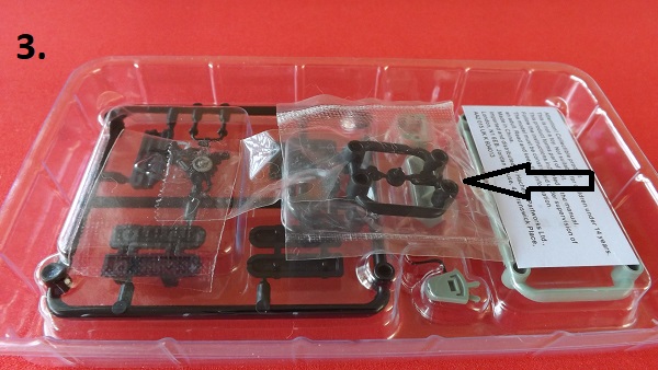

PARTS CHECKLIST – PICTURES 3 & 4

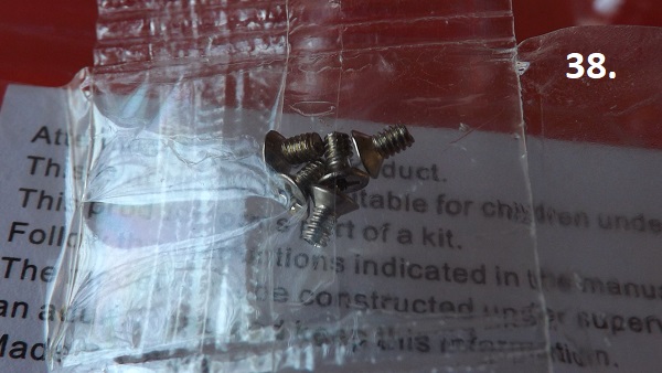

This section contains a replacement part to correct an error and that part is taped to the underside of the parts tray so care needed not to miss it and throw it away.
15-01 Cockpit Details A, B & C
15-02 Cockpit Detail
15-03 Cockpit Detail
15-04 Cockpit Detail
15-05 Cockpit Detail
15-06 Cockpit Detail
15-07 Cockpit Detail
15-08 Cockpit Detail
15-09 Cockpit Details D - I

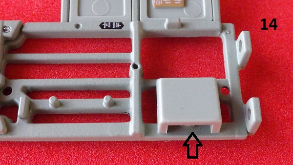

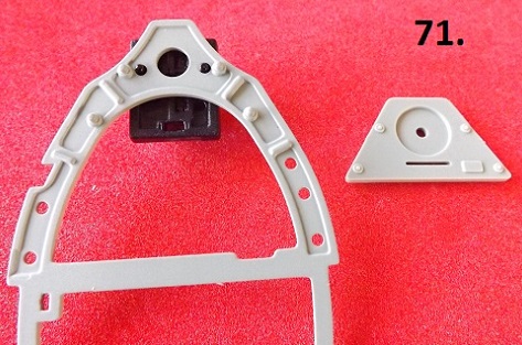

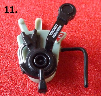

PICTURES 5 & 6

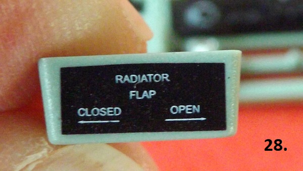

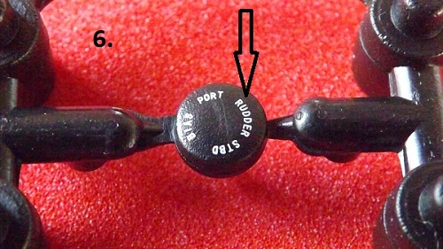

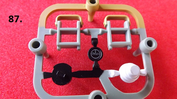

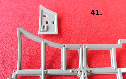

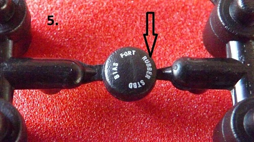

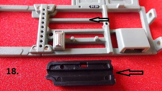

This is the part replaced with this pack. If you look at Picture 5 you can see the word “RUBBER”. This is corrected as in Picture 6 with the correct word “RUDDER”.

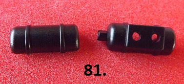

PICTURES 7 & 8

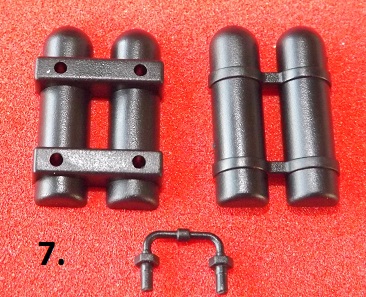

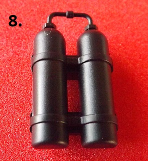

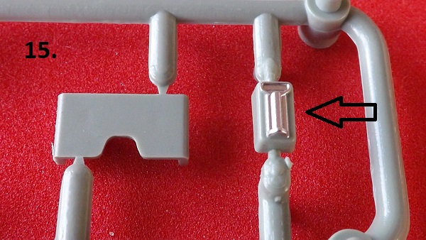

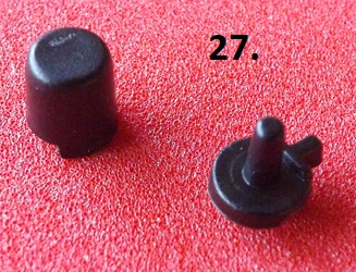

We start off by gluing together the 3 parts that make up the air tanks. Tamiya extra thin worked well here.

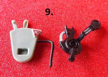

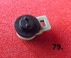

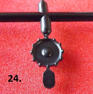

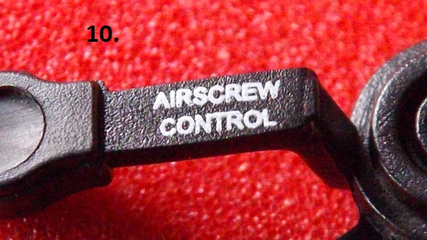

We next take “Cockpit Details” – such a shame they do not give the parts their correct name, and again glue these 2 parts together.
Its worth noting the detail in the printing. These are really small parts but you can still read (if you have better eyes than me) the text on these parts.

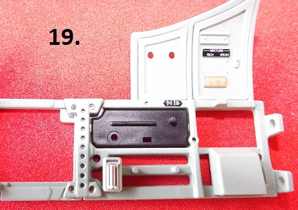

PICTURES 12 to 16

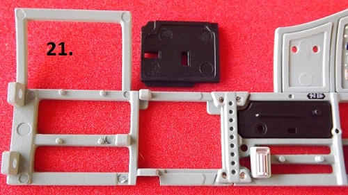

Much of this stage just involves taking various parts from the frets and gluing them into place on the previously constructed cockpit sidewall.
PICTURES 17, 18 & 19
Its worth dry fitting parts before committing glue as the areas that require glue are not always obvious.
In this case the glue is only required in the slot of the black piece (pic 18) so that it sits on the arrowed rail shown in the same picture.

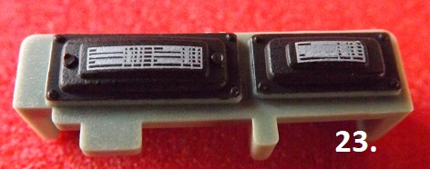

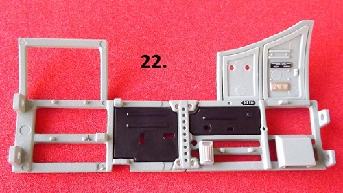

Very little explanation needed here as all we are doing is a continuation of adding parts to the cockpit frame.

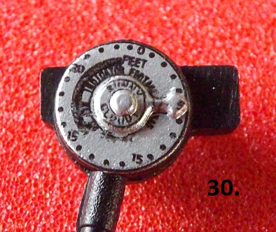

PICTURES 27, 28, 29 & 30

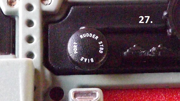

Picture 27 is the corrected part with the word “Rudder” rather than “Rubber” in place.
You can also see in pics 28 & 30 just how detailed the printing is even on the smallest of parts which in many cases will not be seen once the aircraft is all sealed up.

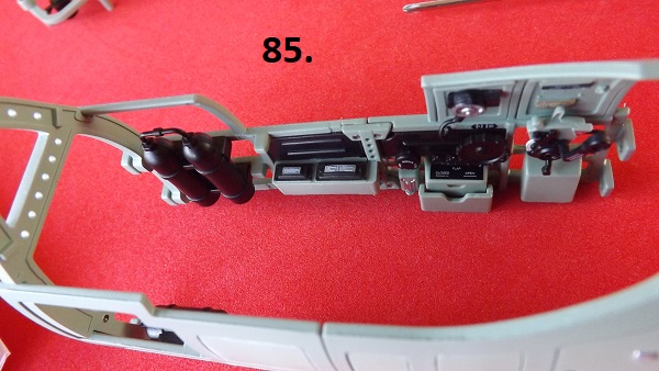

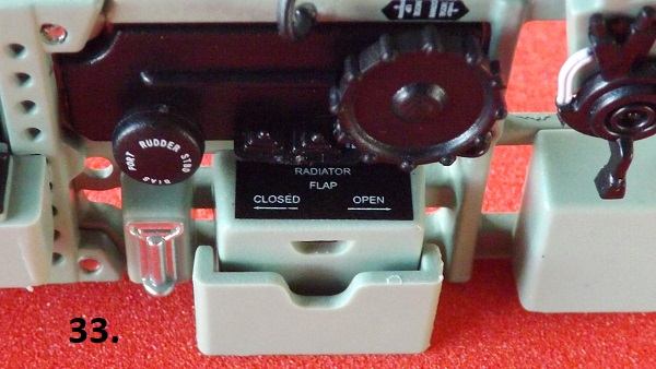

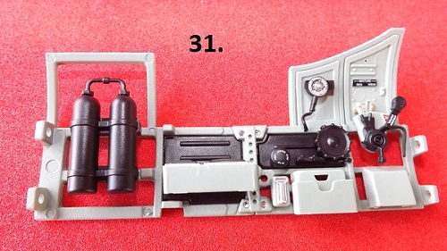

PICTURES 31, 32 & 33

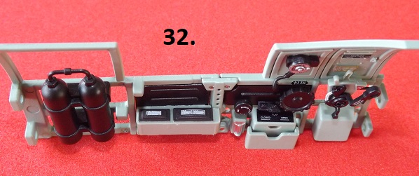

And when this section has been completed this is what it all looks like.
Very impressed by the amount of detail they are packing into this one.
While it may not continue its also worth noting just how many parts, they have been including with each stage which does give you some decent build time on each stage.

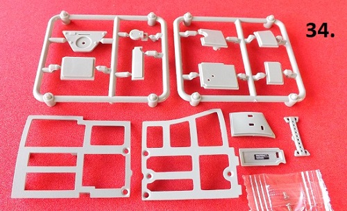

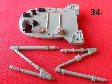

ISSUE 16 – FRAME AND PANELS FOR THE STARBOARD SIDE OF THE COCKPIT
PARTS CHECKLIST – PICTURE 34
16-01 Cockpit framework (starboard side)
16-02 Cockpit framework (starboard side)
16-03 Framework Connector
16-04 Cockpit Wall Panel
16-05 Cockpit Wall Panel
16-06 Cockpit panels and details A – D
16-07 Cockpit panels and details E – H
16-08 Five KM 1.6 x 3mm screws (1 spare)

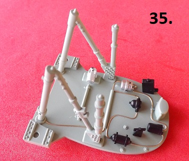

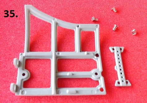

PICTURE 35 & 36
We start with the first part of the cockpit framework and the connecting bar.
PICTURE 37

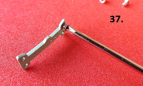

What I like to do before finally assembling the parts is to run a screw through the holes so that we clean out any excess paint etc and ensure all fits well/
PICTURES 38, 39 & 40
Once the parts are screwed together, we end up with the starboard side of the cockpit

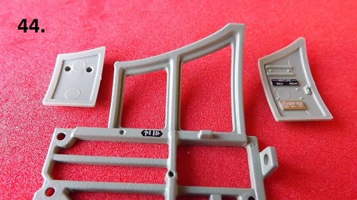

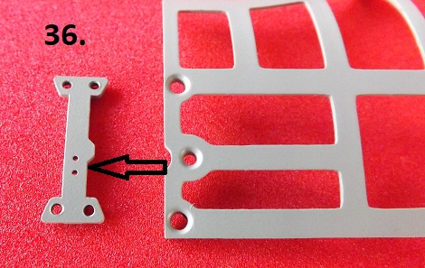

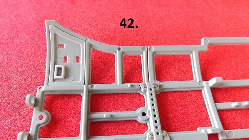

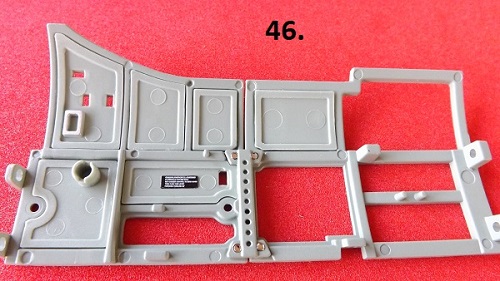

All we do in this stage is to take the various sidewall panels from the supplied frets and superglue these into place.
You do need to pay some attention to the instructions as (Picture 43) some of the parts are handed and have to be glued into place a certain way around.
Quite pleased so far with my new super glue as it gives a few seconds before parts “grab” and so far, that “Blooming” I had with my previous brand seems to have been resolved.

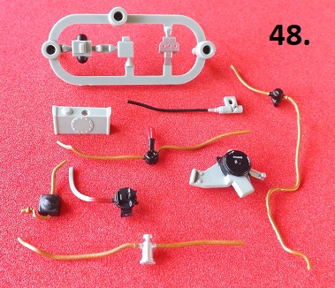

PARTS CHECKLIST – PICTURE 48 – Interesting as we seem to be getting part descriptions this time
17-01 Cockpit Detail (Undercarriage Control)
17-02 Cockpit Detail (Tank)
17-03 Cockpit Details A – C
17-04 Cockpit Detail (Harness Release)
17-05 Cockpit Detail (Signalling Switchbox)
17-06 Cockpit Detail (De-icing control)
17-07 Cockpit Detail (emergency undercarriage control)
17-08 Cockpit Detail (Oxygen Control)
17-09 Cockpit Detail (De-icing Pump)

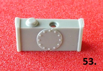

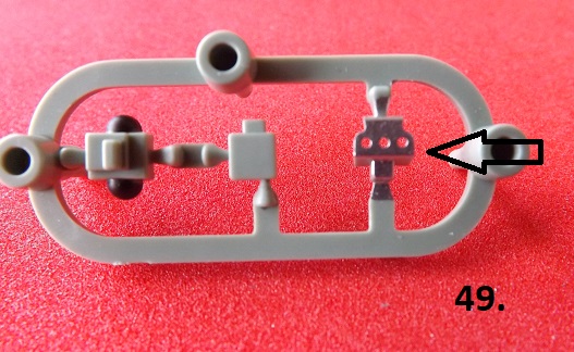

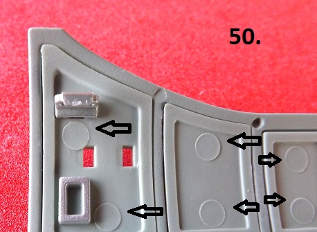

We start by taking the part arrowed in pic 49 and glue this into place (pic 50) to the sidewall.

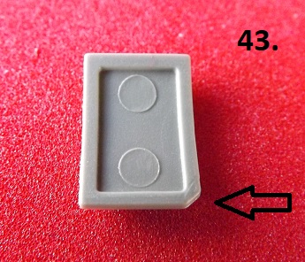

Looking at Picture 50 I have arrowed a slight area of concern with these many raised and recessed ejector pin marks.
Not impossible, but time consuming to correct these, and at this stage not sure what will be seen when its all buttoned up, I have opted to leave these as they are.

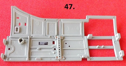

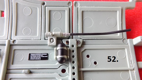

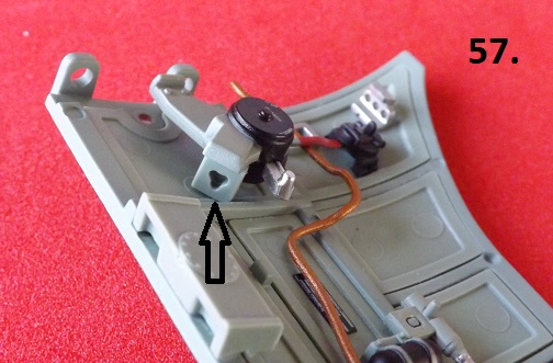

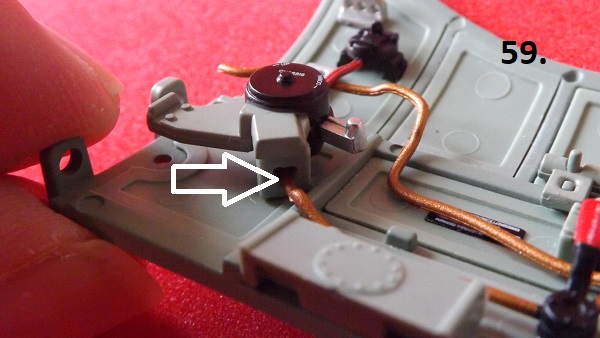

The trefoil shape on the part in picture 57 will see 3 of the various pipes terminating into this part
We can see the first of these in picture 59.
PICTURES 60, 61, 62 & 63

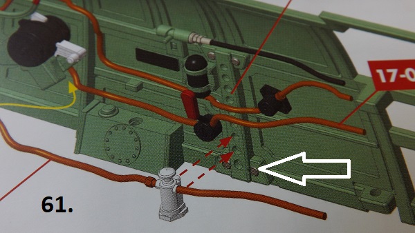

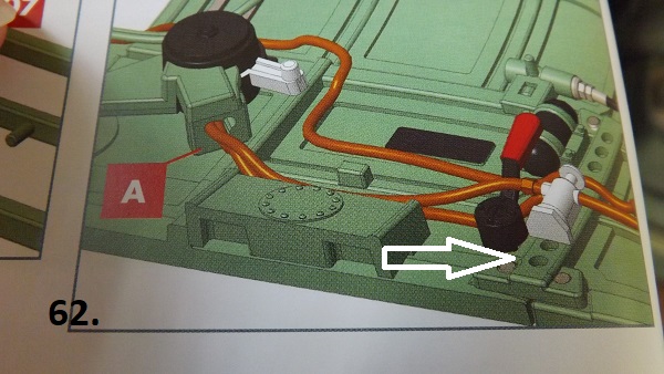

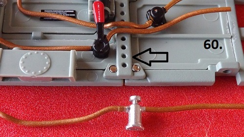

I mentioned at the start of this months update an ambiguity in terms of the placement of the part you can see in pic 60.
It has 2 studs that are glued into two of the holes on the connecting piece hold to cockpit parts together.
Picture 61 from the instructions appears to indicate you leave 1 hole in the connector when the part is in place.
Picture 62 indicates that there should be 2 holes beneath the part when fixed in place.
Having looked at it I have placed it with 2 holes below the part as this way the part seems to line up better with the red undercarriage release lever.

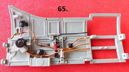

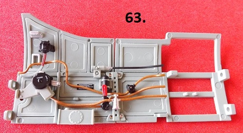

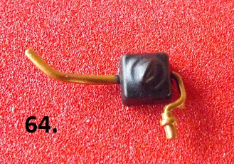

PICTURES 64 & 65
The de-icing control is the last part of this section that we need to glue into place.
Little bit fiddly as you have to align 2 pipe ends plus the connector on the back of the part.

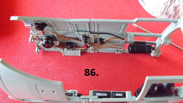

Picture 65 shows the completed section.

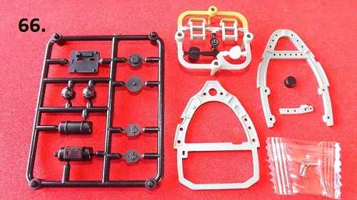

PARTS CHECKLIST – PICTURE 66
18-01 Cockpit Bulwark Frame
18-02 Cockpit Bulwark Frame
18-03 Strut for Cockpit Frame
18-04 Cockpit Details A – G
18-05 Cockpit Details H – K
18-06 Headrest
18-07 Three KM 2 x 4mm screws (1 spare)

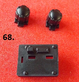

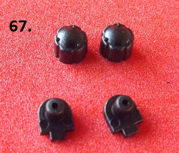

PICTURES 67 & 68
Start by removing these 4 parts from the fret and gluing them together.
The resulting 2 parts are then glued onto the backplate.

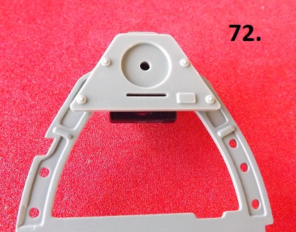

PICTURES 69 to 72
Taking the cockpit bulkhead, we then glue this part in place.
We then take the headrest support and that is also glued into place.

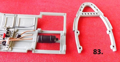

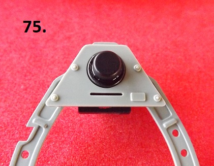

PICTURES 73, 74 & 75
Next up is the headrest and this is made up of 2 parts that are also glued into place on the bulkhead.

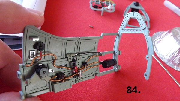

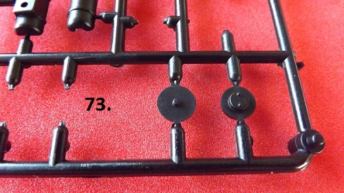

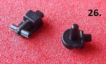

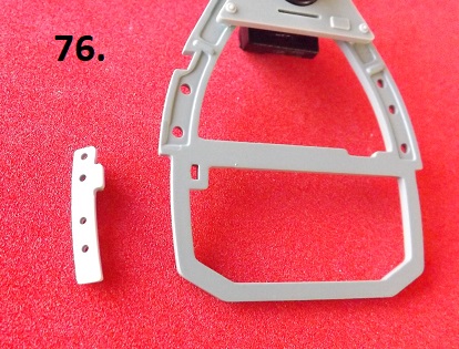

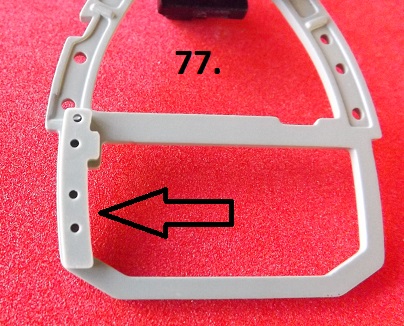

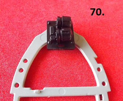

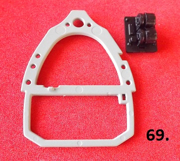

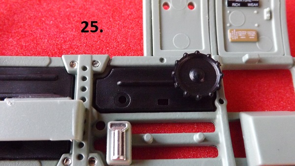

PICTURES 76 & 77
The instructions then call out this struct which is glued in place.
I think this will see the previously installed pipework terminating into these 4 holes.
PICTURES 78, 79 & 80

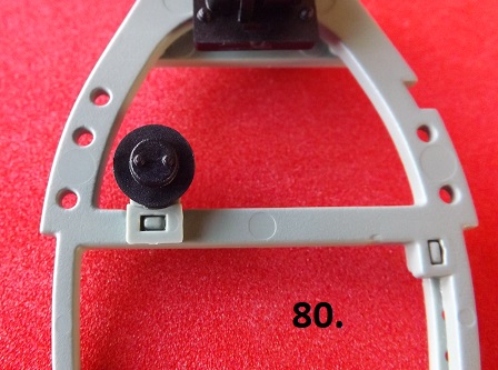

A further set of parts is assembled and glued onto the bulkhead.
PICTURES 81 & 82

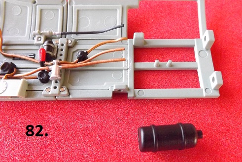

We then take the 2 halves of this cylinder and glue these together before finally gluing onto the framework.
PICTURES 83 to 86
The last part of this stage is to take the remaining bulkhead part and to screw this to the sidewall.
I could not resist using the 1 spare screw to also screw into place the other sidewall and pictures 85 and 86 show what this looks like.
PICTURE 87
Having completed this stage we are left with this fret that appears to have the rudder pedals amongst the component on the frame – but that is for a later day.
So, until the next time Stay Safe and Happy Modelling.
