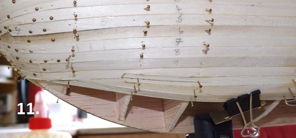

So, for me I am doing a double planked hull using 2.00mm x 5mm Lime and the second planking will be 0.5mm x 5mm Walnut.

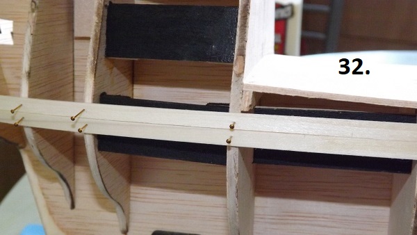

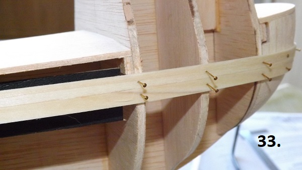

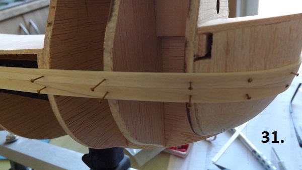

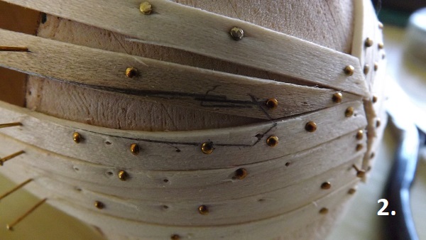

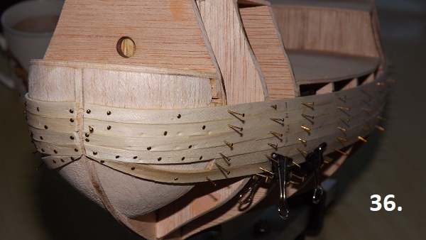

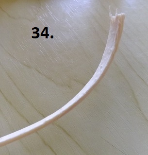

PICTURES 31, 32, 33 & 34
My planking preferences are not the quickest by any means but it’s a method of working I have got used too.
I start by soaking 4 planks at a time in war water using of all things a 2 litre plastic drinks bottle.
This makes the lime pliable to make bending easy with having to resort to planking pliers, or heat tools of any sort.
The planks are pinned to the hull using 2 planks per side at a time and left to thoroughly dry.
When dry they are removed (pic 34) and at this point they have held the shape that was put into them.

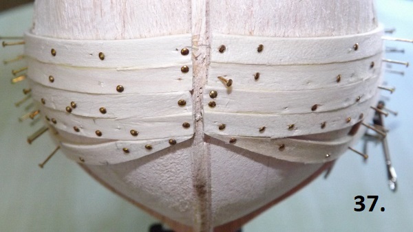

PICTURES 35, 36 & 37

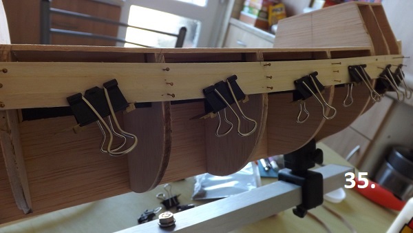

The planks are then glued and pinned into place for which I use Titebond Original Wood Glue.
As well as pins I also use Amati planking clamps just to ensure the edge to edge gluing of the planks is all kept nice and even.
With the shape of this hull I have managed a run of 4 planks before finding I will need to add “stealers” (i.e. triangular fillets) to keep the planking running true without trying to clinker.
From these pictures (36 & 37) the first 4 planks have been glued with the bottom 2 being loose pinned until they dry.
At the moment this looks like a “PINHEAD” lookalike but as things move on most of these pins will be removed and just a few used in select places prior to the second planking being applied.

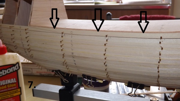

Mick I decided on a change of wood because the stuff provided in the kit is really hard and I could see me making a right mess of it and its not a wood easily replaced.
#48 Posted : 26 May 2020 19:17:55
THE MAYFLOWER – 26th MAY 2020
Slowly moving forward on my build. Time spent over the last few weeks has seen the completion of the first layer of planking that runs from deck level to hull bottom.
My process of soaking, pinning, drying, chamfering then gluing each plank is certainly not a quick way of working but working with a soaked plank allows it some flexibility but you then need to allow it to dry else you end up with gaps as the wood dries out and shrinks back.

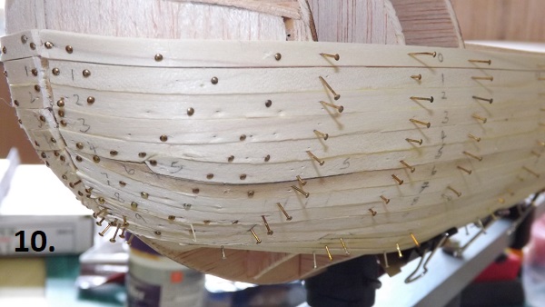

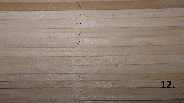

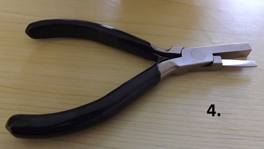

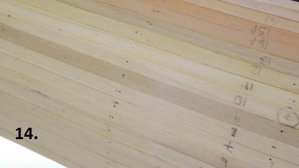

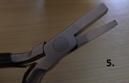

PICTURES 1 Through 6

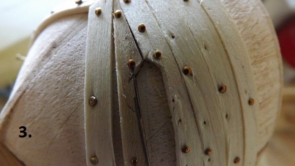

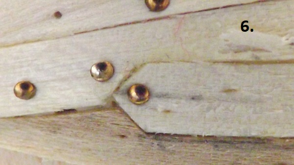

I have not mastered the “Drop Plank” process at the moment but my attempt has allowed me to get planks around quite a tight curve on the bow without any major “clinkering” with planks trying to ride up over each other.
Were I have need to curve a plank I use these little plank crimping pliers (pic 4 & 5) as I find the traditional versions are just a little too big for my hands.
PICTURES 7 Through 11

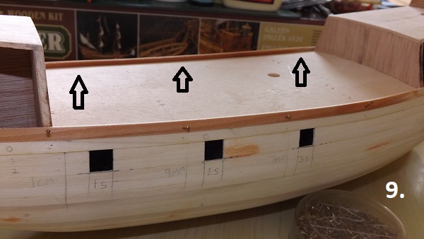

In picture 7 I have arrowed the first plank that is loose fitted and from were we then work down the hull.
When this loose fitted plank is removed the gun ports will be cut and these start at the Top of the first plank glued in place.

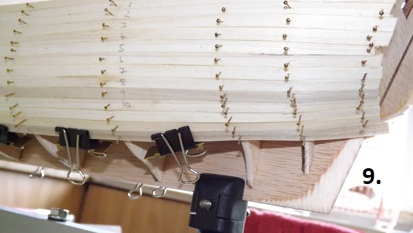

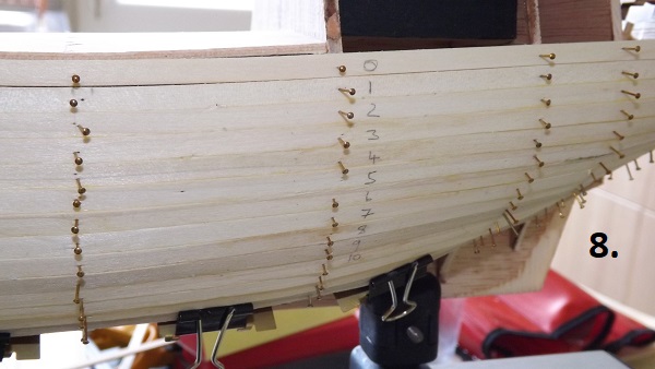

In Pics 8 & 9 you can see that the planking has gone on with next to no gaps between the planks. This is achieved by chamfering the edge of each plank so they butt up against each other as they follow the curve of the bulkheads.
In pictures 10 and 11 the bow is beginning to look like “Pinhead” from the Hellraiser films but just wanted to ensure that the planks around the curve of the bow were held nice and tight as the glue dried.

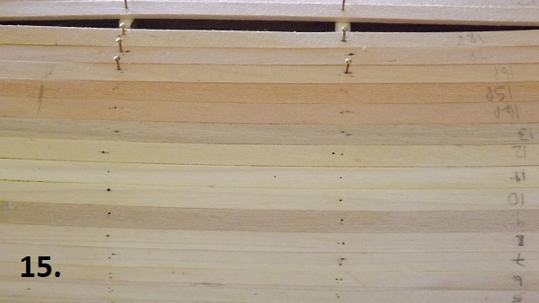

PICTURES 12 Through 15
Again, just general views of the hull planking as its progressed.

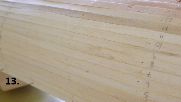

One point of note if how wood varies in colour. I am using Lime as the first planking layer and had to order up a second batch and its noticeable just how much variation in the colour there is.
No major issue as it’s the first planking layer but its always worth watching out for when you put the finishing layers of planking in place.

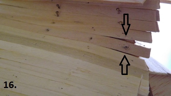

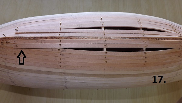

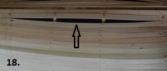

What was surprising was I ended up with just 2 triangular fillets each side of the hull to infill.
I ended up with an “elongated Oval” down at the last 2 plank level and to infill these I used a straight plank length with each end cut at a point (45 degrees).
In picture 17 you can see how I have overlaid this new plank over the previously installed ready to be marked up and fitted in position.
Camera batteries just died on me so a picture of the completed (to this stage) planking in my next post.

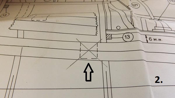

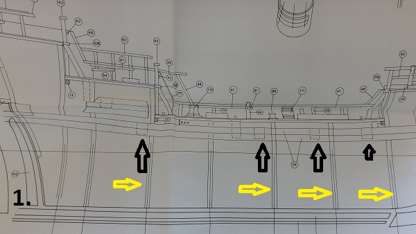

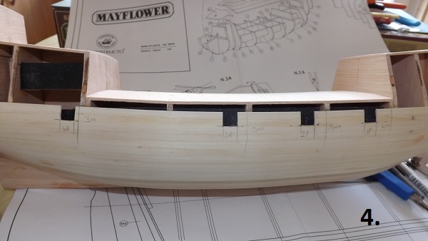

The next stage was to start cutting out the lower gun ports, at this level of the planking 4 per side.

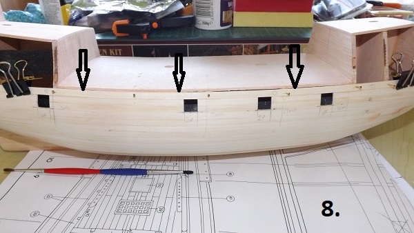

PICTURES 1 and 2
This is were we have to work from the plans in order to get the measurements that we need to cut.
There are no real directions on what to do so (picture 1) I measured in from each frame (yellow arrows) to the edge of the gun port in the plan (black arrows).
Those frames are still visible as we starting planking several millimetres below the line of the deck.

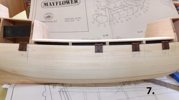

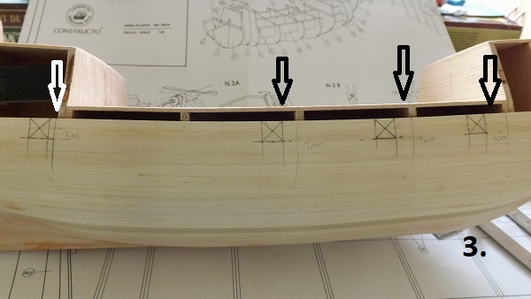

PICTURE 3
This is how it looks with the gun ports marked out on the hull. We can still see the frames (arrowed) that allowed me a point to transfer my markings from.
What is really useful here is that by planking below the deck level this first plank is at the height of the top of each gun port so we only have 3 sides to cut through.
PICTURE 4
Carefully, very carefully I cut out each of the ports 4 each side at this stage

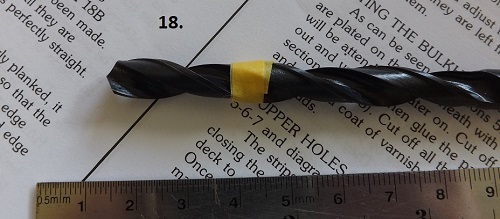

1. Drill mast holes to the correct depth and angle. At this stage the only hole is through the false deck and not into the mast support blocks that were glued in earlier.

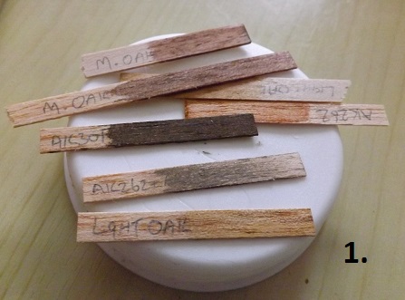

PICTURE 1
I should really try and find some time (if only) to “Play Decks” and work out some colour methods that I am happy with.
I saw a video recently were the builder had achieved just the sort of deck colour I hanker after but apart from mentioning he had used to AK Interactive products (a Filter and a Panel Line Wash) there was no instruction as to how to use these 2 items.
In Picture 1 you can see I have had a “little play” with some lime and Tanganyka which just resulted in me going back to my tried and tested Light Oak wood stain which I will use for the basis of this ships decking.

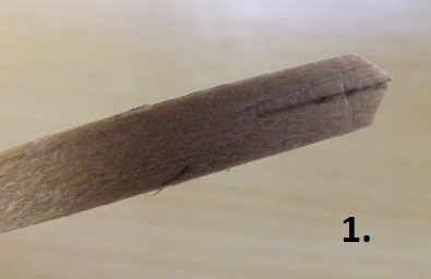

MAKING THE DECK PLANKS:
PICTURE 2

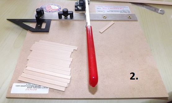

So, armed with my Lime Strips and my tried and tested NSW (Northwest Short Line Chopper) I started cutting the wood strip lengths to 600mm (which is the size I measured from the plans as that detail is not noted in the instructions).

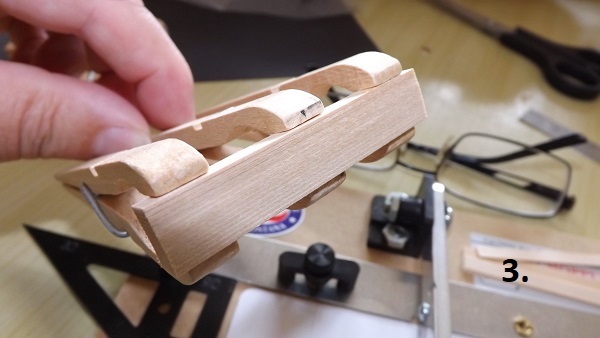

PICTURE 3
Each length cuts down to around 16 x 600mm lengths with a tiny bit left over.

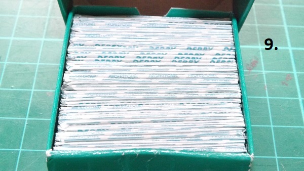

These lengths are then bundled (15 at a time as that is the span of my peg clamps) ensuring the long and short ends are all inline.
PICTURE 4

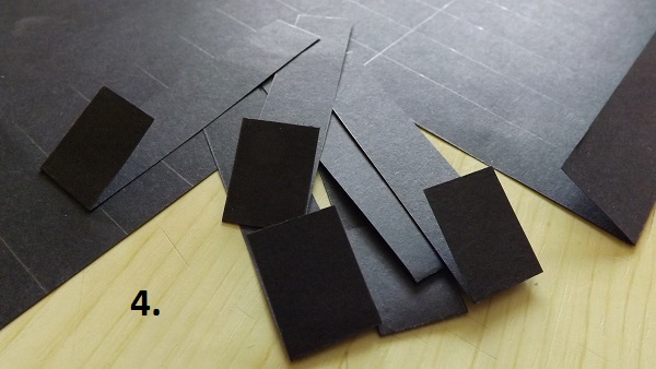

My own preference for getting the effect of Plank Caulking is to use black paper. By no means the quickest option or indeed the easiest.
We start by cutting some strips of black paper and as you can see here I pre-fold one edge that will glue to one of the shorter sides of the planking bundle.
Nothing special about this paper other than it took an age to find one that was not too thick and more importantly that stayed in place once glued.

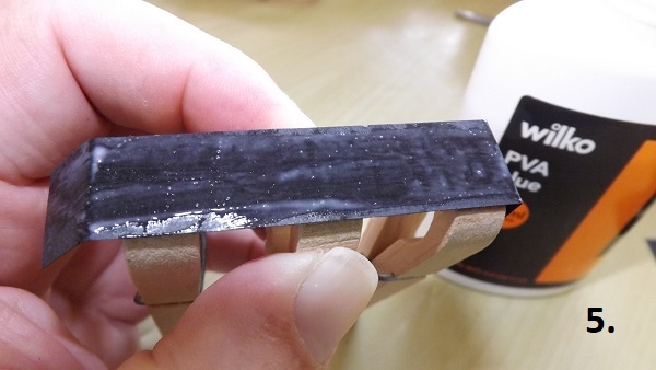

PICTURE 5
Using nothing more than a very cheap PVA “kiddies” glue from Wilco one long edge and one short edge of the plank bundle is glued up and the paper pressed into place.
What we are aiming for is to keep the planks tight in the peg clamps as we do not want glue travelling down between the planks otherwise you will never get them apart again.
I then coat the outer part of the paper as this seems to allow it to dry more evenly without curling and pulling away from the planking (an important stage as you will see when we come to separate the planks)

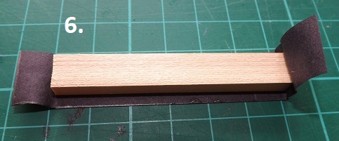

PICTURE 6
And once this is all dry this is the little package of planks we are left with.

We now need to consider how to separate this bundle into individual planks while retaining a black edge along one short and one long side.

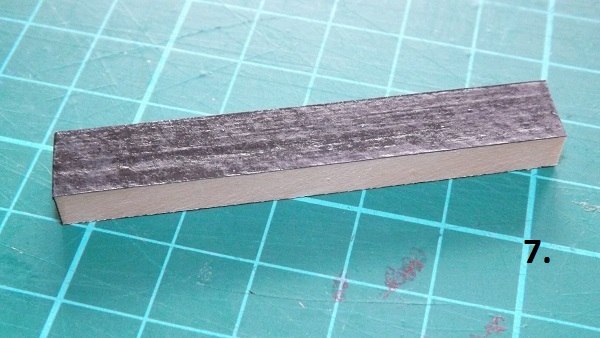

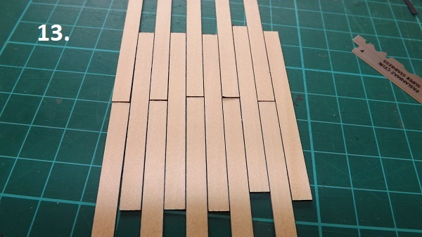

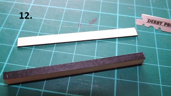

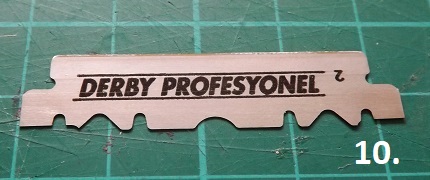

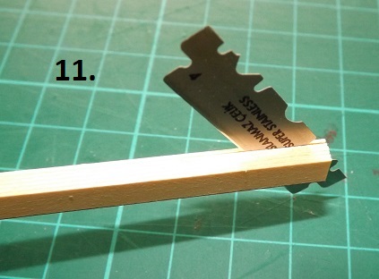

PICTURES 8, 9 & 10
To get between these plank blanks we need a very, very thin blade. And one of the best that fits that requirement is the tried and tested razor blade.
Surprisingly not an easy item to source these days with the advent of electric razors or cartridge style blades.
I managed to track these down and being single edges blades are “safer” to use that the traditional double-sided blade in my view (only one chance of gutting your fingers rather than two 😊)

The method of parting the planks is to pick up the space between 2 of them and to then very carefully “saw” along the length of the plank.
PICTURE 12
And this is the first of the planks parted from the bundle.
We keep going until all are separated, making sure NOT to lose concentration or we could end up with “Battle Damage” to the fingers.
PICTURE 13
And this is the sort of result we can hope for once the decking is in place.
With luck we will end up with a neat black line along one long, and one short edge.

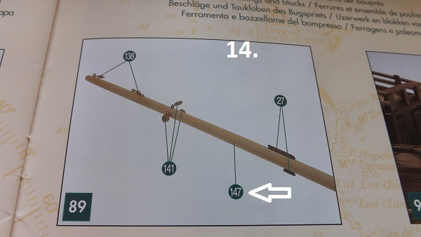

PICTURE 14
This shows that you have to be so careful in cross referencing the picture book, printed instructions and plans.
This is a picture of the bowsprit and I think its fairly clearly that is identified as part 147.

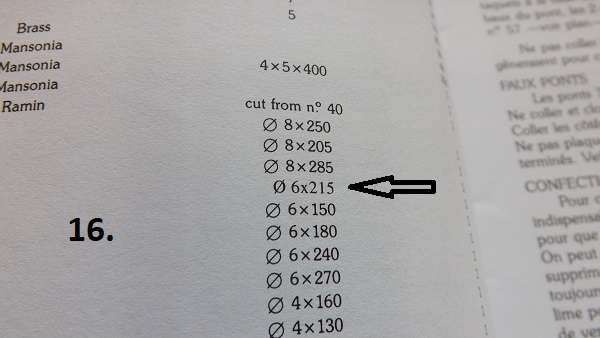

When we cross reference Part 147 to the parts list is wrongly described as “BLOCKS” rather than “Bowsprit”.
Scanning along the line shows that this “block” has a diameter of 6x215mm so I think we can safely assume this is not a block but the bowsprit.
PICTURE 17

PICTURES 18 & 19

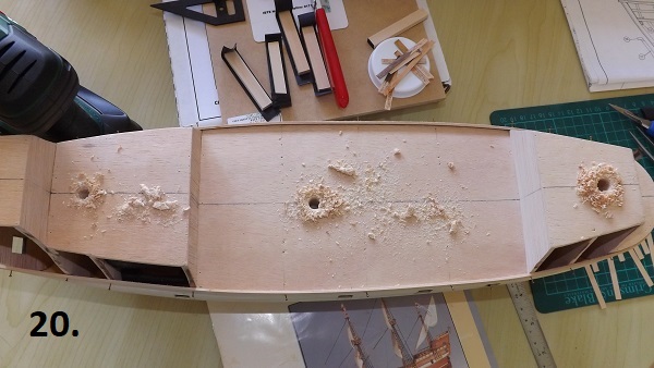

Paying careful attention to the instructions we discover that the Main and Foremast are 8mm diameter but the Mizzen Mast is just 6mm diameter.
Having taped the drill bit 2 the 2.5cm depth its time to chuck the drill (not literally – although there have been moment) and using the drill we proceed to drill out those holes.
PICTURE 20
Looking like the woodworm has had a good feed we just need to clean of the wood dust from the previous drill exercise.
